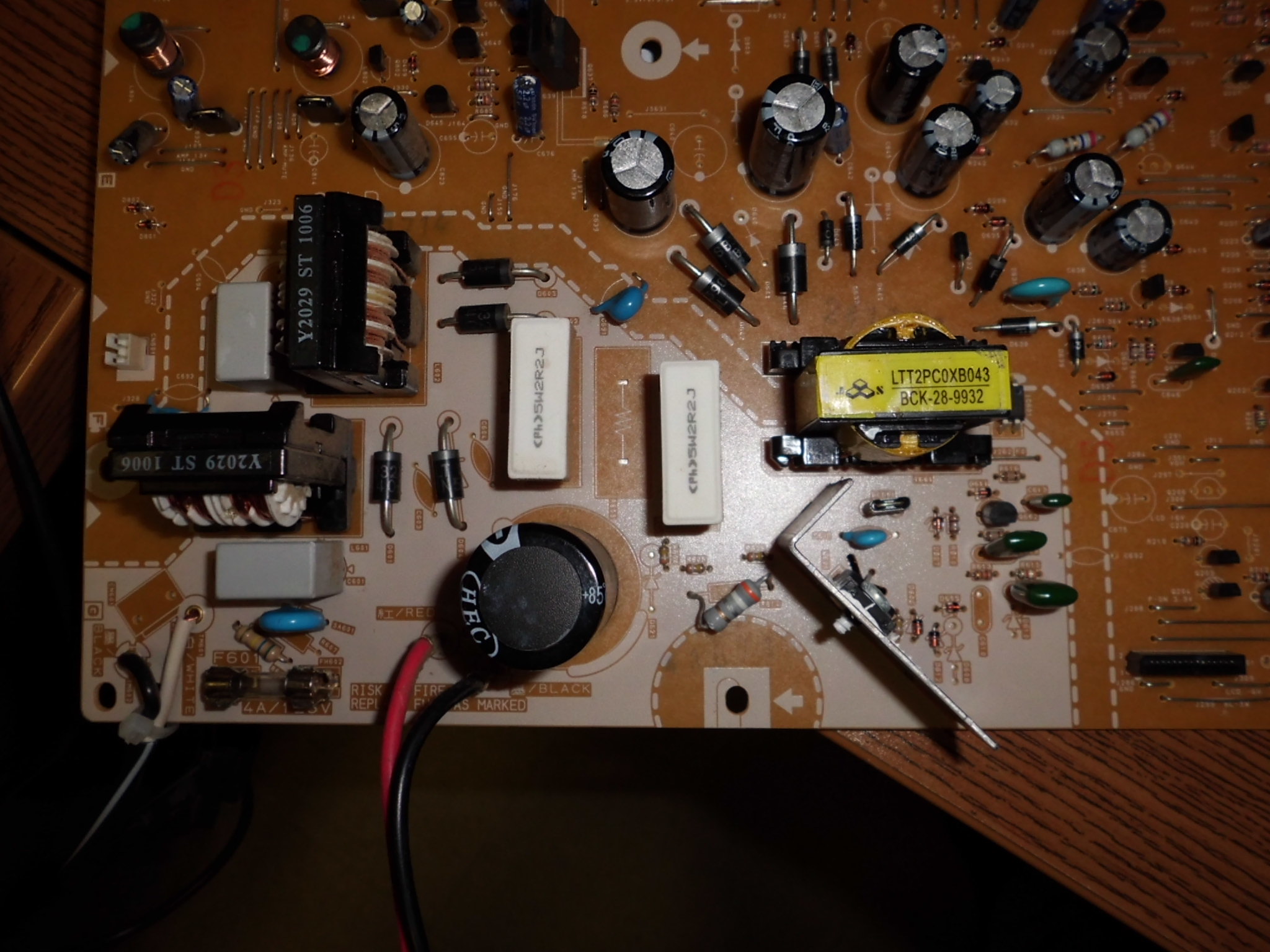

    I retrieved a LC32EM1F from the dump and found that it draws current as I slowly bring up the AC using an isolated xformer. At about 40 VAC, the current rises to 2A. Power transformer has an audible buzz so started looking there after disconnecting the inverter board and the main board. Made sure that the FET attached to the primary transformer was good and then looked at each winding on the primary transformer. The primary side is good (~2 Ohms), but the secondary side looks like they are all shorted together. Other thing I noticed is that when I disconnect the main board, the current drops. The transformer part number is ltt2pc0xb043, but I could not find specifications for it. Anyone help with this one?

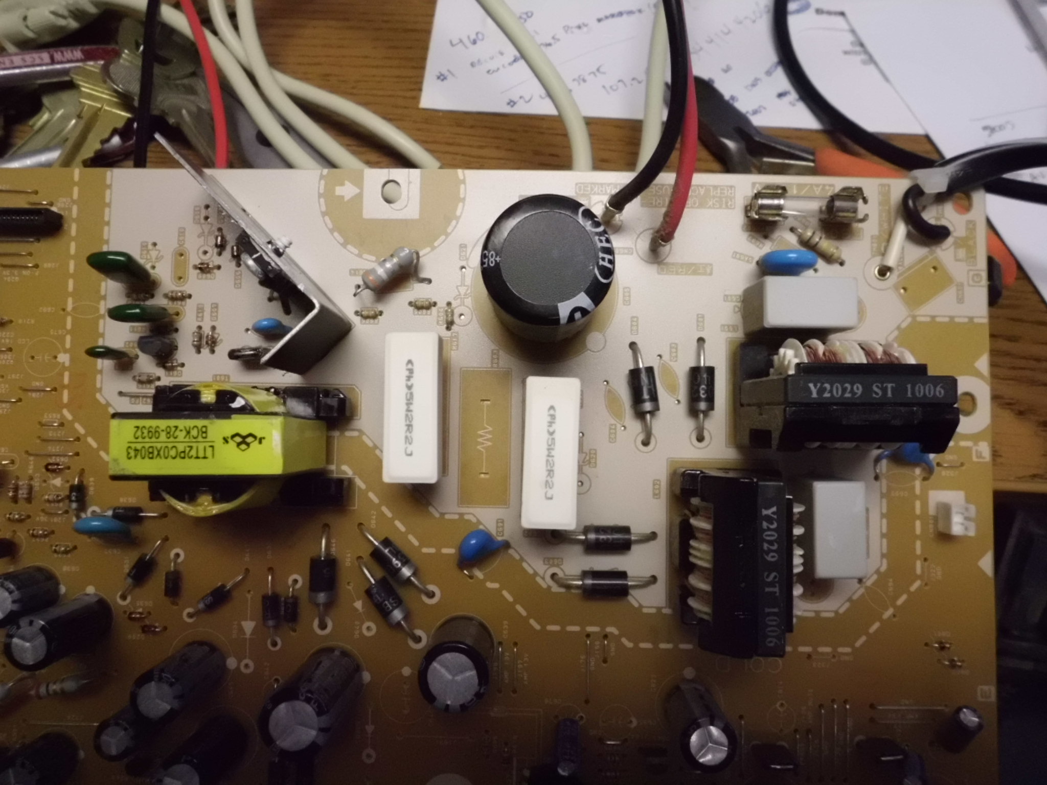

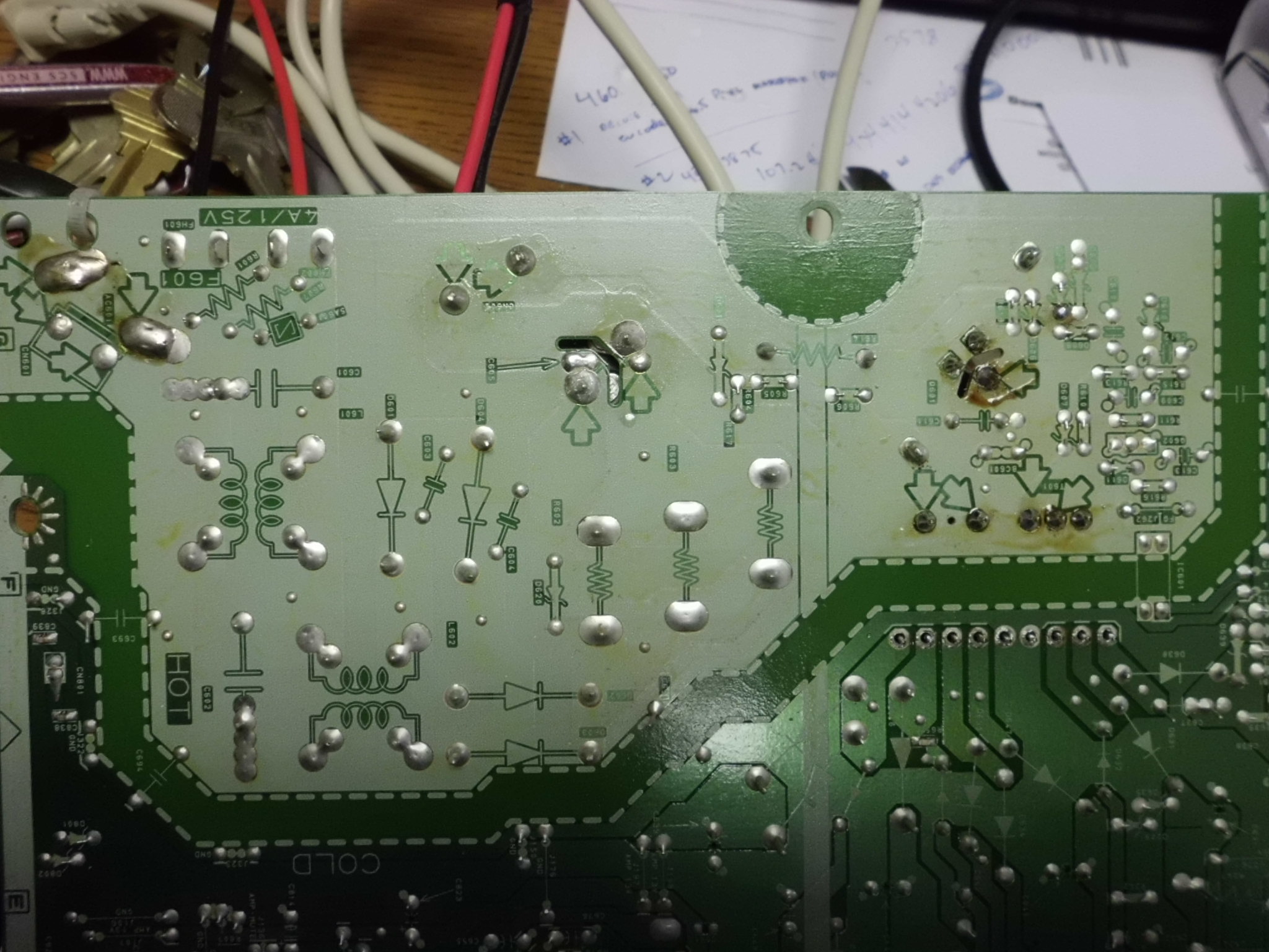

          Tha20 Ohms indicated you have short circuits. Are you sure that the MOSFET and the rectifiers are good? try removing the MOSFET, lift one leg of each rectifer one at a time, etc. Closed up pictures of the primary side of both sides of the board?

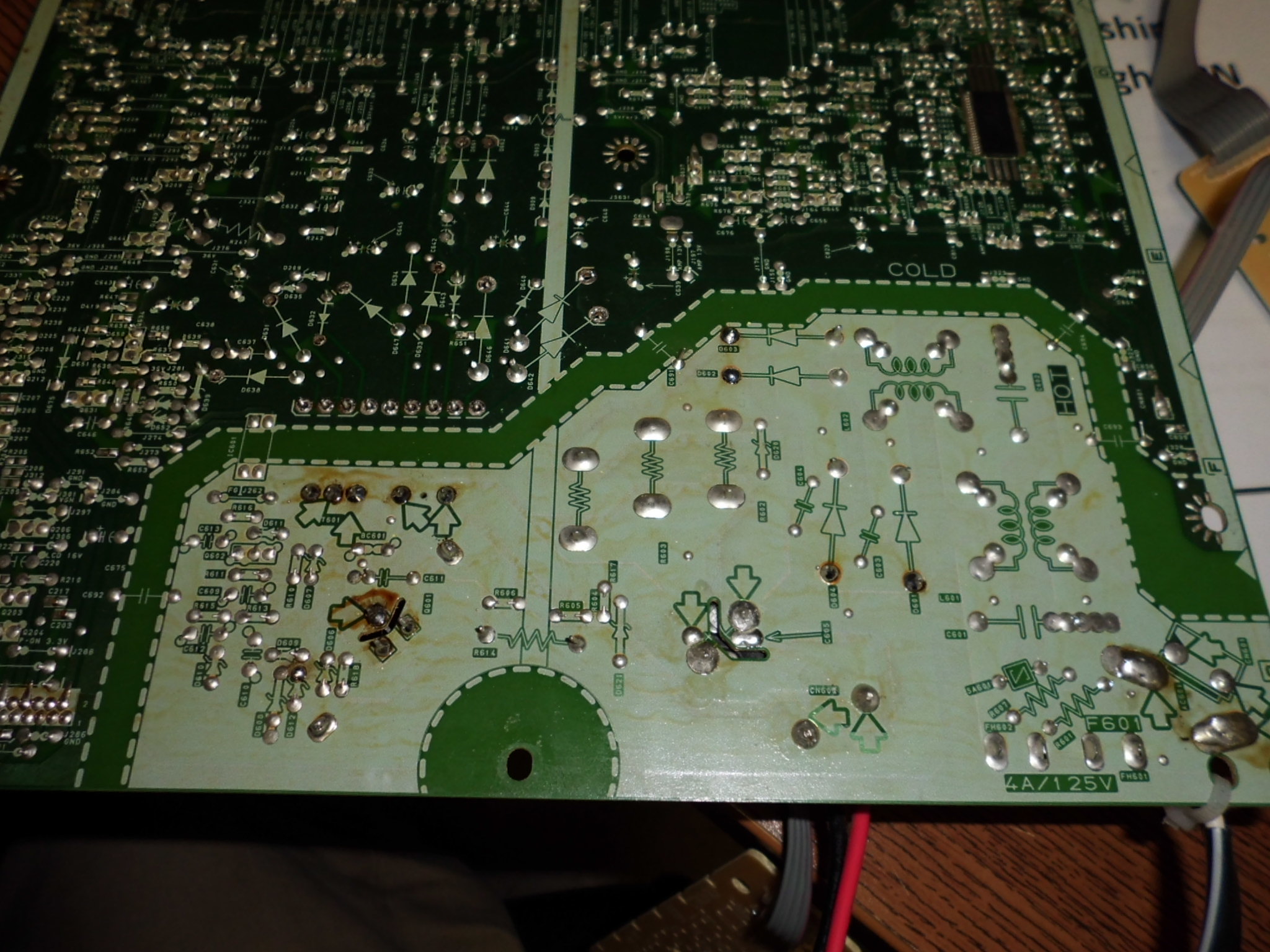

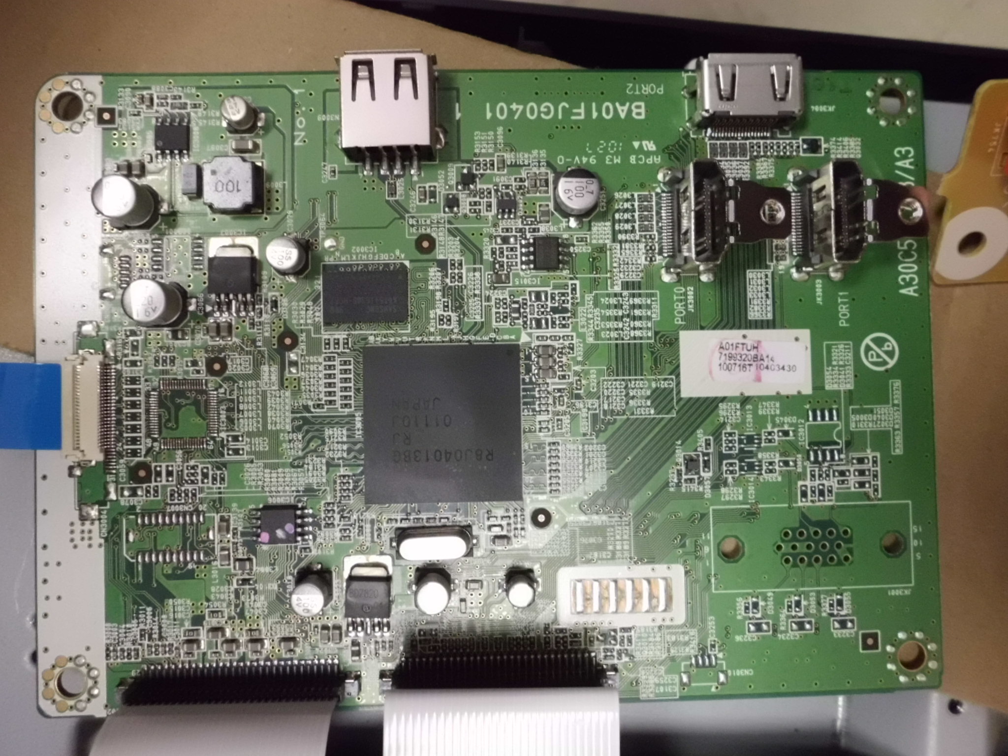

            Replaced the FET with (K3563) with 65E6600 just to make sure. Still high current. I have not soldered the secondar side of the transformer back down yet either. Unsoldered each of the diodes on the primary side as well the the 10 or so closest to the transformer. All appear to be good. I also checked the glass/switching diodes nearest the FET. One (D612) looks shorted when soldered in, but turned out good when desoldered. Pictures below.

              Back at it again. I disconnected the peripheral boards and then desoldered the secondary pins on the primary xformer. Current immediately rises as I turn up the AC on isolated xformer. The transformer buzzes pretty loudly and the heatsink for the FET gets hot instantly. Measured across all the zener diodes and though I had found a shorted one (D612), but was not the case. Unsoldered one side and still high current. Suggestions on what to check next?

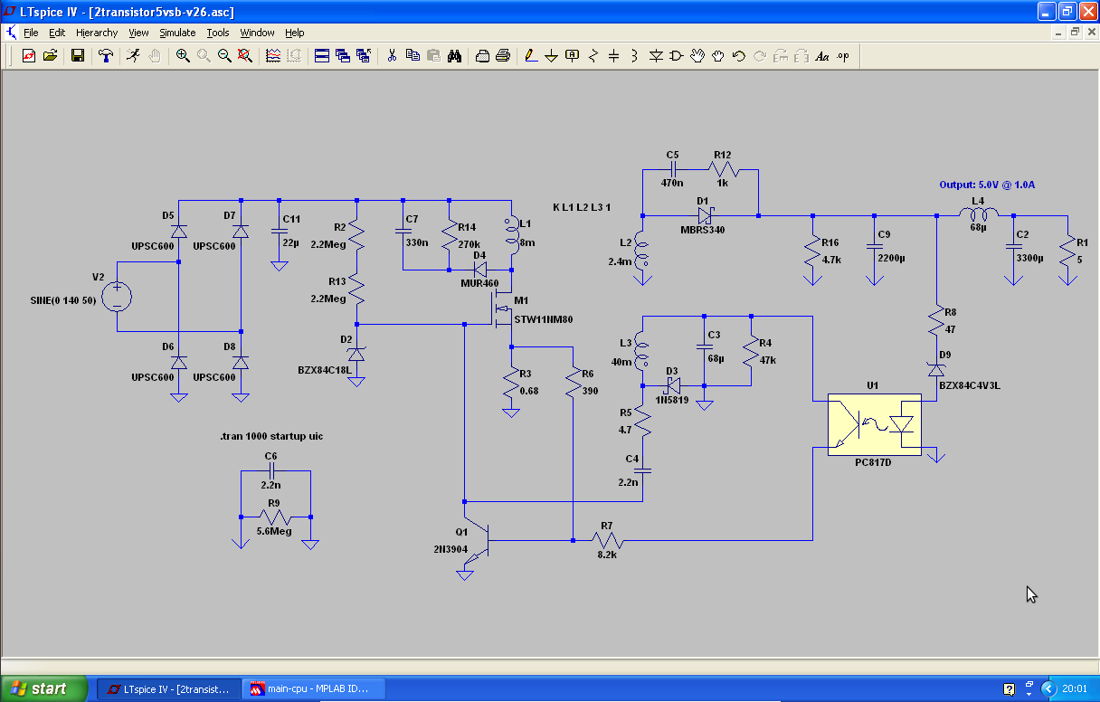

                  There is no IC in this design bud -- it's a self-oscillating converter using one NPN transistor and the MOSFET. It oscillates around the properties of the transformer. A rather ingenious design, I must admit, but a very bad one for several reasons. It tends to be unstable; it can go out of control and make the output voltage shoot too high. It's a pain in the *@#! to debug.
                  In general, I'd say the only way the MOSFET could fail by getting hot would be:
                  1.) it's shorted but high ohms short (a couple kohm would do it)
                  2.) it's got a drain-gate short
                  But the circuit has many other ways it can fail:
                  1.) if R5 goes too high in value (it dissipates about 1/4W) the MOSFET will not be efficiently switched and voltage will not rise high enough
                  2.) if Q1 goes open, the circuit will not oscillate (gate will remain at 18V, which wouldn't be good!)
                  3.) if R7 goes open or high in value (it dissipates about 1/2W) the circuit will not regulate the output voltage (it will go high)
                  4.) if R3 fails by reducing resistance (rare), current limit characteristics will change
                  5.) if C3 fails, output will go out of control (2-3x rated voltage)
                  6.) any bad caps on output will cause the circuit to be unstable
                  7.) snubber failure (as with any flyback)
                  8.) ... probably other ways it can fail too, just some I can think of
                  On these Funai TVs and similar TVs, they also use the self-oscillating circuit for generating the ~135W backlight supply, only slightly modified. I wish I was kidding.
                  Short circuiting the output of a self-oscillating converter will normally kill it, the MOSFET fails short.

                    Thanks TOM, I just look at the bottom side of the board and see two transistors and an Opto connections.

                      With the isolated xformer barely turned up (1.5 amps @ 5 VAC) I am getting 7 VDC at the base of the Q1 transistor (Q602). Does this indicate that the Q1 is shorted?
