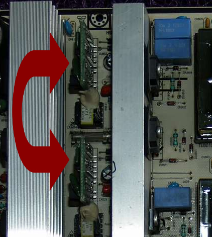

    Okay I think i've made some progress.. With PSON and VSON... I checked the voltage outputs, ALL are present except the Vs. I decided to measure the voltage on all the electrolytic caps along that Vs line of the PSU.. 395V across the large filter caps, 0v on the cap beside sub board 1, and obviously 0v on the secondary caps... Checked the voltage on Sub Board 1's Vcc pin and it was 0V, (sub board 2 is working and has 3.2V on it's Vcc)....
    So I followed the path of Sub Board 1's Vcc supply, which was jumped across the board back to a PNP transistor QU803 (KMPS 751Y 603) near the standby section.. Before the base resistor and emitter of QU803 there is a cap with 13.6v across it.. This also feeds sub board 2 so I know it's good.. Essentially, there is voltage on one side of QU803 and none on the other... Took it out of circuit and the junctions test 0.505v and 0.660v...

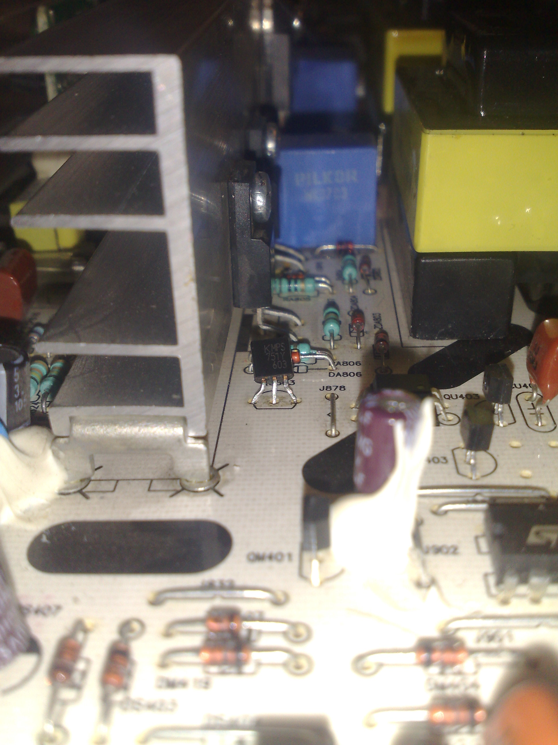

      Okay after about an hour searching I found this on Farnell's, a replacement MPS741. I'm gonna buy one, put it in .... (stand way back from it :-) ) Then try power it on again and see if I can get the Vs to work..

        Re: Samsung PS-42Q7HD clicking, blue flashing LED, no power
        Put in the new PNP transistor for QU803 and still no go... The same 13.7 volts is at the collector and base of the transistor, with nothing at the emitter.. Both sides of the base resistor (which is fine) are also at 13.7 volts as well...
        I'm gonna try to test the supply voltage to sub board 1 when I turn on the PSU and see if it is shutting down because of a short... And pull the sub board off the main board for testing.... this one is difficult

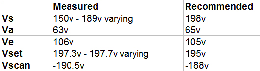

                                    Swapped out that cap on the sub board.. Still the same..
                                    Took these measurements while the screen is pulsing:
                                    I need to find some way to isolate the PSU first and put a load on it.. If I put four 25V bulbs in series and use a resistor to limit the current, I could use this as a dummy load for Vs? Does this sound safe/crazy?

                                      Ve is bad then. Not seen that before, haven't considered what that might do... hmm.
                                      Anyway, for a Vs load, why not use a 230V lightbulb? 100W should be fine for ~85W load on Vs.

                                        #39
                                        Sorry tom.. I edited it wrongly in photoshop.. TWICE!!!!
                                        I'll change it again now..
                                          Okay above are the correct figures that I pulled when the screen was on but pulsating..
                                          Just as a test I swopped the sub boards (both DYP-42V5).. changing the 16 pin IC brought the Vs voltage back up, but I was never happy with the solder job I did...
                                          When I swopped the boards the TV starts clicking and doesnt come on at all.. So it seems that there IS a problem still with that sub board that I soldered, but this problem is only evident under load.. I've tested all components on both sub boards and they match. Dont seem to be able to buy that sub board separately... May just bite the bullet and order the PSU..
