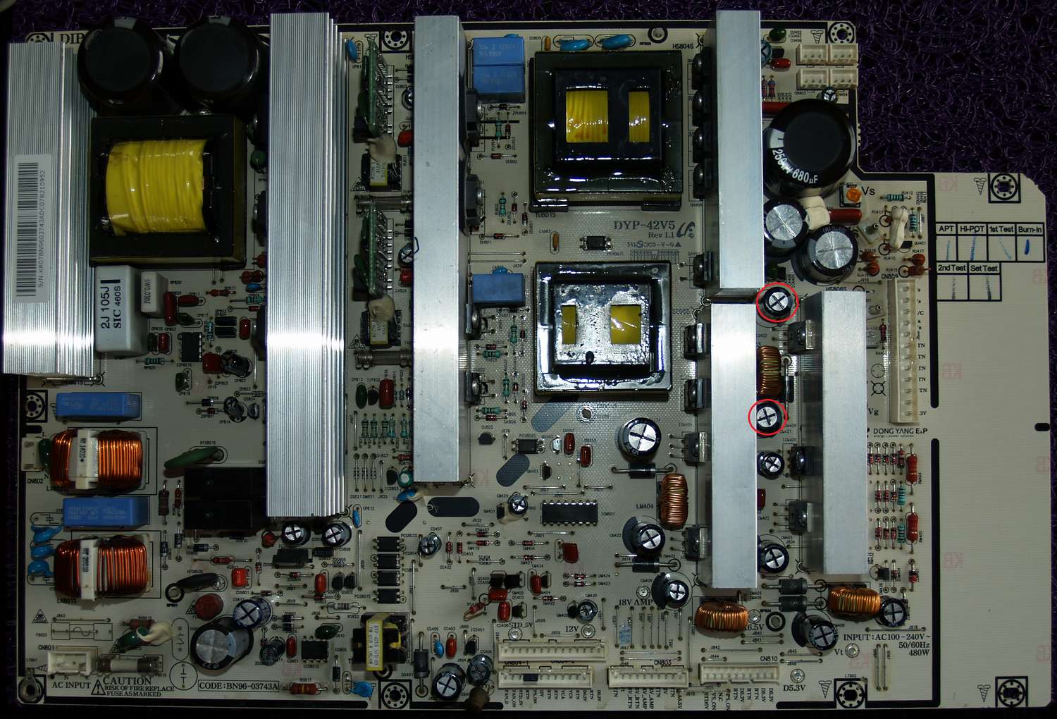

                                  Re: Samsung PS-42Q7HD clicking, blue flashing LED, no power
                                  http://www.ohmsupplies.co.uk/epages/...roducts/KIT156
                                  I spotted this repair kit this for the fault... Three of the components from this list were blown on my TV (I replaced with exact matches) and I tested all of the rest of the components out of circuit which were all fine. But I will work back along the line, starting with the voltage on the main 450V filter caps..... say goodbye to another ten hours
                                      Nah, that's not the one Tom...
                                      BN96-03743A is the PSU in my one.. I've spent a couple of hours searching for it.. but came up with nothing.
                                      It looks like this
                                        BN96 is the assy num, but the blank board is BN44. But it doesn't match. Close, but slightly different. I'll have another look around.
