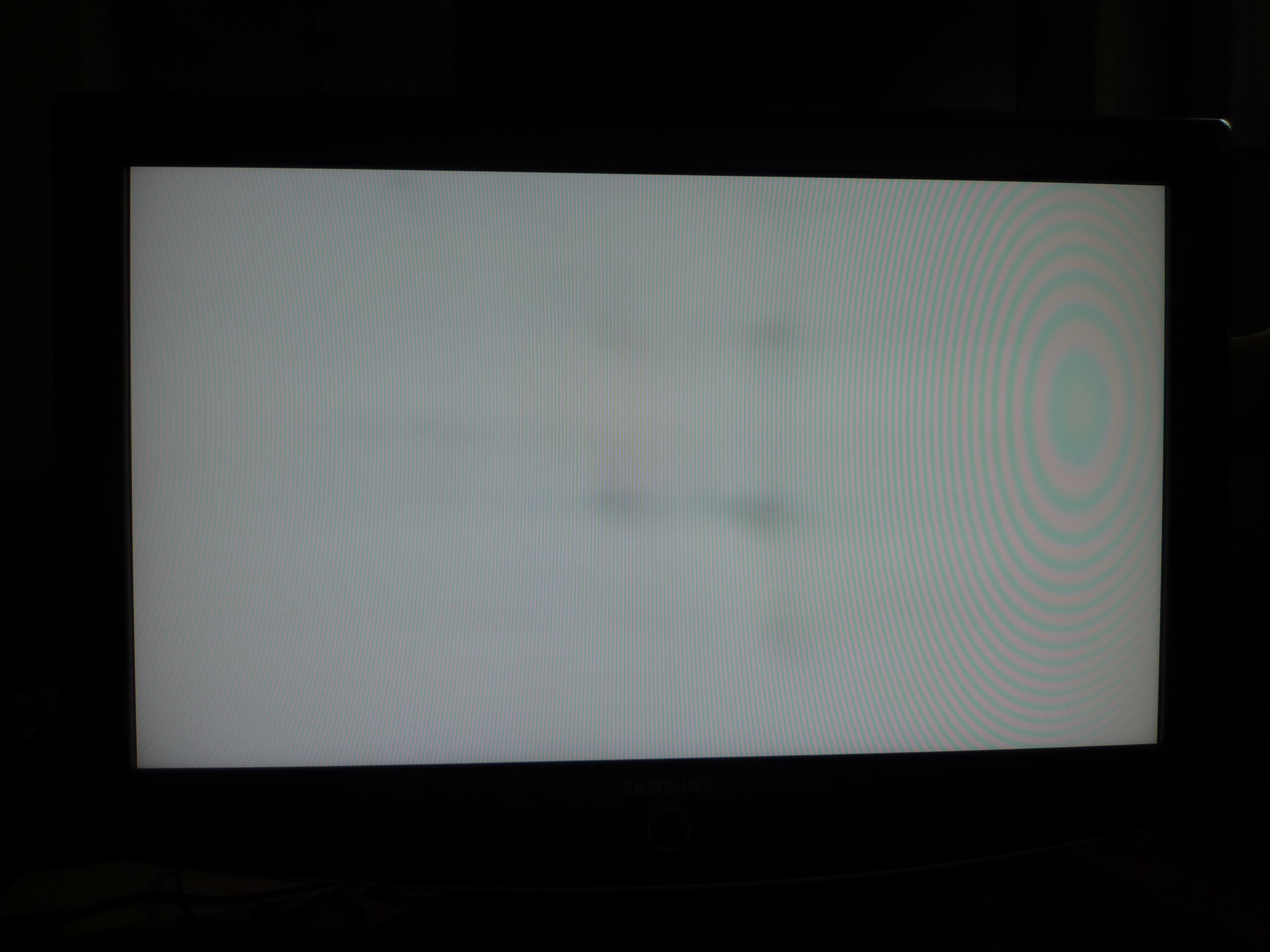

    Hi guys, was given this Samsung LCD TV by a family member because it would not come out of standby which turned out to be a faulty T-Conn board. The TV is now fully operational but has some very slight screen image retention, apparently caused by a SKY logo or something? This image was present before the repair. If I were keeping this TV it would not bother me too much as it's very slight but I'm looking to sell it on.
    My question is, is there some way of rectifying this problem?
    Model number: LE32R87BD
    Year: 12/29/2007
    Thanks,
    Al.

    It will go away usually in a couple of days - LCD burn in is usually temporary.
    If the T-con was faulty and held the image static for a long time (without the AC reversal a working T-con provides) - it may have electrolysed the LCD (which only takes 10-20 minutes before visible burn in appears.) You can try applying strong flashing patterns to the screen to attempt to fix it, but there are no guarantees.

                                • AlbertRoss
                                  • Jul 2012
                                  • 181
                                  • United Kingdom
                                  Re: Samsung LCD TV Screen Image Retention / Burn-In
                                  Not sure if you can see the image I'm talking about in the photo? In the middle of the screen, the image looks like a square box of circles?
                                    Looks more like mura, defect in the LCD itself.
                                    • AlbertRoss
                                      • Jul 2012
                                      • 181
                                      • United Kingdom
                                      Is it repairable of terminal?
                                      • multimeter
                                        • Jan 2011
                                        • 739
                                        • united kingdom
                                        that is mura,not image retention,your disk wont get rid of that
