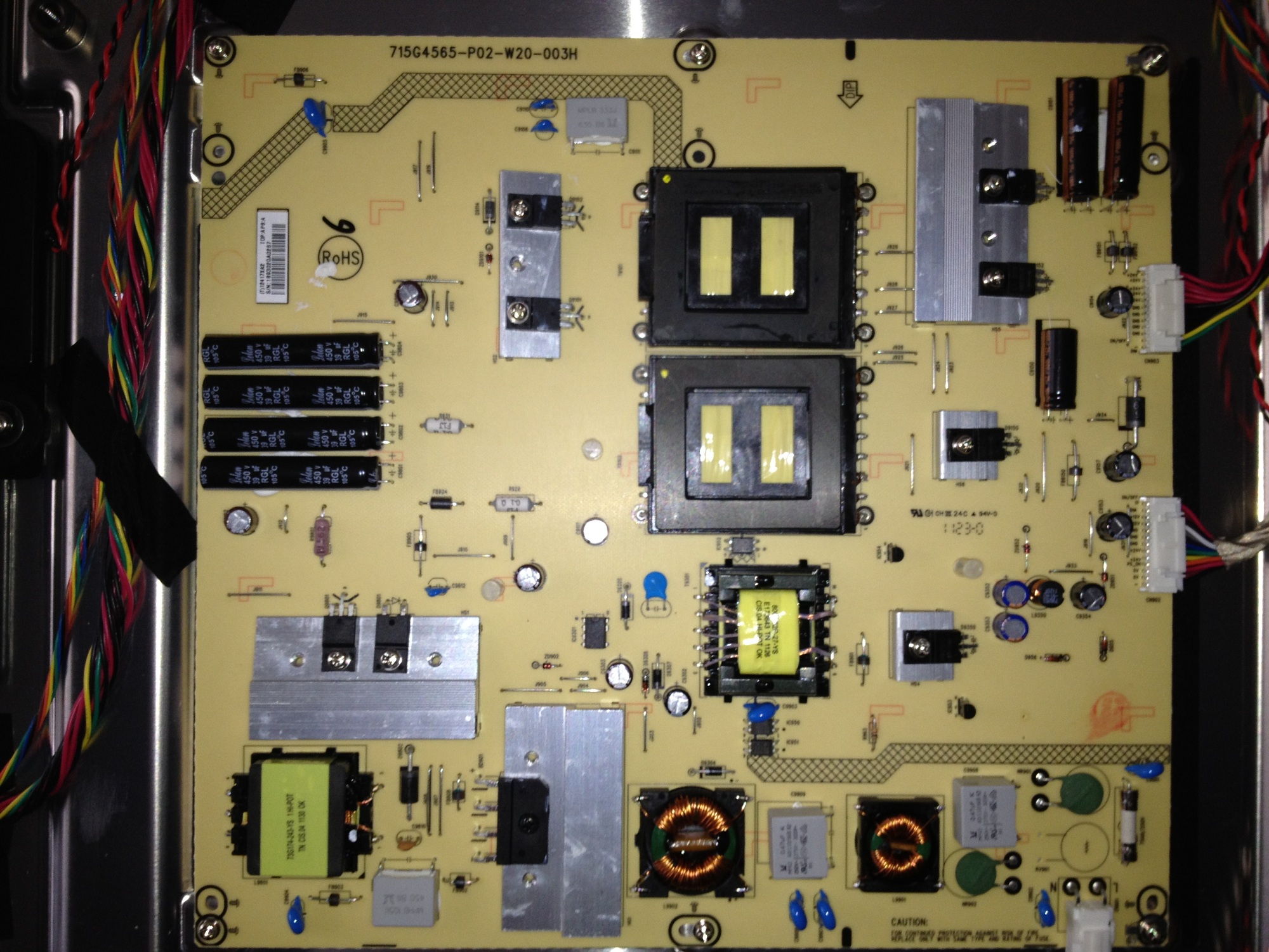

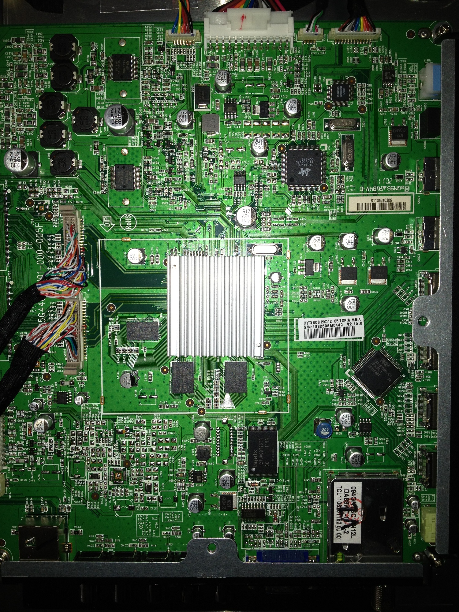

      Re: M3D460SR Vizio 46" LED LCD Tv Power On Problem
      Here are photos of the power supply and the main board. I found 6 regulators on the main board and measured them on standby and power on.
      On Standby:
      U703
      N181 903T6
      pin1 - 0v
      pin2 - 3.31v
      pin3 - 5.29v
      U502
      N352 III7-I8
      pin1 - 0
      pin2 - 0
      pin3 - 0
      U707
      N101 9I2T43
      pin1 - 0
      pin2 - 0
      pin3 - 0
      U702
      N22I GI084-33
      pin1 - 0
      pin2 - 0
      pin3 - 0.32v
      U704
      N22I GI084-33
      pin1 - 0
      pin2 - 0
      pin3 - 0.32v
      U701
      N243 912T63
      pin1 - 0
      pin2 - 0
      pin3 - 0
      TV Turned On:
      U703
      N181 903T6
      pin1 - 0v
      pin2 - 3.32v
      pin3 - 5.22v
      U502
      N352 III7-I8
      pin1 - 0
      pin2 - 1.81v
      pin3 - 3.34v
      U707
      N101 9I2T43
      pin1 - 0
      pin2 - 1.21v
      pin3 - 3.34v
      U702
      N22I GI084-33
      pin1 - 0
      pin2 - 3.35v
      pin3 - 5.17v
      U704
      N22I GI084-33
      pin1 - 0
      pin2 - 3.34v
      pin3 - 5.16v
      U701
      N243 912T63
      pin1 - 0
      pin2 - 1.21v
      pin3 - 3.35v
          All those readings suggest the voltage regulators are working.
          On the power board, there are two connectors. List the legend and the measured voltages when the TV is on.
          One of the pins is PS_ON. PS_ON is a signal from the main board telling the power supply to come on. You may want to press the on/off button several times and note the readings on PS_ON each time.
            Here are the measurements while the TV is on:
            13 - 0v
            DIM - 0v
            +12 - 12.00v
            +12 - 12.00v
            Gnd - 0v
            Gnd - 0v
            Gnd - 0v
            +24v - 23.7v
            +24v - 23.7v
            pS-on - 1.85v
            5v - 5.23v
            5v - 5.23v
            Measurements when I press the power button and the TV doesnt turn on:
            13 - 0v
            DIM - 0v
            +12 - 12.15v
            +12 - 12.15v
            Gnd - 0v
            Gnd - 0v
            Gnd - 0v
            +24v - 23.9v
            +24v - 23.9v
            pS-on - 1.85v
            5v - 5.26v
            5v - 5.26v
            When turning on and off the TV, the PS_ON pin reads 1.85V and as press the power button to off, it takes a couple of seconds and then the pin reads down to 0.030V. Turning on the TV, and getting it to work on the pin goes from 0.03V to 1.85V again when on.

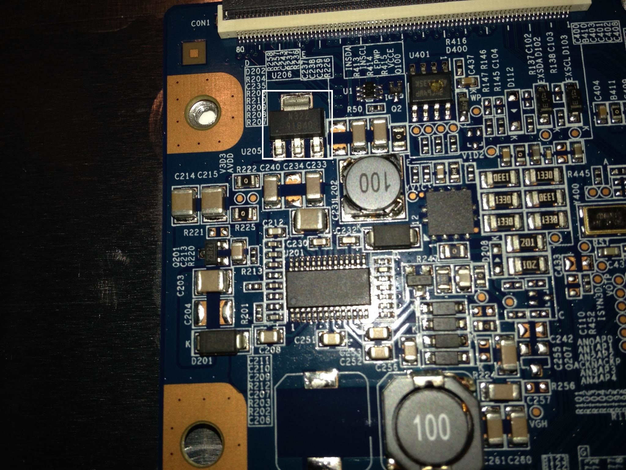

                    Hi, I just started troubling shooting this exact same problem on my M3D460SR. All the voltages outlined above are similar to mine. I looked at the LED T-Con board T460HB01 and found another component that looks similar to a voltage regulator, however I cannot find the component searching the web. It is U205 and the IC has "N322 9184D" on the top of it. This component can not be found on Digikey or general google searching. Can anyone verify that this is a Voltage Regulator? It has the same form factor as some of the others. See picture for details.
