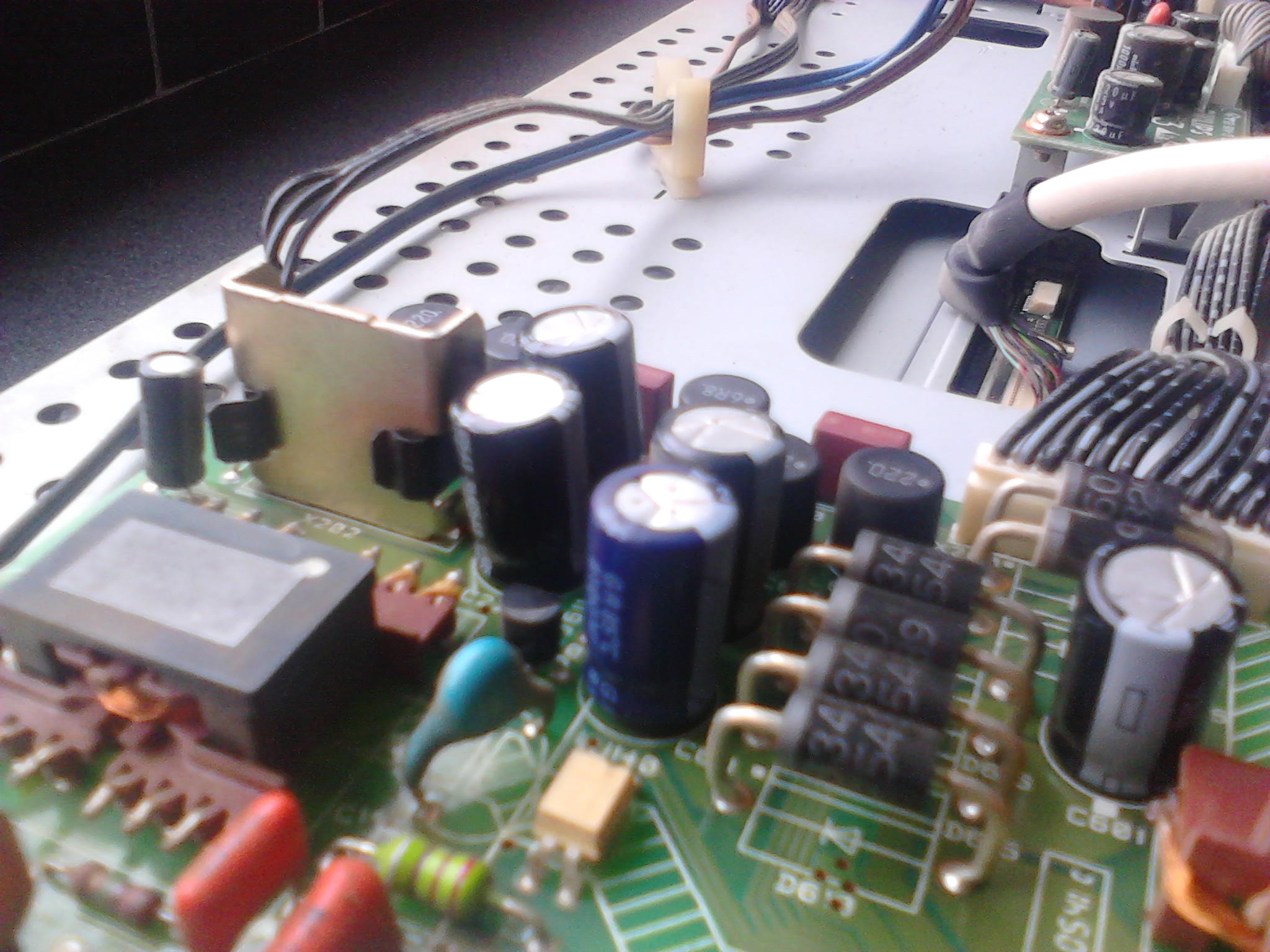

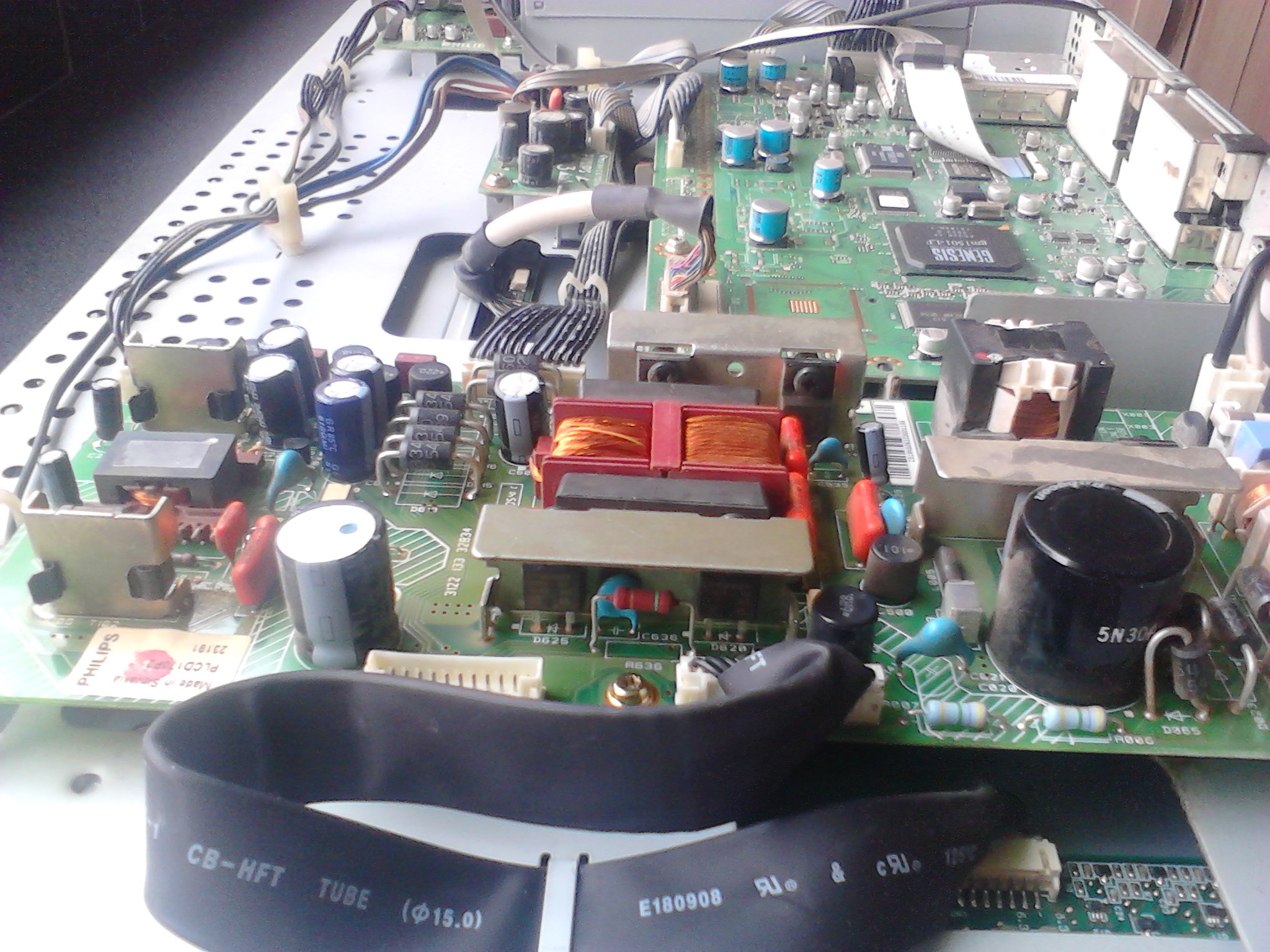

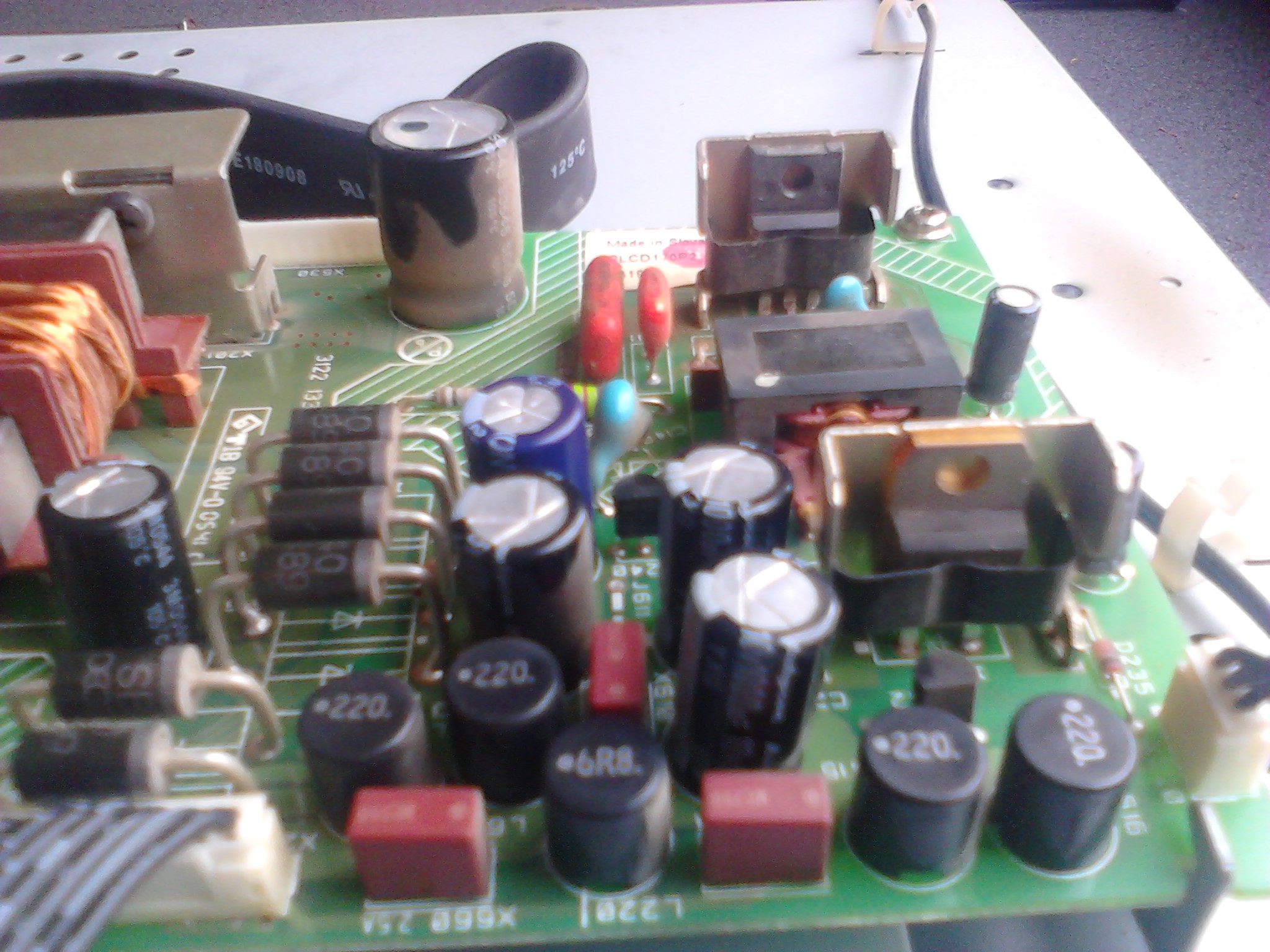

    philips 26" PLCD170P2 Slow at turning on.
    Hello again Guys.
    My bro in laws tv used to take around 45 mins to warm up before you could switch it on, but then it started taking longer so in the end they just left it on standby all the time so it would switch on when they wanted it on.
    So i asked him to switch it off at the wall and leave it over night, the next day it wouldnt come on, 3 hours later and still no life.
    I have got the tv now, replaced a couple of caps, plugged it in and it came on.
    So i left it over night, tried to switch it on and its dead. So i put the original caps back, plug it all in and it comes on???
    I noticed yesterday that if i remover the ribbod going to the inverters it will switch on, then plug the inverters back in and it will power on again?
    Am i right in thinking that its a bad cap not charging properly?
    Some pics to show you the board.
    The blue cap is one i have put in.
    Also, all the caps are RUBYCON and Nichicon.

    Re: philips 26" PLCD170P2 Slow at turning on.
    1) What brand and series did you use for replacements? The type of capacitor matters.
    2) Why just 2 caps? Were the old ones bulged?
    3) We will need pictures of the inverter boards.
    4) We want clear focused pictures in this composition
    https://www.badcaps.net/forum/showpo...94&postcount=1
    In fact, please retake pictures of all your boards with the above composition.
    5) The length of time it takes to turn on could be caps with high ESR (ohms). As the set warms up, the ESR drops allowing the TV to work.
    Even the best caps can be cooked as we have seen cooked Rubycon capacitors in Dell SX 280s (4 of them in my basement), Apple iMacs, etc.
    6) When it takes a long time to turn on, what is the status of the power LED? Is it green, red, or off?
    7) Do you have a multimeter and know how to measure DC voltage?

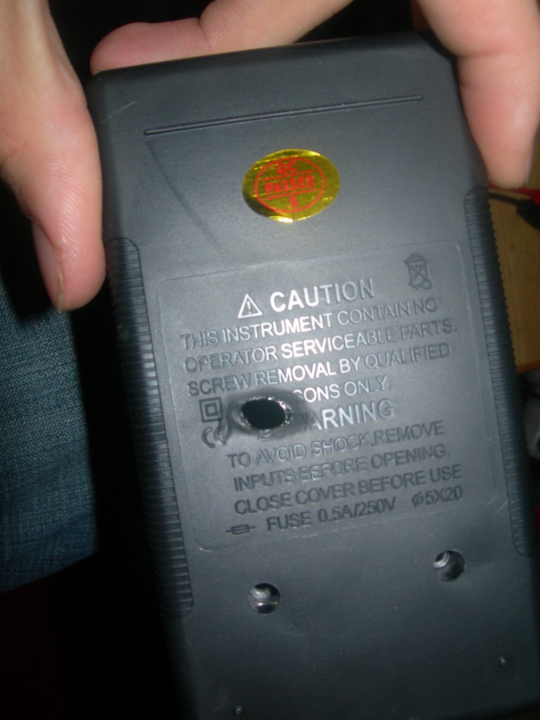

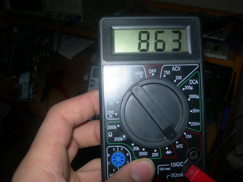

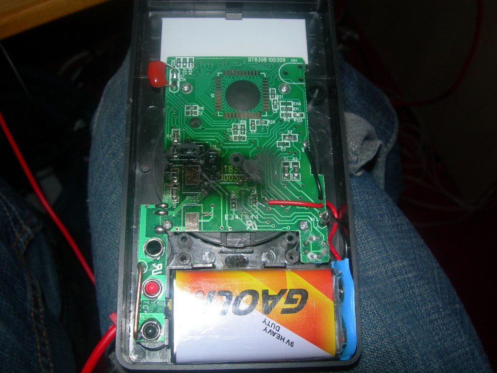

      7. I HAD a multimeter, it was a cheap one, bought it last week and it lasted 2 days. Now when i select a voltage setting the voltage rises on its own without touching anything? The diode setting does the same. I must have cooked it some how. I will get another one on thursday. And yes i know how to use it.
        For some meters this is normal, due to the very high input impedance of a good multimeter. If you short/touch the probes together does it go to zero, also try measuring an AA battery, you should get around 1.55-1.6V new from a packet.
          If i stick it in the 240v plug socket the lcd just dims down, it worked fine when i got it.
          It used to say 1 on the screen if there was no reading.
          Its deaded alright, only cost £5 so i'll get a better one.
          EDIT: Just tried a new aa battery and it just shows 1 on the screen which means no reading. But if i hold the prongs in my hands i measure 40-50 volts dc lol.
            Yeah okay I think that's had it but the build quality of these things is scary anyway, I blew one up all too easily (to this day I'm still not sure how I did it!)

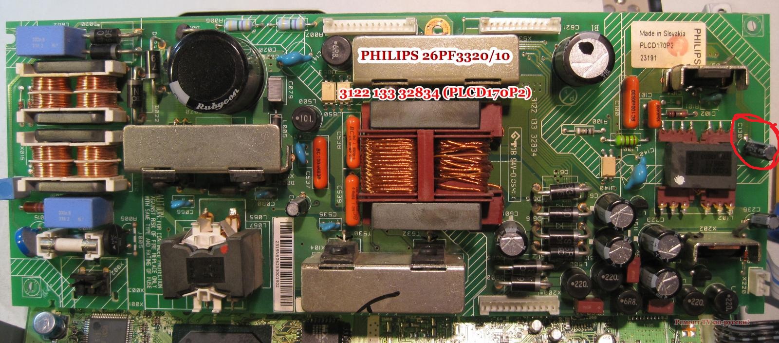

                    Ok, think i have fixed it.
                    I have circled the problem (CAP C130).
                    I warmed each cap up with my fingers then plugged the tv in, This cap when warmed up started the tv every time.
                    It is a Rubycon 25v 100uf. I have replaced it with a Teapo 25v 100uf cap from a pc psu. I let the tv sit for 30 mins then plugged it in and it came straight on.
                    I will now let it sit for an hour and let you know how it goes.
                    (I have got the pic from google images but its the same power board).
                    Also Retired caps, i am not sure if it was a low esr i put in it but i had to use what i could find. I am going to buy the full set of caps for it and do it properly. Mouser charge £12 delivery???
                    I know you will probably want to slap me but i have to ask, are these ok to use? http://cgi.ebay.co.uk/ws/eBayISAPI.d...r=560130592374

                      I'm sure I've got such a cap lying around - and a decent quality brand at that. You can have it including postage for £1.
