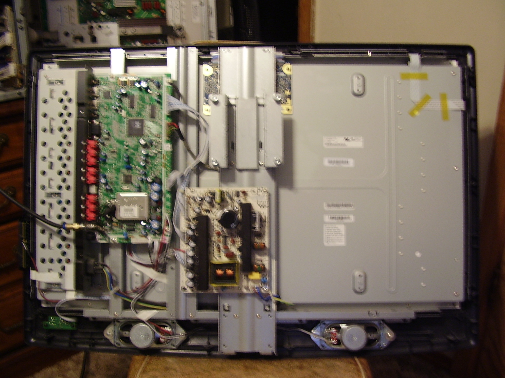

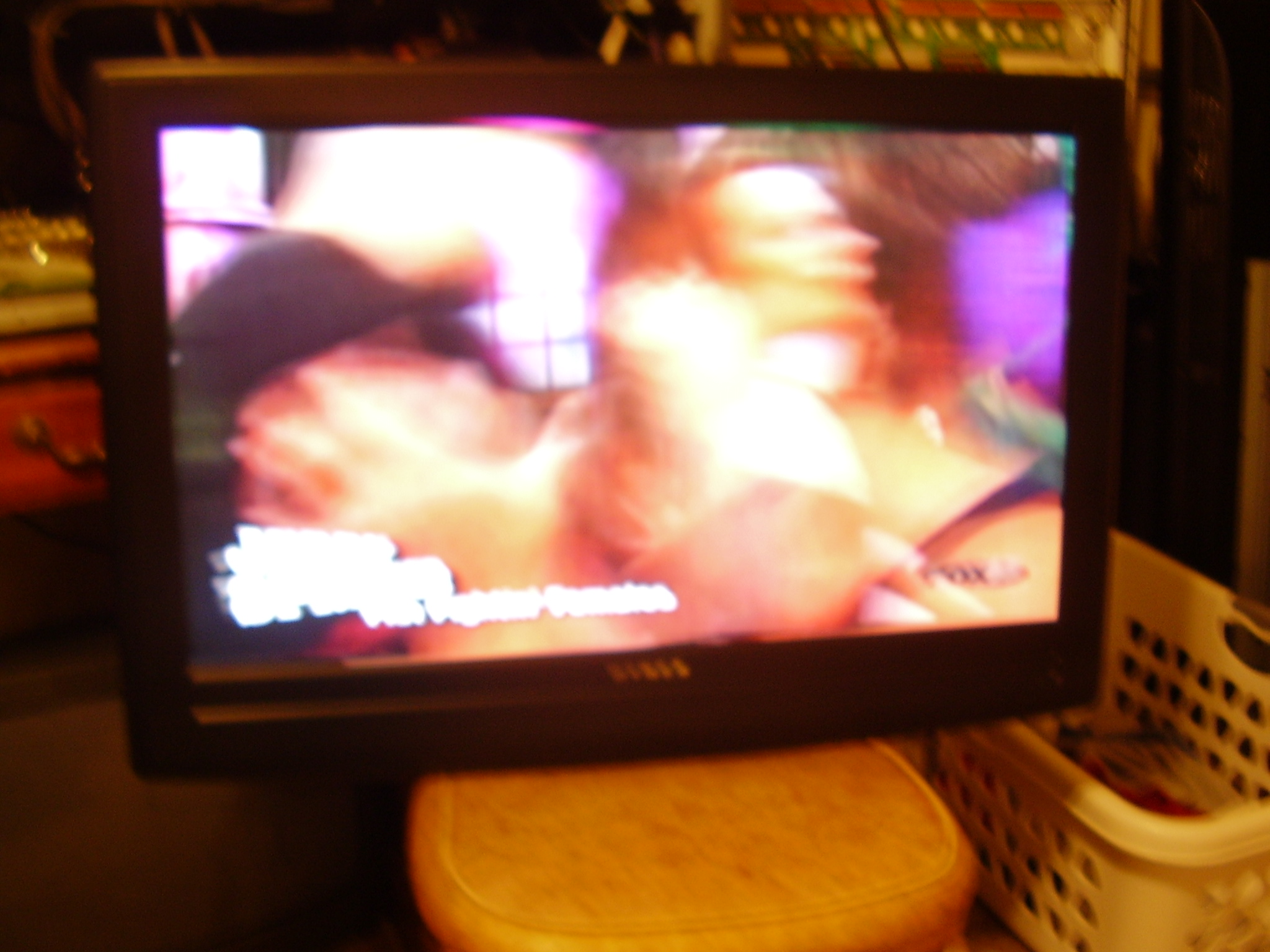

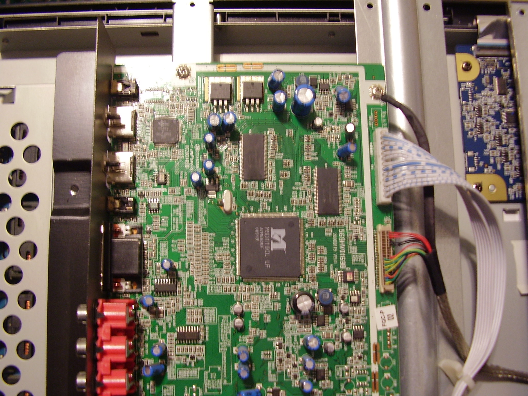

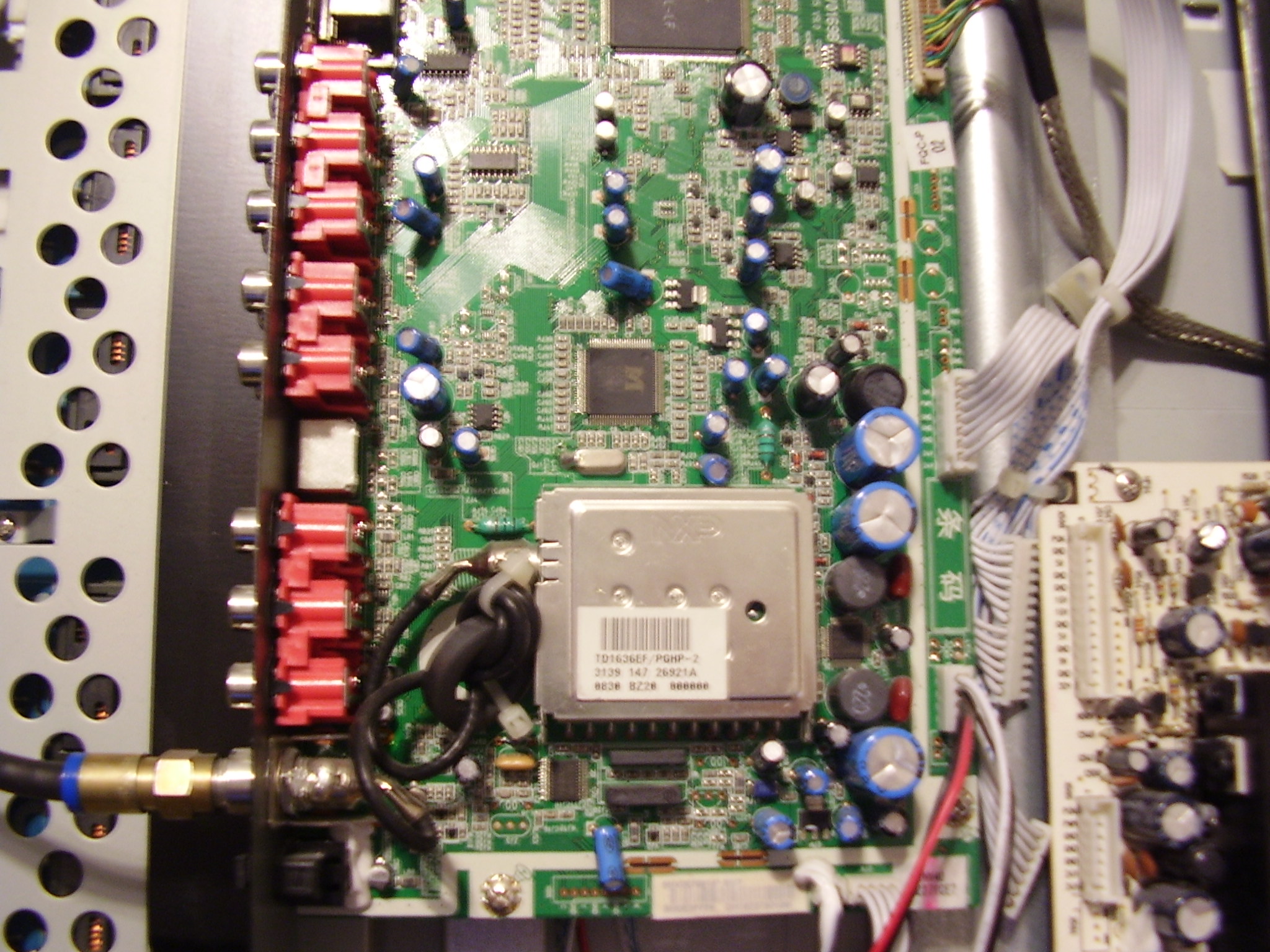

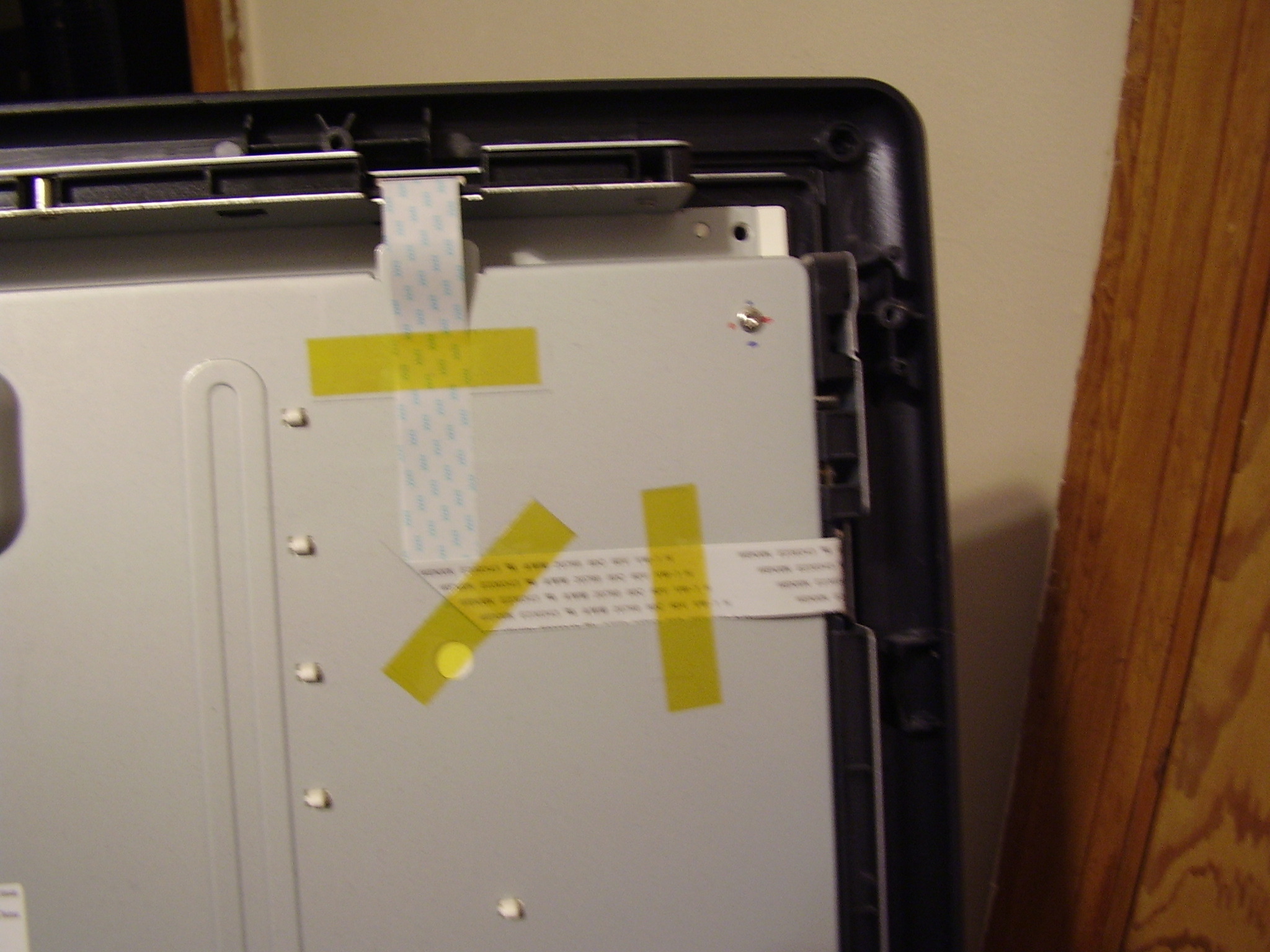

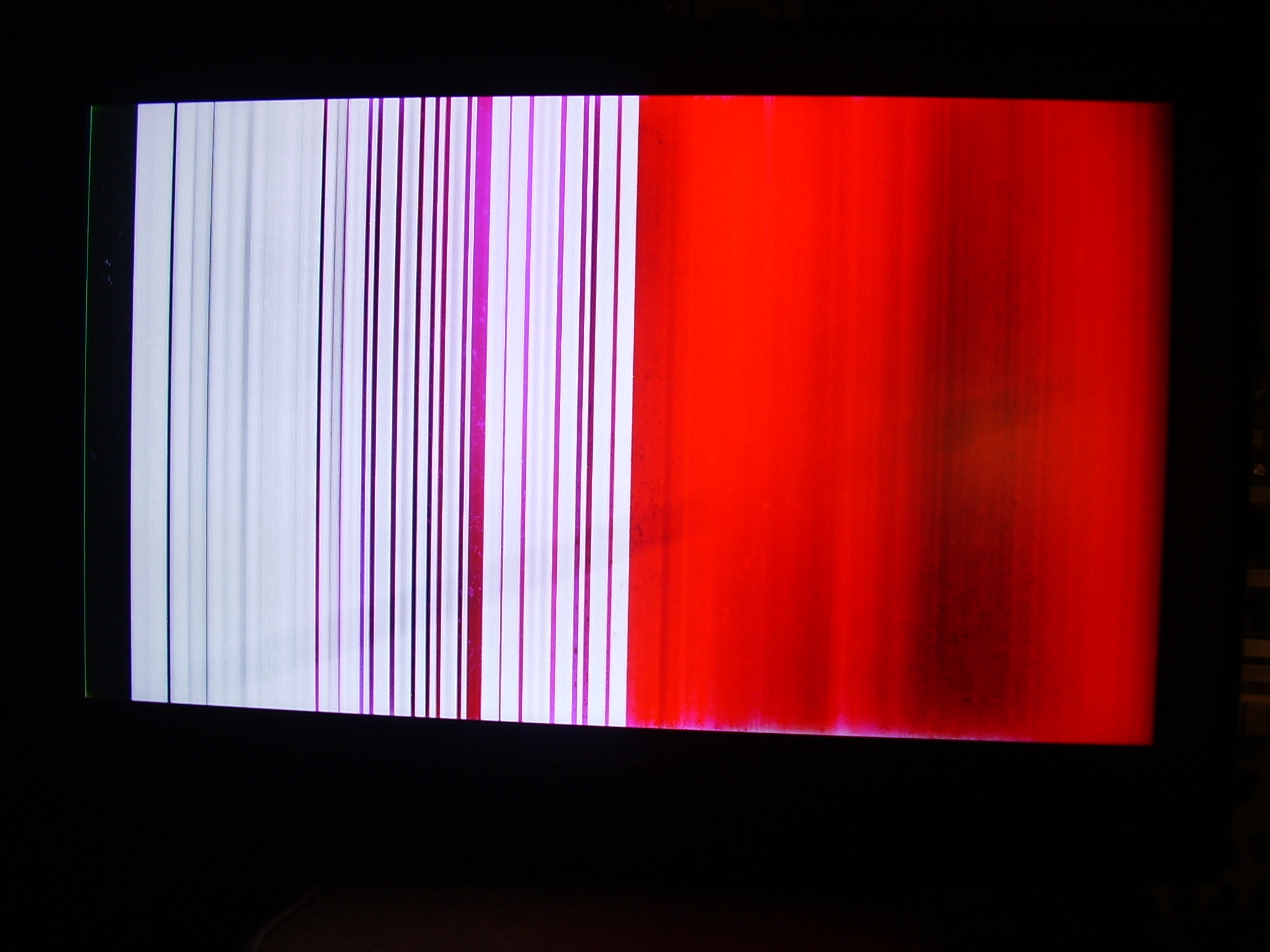

    I picked up this tv from a couple that said when they went to hook up the cable box it sparked when the cable made contact with the threaded part on the tv. Now when its turned on it will have good sound but multicolored vertical lines that move and when i tap on the plastic case it will flicker like there is a loose connection. If i keep tapping it will show a picture but fades in and out with the lines but it seems after it warms up it will hold the picture without any problems. I have tapped on each board to try to maybe isolate the problem but to no avail. Any ideas where to go from here? I took some pics that might help.

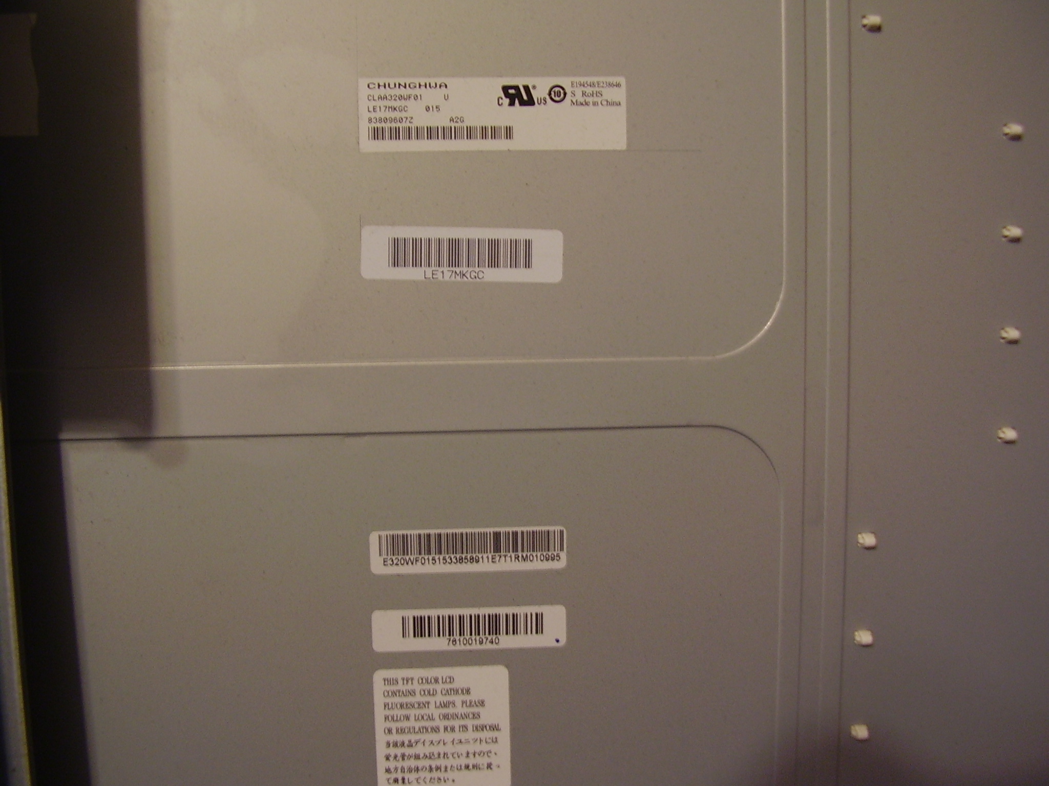

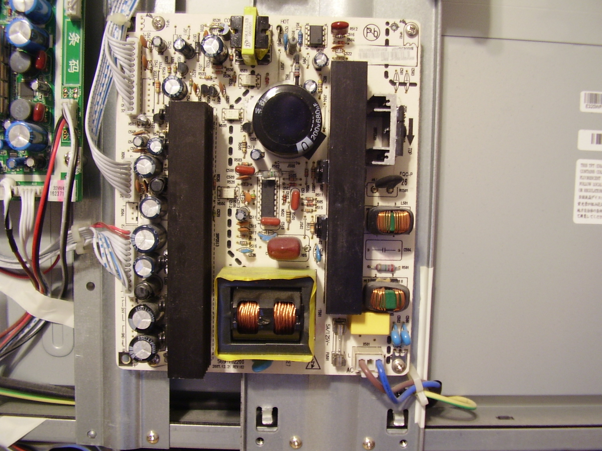

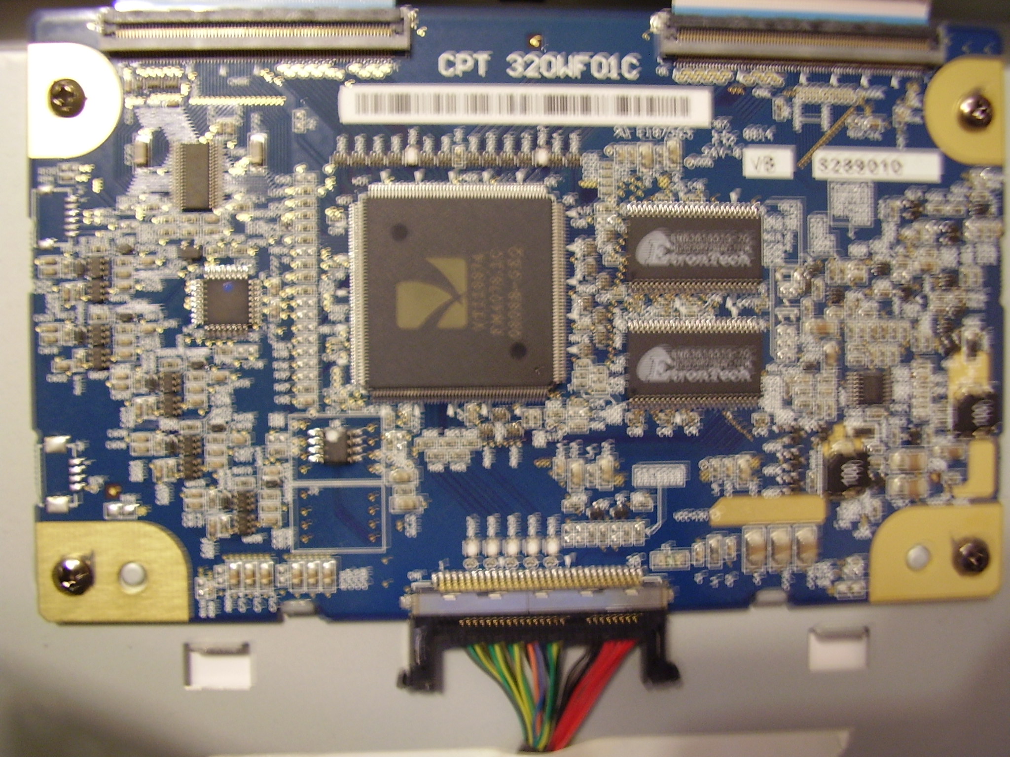

    Re: Dynex DX LCD32-09
    more pics
      Reseat and clean every connector inside the TV including the front panel buttons.
      Check every screw on every panel to make sure they are secure and not loose.

        I cleaned all connections and tightened every screw but still the same result. I have noticed if i slightly tap on the tuner it will make the distort the sound and i will get the little squares in the picture and it will freeze but just momentarily. Also get the same distortion when i touched the inputs with a screw driver.
          Just a shot in the dark, the tuners metal case should be grounded somewhere on the circuit board. Sometimes it is a solder connection. Try re-flowing the solder joint. I had a tv one time with a problem with the tuner ground.

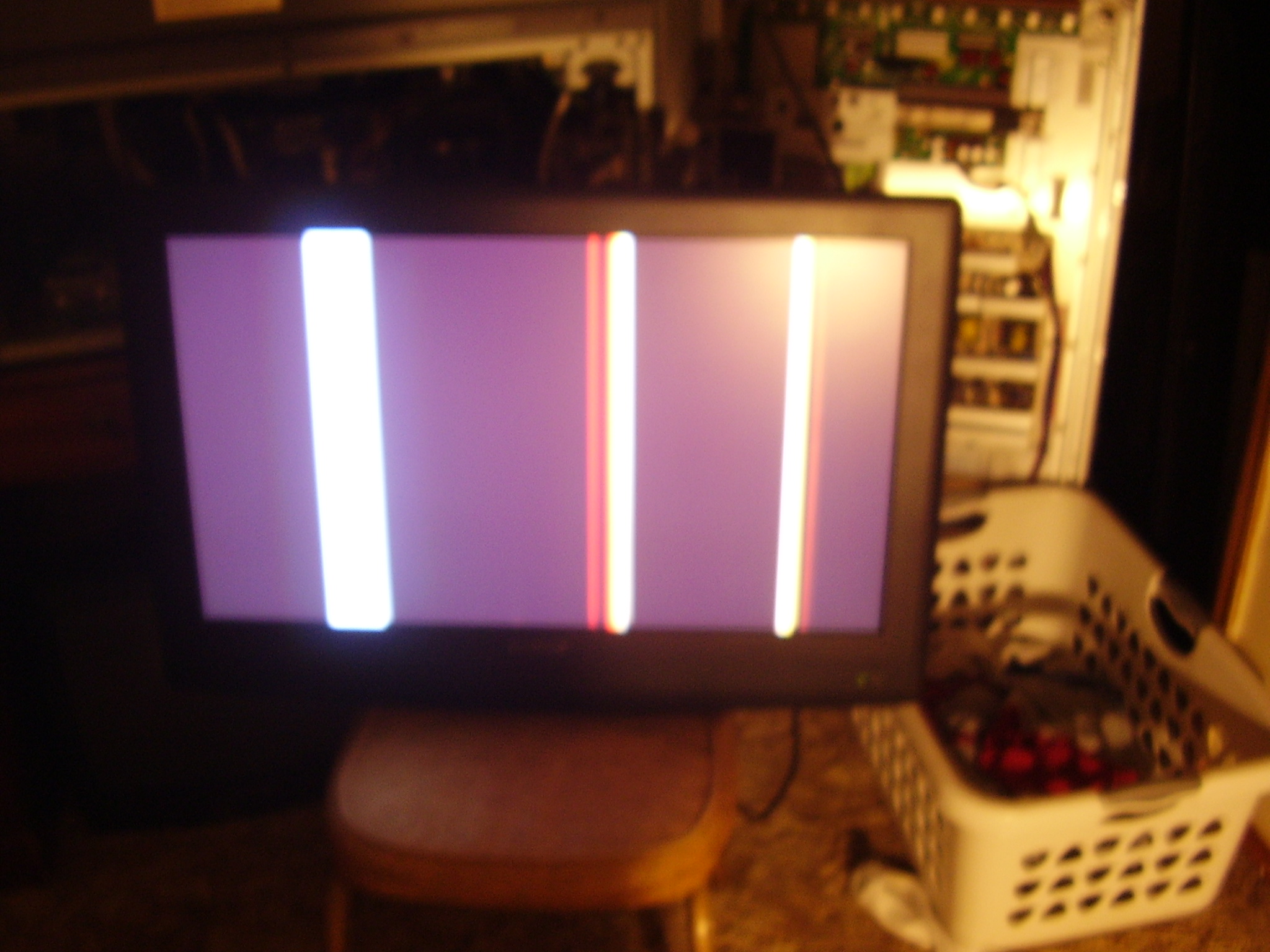

            I was checking for readings at the tuner and the probe slipped and i got spark and now i have no picture at all, Still have good sound and the backlights come on but no display. I tryed a different board and with that i only get a flashing red power light with clicking sound coming threw the speakers. Any suggestions on what could cause the issue?
