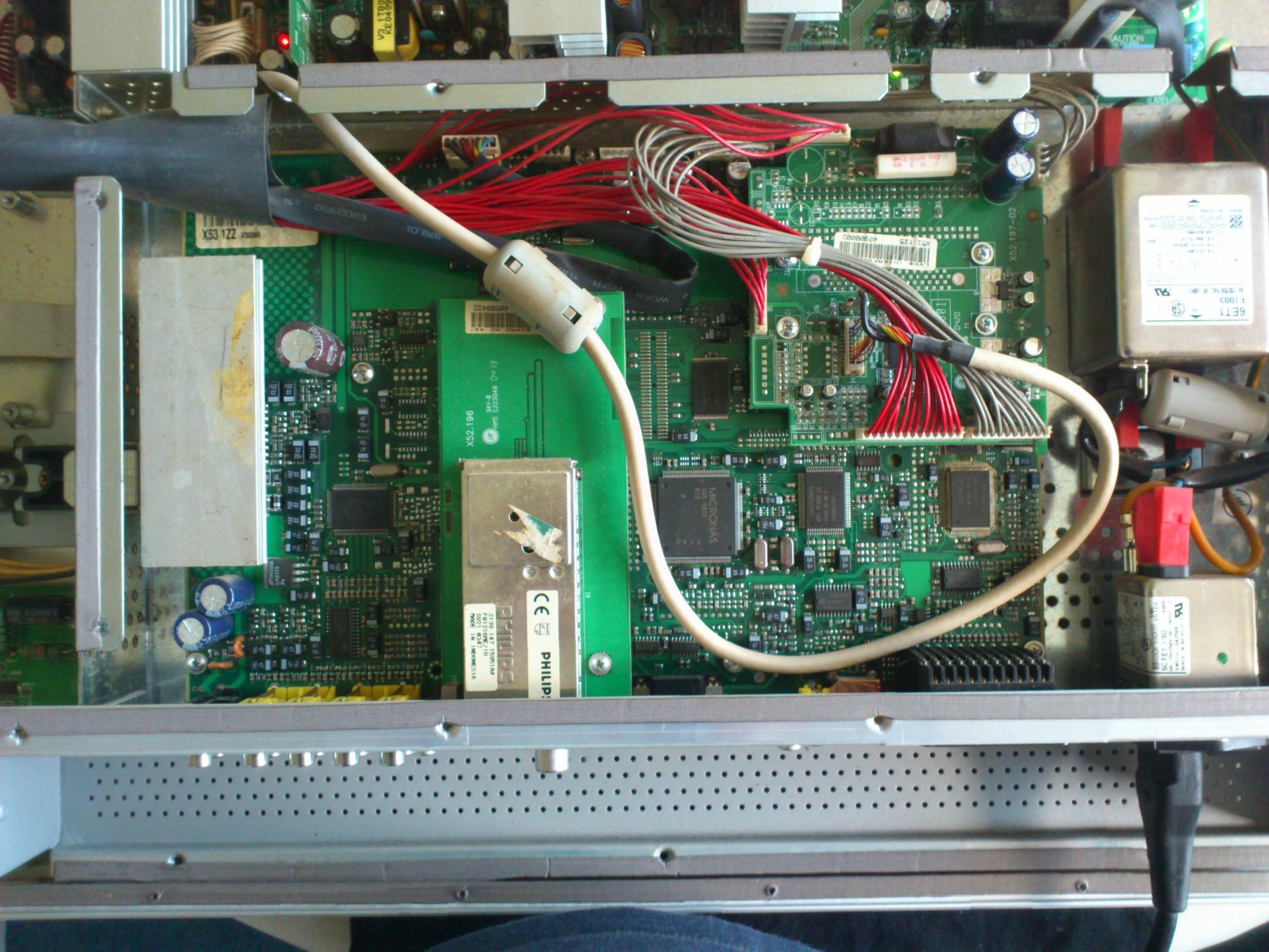

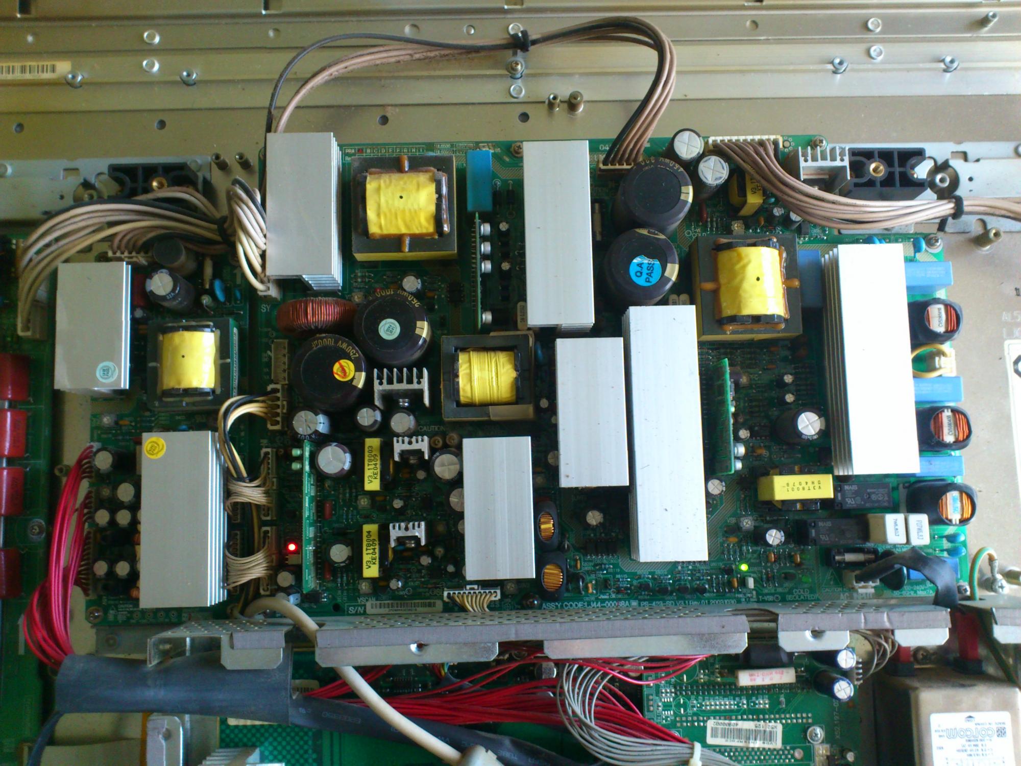

      Re: Goodmans 42" Plasma standby to green but no pic - help me!!

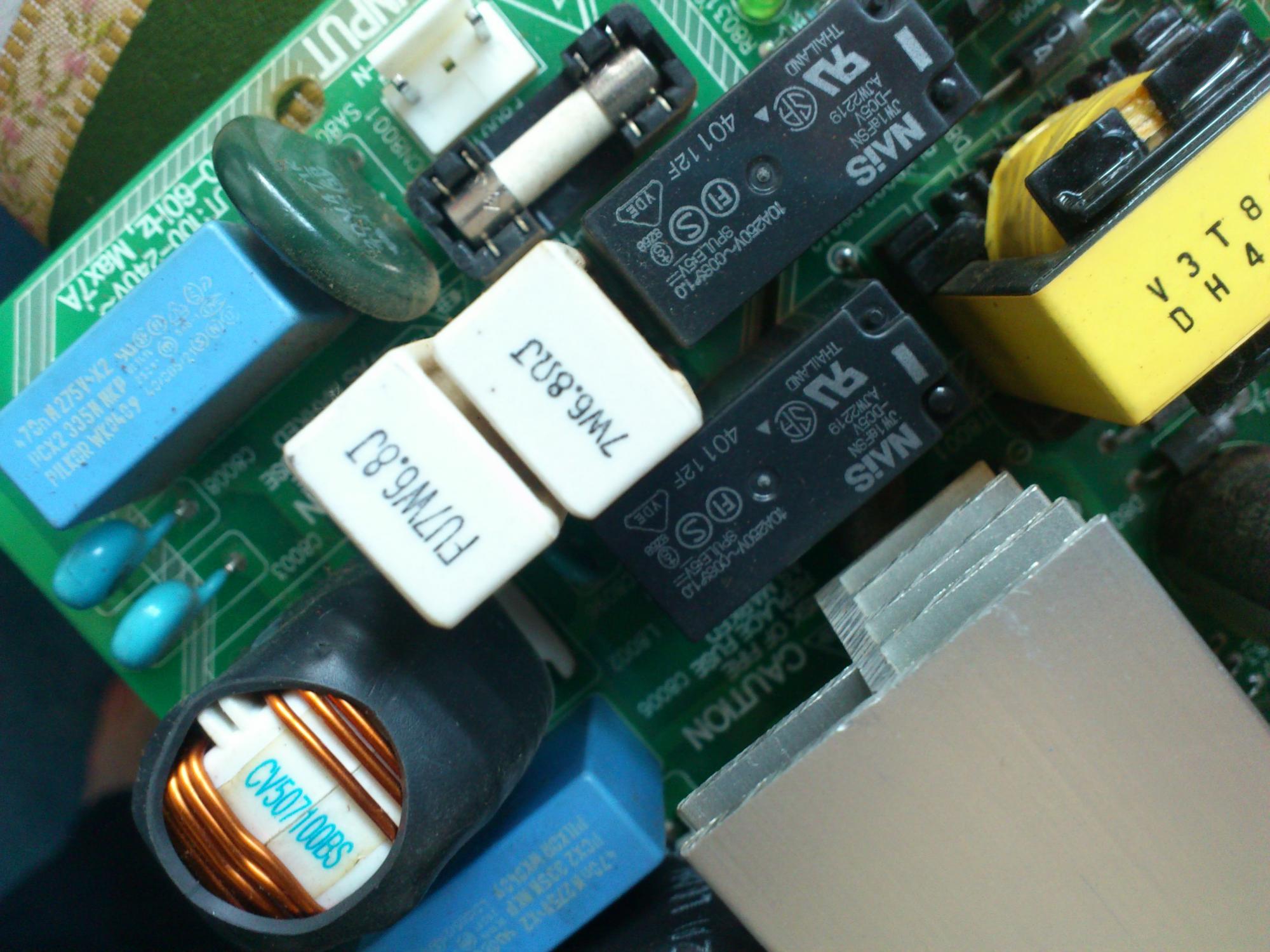

      its just took me 45mins to get these pics available for upload!! stupid phone!
      the green lights are when tv is switched on, then i hear a relay click then the red light on the far left of the board comes on (power board)

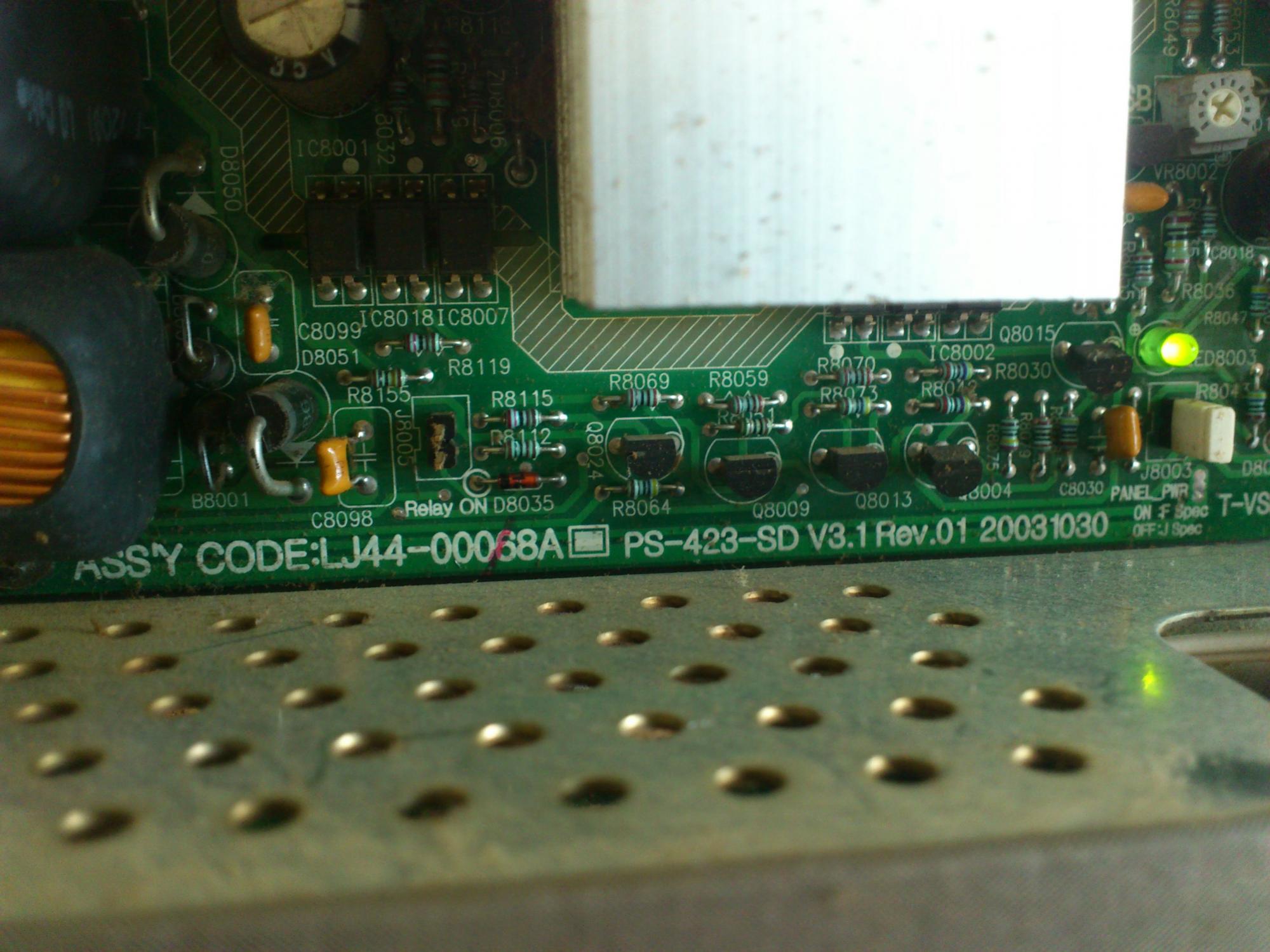

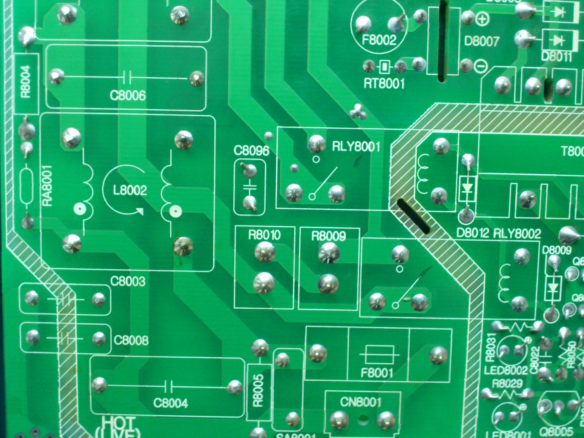

          R8010 is blown ceramic fuse, but just trying to see whats caused it.....any ideas guys?
          i cant find Q8016 and Q8018 any one point me in the right place??

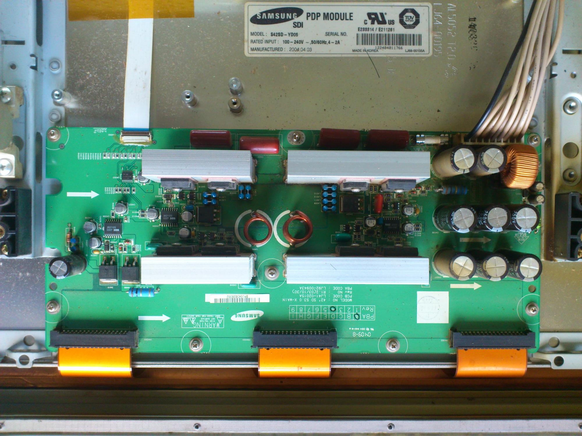

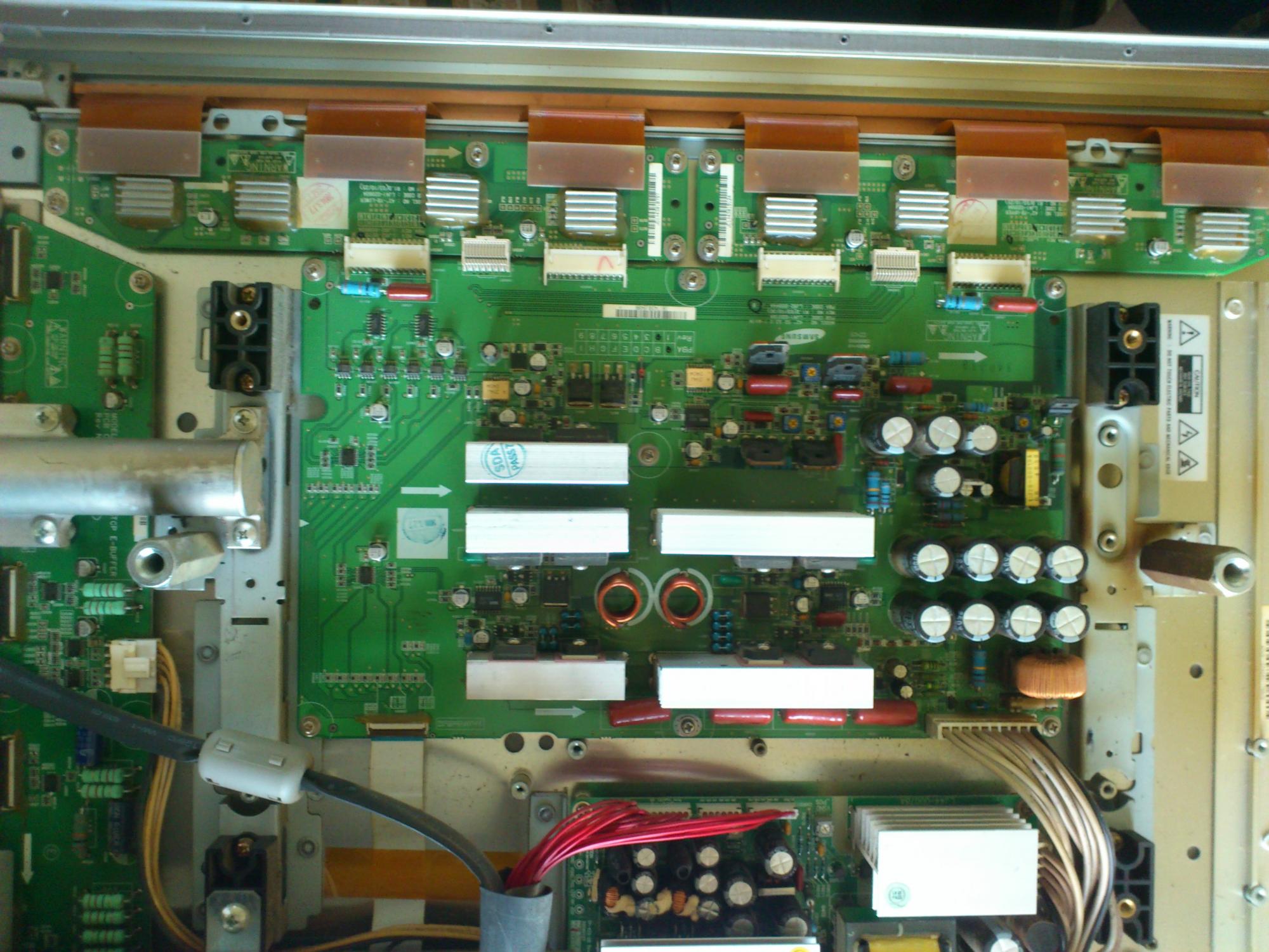

            Okay, Samsung PDP.
            You'll have to point out the fuse for us.
            If the fuse is blown on either sustain board, I would normally consider it an expensive repair. It may simply be the fuse ageing, but it is more likely a failure on the board in some way.

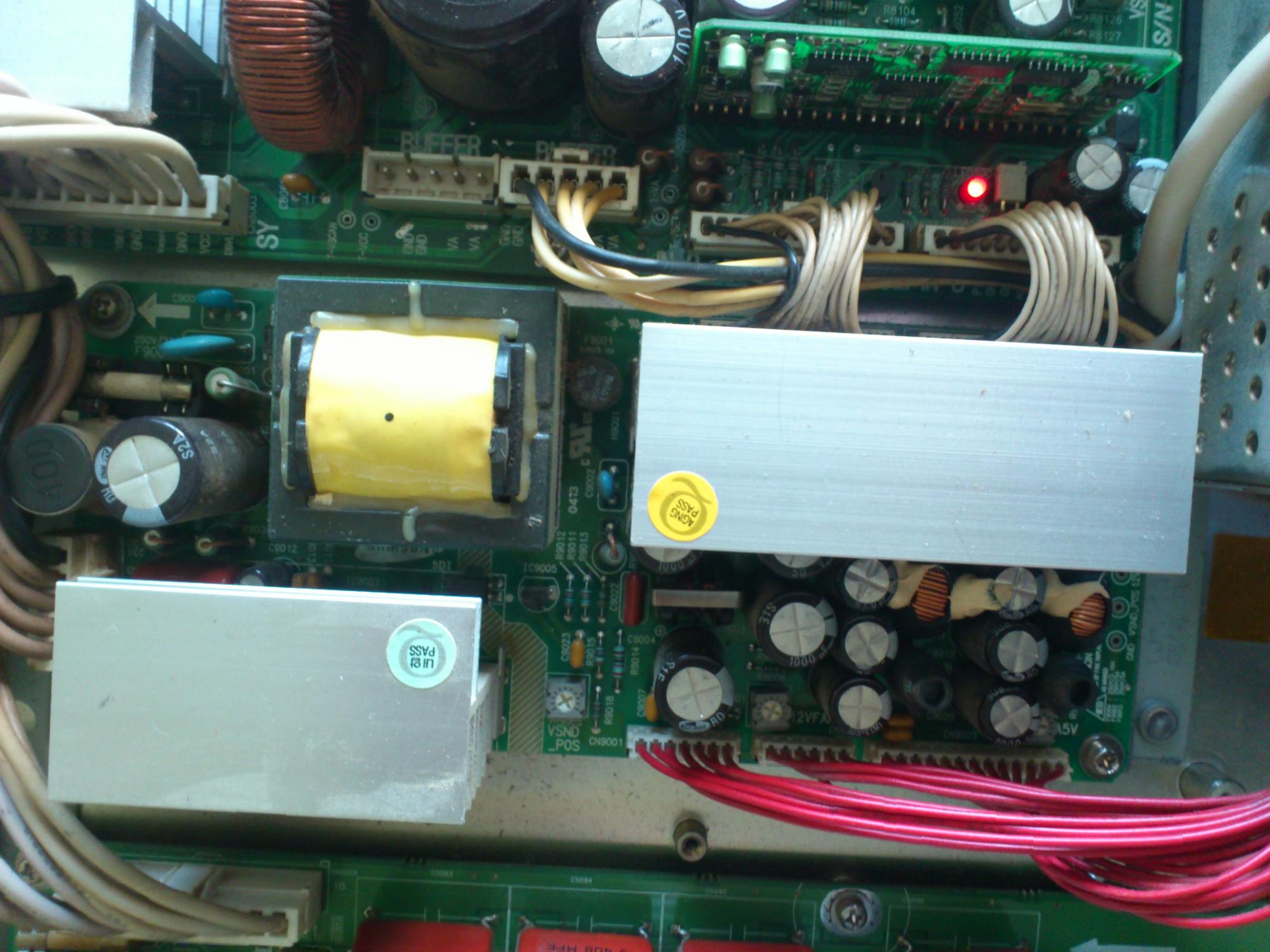

              on the power board to the left are 2 white ceramic fuses far left, its not letting me upload the edited photo, its the one on the left thats gone, there is a repair kit that contains these and 2 big transistors, but i cant find the transistors on the board? ill up load a closer pic after ive eaten my diner
                found them..... tested and there both ok, so im thinking maybe its just the ceramic thats gone....fingers crossed, if anyones got any other ideas of what to check before i order them it would be helpful
                its R8010 thats blown, which is the ceramic on the left of the first pic

                      Should only be those resistors but could be a shorted fet on PSU.

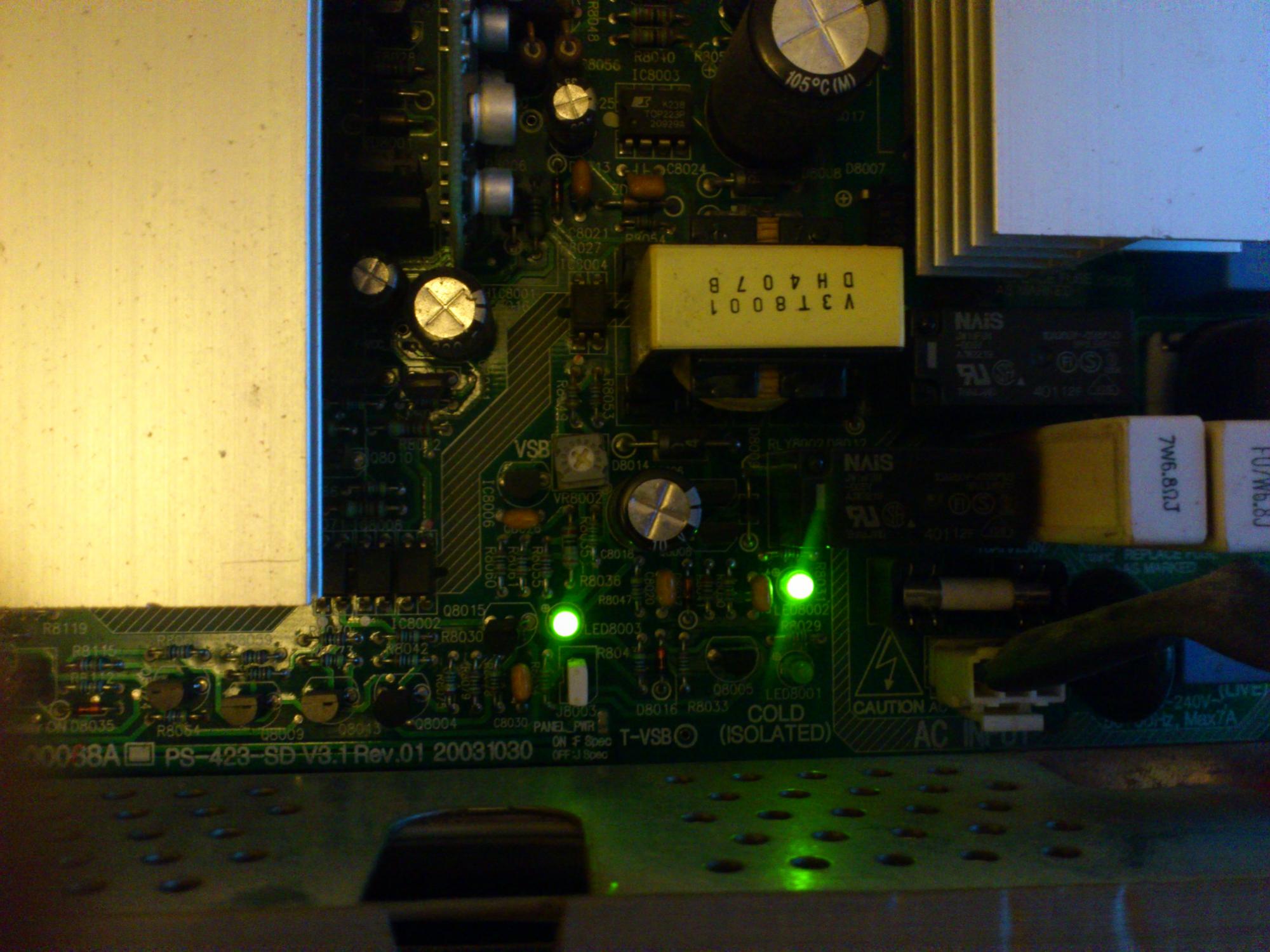

                          fitted resistors just now, and 3 green lights on the board come on then relay clicks and the red light comes on and the 3rd green led goes out, are all the voltages on these DC i mean the feeds to the other boards?
                          its as if its waiting for a signal for something then when it doesnt recieve it its clicking off, the green light on the front of the tv stays on green though

                                    Try testing Vs and Va without Y and Z sustains connected.
                                    Vs and Va are independent supplies; they shouldn't influence each other.
