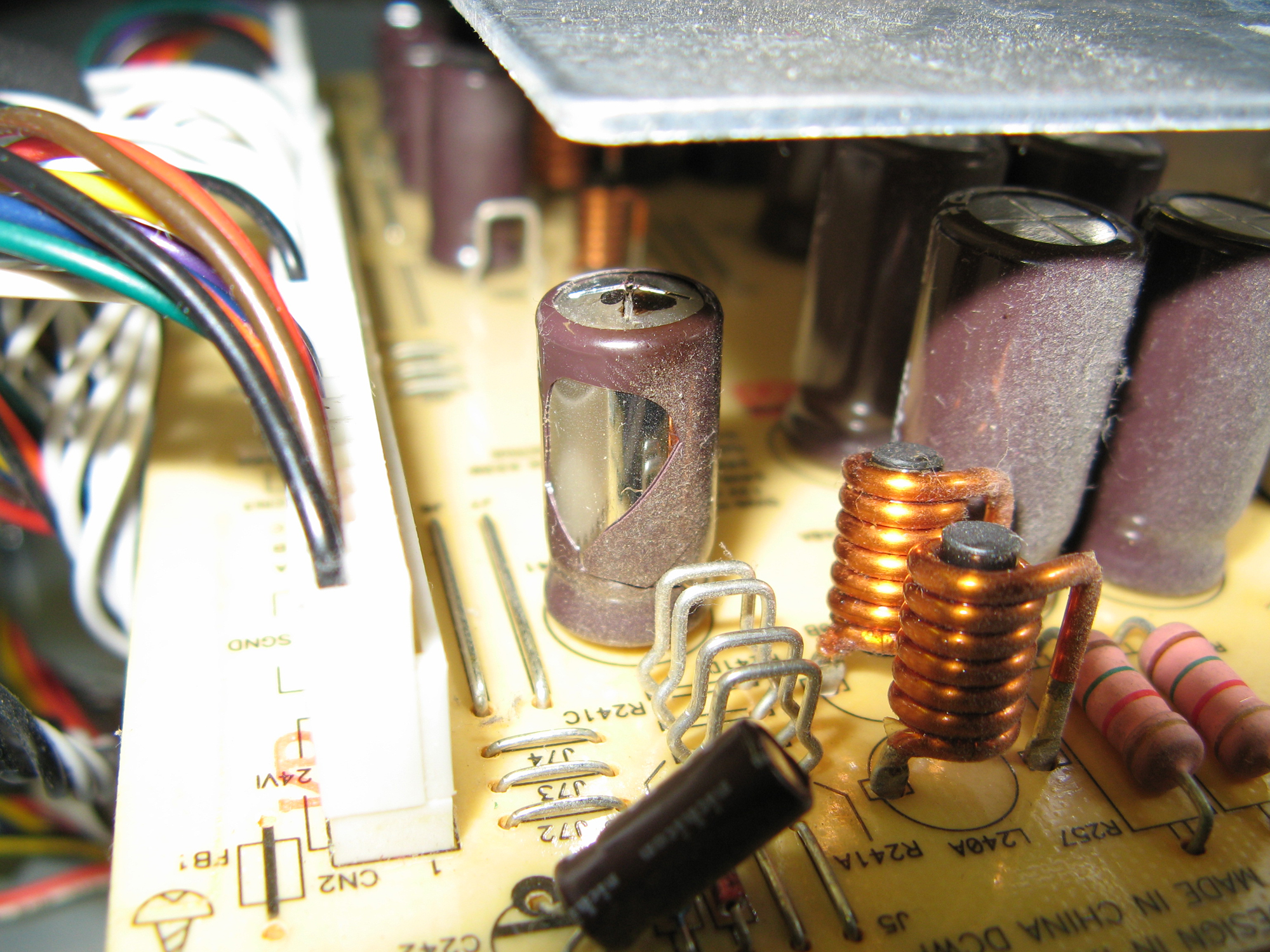

    Re: Help- Vizio VW42L HDTV10A
    Success!
    I also found an offending bulged capacitor under the power supply heat sink (470uf 25v).
    The tv powers up and works great! I attached a picture for your reference.
    Thanks all!
