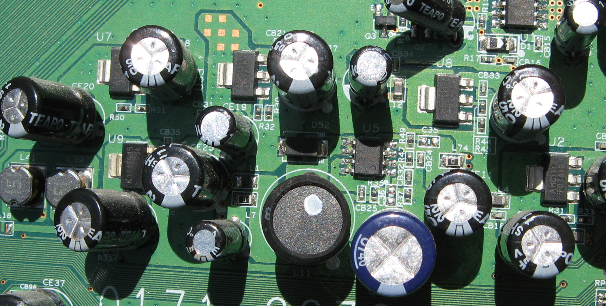

                  Plugged it in, hit the power button and took the following voltage readings:
                  U9
                  Pin1=0
                  Pin2=1.5 volts
                  Pin3=4 volts
                  U7
                  Pin1=.03 volts
                  Pin2=1.27 volts
                  Pin3=4.03 volts
                  U33
                  Pin1=2.79 volts
                  Pin2=4.03 volts
                  Pin3=5.10 volts
                  U8
                  Pin1=2.04 volts
                  Pin2=3.28 volts
                  Pin3=5.15 volts
                  Here's a picture.....
                  Thank you!
                  • tibimakai
                    • Jan 2012
                    • 3680
                    #49
                    Re: Help- Vizio VW42L HDTV10A
                    U33 it's bad. Should be 3.3V(where do you have 4V) and it's supplying the U7 and U9 with higher voltage.

                      Know any Digi-Key part numbers for these 4 regulators?
                      • retiredcaps
                        • Apr 2010
                        • 9271
                        #51
                        This is exactly why I always ask for actual readings.
                          Provide the actual part numbers of your regulators. The part numbers in your pics are not readable.
                          --- begin sig file ---
                          --- end sig file ---
                          • Amuyamula
                            • 22
                            #53
                            Amc1117
                            FD7416
                            and
                            K1117S15
                            736
                              Amc1117
                              FD7416
                              and
                              K1117S15
                              736
                              http://www.digikey.com/product-detai...98-1-ND/705738
                              http://www.digikey.com/product-detai...ICT-ND/1301519
                              Now my question to you is:
                              Do you think U9 is still bad?
                                Being a newbie at this, I can only doubt its bad so Im going to swap it out.
                                  Start with post #31 and re-read everything until your first post.
                                    Your #40 post indicates that maybe U9 is bad. Thanks for all your help!!!!
                                      Nope. Your U9 is good. You report pin 2 is 1.5V for U9. The part number tells us that the expected output voltage is 1.5. So your U9 is good.
                                        OK, then I will replace U33 since that isn't outputting 3.3v.
