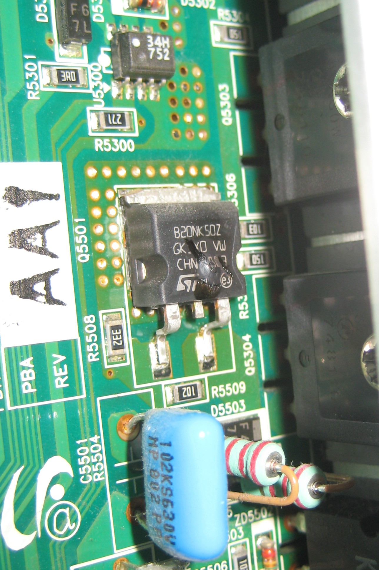

          Well I tried a 72W halogen globe as well and same result.
          Decided to bite the bullet and try it without the globe in series.
          Plugged in the AC, 1 click and silence.
          Tried turning the TV on and got some buzzing from the back of the set, then something went 'pop' with a small amount of smoke on the Y-main board.
          Not sure what the part is in the attached photo (Q5501) - but it doesn't look so good anymore :P

              #86
              Re: 50" Samsung Plasma (model number PS50Q91HD) - possible purchase
              Interestingly, when replacing the bulged 680uf 25v capacitor on the Ysus board, I did notice some dark/brown patches underneath Q5501 which is now blown - so this mosfet has obviously been running hot.
              From what I've read, I should be able to replace this mosfet, however will need to most likely replace both Y buffer boards?

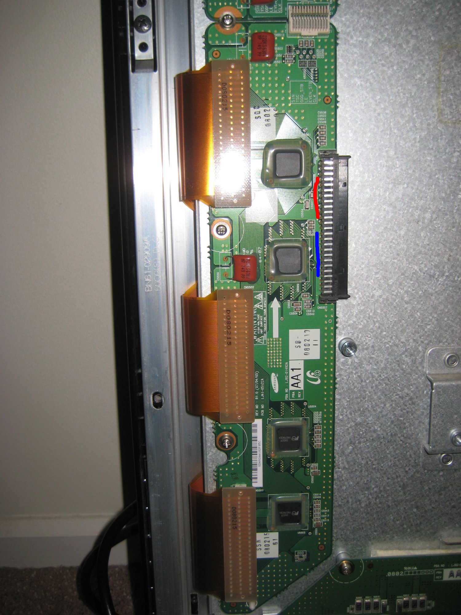

                  Any tips on how to check the Y buffers for shorts?
                  I must say, this set is really testing by confidence - I was quick cocky after fixing the 32" plasma :P
                  I also need to try and work out if Q5501 is the only messed up part on the Ysus or if I should bite the bullet and just order something like http://www.ebay.com.au/itm/271002634287

                        #91
                        hmmm doesn't look too promising for the buffers...
                        Depending which pins I test on the upper board I'm getting either 0, or 5k ohms or 10k ohms.
                        lower board on some pins I get open loop, others 0.
                        If I need to replace buffers + repair ysus it's starting to get a little expensive and perhaps not worthwhile

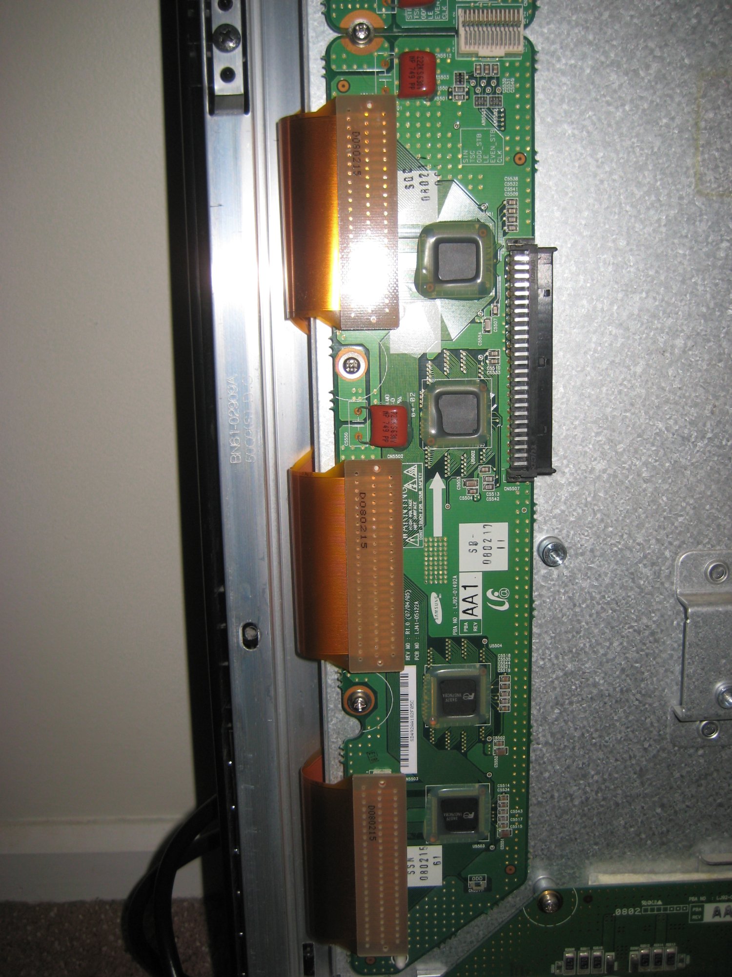

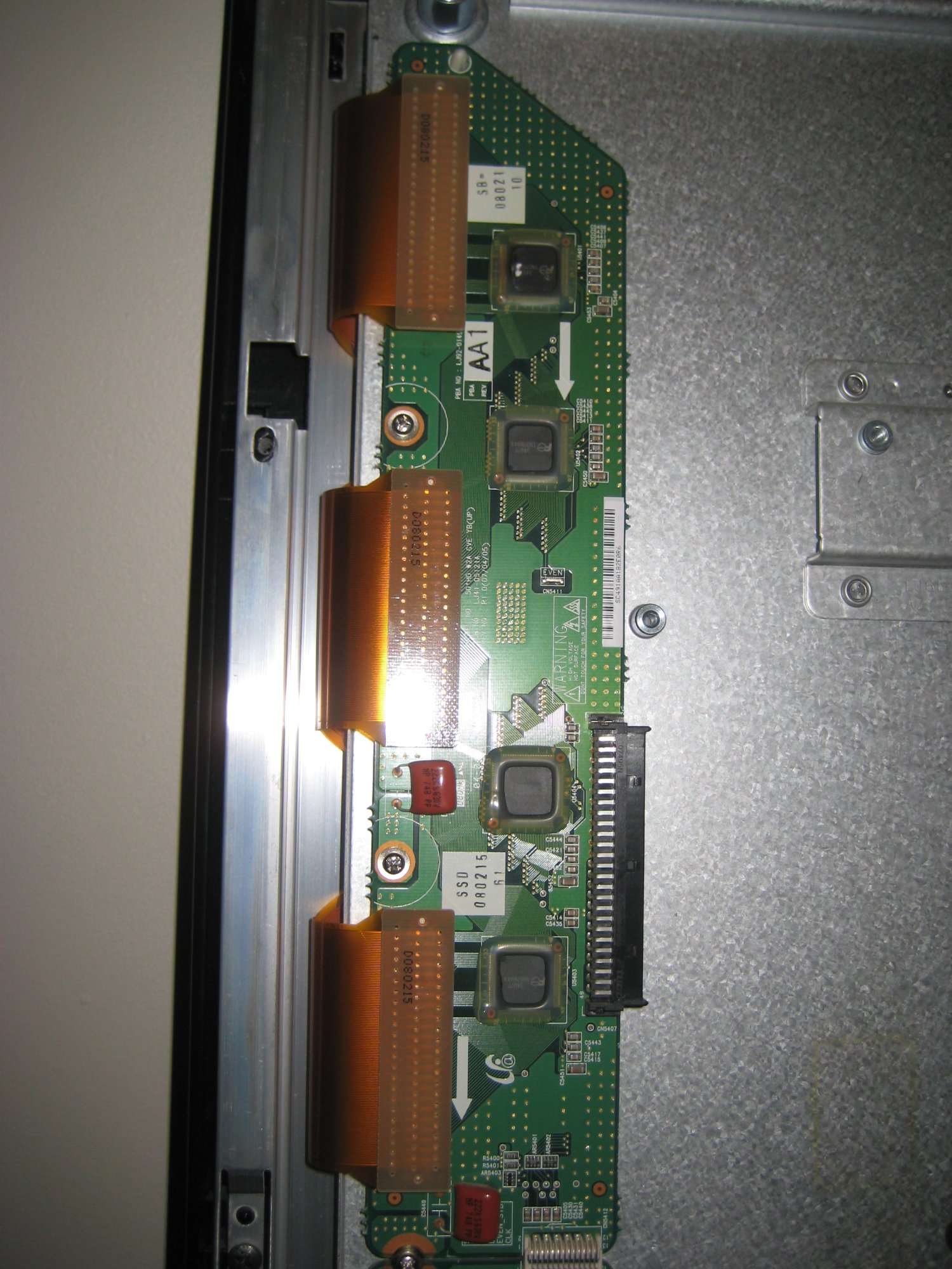

                          Post pictures of your buffers, maybe you're testing the wrong places.
                          • psmedley
                            • Apr 2012
                            • 144

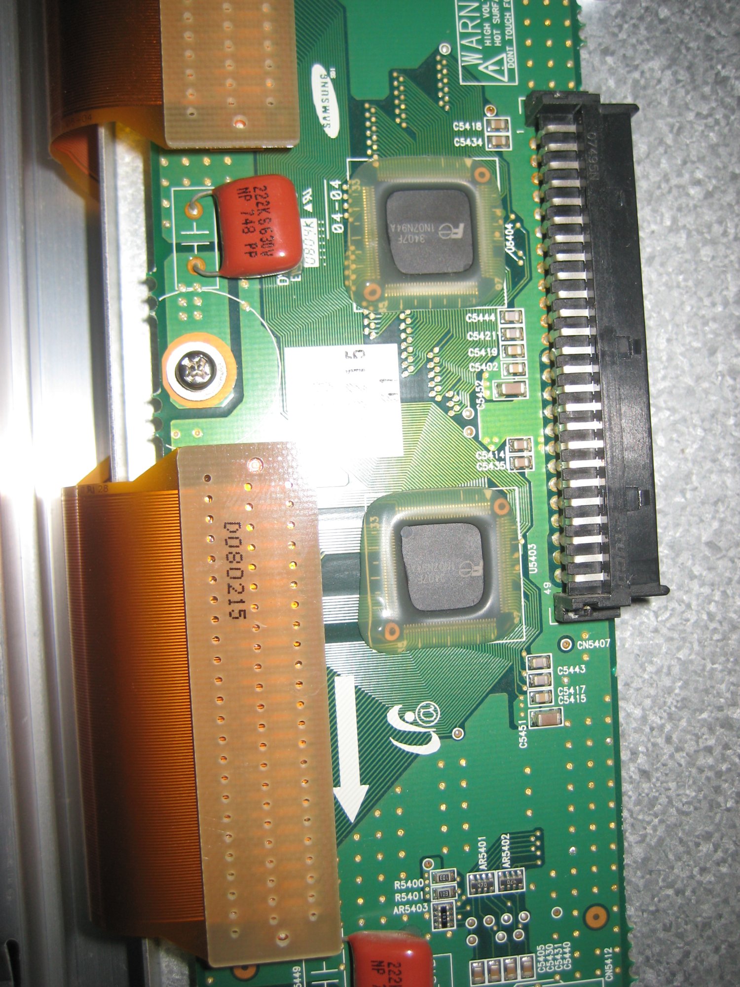

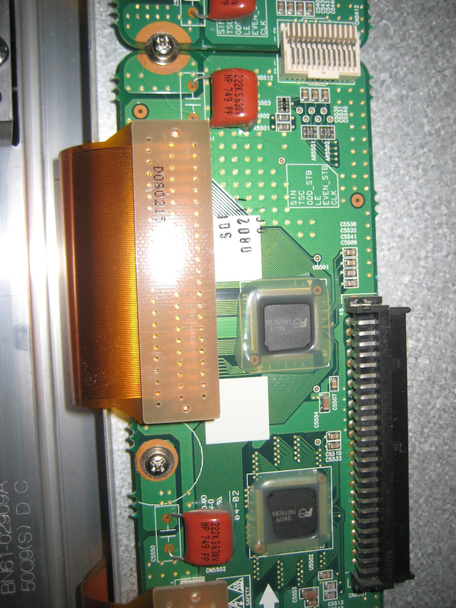

                            #93
                            Photos of buffers attached.
                            The connectors look pretty similar to the Coppell photos...
                              #94
                              A good place to check would be across that red cap.
                              • psmedley
                                • Apr 2012
                                • 144
                                #95
                                all 4x red caps read OL
                                  #96
                                  So they're probably not blown but just to be sure check this; any pin along red to blue, both ways.

                                    #97
                                    Will do... so basically top half of connector to bottom half...
                                    Which is not what http://www.coppelltvrepair.com/data/...2-01203A-1.jpg shows

                                        #99
                                        lower buffer board - either OL or reading in megaohms
                                        upper buffer board - top pins to bottom 3 pins = 5 ohms. Once I go to fourth pin from bottom, pins have high resistance (min 10k, some M or OL)

                                          #100
                                          Shame there are no pin layouts to truly show what is power and earth to enable more accurate testing...
