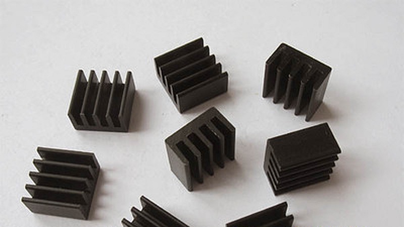

          Once you make it work, it could be good idea to put small heatsink on each buffer chip. There are some cheap 9x9x5mm little heatsinks on ebay just to fit in the middle on buffer IC top, not touching protective glue on IC terminals.

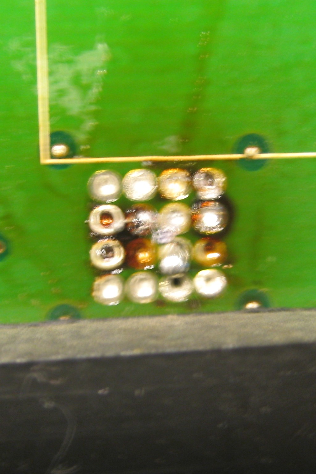

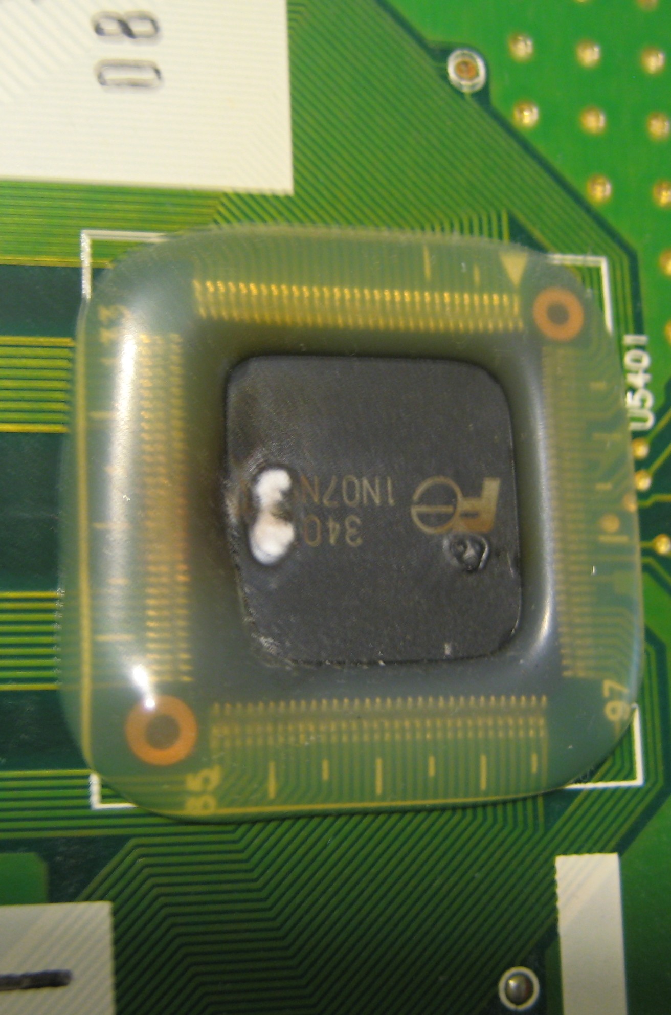

            LOL I think I found the problem with the upper buffer board... I didn't notice it earlier, but note the top buffer chip on the upper buffer board...
            I've attached a closeup for clarity,and also of the reverse of the board.
            Do you think that *might* be the short???!!??
            ...and of course, now I look back, I see that it was damaged way back in https://www.badcaps.net/forum/attach...1&d=1339659556 too

              It's normal for ICs to melt in operation don't you know? Remember to keep the magic smoke, you can probably fit it back in. Anyway you could cut the epoxy off the chip and hot air it off, then run the TV without that IC. You will get a black bar.
              I almost wonder if this is where the failure originated. A shorted buffer loading down the power supply a lot, and the user running it for a while trying to get it working, then eventually killing the PSU MOSFETs.
              Though the bottom is probably just flux... I imagine a lot of them will look like that.
              Generally I perform a visual inspection of all boards when I get a set, but that is fairly subtle as it looks like just a mark on the IC from a distance.

                                  When you install new YSUS FET's maybe you should try without whole upper y buffer board. Topmost IC on upper buffer board is visibly blown and should be replaced, but maybe there are more shorted IC's on the same board but not visibly blown. Even if you remove topmost IC other possibly shorted IC's can blow Y FET's again. Testing with new FET's and lower buffer only (which you confirmed has no shorts) would ideally produce normal picture on the lower half of the screen. If that happens, you can start celebrating ;-)
