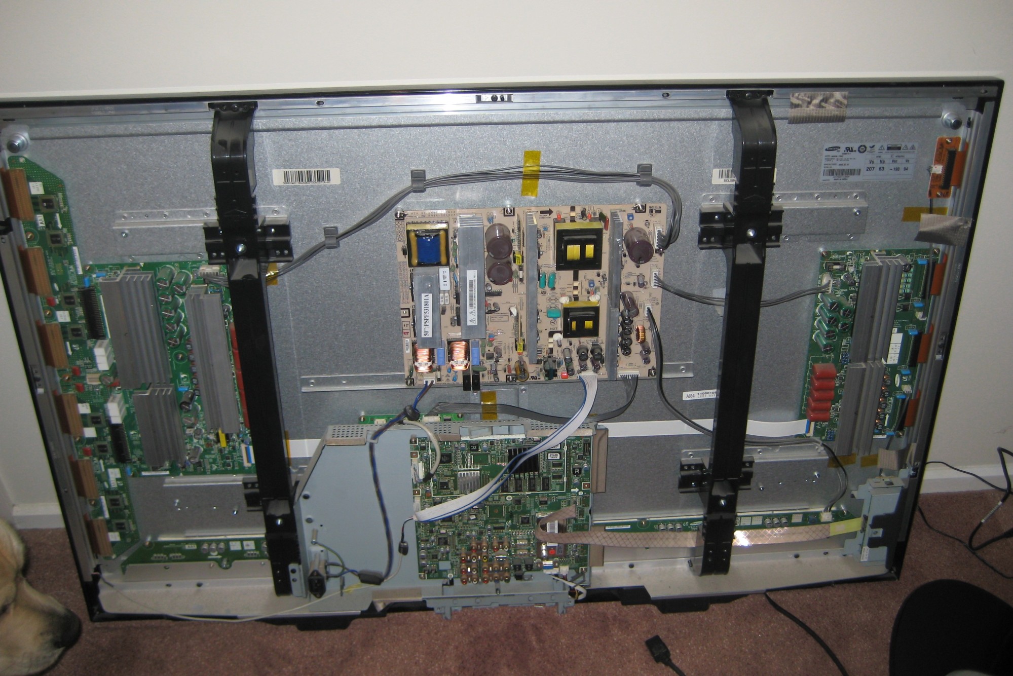

        Re: 50" Samsung Plasma (model number PS50Q91HD) - possible purchase
        Got the TV - probably paid too much ($A101), but Tom66 is right - I've been bitten!!!
        Pictures of board layout attached.
        Will get closeup photos of the boards once I can get some decent lighting.

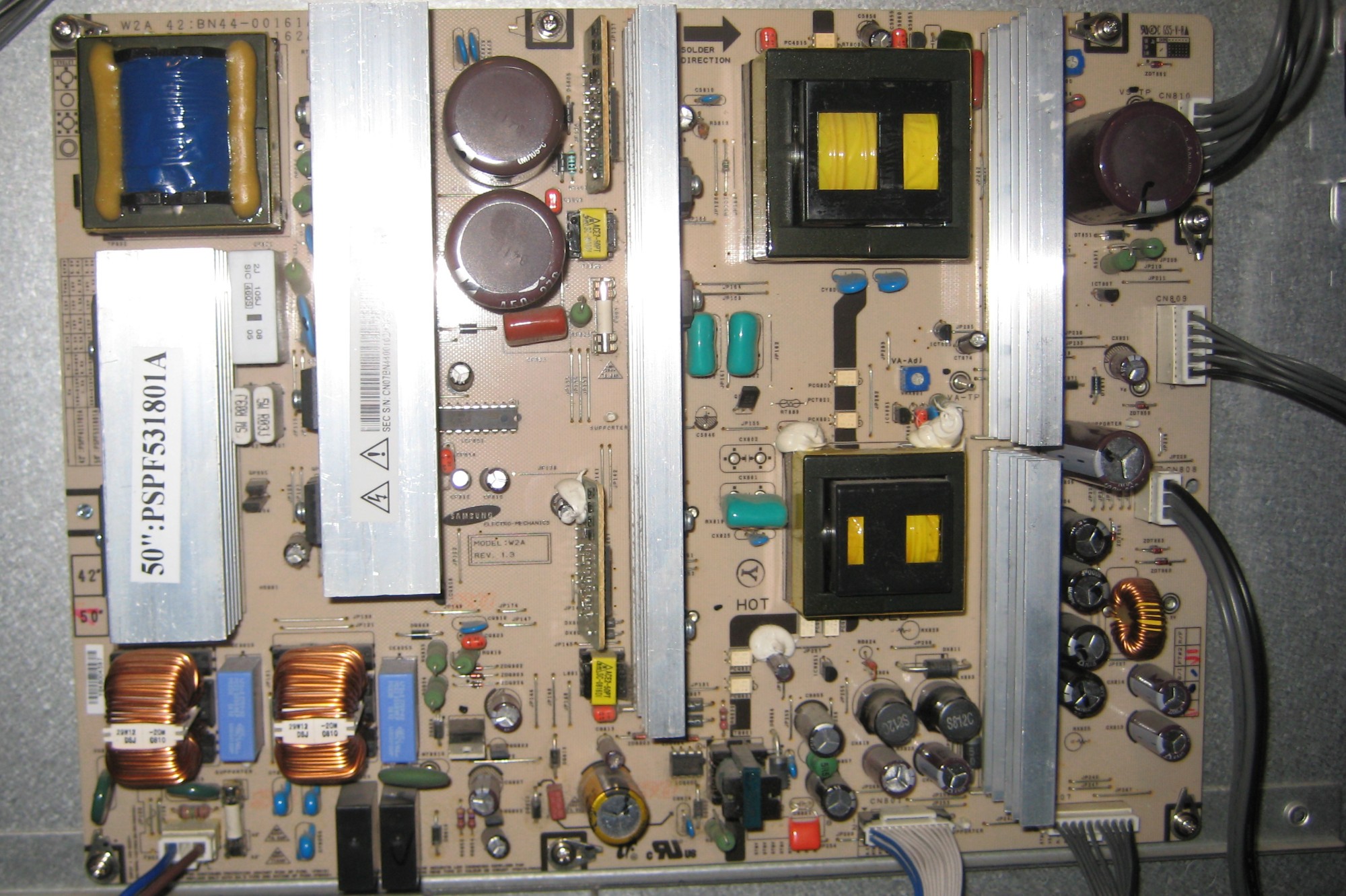

        Initial observations:
        - when connecting power, clicking noise from the PSU, repeats every 10-15 seconds.
        - disconnect Y-main board from PSU - same
        - disconnect X-main board from PSU - same
        - disconnect board behind main board (Z-main?) from PSU - same
        - disconnect board that runs across bottom of TV - same
        - disconnect all boards except main board - same
        Suggests a PSU issue?
        I do note that there are 2 25v 68uF Samwha's on the Y-main, and 1 x 25v 680uf Samwha on the X-main that are clearly bulged.
        PSU caps are Samyoung
        More to come - but I'll probably test all caps on the PSU with my ESR meter and check for dry joints next. Might not be until the weekend tho.

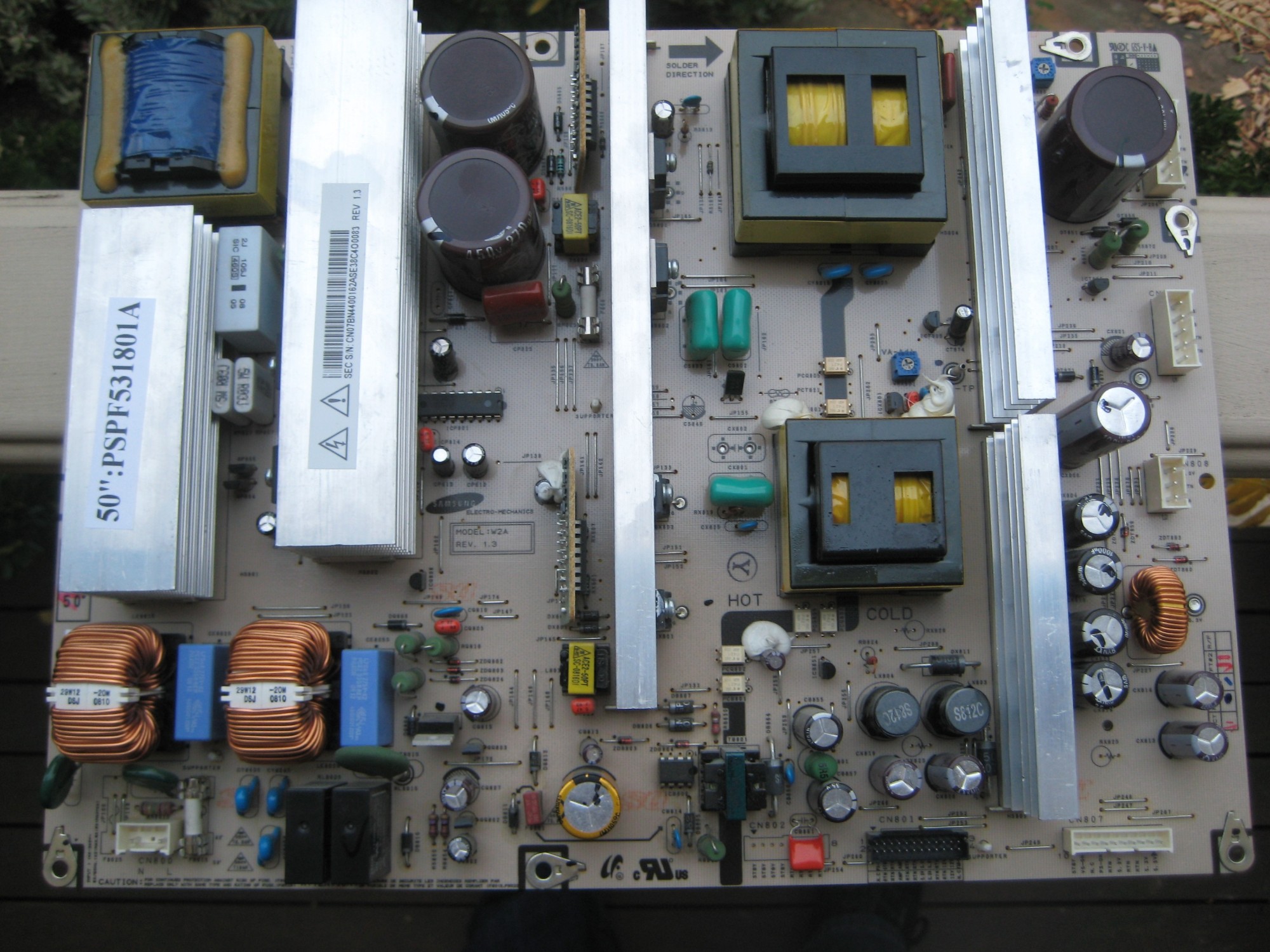

          Have found several badcaps on the PSU: - photo attached - will try get a clearer one tomorrow in daylight
          50v 47uf with 0.6 ohms ESR vs reference value of 0.5
          25v 200uf with 0.34 ohms ESR vs reference value of 0.23
          50v 100uf with 0.84 ohms ESR vs reference value of 0.31
          50v 47uf with 0.84 ohms ESR vs reference value of 0.5
          50v 47uf with 1.01 ohms ESR vs reference value of 0.5
          25v 1000uf with 0.21 ohms ESR vs reference value of 0.08
          25v 1000uf with 0.17 ohms ESR vs reference value of 0.08
          50v 47uf with 0.91 ohms ESR vs reference value of 0.5
          25v 220uf with 0.56 ohms ESR vs reference value of 0.23
          Not sure about the following as I don't have reference values:
          100v 820uf with 0.05 ohms ESR vs reference value of ??? - guessing from table between 470 & 1000 uF I'd say reference should be 0.05-0.06 so borderline??
          10v 2200uf with 0.06 ohms ESR vs reference value of ??? - guessing OK? 10v 1000uF has ref of 0.12, 4700uF has reference of 0.23 - this is lower than both
          big caps:
          250v 820uf with 0.13 ohms ESR vs reference value of ???
          450v 270uf with 0.18 ohms ESR vs reference value of ???
          450v 270uf with 0.17 ohms ESR vs reference value of ???

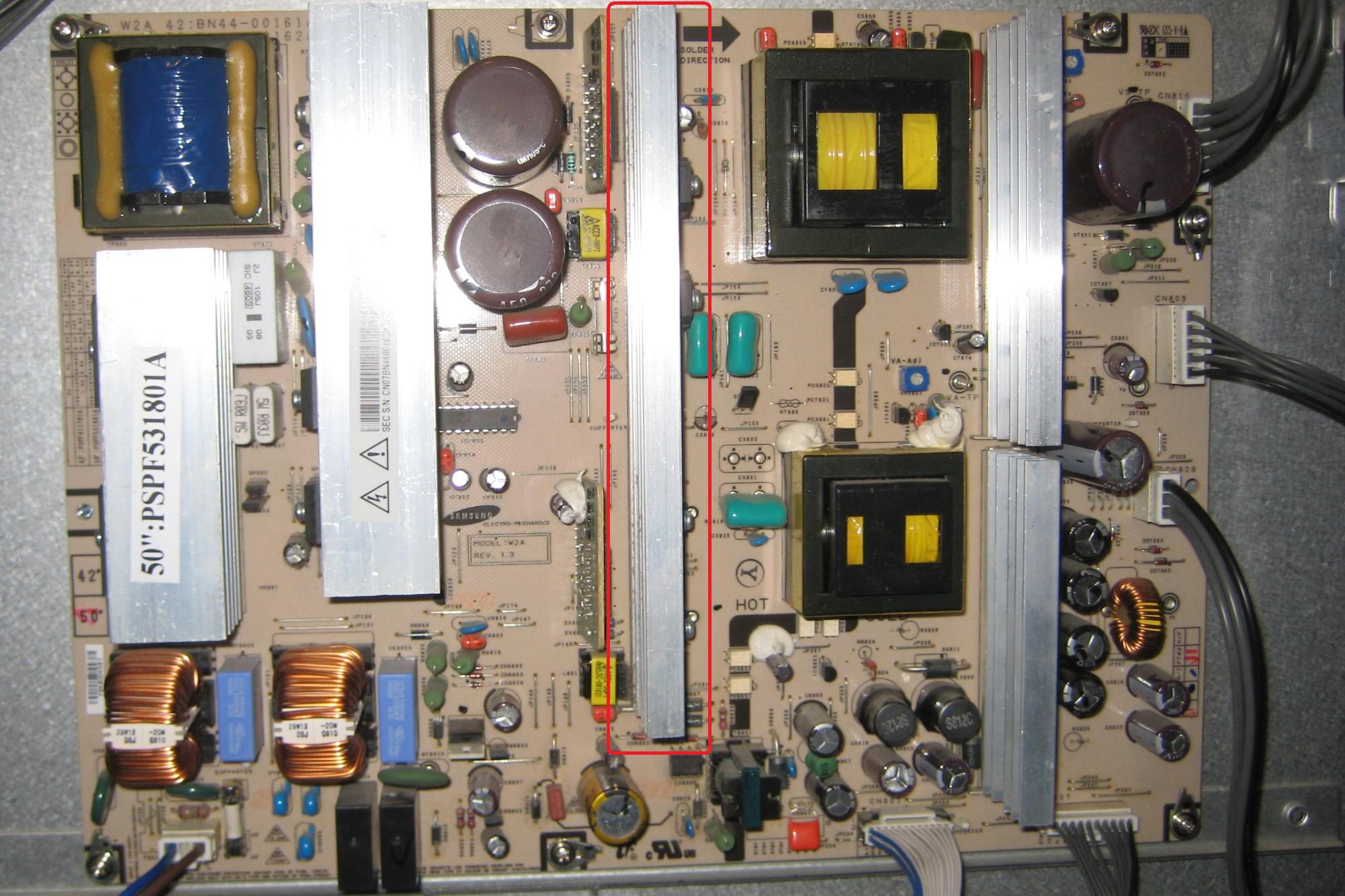

              I've marked the heatsink that I reflowed on the one I fixed. I could get it to work/fail by applying pressure with a wooden spoon. It could be live! Can't remember now.
              I'd reflow that first. I was at a lady's house picking up another broken set whan she mentioned she also had the same model doing the same thing but she had 5yr wty. The PSU literally went up in smoke whilst she showed me when it cycled a couple of times!

                  OK reflowed joints that tw2005 suggested - also the joints for the parts attached to the LH heatsink - and no change in behaviour....
                  • tw2005
                    • Oct 2011
                    • 6458
                    Well that's a bugger. Maybe it's blown then. The only other PSU I've had to fix in a plasma was a Panasonic with a blown MOSFET. It continuously clicked because obviously the PSU was not starting up due to the dead switching transistor.
                    Time to follow the circuit and fault find the components I guess or find a cheap PSU.

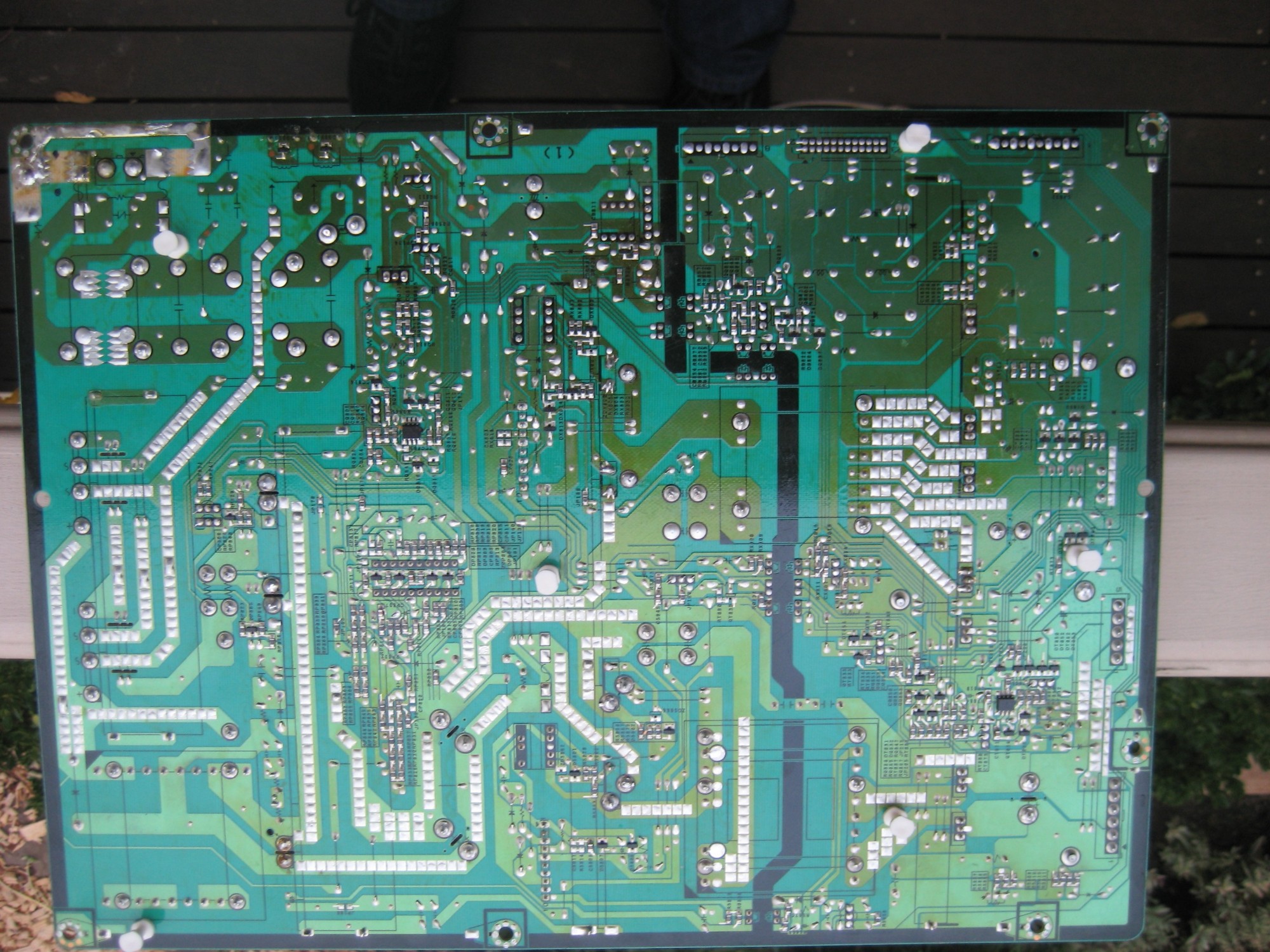

                                      I read that if a mosfet is dead, they often short from drain to gate.
                                      This seems to be the case here - I have continuity (< 3 Ohms) between drain and gate on QS801 & QS802, but not with QX801 and QX802
                                      • psmedley
                                        • Apr 2012
                                        • 144
                                        Photos of front/back of PSU board - hopefully there was enough light left that these are sharp enough!
                                        Also just confirmed that fuse F803 is blown, but there is still continuity through the terminals - I guess because QS801/802 are shorted?
