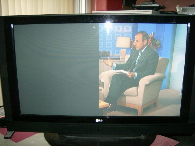

    Hello, I need your technical assistance.
    I have a LG plasma TV 42PC1DA defective.

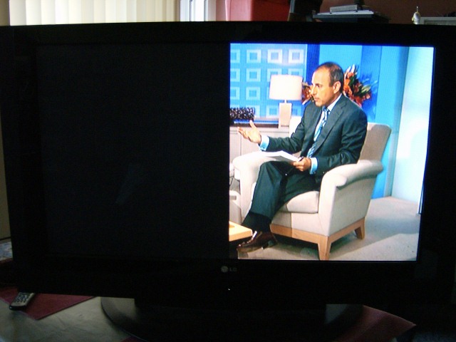

    Symptom: No picture on the left side of the screen, right side picture perfect.

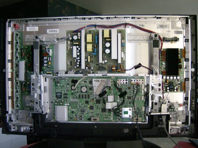

    What I did, replaced the control board & the XR board.
    Replaced the cables. Checked the DC supply, +5 V and Va on the XR board, correct voltage, checked fuses. Same problem.
    Is it possible that the main board is faulty?
    Thank you.

    Reseat the cable for the XL buffer.
    Or replace the XL buffer.

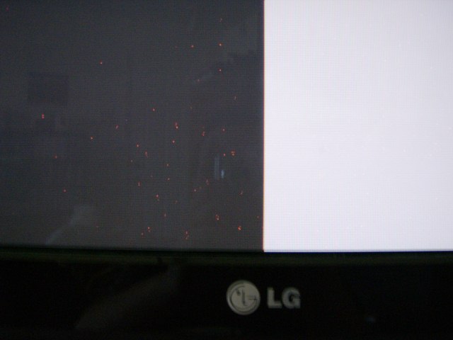

    Does your TV suffer from the dreaded "sparkles" problem? (Flickering green, red and sometimes blue pixels in the corners of the screen, visible in darker portions.)

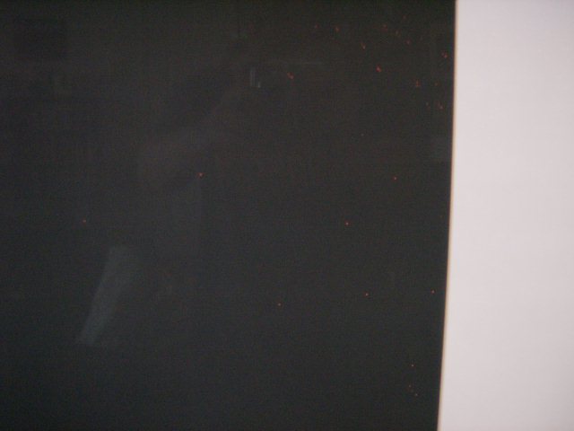

      Hello, on the front left side, half the screen in dim light, with red sparkling, but more in the center bottom. Sparkling also appears on the right side of the screen.
      At the back of the TV, the XR board is on the right side.

        The sparkling is an unrelated symptom, but it will get worse over time. LG released a software patch for the control board to fix this problem but it requires someone with the right control jig (expensive.) I think there is a member on these forums who does program these boards for a small fee.
        I think the problem is more likely to be XL because it's on the left hand side of the screen, but I'm not sure if the labelling is from the back or the front of the TV. Either way, consider replacing the X buffer for the failed side of the screen.

              Problem solved. Faulty screen, right side (rear view), burn spot on all COF (chip on flexible cable).
              I do not know the reason, the circuit XR is in good condition, nothing to suspect.
                Re: LG plasma 42PC1DA Half left screen
                Possibly a failure in the XR board damaged the panel COFs. It is sad that the COF are not replaceable and failures condemn the panel.
