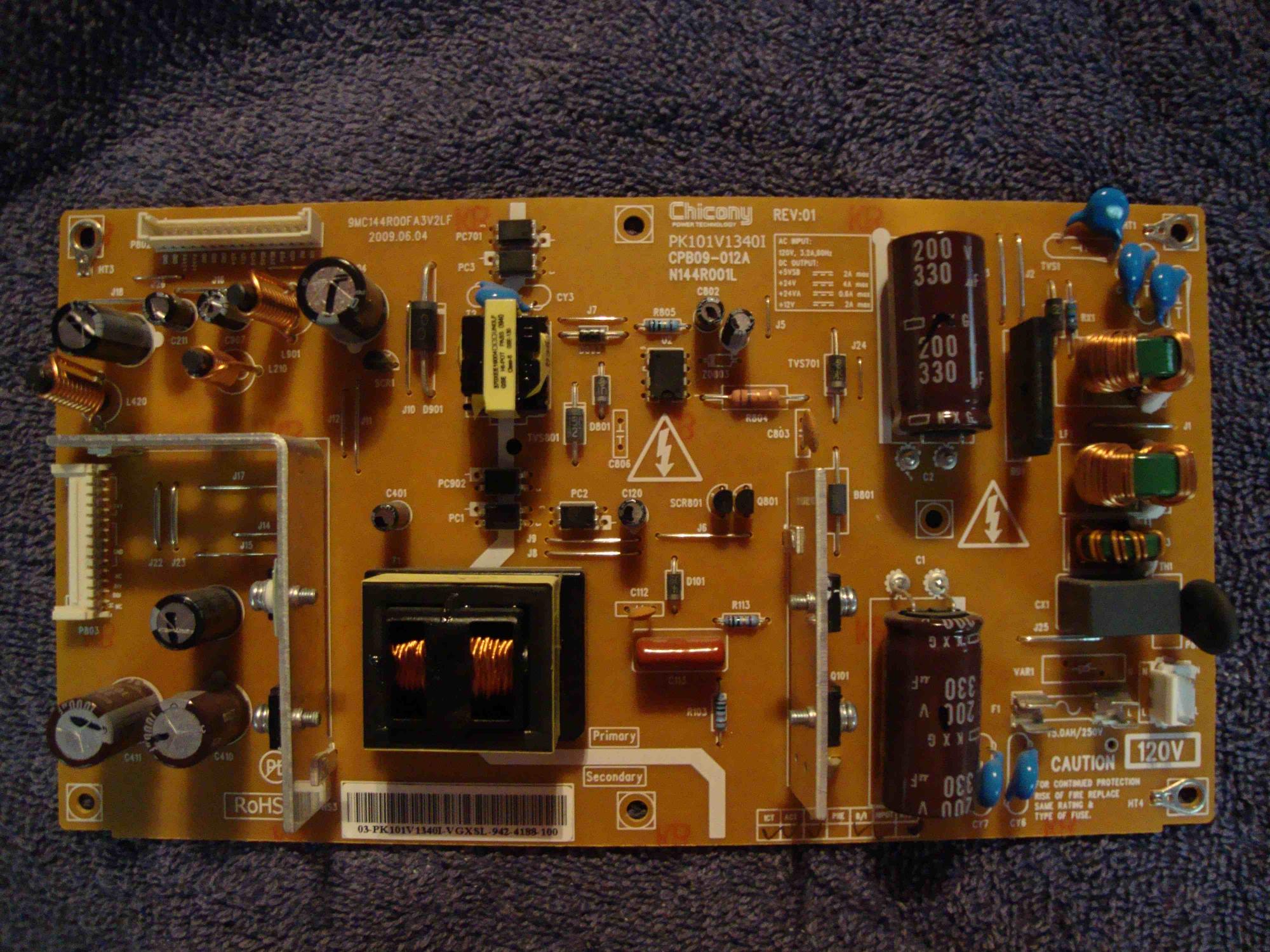

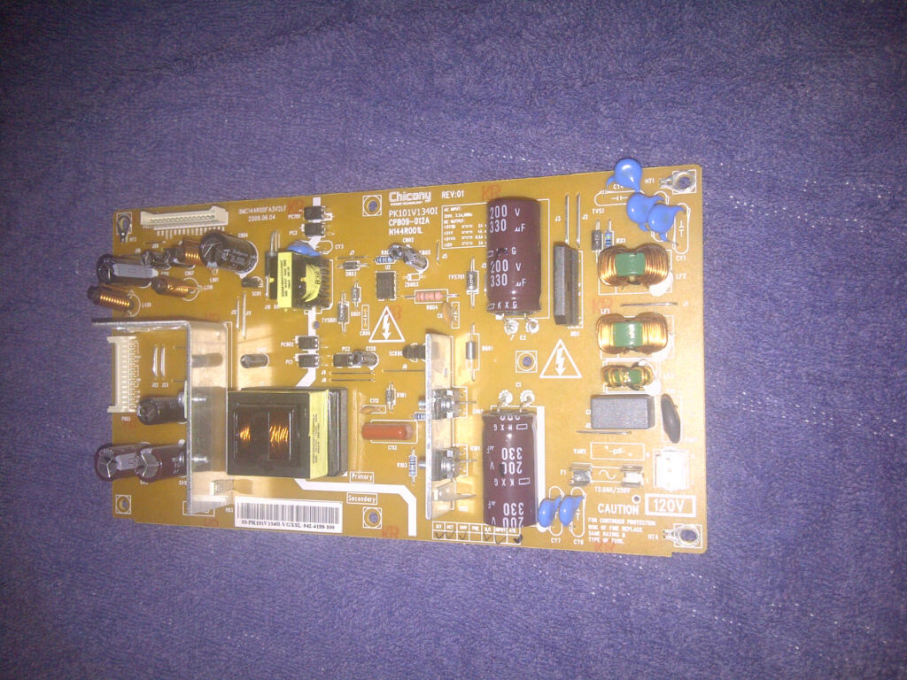

    Hi all, last week I jumped into a thread I thought was for my TV model but it turns out the board in question was a different part number. I was asked to provide the pictures of my board in my own thread so here goes.
    My TV will not turn on, when I push power button or use remote nothing happens, no error code no blinking lights. I took the back cover off and found the main fuse had blown, tried replacing it and as soon as I plugged it back in the new fuse blew again. Following the previous thread I tested the bridge rectifier and it did not pass the test. Using a multimeter on OHM setting I tested points one and 2 on the rectifier and with the leads one way I got no reading and when reversed i got a reading. On points 3 and 4 i get a reading both way the multimeter leads are connected. Are there any other things that I should check or would the bridge rectifier be enough to cause the main fuse to blow? I have attached pictures of both the front and back of the board and the part number.
    Any assistance is greatly appreciated
    Paul

      That Model has shorted TVS. I asked Oconnorp to post new thread since his TV is not the same model or boards.
      @Oconnorp, please post straight shot pictures of the boards with good lights, I can hardly see anything on the pictures, thanks.

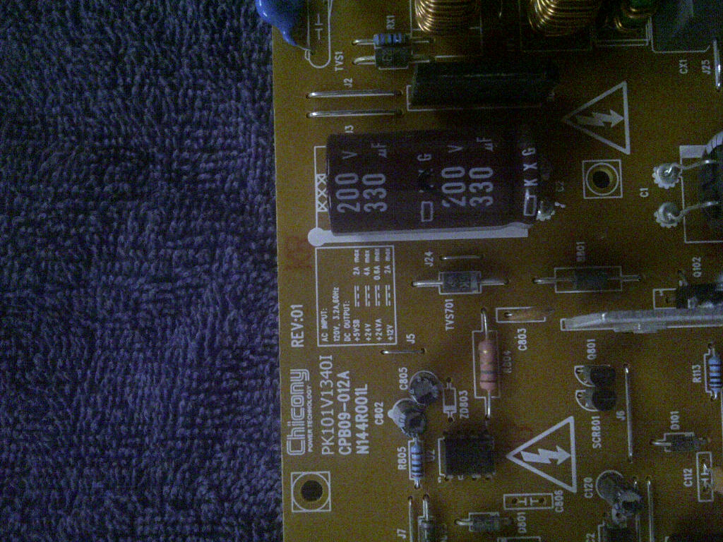

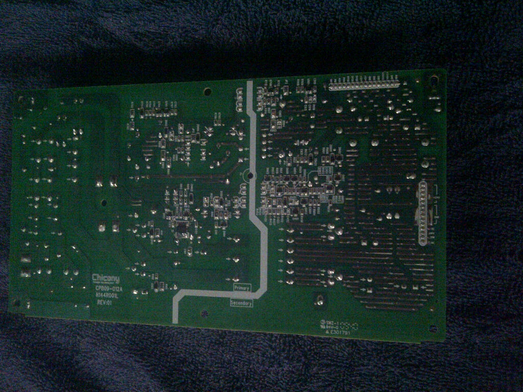

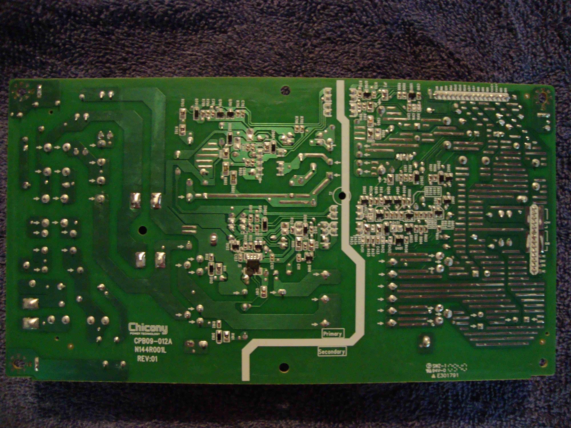

        sorry thought these posted over the weekend. Not sure what happened. Here are the pictures front and back. Hopefully better than the other ones

          On the back of the board - primary side there is a largish 8 legged component
          Looks damaged in the picture - is it? Has it got a part number on it that yu can read.

            Use your multimeter on the 200 ohm range to check this device TVS1. You should see no change when probing it if it is good. Do this with the TV unplugged.

              The 8 legged creature looks ok to me, must be a shadow in the picture. I probed the tvs1 as indicated in your picture it reads 0.6 steady when I hold the probes on it.
                Re: Toshiba 32AV502RZ
                0.6 Ohm? That sound like the same problem with the other Toshiba on that thread you were asking the question, the TVS was shorted out. You can remove it, put in the new fuse to test, the TV should come on now
