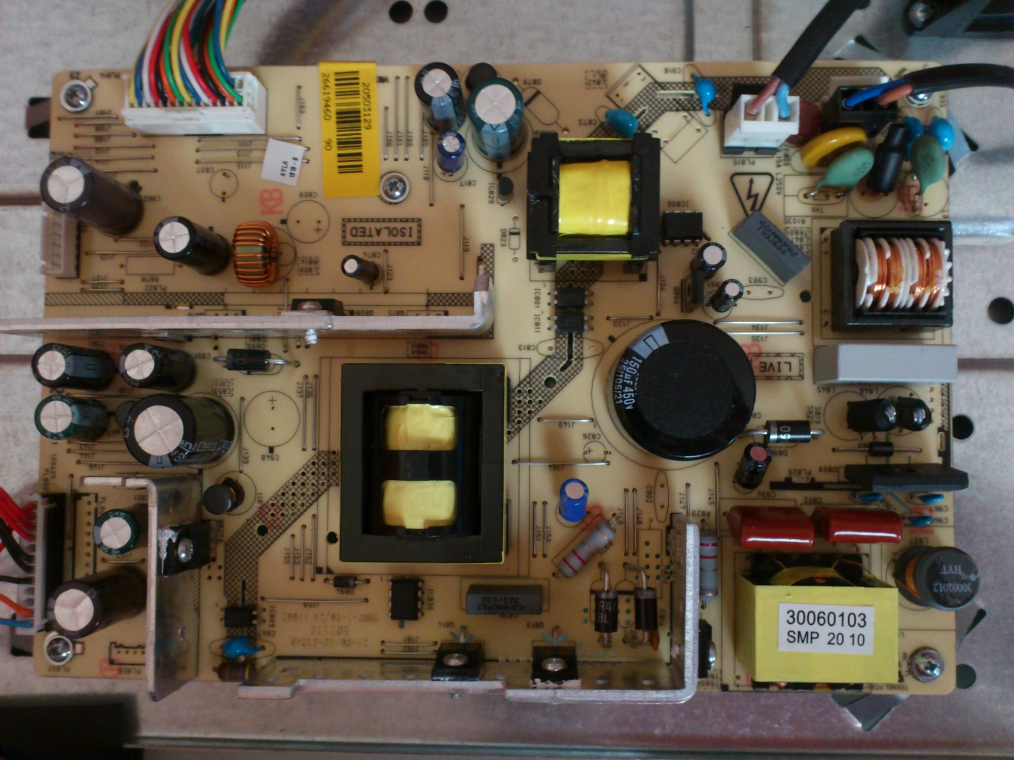

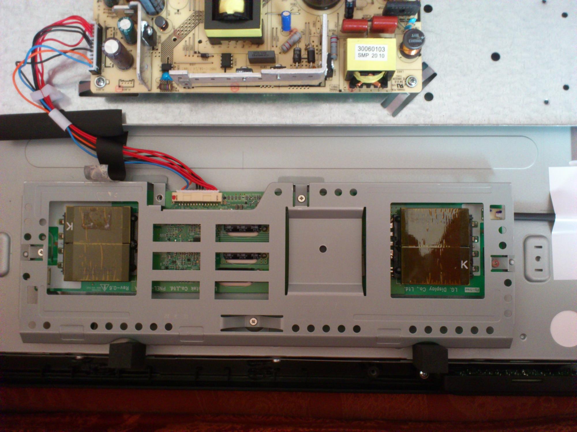

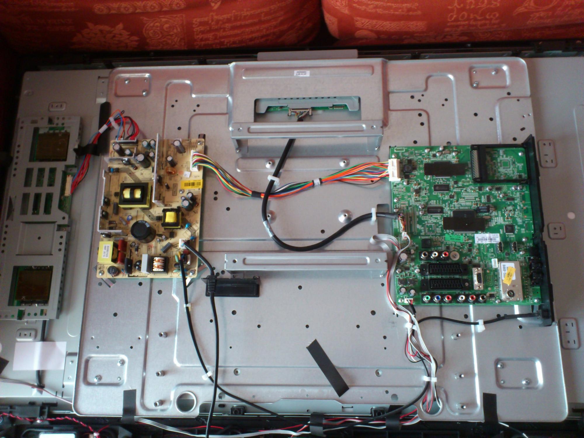

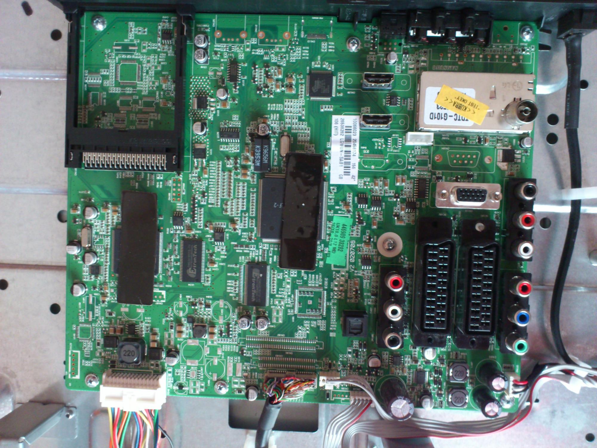

    HI ALL, has anyone had this problem, randomly shuts off, aint had a chance to fully test the fault yet but had the back off to see if there where any bad caps bulging
    see pics below
    Re: Hitachi 42LDF30U RANDOM SWITCHING OFF
    Another Vestel you've got there, definitely a later model.
    From what I recall the 17PW26 PSU's tend to get bad poly caps like on the 17PW20's/17PW15's.
      I keep getting these just recently, I'm watching the tv now waiting for the fault...but it hasn't gone off yet, I might just change all the caps including the polys then, just for peace of mind.
      It's a nice tv but to say it's full 1080p the picture is not that great compared to my LG 1080i , I am watching a none HD channel though.
      I paid £65 for it so not a bad buy suppose
              When I took the back off I did reseat all the plugs, and some screws had broke the mounts off as if it's been dropped but no marks anywhere, so might have fixed it without doing much....lol
              I'll just test it for a few days and see what happens then
                  vestals also suffer badly from cold joints,i fixed one that had 14 cold joints on it,you could actually wiggle capacitors and the legs would move on the solder side!,check for that as well.
                  fixed so far...376 lg lcd tv's,24 onn tv;s,24 panasonic lcd,16 jvc lcd,12 marshall jcm800 amps,refurb of various disco equipment lighting,old style disco decks ,and a flymo!
                  please let us know if everything works ok if your tv gets fixed, as it will be and aid for anyone else having the same problem and wishing to fix it.it would save people clogging up this site with topics that are duplicated,and can be found easily using the search function.,and taking up valuable space.enjoy your fixed tv!,hopefully!
                    ive got it now on test to see what happens and its not done anything yet ive wiggled stuff about and its still ok...only been on for 30 minutes so far tho
                    if it still does nothing i will get the soldering iron out and change some caps and check the board for bad joints

                                  tested again and voltages are stabble when fault occurs, with the sound switching off before the picture goes....ive ordered a main board for it for £20 but its not come yet, so fingers crossed thats the culprit, i should get it tomoz so will update when ive retested it
                                  what voltage does the t-con run on??
                                    Usually 5V for T-con.
                                    Try using some contact cleaner on the side button board... sounds like it is controlled switching off.
                                      board came today and its got the wrong t-con connector on it....and i cant find the right board....so im screwed now! gonna have to refund them, now im left with a 42" thats useless
                                      major bummer!
