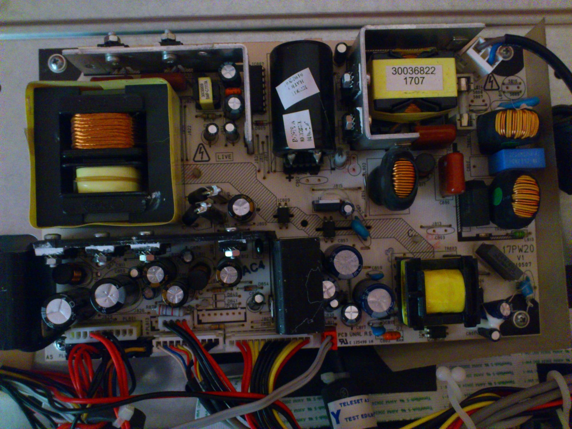

    hi all, ive recently got 2 lcd's in, 1 being a Goodman 32" with a 17PW20 Psu and a 37" Hitachi with the same board

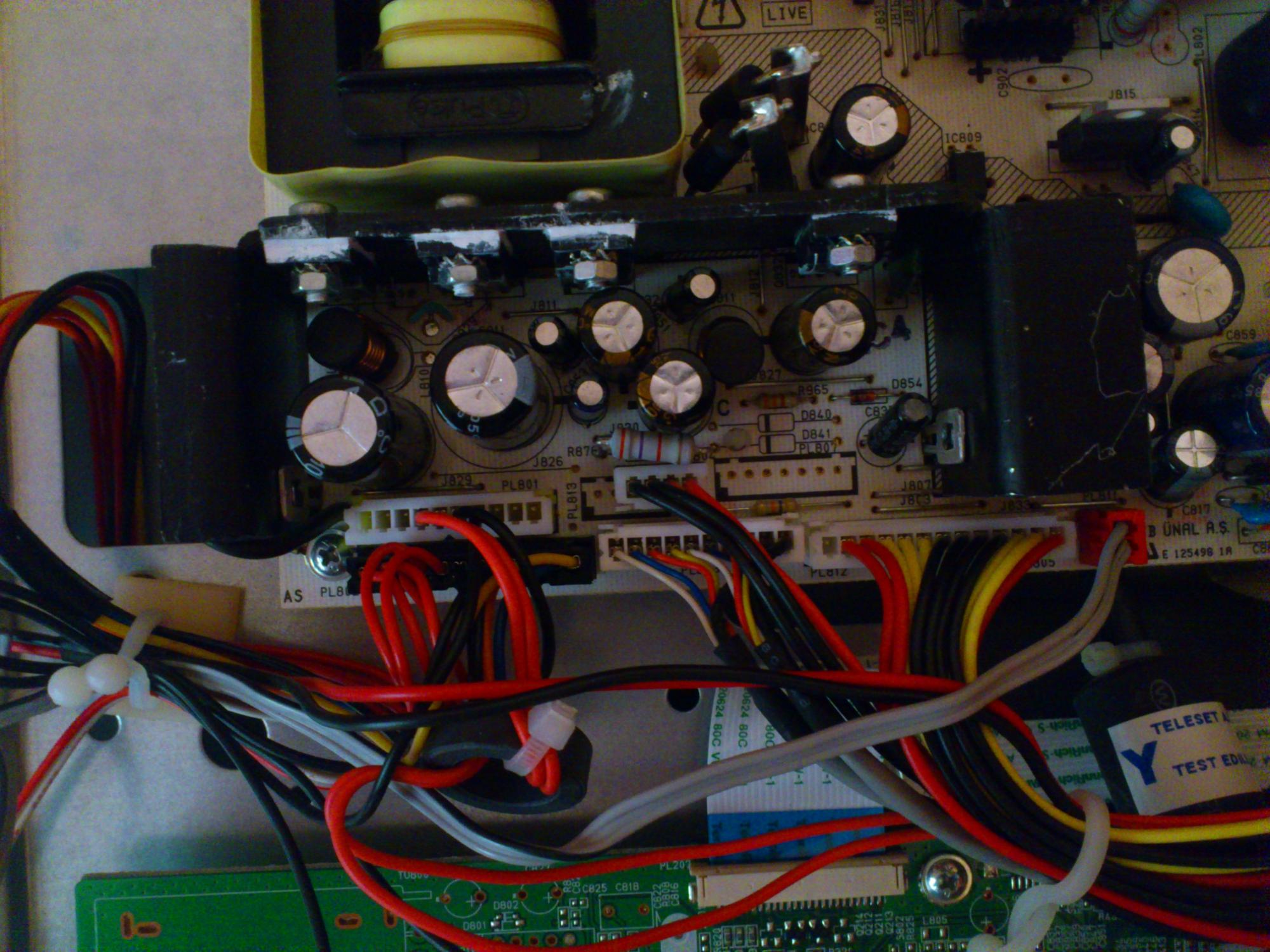

    goodmans turns its self off after about 5 mins - ordered main caps to try changing them 2 x 4700uf 6.3v, 4 x 1000uf 16v, 1 x 2200uf 6.3v and 2 x 1000uf 35v (no bulging caps found but G-Luxon)
    the Hitachi how ever does nothing....DEAD, i have swopped PSU's over and tested in the goodman and that turns on and its working fine - any ideas guys? is this a main board issue or inverter?

    17PW20 is cross compatible with 17PW15-8.
    If you have too much trouble would just advise buying one on eBay for around 20 quid.
    The #1 fault (5 mins off, sometimes 1 second, sometimes 1 hour...) is caused by the two 15n 630V caps near the main switching fets on PSU, but there are hundreds of other possible faults that make these things a right nightmare to diagnose.

      will order the 15nf caps tonight then swop all caps anyway on the Goodmans to be on the safe side then retest and fingers crossed that ones sorted

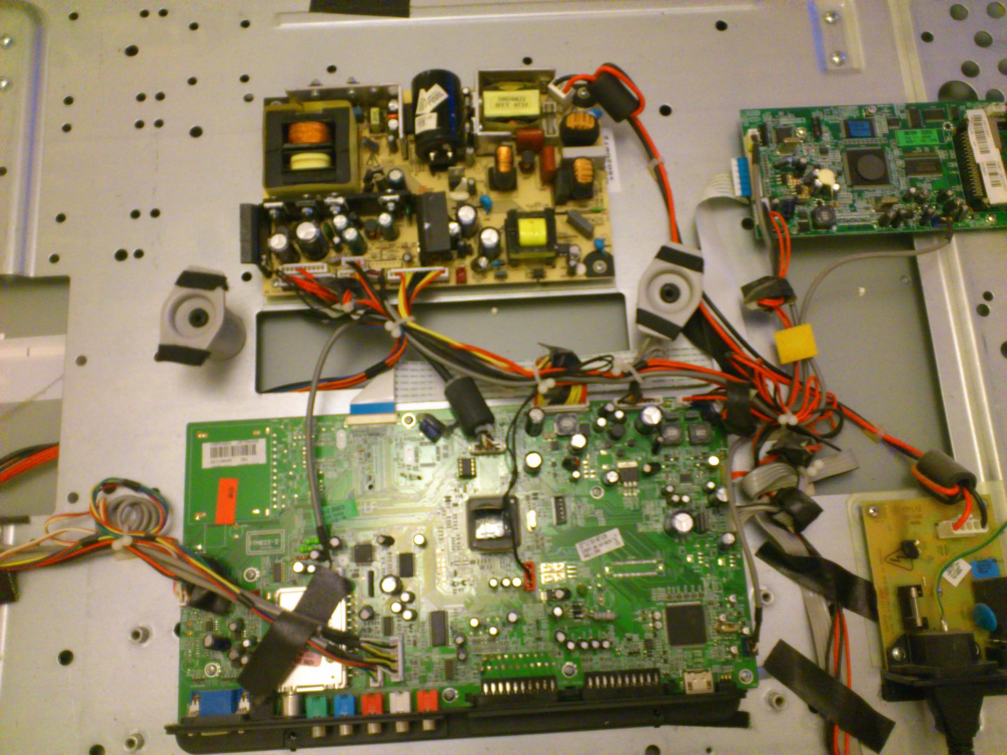

            tested with main board out the 32" Goodmans, the tv comes on but there is no picture, the back light does light up tho and there is sound
            is this likely to be the t-con?
            if it is this means the 37" needs a new main board, remote, and t-con! jesus!

              More likely the 32" board is programmed for a different T-con and so won't display anything on the 37"...
                Re: 17PW20 PSU Working but no power lights on LCD
                arh....makes sense due to the other board having 37" Hitachi wrote on it! lol

                      -Do not- lower the voltage rating of the caps on the primary.
                      Although it may not seem like it matters (PFC is 400V), it does because the ringing at the drains puts the voltage across those caps as peak 600V. In fact using 1kV caps would be a good idea. They are cheap from farnell or ebay.

                          will this do the 15nf ones?
                          http://www.ebay.co.uk/itm/PANASONIC-...item3a70f0a15f
                            Looks fine but...
                            http://www.ebay.co.uk/itm/17pw20v1-v...8#ht_500wt_971
                            Might end up cheaper as it has a few other parts too.

                              I've ordered the main board for the 37" and all the caps for the PSU on the 32" so I'll update when I've fitted and tested both TVs
                              Shame I didn't see the kit earlier cause I ordered the replacement caps for g-luxon caps yesterday, but ordered the Panasonic 15nf ones now, but will remember for future to look for the repair kits instead

                                all caps changed on the power board of the 32" Goodmans, out of the 13 i changed there was one bulging at the bottom....capxon cant remember the uf, but just tested for half hour and it hasnt gone off or any thing so another one done, just waiting for the main board for the 37" which i have had a slip through the door so got to pick up tomorrow from post office so fingers crossed that should work if not ill be back to report!
