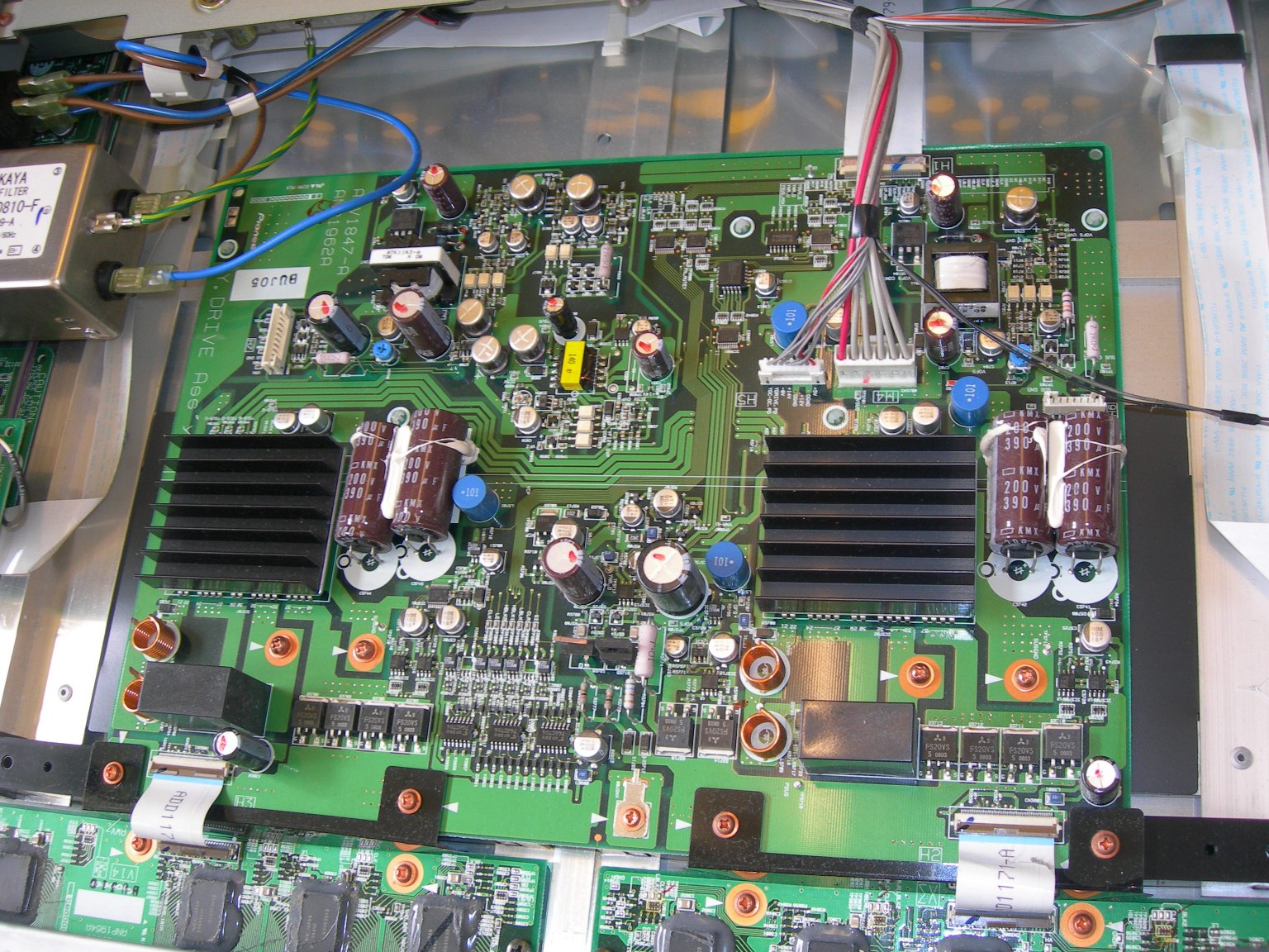

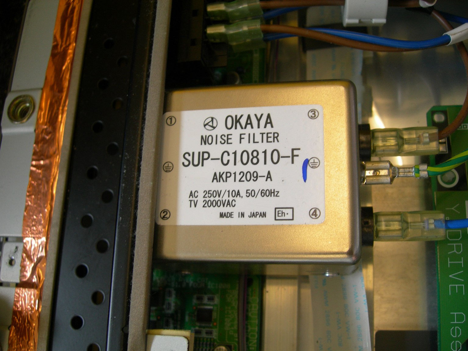

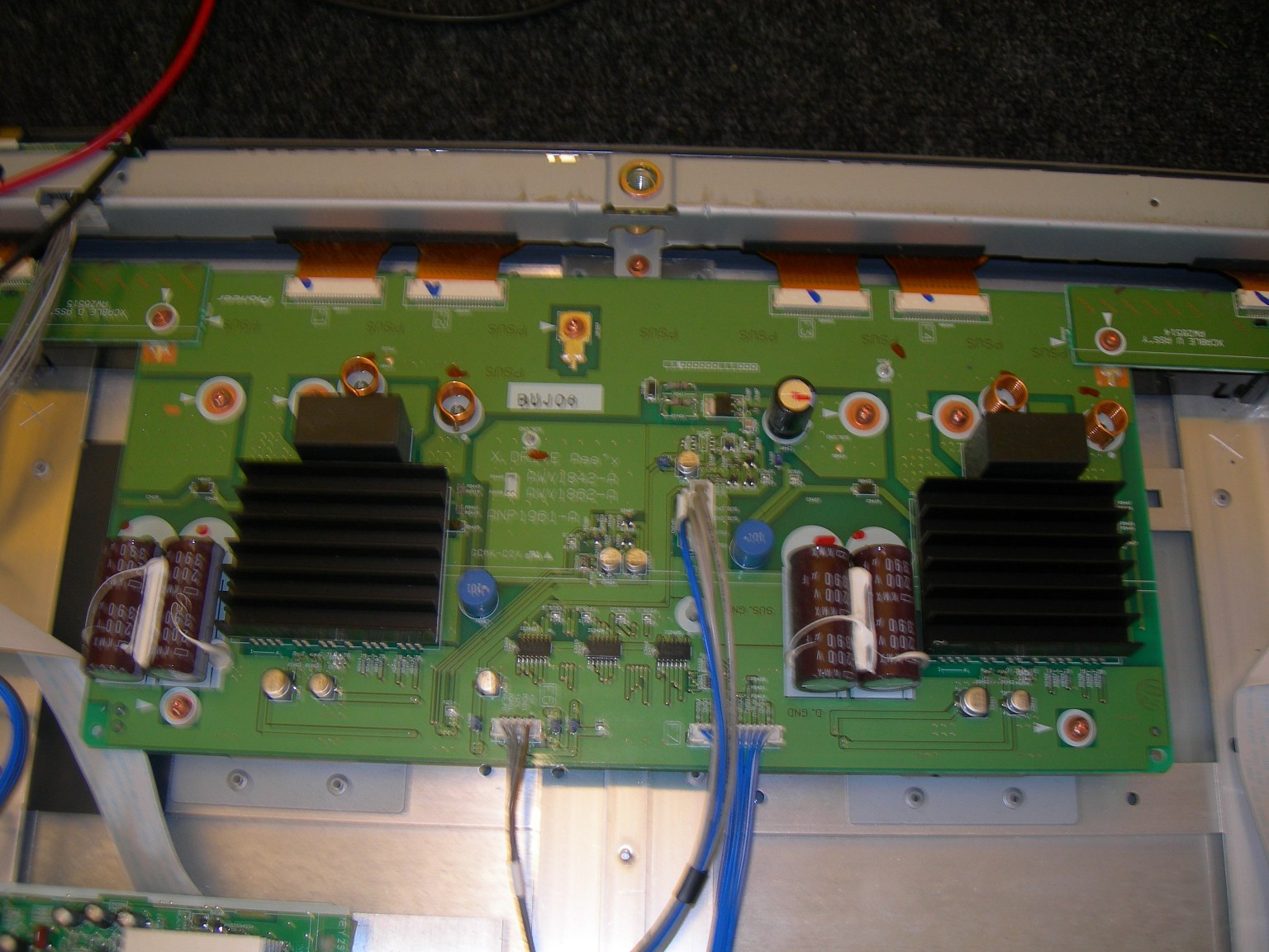

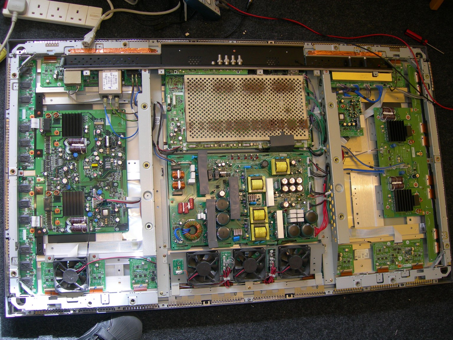

              Okay... got it in the shed & took it apart.
              No trap switch - this model is too old for that! As it has no HDMI etc no need to keep any of that silly stuff secret.
              First impressions VERY nice. It is completely chock full of stuff. Barely any space in it! PSU has all Nichicon and Chemicon caps. Sustain boards have Nichicon, Chemicon and Elna caps. There's a few Panasonic caps on some other boards too. On this plasma the Y drive is on the other side of the screen, where the X drive would normally be, but it's just convention to put it on the left, not a requirement of the panel layout.
              The Vs bus alone has 3000uF capacitance! It's HUGE, compared to a 42" Samsung I serviced with -just- 150uF!
              Also, it's got a Pioneer panel, with Pioneer drive logic, but the PSU looks to be OEM of some kind, I can't tell who makes it. Pioneer have used hybrids on this design which I -don't- like, but at least the devices aren't impossible to remove.

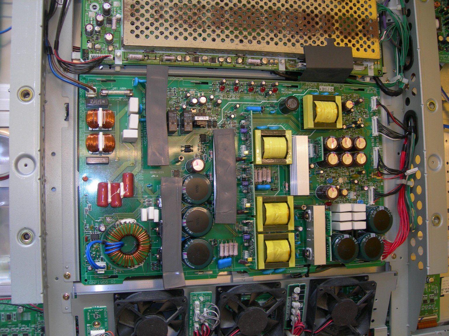

              So, symptom is: Plug it in. Power LED comes on red. Press power button, LED goes green, one relay click, then ~5 seconds later another click, and the LED goes red again.
              Initial checks showed a good STBY+5V at exactly 5.000V according to my meter (±0.7%). STBY+12V however measured a high +14.5V. However, I don't think this is the problem, it is probably high because it is not under much load.
              When power button is pressed the "POWER" signal goes from ~14V to 0V and that's when the first click is heard from the relay. After about 5 seconds, the POWER signal rises back to 14V and the relay clicks back out.
              So, I checked to see if any DC bus was appearing... nothing, nip, zilch, nada. None of the main -8V, +8V, +12V or +14V supplies are firing up, they're stuck in millivolt amounts. Vs and Vda (Va on Samsung/LG) are both millivolt too...
              Checked the main PFC caps (3x270uF 420V Nichicons)... aha, a clue... nothing on them. Checked the pre-charge resistors (2.2 ohm 8W, 3 in series) and I think one is open circuit, because they all show as O.L. I'll pull the board and check.

                Re: Pioneer PDP-502MXE 50" 720p plasma
                Yep, as expected (very common failure) one of the inrush limit resistors is o/c. I have a 3.3R ohm 25W power resistor knocking around, I'll see if I can use that to test it, then I'll order the right replacement.
                  Hmm... the mystery deepens...
                  I found my 4.7 ohm (not 3.3 ohm) 25W resistor for a temporary fix and installed it.
                  However upon powering it up there was a crackle/bang and some smoke from the resistor, it is now o/c as well as one other resistor in the chain.
                  I checked further down the line, and it appears as if all the power MOSFETs for the SMPS are shorted... what could cause this...? One is shorted gate source and drain source, the other two are both shorted drain source.
                  This PSU uses a very odd flyback design for all the outputs. That means a single transistor for each one. I call this odd because flybacks are generally difficult to design for output powers in excess of around 40W, and 100W is a generally accepted limit.
                  It uses 2SK2847 FETs by Toshiba.
                  I will pull all the fets and test them. The PFC fets are fine.
                    Okay, I figured out the topology of the power supply means that one shorted fet will make all three appear shorted. The only failed fet is the one that is shorted to both gate-source, gate-drain and drain-source, the others are fine. Amazingly the control logic appears to have survived this gate-drain surge - I can only guess because of the 2.2 x 3 ohm input resistors will have limited the current before they failed completely.
                    So, I guess this is how it took out the test resistor - because there was a dead short on the rails. Amazing it didn't blow the fuse!

                              Simple Ohm's Law there - this is a big set with high consumption so it's going to have a big fuse. The component with the highest resistance at that current fails first under a current surge - and in your case this happened to be one of those resistors, not the fuse.
                              Yeah. It's got a 10A HRC fuse. I've never seen a HRC fuse in a consumer appliance. Also, the fuse is 400V rated. Unusual. Not 250V as would be normally expected.
                              This thing is about 8-10 years old from what I can find on the 'net so it probably cost around £5,000-£10,000 back then. For the price, it is a very, very well built. It's surprising one of the FETs would short, but it does provide Vs, which is the heaviest bus on the TV, drawing close to 400W for full white. The TV is rated 470W input max.
                              I tore apart one of the ceramic power resistors and got to the resistance wire. Found a clear break in it with burn marks on the substrate/core. In fact there were two breaks in the wire around the same area, I guess it's the weakest part of the wire. No other signs of damage elsewhere in the wire.
                                      I found the datasheet for the resistors.
                                      They are BGR7 resistors, 7W power ceramic cased wirewound devices.
                                      I need to find equivalents, I can only find 5W, but even if the lower power dissipation was not an issue, the lead spacing is wrong. I'm wondering if I can bodge in an axial lead 7W resistor, as I see quite a lot of those...
                                        Okay, I'm using this fet:
                                        http://uk.farnell.com/jsp/search/pro...sp?sku=1664089
                                        They used a 1.1 ohm 900V fet (2SK2847) in the original PSU, and the gate charge is nearly the same, so I think this is an acceptable substitution.
                                        And these resistors (I'm replacing all three to be sure):
                                        http://uk.farnell.com/jsp/search/pro...sp?sku=1174355
