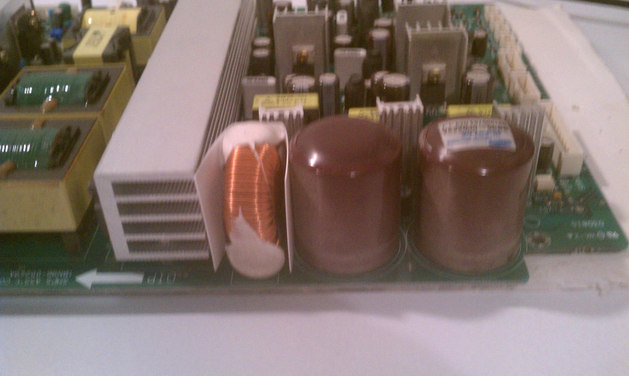

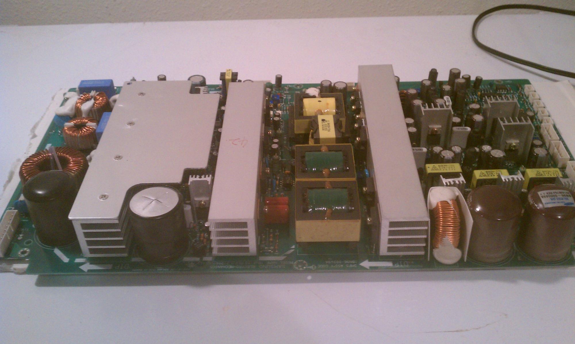

    Hello all and thank you for allowing me to join your great group.. I was given this TV in hopes that I could fix it and give it to the local VFW. When I push the power button I get the red power light blinks 5 times .. I get no sound except for the click of it trying to power on and no video.. So I broke it open to take a look and the first thing that jumped out at me was the 450v 330uf x2and 200v 1200uf x2 looked puffy.. One of the 450v poly caps was totally popped up and after removing the poly cap I can see a split in the cap.. The other 3 still have the poly caps intact.. I will be honest with ya all that this is my first adventure into fixing a plasma..So my question to you fine folks is, do you think there is much of a chance of fixing this thing by replacing those 4 HIGH VOLTAGE Caps and will I kill myself doing it . I have tried unhook the left board and power up and that made no difference and also did the same with the right board... Same ol' same ol'. The power board is a B4k-50 Rev1.2
    Any insight on this would be greatly appreciated ....

    If you take the plastic disc off the top of the cap, does it appear bulged? It is common for the disc to bulge without the cap actually having failed.

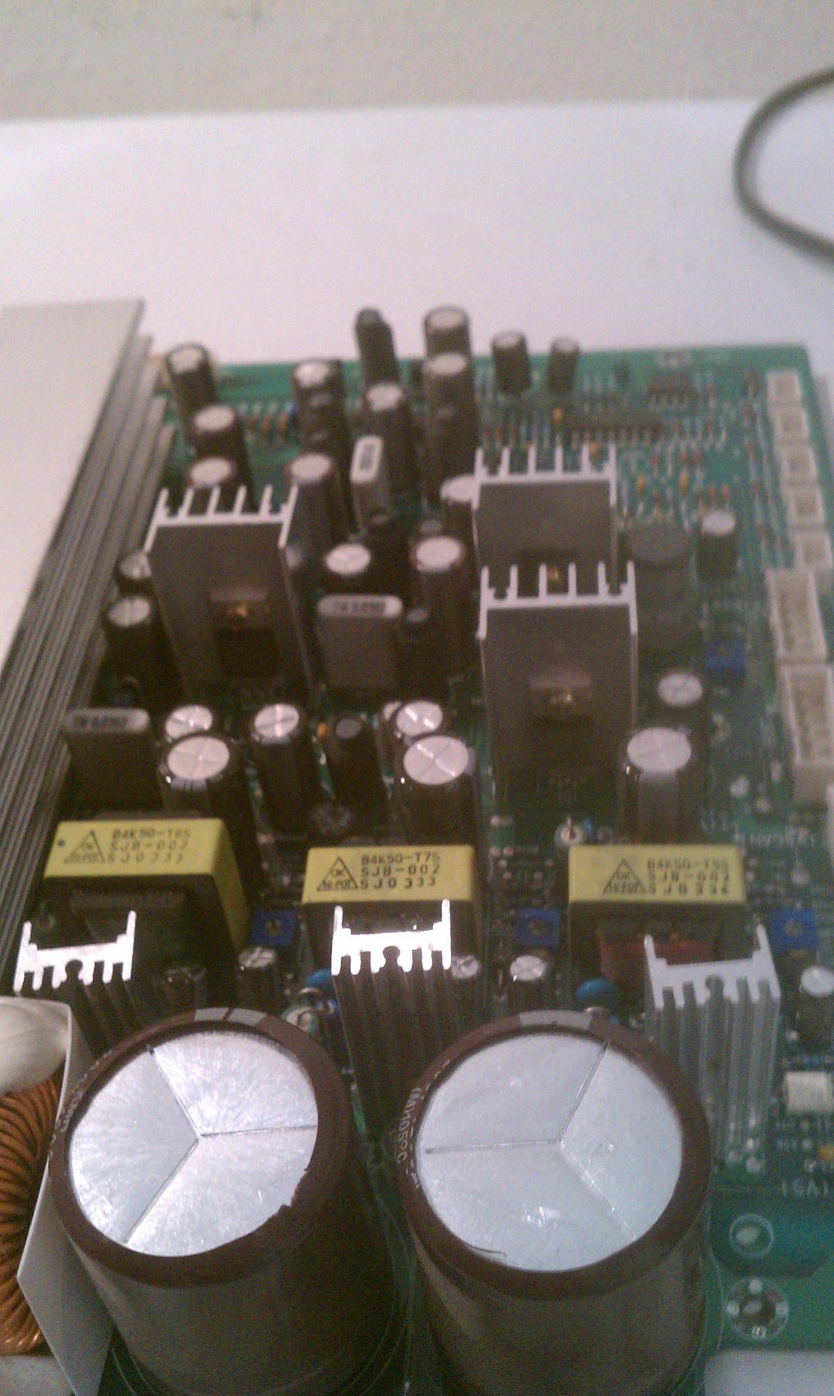

      Ok I popped the poly caps off all these caps. The 2 black ones(450v) look to be split a bit on the top and the brown (200v) are not split or bulged. I forgot to say earlier, that I did already order all these caps from digi because I knew someone that was placing an order, so I jumped in with him...

          Ah yeah, definitely bulged.

          A few things to check.

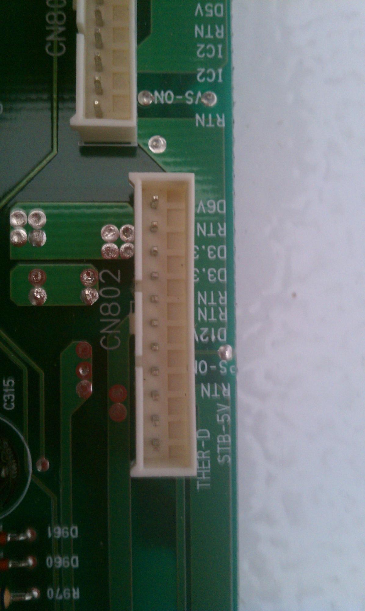

          Do you get stable 5V standby? (There should be a pin or two marked 5Vstby, 5Vst...) Check the voltage with the black probe in a spare screw hole on the back of the frame.
          Are all the fuses on the power supply good? I have seen plasma TVs with a separate fuse for the high voltage PFC bus. Check all fuses you can see.
          After you replace the caps, more testing can be done.

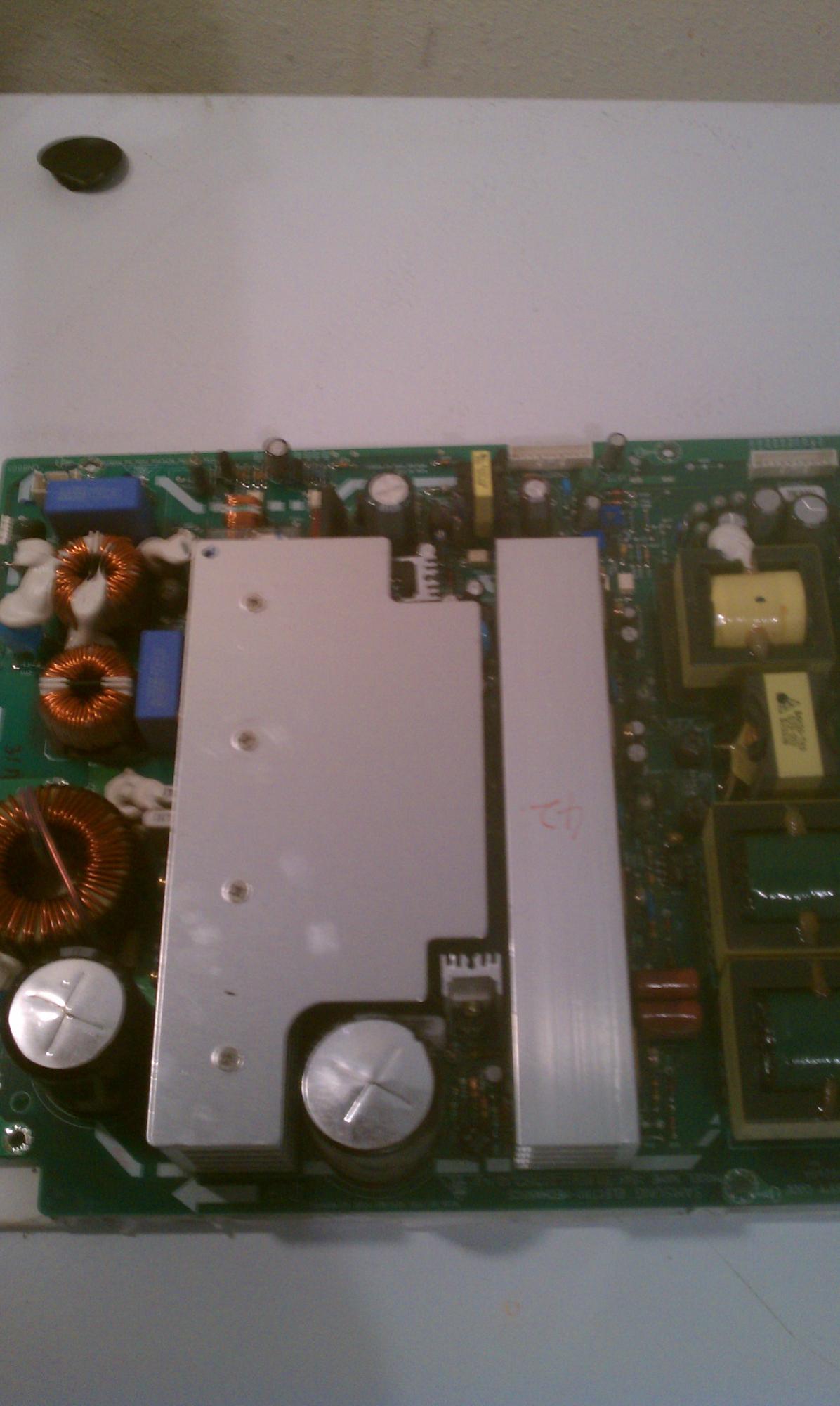

            Yes I replaced all the 250v t8ah with some 250v 8a fuses I had from an old stereo that would blow fuses all the time.. Ok I am getting ready to show my lack of experience with this kind of stuff . I have the board removed from the chassis and sitting on a work bench.. Do I need to reinstall it ? Do I need to have it hooked up to 110? And to be real honest, I am not sure which setting to use on my meter.. I warned ya that I am not a guru I really like my life and dont want it to end by a TV sending me to meet my maker LOL.. Oh and I am a woman but not a blonde
              Yes. Reinstalled.
              And yes, hooked up to 110v. But don't turn the TV on just yet.
              Set your meter to DCV (red).
              Use any screw for ground with the black probe.
              Then with the red probe check the pink plug going to the signal board.
              Start on the left (blue wire) I think 5Vsb is the second wire.
              Because of the giant heatsink in the way on the powerboard side. I would reccomend checking it on the signal board side, where there's more room. Unplug first it if you have to, (with the TV off).
              There's also 5Vsb on the Y-sustain and Z-sustain. (left and right sides of the TV, they have heatsinks covered in black, and rows of 16 capacitors.)

                            Ok all glass fuses are new and I am getting 5.05 V on the 5v stb

                                        Well all caps replaced smoothly.. BUT SAME OL PROBLEM.. Any have any other ideas?
