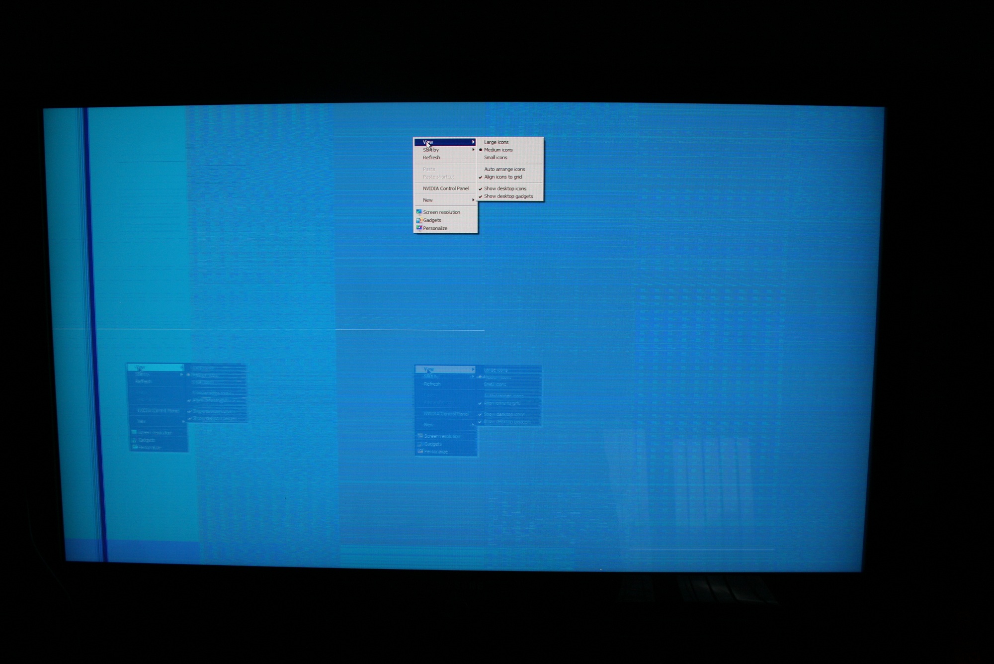

    Just picked up this this TV.
    The reported issues were lines down the left hand side of the screen and no sound.
    I have plugged it in and can see the lines down the left hand side of the screen. As you can see in the picture though the whole screen seems to be ghosting and suffering from interference.
    It also looks like when you push on the screen some of the interference goes but the lines and the ghosting remains.
    I am going to have the back off shortly to try and reseat the cables and see if that has any effect.

    Looks a lot like a T-con problem. The ghosting is probably caused by insufficient OFF voltage, which is used to turn off the pixels in the LCD. Budm might be able to help here.
    To eliminate the main board and cabling (to T-con), you can try the trick of changing the LVDS format.

        Yeah I looked in the menu but couldn't find the LVDS option I will get back into the menu and see if I can find it. I have found out why there is not sound.... Someone has removed the speakers! There were also some wedges in the top of the screen so someone has tried to remove the ghosting with them.
        Looks like I have a right dog here.

                Jeez no one mentioned this yet????
                46 and 52" samsungs and sonys > from 2008-2010 , samsung brand panels
                These all get tab bonding issues where you get a darker picture and ghosting. usually its the top left tab and pressing on it, or twisting the whole tv will fix the picture. The wedges were probably an attempt to fix tab bonding issues, but they could have put too much pressure and missaligned the tab at the top > causing your lines.
                This is generally not fixable.

                  I thought it might have had something to do with the tab bondings.
                  twisting makes it better but does not cure it. I assume they have damaged it. Oh well I am sure I can get something back for the T-com, main board, power supply and inverter boards.

                      Im gutted that I managed to get rid of the black lines by playing with the tab bond but then when I put it all back together it resulted in a solid thick black line.
