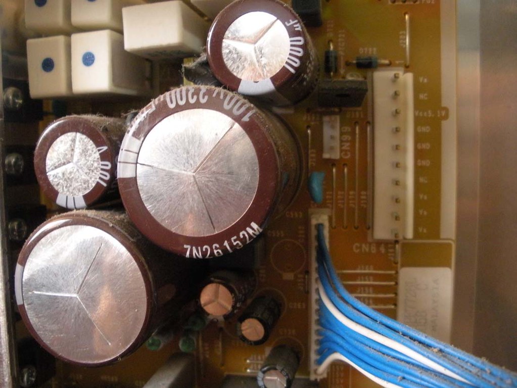

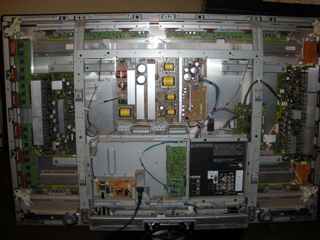

          Ok, got the unit.
          There appears to be either a power supply or main board issue:
          The large caps (upper right side) close to the Va and Vs connector
          appear to be bulging a bit:

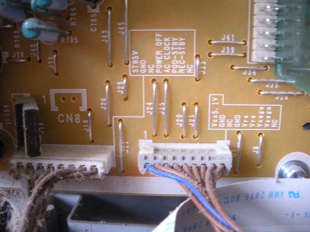

          And after disconnecting the X-SUS connector,
          both the Va and Vs are only at about 4 volts
          or so (panel says Vs should be 88.9V, and
          Va should be 65.3V), and they do NOT
          change with turning on the power. The
          front red "standby" LED, and blue "power
          on" LEDs work fine, as well as the "power
          save" LED.
          But the interesting thing is, is that a pin
          labeled "POWER OFF" does NOT change
          voltage, and remains at zero volts, even
          though the front blue LED indicates "power
          on":
          The STB5V and AC CLOCK, etc., all appear to
          have normal voltages.

            The three caps next to the heatsink on the right side all look bulged. Definitely replace them. Those are Chemicons, but this is an older set and it's likely they have simply reached end of life given their position.

              I've never encountered a plasma display using 90V for Vs. Very interesting. Typically it is 180-215V. Those caps are under a lot of stress, they will cost probably $10 to replace, but they are not the only problem. Likely you've got a s/c diode on the PSU, someone had a Hitachi here with the same problem, I think.
              POWER OFF is one of two things:
              - Signal from PSU to mainboard warning of imminent power failure (loss of AC, enough power for 100ms maybe)
              - Signal from mainboard to PSU telling PSU to discharge Vs caps (safety) - top right resistors and SCRs handle that
              Probably second one, as AC CLOCK is enough for power fail detect.
              Check POD_STBY and REC_STBY, and main supply rails.

                What do you mean by "s/c" diode? Do you have the link to the
                thread with the same problem?
                Ok, so "POWER OFF" is a signal to turn the unit off...duh!
                Here are the voltages:
                Power Off:
                AC_CLOCK = +3.3V
                POD_STBY = 0 V
                REC_STBY = 0 V
                Vcc5.1V = 0 V
                Power ON:
                AC_CLOCK = +3.3V
                POD_STBY = +4.7V
                REC_STBY = +3.1V
                Vcc5.1V = 5 V
                Is Mouser the best/cheapest place to order these caps?
                They are 3300uF, 100V, 105 deg C
                  Re: Dude is bringing over a Hitachi P50S601 (plasma 1080)
                  s/c is technician shorthand notation: Means short circuit. Most diodes fail leaky or s/c.
                  Mouser is good - I used them before for plasma TV caps 250V 560uF that were difficult to source.
                  POWER OFF is used to safely discharge those big caps. I think it is a legal safety requirement. A Panasonic plasma I serviced had a very nice "high voltage" LED that would stay lit to warn you of this danger. It would glow for 20-30 seconds with no power.

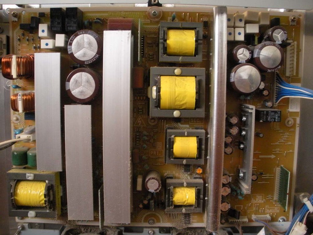

                      Ok, so I used this testing method:
                      https://cdn.badcaps-static.com/pdfs/...8a445601d2.pdf
                      And apparently, I have a bad lower buffer board. The top board
                      tested good, at least with the DMM.
                      From what I've read, the same exact two big caps will bulge, and
                      often will make Vs and/or Va too large a voltage, and this will
                      blow out either one or both of the buffer boards.
                      My plan: get the two big caps from Digikey:
                      http://search.digikey.com/us/en/prod...6809-ND/131655
                      Install them and verify the Va and Vs and good.
                      Then I will install only the top buffer board, to see if I get
                      the top half of the picture. This will hopefully verify that the
                      Y-SUS and X-SUS boards don't have any blown MOSFETs.
                      Only then will I order the lower buffer board:
                      http://cgi.ebay.com/ws/eBayISAPI.dll...tchlink:top:en
                      If successful, this would be my first plasma repair.
                      Thoughts?

                          Make that 3 big caps like i said. The smaller one between them looks suspicious too, and even if it isn't blown now, it'll go soon because it's right next to that heatsink just like the big ones. If the two big ones failed due to excess heat, the smaller one doesn't have much life left in it either.

                                  Ok, I just got my Russian Micro V4.0 ESR
                                  meter, and when I measured these big
                                  caps taken out-of-circuit, they were
                                  both about ESR = 0.04 Ohms, 2800uF
                                  each.
                                  So these are both well within the +/- 20%
                                  tolerance of these caps.
                                  The third and fourth smaller caps were about ESR = 0.05 Ohms,
                                  930uF, so both of them looked ok as well.
                                  I probably have some other issue, if this meter is
                                  to be trusted.
                                  I checked all the diodes in the vicinity, including the
                                  diodes mounted on the heat sink, and they all
                                  appear good.
                                  I also checked an 2SK3683 power mosfet, and
                                  it was good.
                                  Any ideas moving forward appreciated.....will have
                                  pics soon....

                                        Those 100v 3300 uf caps are bad on every one of these power supplies and very common failure.
                                        the secondary voltages are running at 85 volts at these caps.
                                        I have not had any other cap issues on this power supply other than these two large caps.
                                        These are narrow caps and you have to watch when ordering replacements.

                                        The best way to check these tvs is to unplug the upper or lower buffer board.
                                        If the tv power supply was going into protect mode you can unplug one buffer at a time.
                                        You can not check these like the l/g tvs, that, is you can`t unplug the y or z and have the tv power up. It won`t do anything unless all the boards are plugged in.
                                        You can unplug the buffer boards and the tv will still power up.
                                        I have found these in China on feebay for around 120.00 for the pair new.
                                        These tvs have a great picture. (you have a good panel with multiple buffer ics)
                                        This tv is very much worth repairing.
