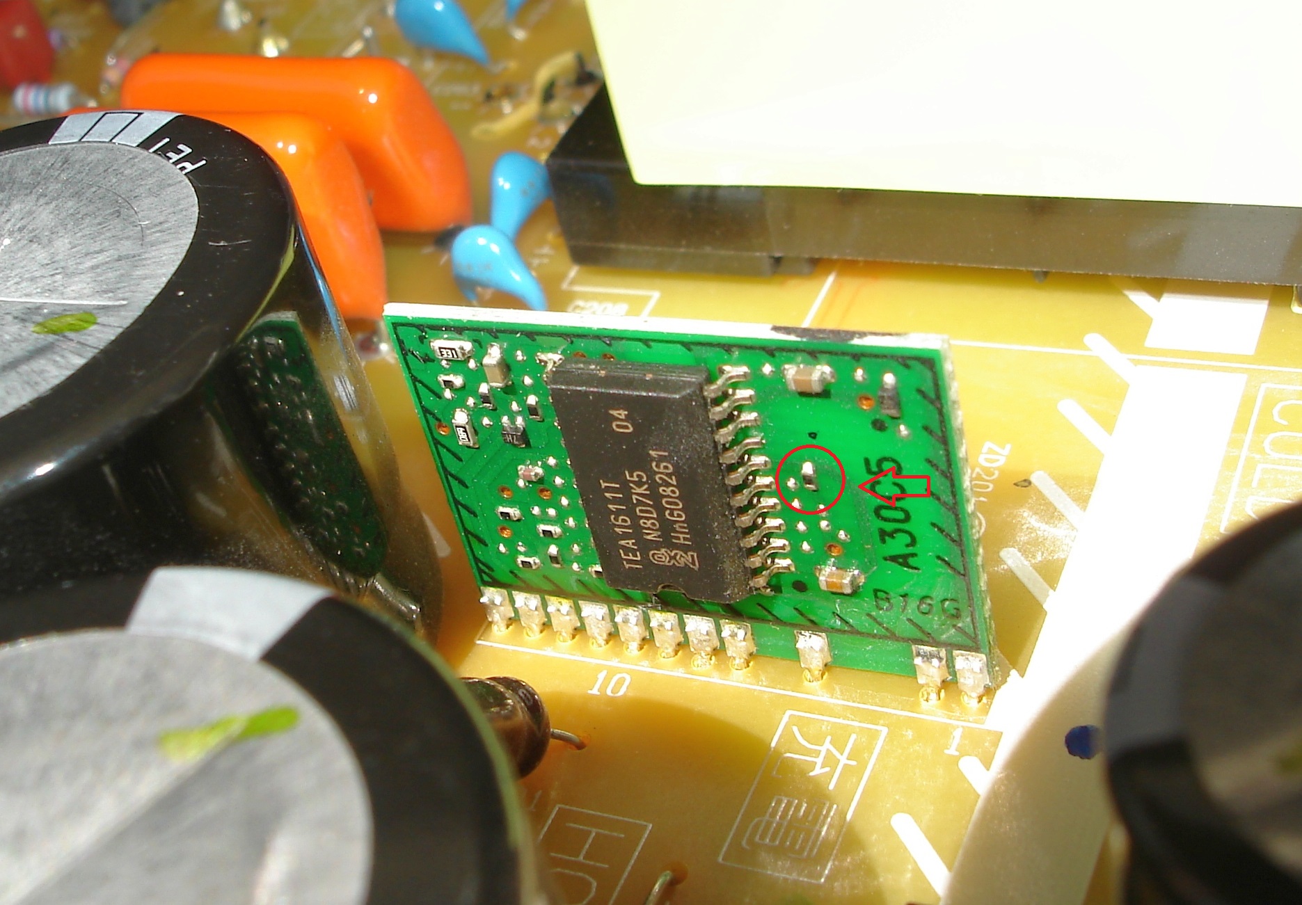

                  Re: TV Panasonic TH-50PZ85U 2 blinks
                  Originally posted by Mishannya View Post
                  More pictures of MC201 and MC301 added.
                  Hi, can anybody tell me the value of the resistor between pin 13 and 14 of TEA1611??
                  Need this very quick. Thanks alot.

                                Okay, so I'm apparently a klutz... Can someone give me a solution to my problem. I accidentally desoldered and lost the highlighted capacitor in the picture. What can I do if there is no hope for finding it? Can I buy a new one? or a new MC301 board?
                                I would be forever grateful for a response...
                                  #36
                                  Not a capacitor. It's a resistor. Your only hope is someone with an MC201/301 board that someone can use to check the value of that resistor.
                                  Otherwise, you will have to replace entire power supply board.
                                        I did find this! But, it's probably not any help without knowing what I need replaced... http://industrial.panasonic.com/www-...OA0000_WW.html
