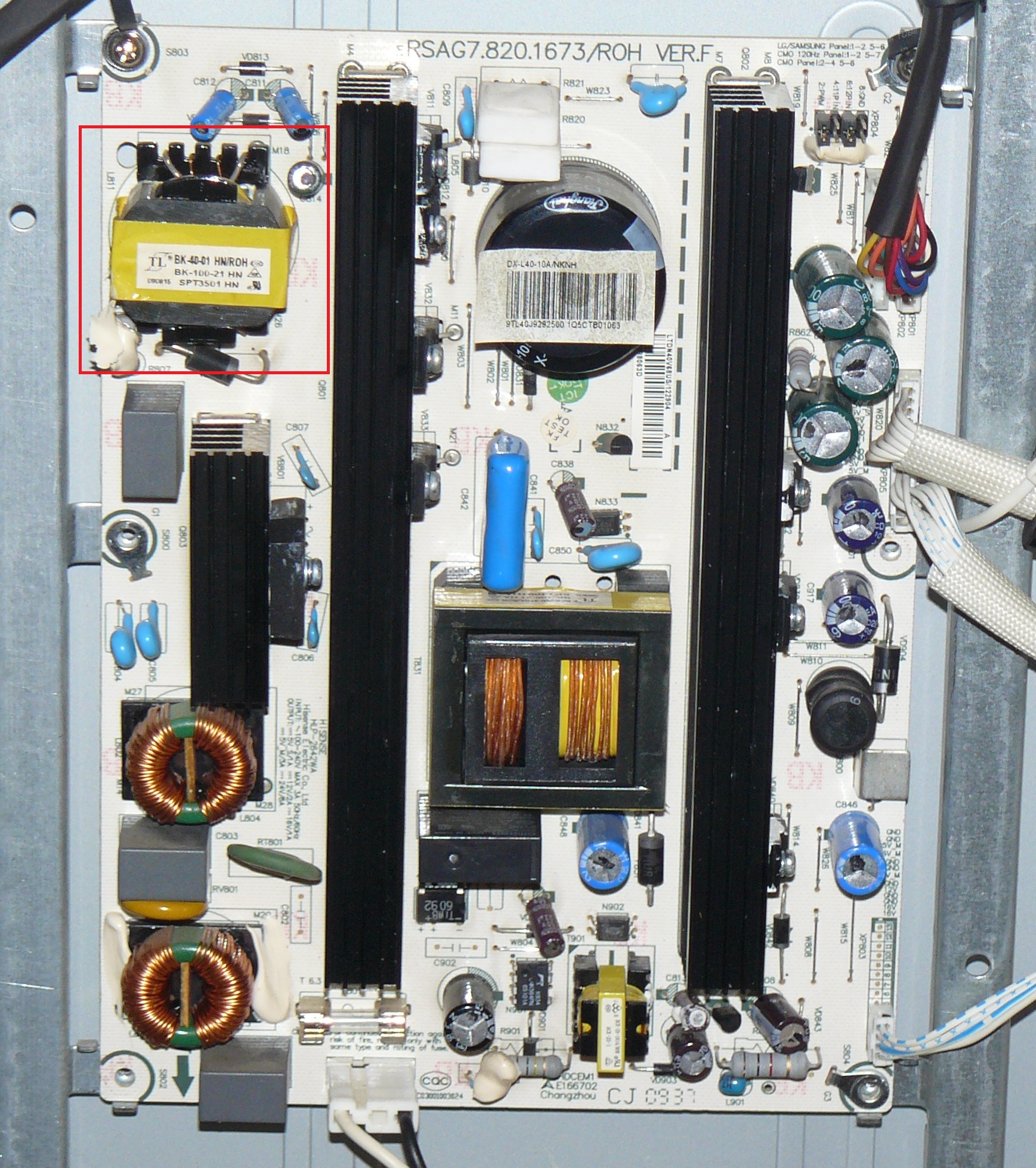

                            #33
                            Re: Dynex DX-L40-10A
                            That is the PFC Voltage boost Inductor with sensing winding.
