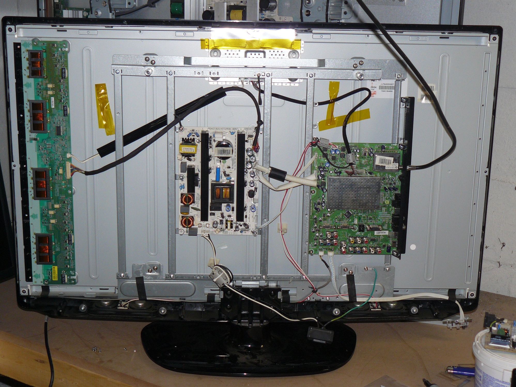

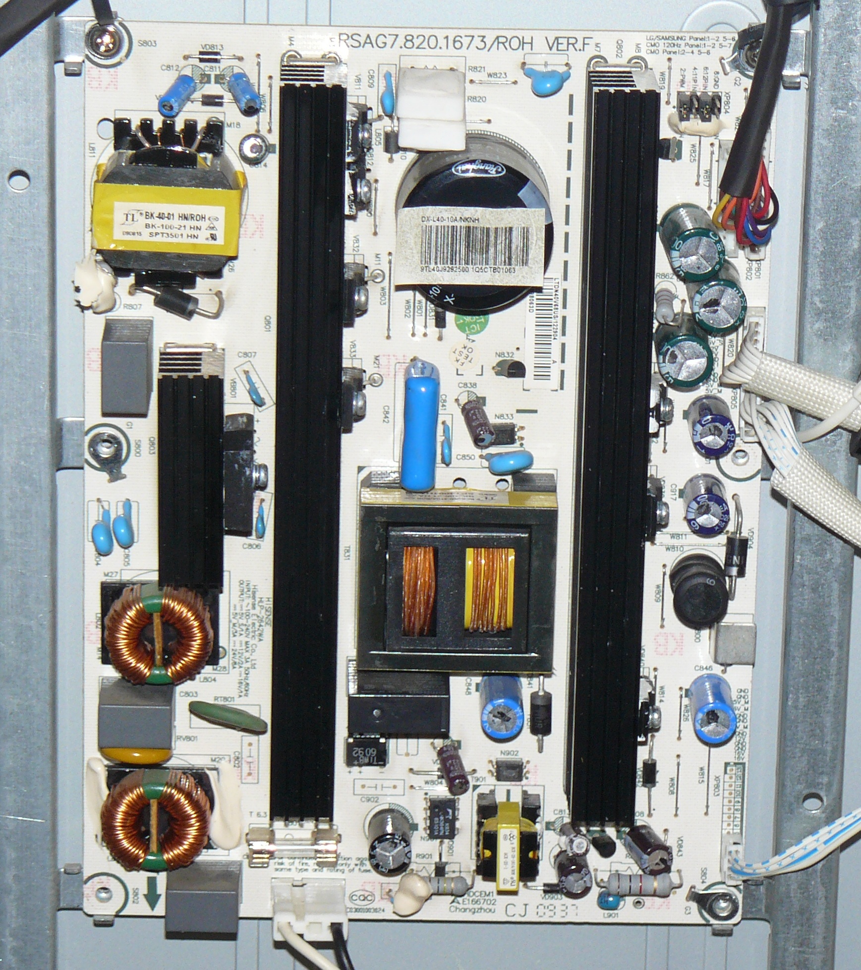

    This tv is acting strange. When you first plug it in, led red (standby) you can hear static through the speakers like its on cable with no signal (snow). The snow sound does crackle. After a minute the sound gets less and less to the point you can barely hear it. If i unplug it and then plug it back in it restarts the snow sound. On the rare occasion i plug it in and i don't get the snow sound i can power it on with the keyboard but i get no screen. I shined my mag lite in several different spots but i can't find an image at all. When the tv does turn on if i try to turn it off with the keyboard it won't. I have to unplug it. I did get some voltage readings the few times i did get it to turn on.
    5V and i'm getting 5.09
    12V, i'm getting 11.75
    16v, i'm getting 16.23
    24v, i'm getting 24.45
    The power supply is full of "peace" caps?? I've never heard of them and i can't find a datasheet for them. I did a quick esr checking in circuit and all the caps with the exception of the really big one and a smaller 4.7uf 450v, they are all in the .03 - .05 ohm range.
    Scribd has the service manual. Doesn't give me much troubleshooting info. The flow charts all point to replace mainboard if the keyboard doesn't work and a no video. It does give schematics which to me is like reading greek at the moment. The BL on/off reading with the tv on is 2.877 and if i'm looking at the shematics right i think it needs to be in 3.3 range.
    I am lost.
    Here is the link for the service manual
    http://www.scribd.com/doc/72513882/D...ual-DX-L40-10A
    Would a shorted audio amp maybe cause the power supply to not fire up, protection mode? The led does not flash.
    Thanks for any advice

    Did you try powering up without the power cable to the inverter board? The power supply seems to be working with all the voltages you see. It detects something and goes into shutdown?

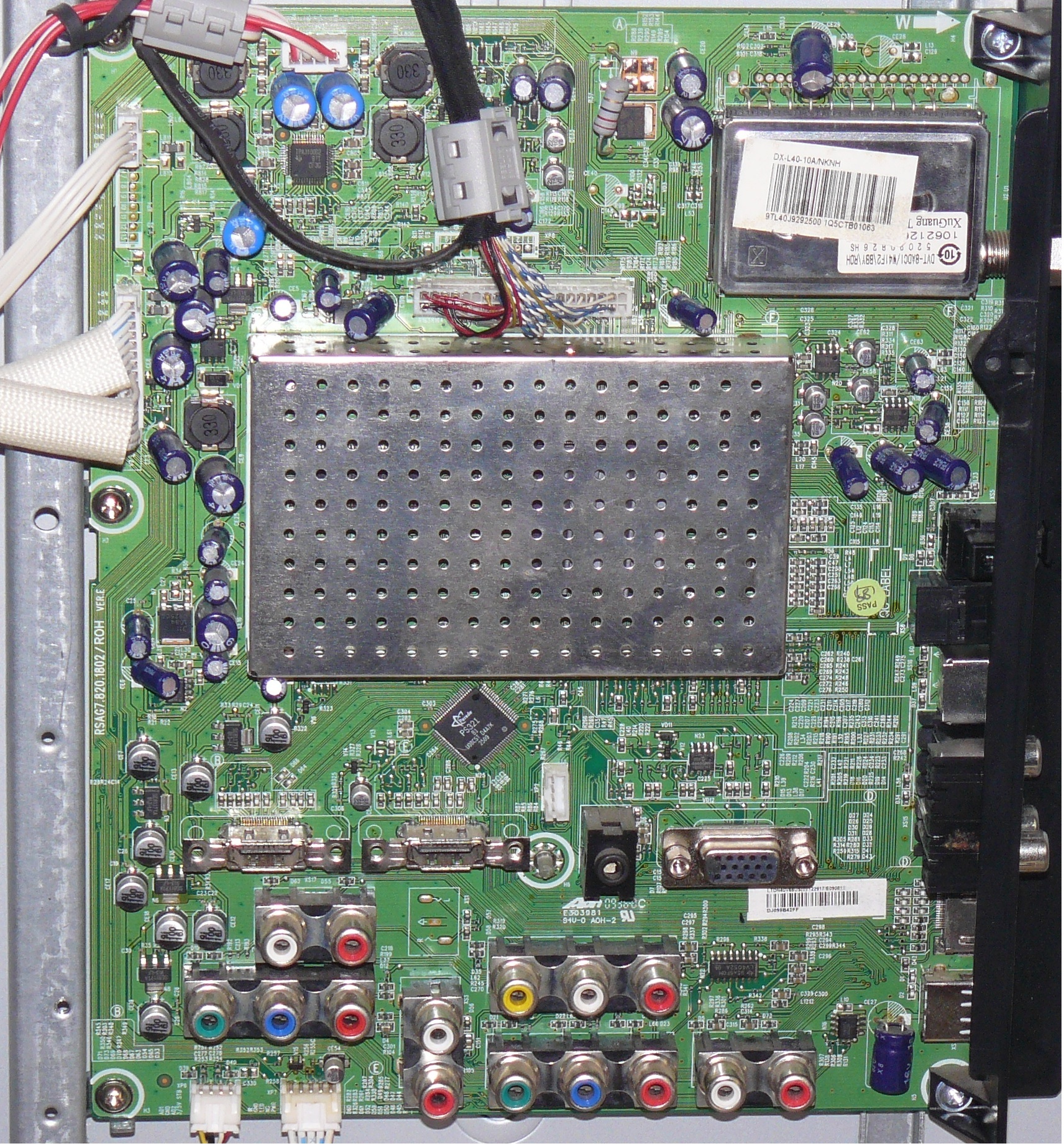

      I'm still getting the snow sound from the speakers. Have you ever heard of noise through the speakers when the tv is in standby?
        Re: Dynex DX-L40-10A
        No, I wonder if you may have unstable power on the main board due to bad regulators?

            I discovered something odd. When i get the snow sound from the speakers (led red/standby) i'm getting all the voltages i posted in post #1. Now after serveral on/off cycles with the power cord to get the no snow sound (led red/standby) i only get 4.76von the 5v pin, almost nothing on the 12, 16, 24 pins. I'm wondering if the power supply is send voltages to the main board that it shouldn't causing the mainboard to give me the snow sound.
              That does not make sense to me since the main board is the one that sends the PS_ON signal to the power supply board to turn on the 12, 16, and the 24vdc on. Is sounds like the main board is stuck in the ON mode even though it is supposed to be in standby mode.
              We need to locate the PS_ON pin on the power supply to see what is going on there.
                  I think the STB (on_standby) or the SW is the PS_ON pin, measure them with the set off and with the set on.
                  I think these voltages are:
                  5v_s = 5Vdc standby, always on
                  5v_m = 5V main, switched on by the PS_ON.
                  12V = 12V main, switched on by the PS_ON.
                  br = backlights brightness control.
                  sw = may be PS_ON or Backlights inverter on control signal.

                                I just plugged in the tv and the backlight actually turned in this time. I quickly went to check the voltage at the stb pin and it was 2.875. The screen was putting horizontal lines that were scrolling from top to bottom. I was getting the (snow) sound from the speakers. The keypad still wouldn't turn off. Should the stb pin be in the 3.3 range? There are 5 voltage regulators on the main board
                                SE8117TA
                                913-LF
                                From what i'm seeing on the datasheet i believe its an adjustable regulator. If it was a fixed there would be a 25, 33, ect at the end of the SE8117TA. I did hear a buzz from the transformer before the snow sound started again. Afer i unplugged it i plugged it back in and naturally the backlight wouldn't come back on for me to verify the noise.
                                • Mr Bill
                                  • Nov 2011
                                  • 648
                                  I checked the voltage regulators and according to the schematic i'm nowhere near what it should be. Do the resistors dictate the output voltage? Even the input voltage isn't high enough. Here are my results
                                  (N1) Vin=5v Vout=?? I'm getting 3.184vin & 1.245v out. R19=180ohm (i'm getting 180.1) R20=300ohm (i'm getting 299.4)
                                  (N3) Vin=5v Vout=3.3v, i'm getting 3.127v in & 1.263v out. R24=180ohm (i'm getting 179) R28=300ohm (i'm getting 298.9)
                                  (N5) Vin=5v Vout=3.3v, i'm getting 2.863v in & 1.599v out. R29=180ohm (i'm getting 176.3) R33=300ohm (i'm getting 136.2)
                                  (N6) Vin=5v Vout=2.5v, I'm getting 4.49v in & .756v out R31=100ohm (i'm getting 100.0) R32=100ohm (i'm getting 100.5 out)
                                  (N8) Vin=?? Vout=1.25v, i'm getting 1.518v in & .532v out, R35=100ohm (i'm getting 59.2 ohm) R36=0 ohm (i'm getting 0.000ohm)
                                  So R35 & R33 are reading low but i thought when a resistor fails the resistance goes up. I don't know where to look about the input voltages being low.
                                    Hi Bill,
                                    I look at page 38, it shows you what you should get at Vo, it even gives you the formula to calculate the Vo value, please see the PDF.
                                    • Mr Bill
                                      • Nov 2011
                                      • 648
                                      i just noticed my schematic didn't show the black text on it. I had to print it and scan because i couldn't pull the 1 particular page from the service manual. All the the voltages are low on the regulators.
                                        If the input are OK, but the out is out off the spec of the expected Vo base on the spec of the regulator, then I would say it is bad, not sure the spec of each regulators are, 5%, 10%
