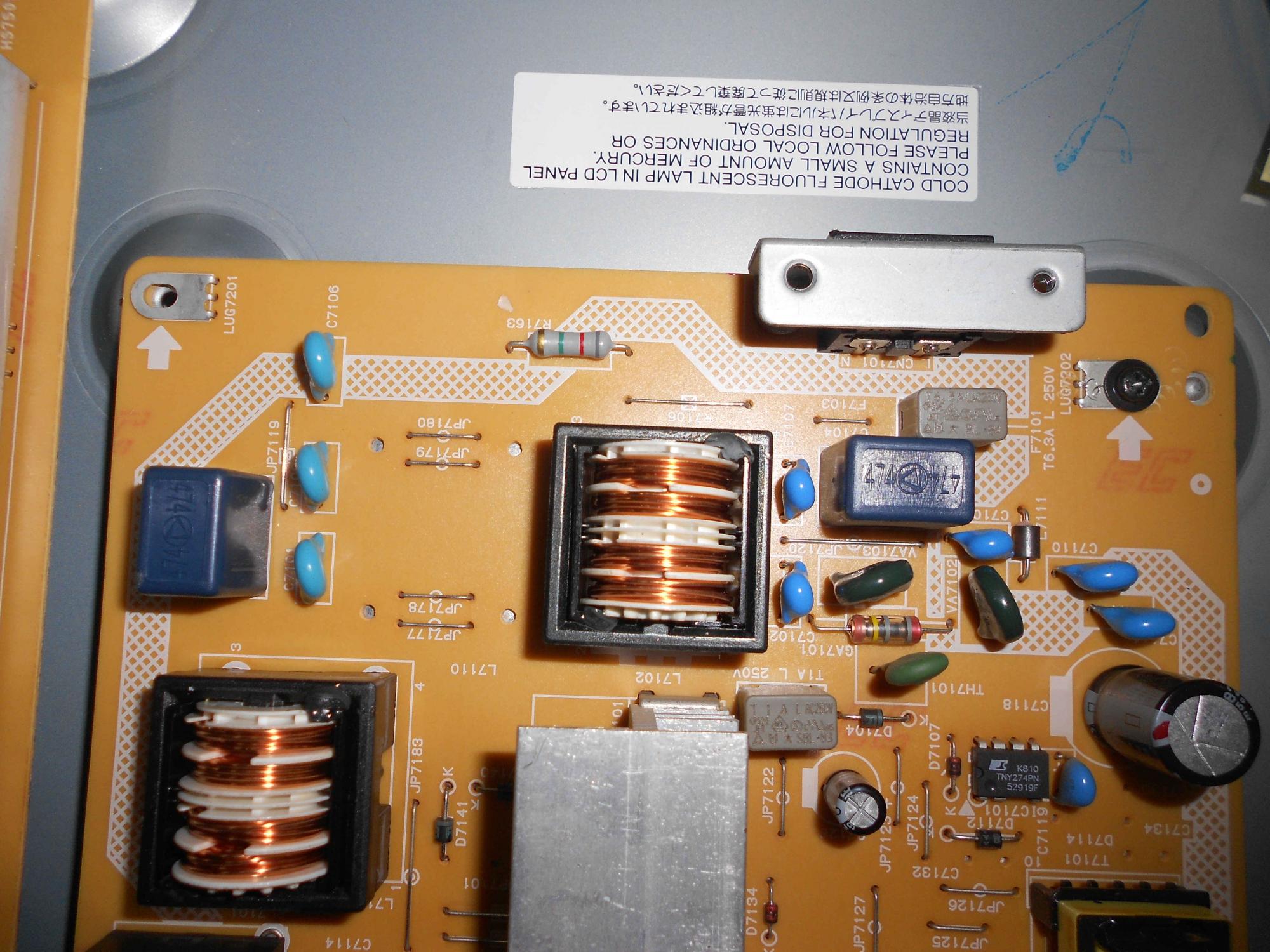

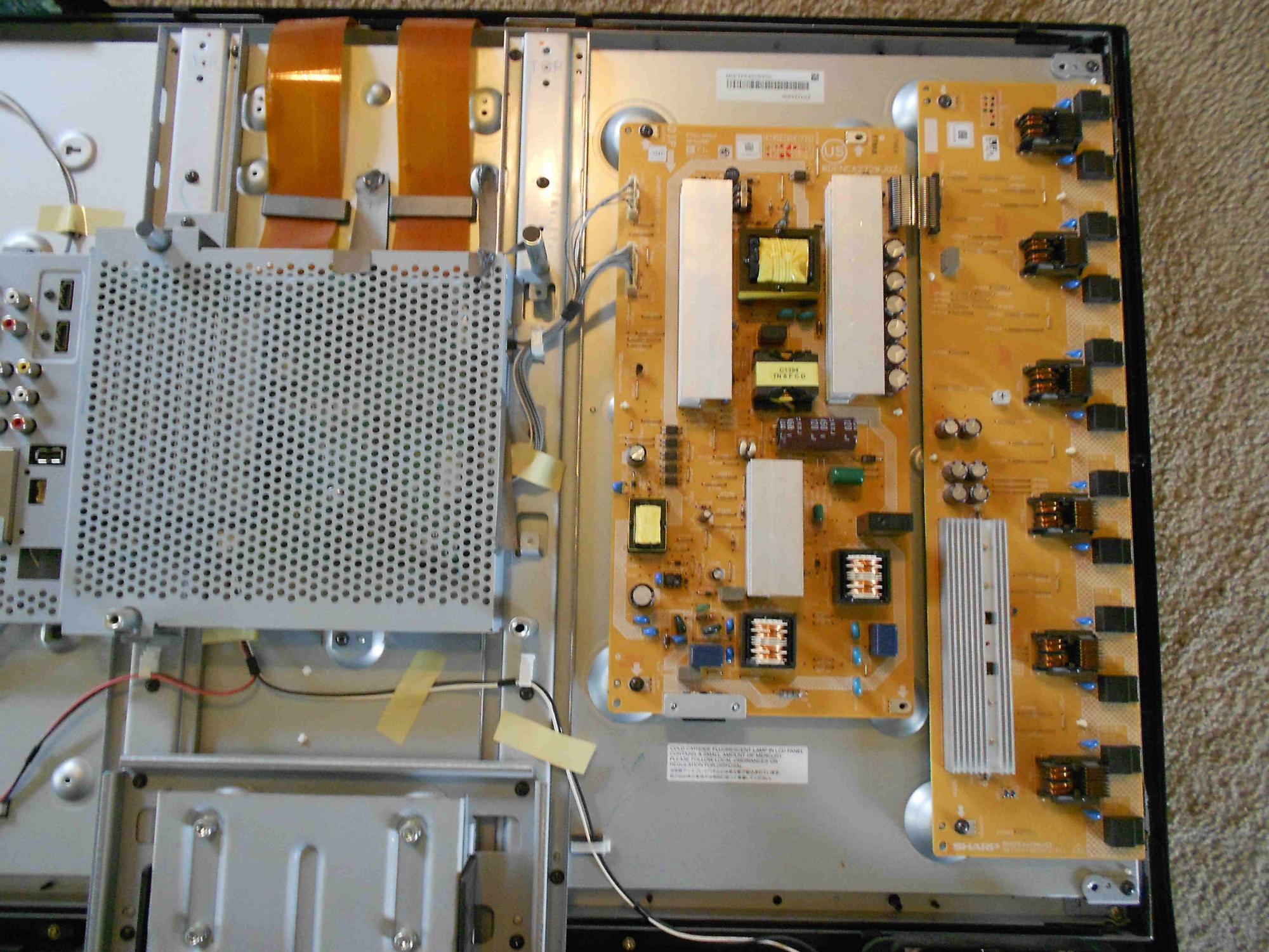

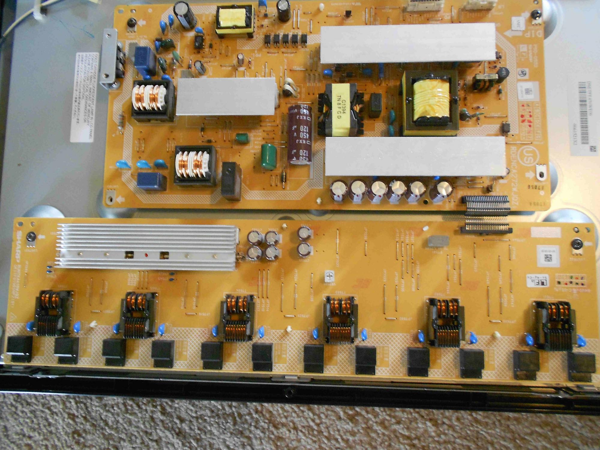

Here I some pics of the boards. None of the capacitors show signs of being bad. I checked for cracked solder on the two boards in the pics, didnt see any but I imagine there hard to find if they are cracked. I did a reset, hold channel down and up volume buttons while plugging the TV in. I now get a green "on" light and a blue screen but nothing else. Thought about just buying a used power supply board and trying that. Any suggestions would be appreciated.Attached Filesif you find these attachements useful please consider making a small donation to the site

Pics are not quite sharp enough we really need to be able to see the board designations. Please can you also post a pic of the bottom of the power board.

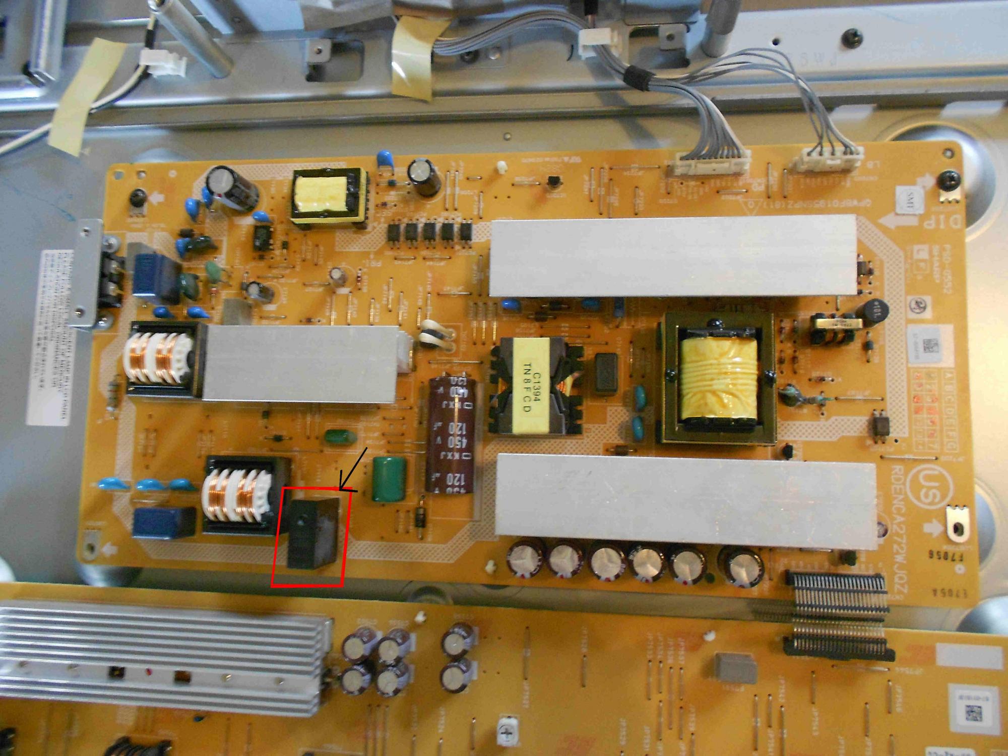

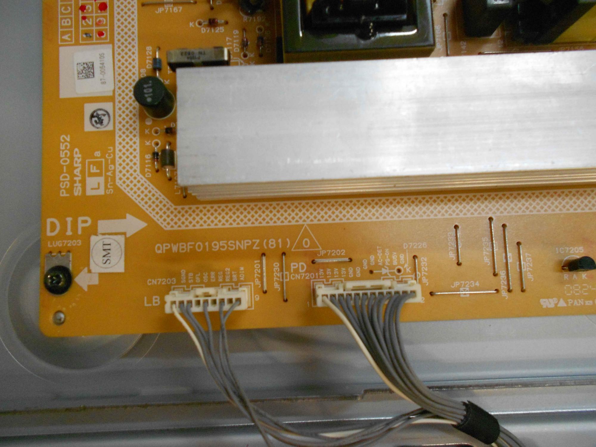

Not sure what you mean by board designations? Here's what happens. If I have the back on it, I do the reset, and the blue screen comes on, but no OSD, and the green power light stays on. If I reset it with the back off, I do not get the blue screen. The green power light comes on for approx 5 seconds, then the power light and the OPC light blink twice, then the OPC light blinks three times. I tested the voltage as you stated and only one pin, the 10 pin on the the 12 pin connector, had any voltage, which was 5v. I've attached a pic of the bottom of the PS and of the pin connectors. ThanksAttached Filesif you find these attachements useful please consider making a small donation to the site
Re: Sharp Lc37sb24u No Picture/audio
I also noticed that this relay(red box in picture) actually clicks "on" when the TV is first plugged in. At that time I get 37V at pins 1-4 on the 12 pin connector, then after about five seconds, the relay kicks "off" and the voltage to these 4 pins goes to zero volts. This is also when the power and OPC lights begin to flash.Attached Filesif you find these attachements useful please consider making a small donation to the site
