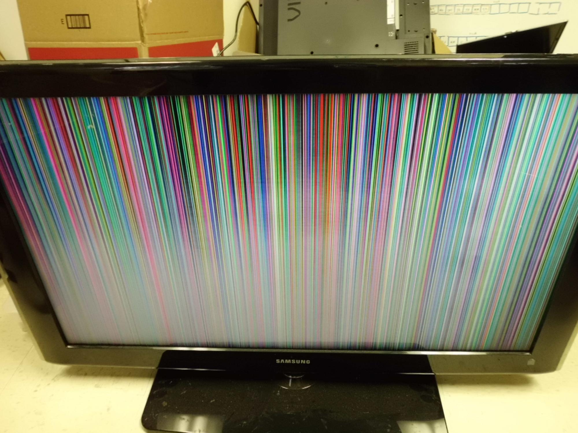

    Just had a Samsung LN-t4065F 42" dropped off by a friend that powers up but displays only vertical color lines. Have not opened it yet, but looking for suggestions on where to start looking. Loose T-con controller cable?

    Definitely looks like T-con. I had a similar problem with a Samsung which turned out to be a failed voltage regulator on the T-con.

      Thanks. Just got back to my desk and decided to try something I recalled from another thread. Held in the Menu button and powered on. Fired right up and clear picture from VGA source. I did notice a few pixels were striped, but went away as the image refreshed. Nice to know that it is not totally disfunctional. Taking the back cover off now.

        That may be a coincidence. When I saw the mentioned Samsung TV, it was faulty. When I got it home it actually worked - the regulator was intermittently failing. If the output voltage of that regulator is low, the T-con may be becoming confused, and the Menu button may be resetting it...

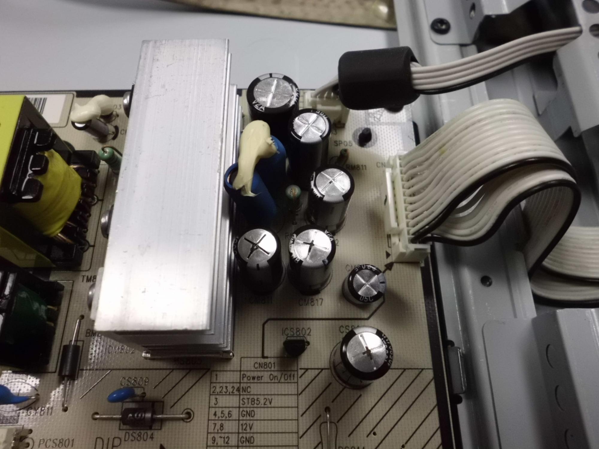

          Curious as to how you identified the failing regulator. I assume it was a three pin type regulator (Vin, Vout, GND)? Did you see ripple on the Vout or just watch the pin with a scope, looking for voltage level changes? Recall, which regulator it was?

            Opened it up this AM and right away noticed the bad caps on the PS. It is a Hansol BN44-00167A board and I found right many threads on various forums. Looking at the 1000uF @ 10V caps, I found ESR's in the 2.2 range. CM807, CM807 and CM809 had decent ESR readings of 0.1x - 0.2x and the main filtering cap was also 0.2x ohms.
            All I have in my parts drawer are some 1000uF @ 35V / 105 deg. capacitors. Can anyone tell me if the higher voltage rated caps can be used in place?

              The 35V caps will work if they are low ESR caps and IF they will fit.

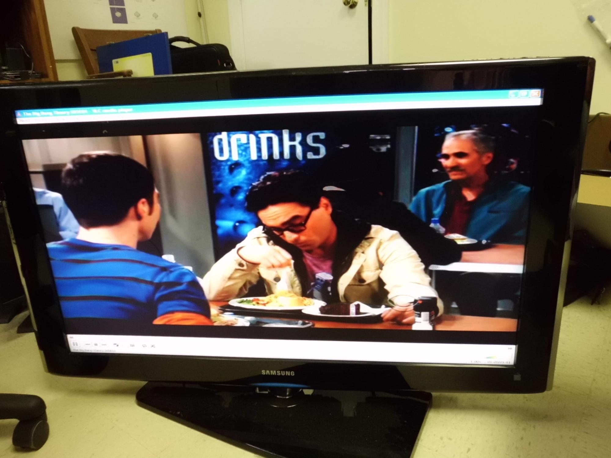

                Thanks. Just replaced four of the 1000uf 10V with 1000uF @ 35V and turned it on. Big Bang Theory is playing now! Thanks for the help guys.

                  On my board it was a standard 1117 regulator with a 2.5V output voltage, measuring close to 1.3V. The output voltage presumably would occasionally stabilise (as it worked once), but most of the time would be stuck at 1.3V.
