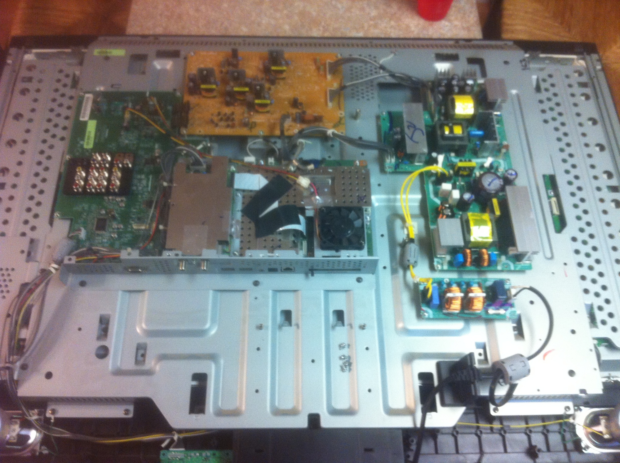

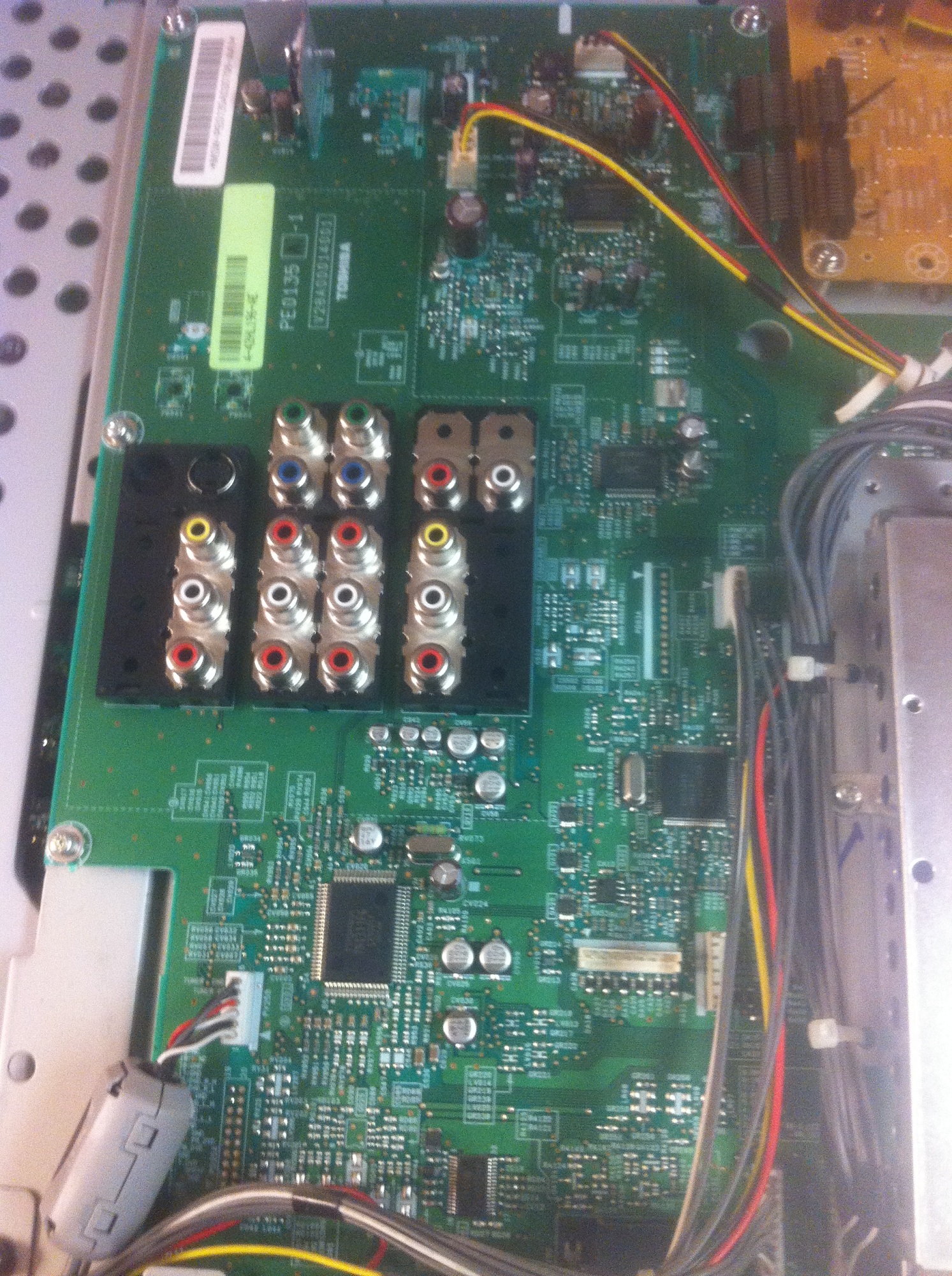

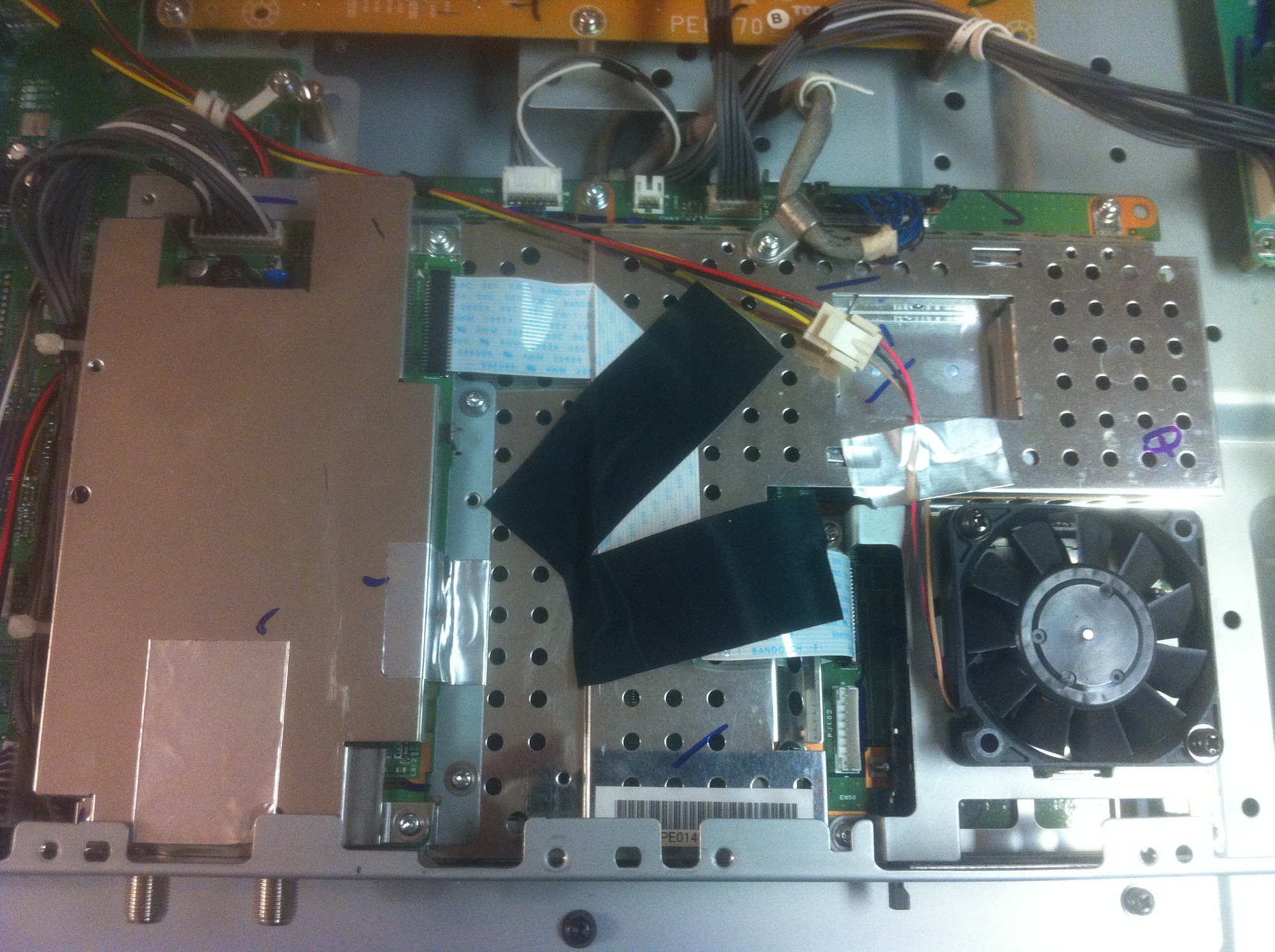

    I picked up this 42" toshiba LCD the other day and i'm getting around to checking it out. When the power button is pushed I'm getting 3 red flashes from the front led, then a pause and 3 more flashes. Checked under the hood and just shook my head, crap load of ugly boards inside this bugger. Either way. I checked my PS rails and i'm only getting the 5V stdby voltage. The ps_on pin isn't picking up a voltage. Typically I would look at the main board next but this one is different. It is loaded with different boards. It has the PS board, a "Lower B" board(someone please tell me what this is for, located in middle of tv with brown PCB), Seine (Main/Logic) board and another input board on the left side of tv.
    I've removed the Seine board and didn't find the typical LDO regulators that sometimes fail on a main board and basically everything on it is too small for me to replace. I'm thinking the PS_On is supplied through this (Seine) board but i'm not sure and want some input from the pro's here.
    Thanks in advance.

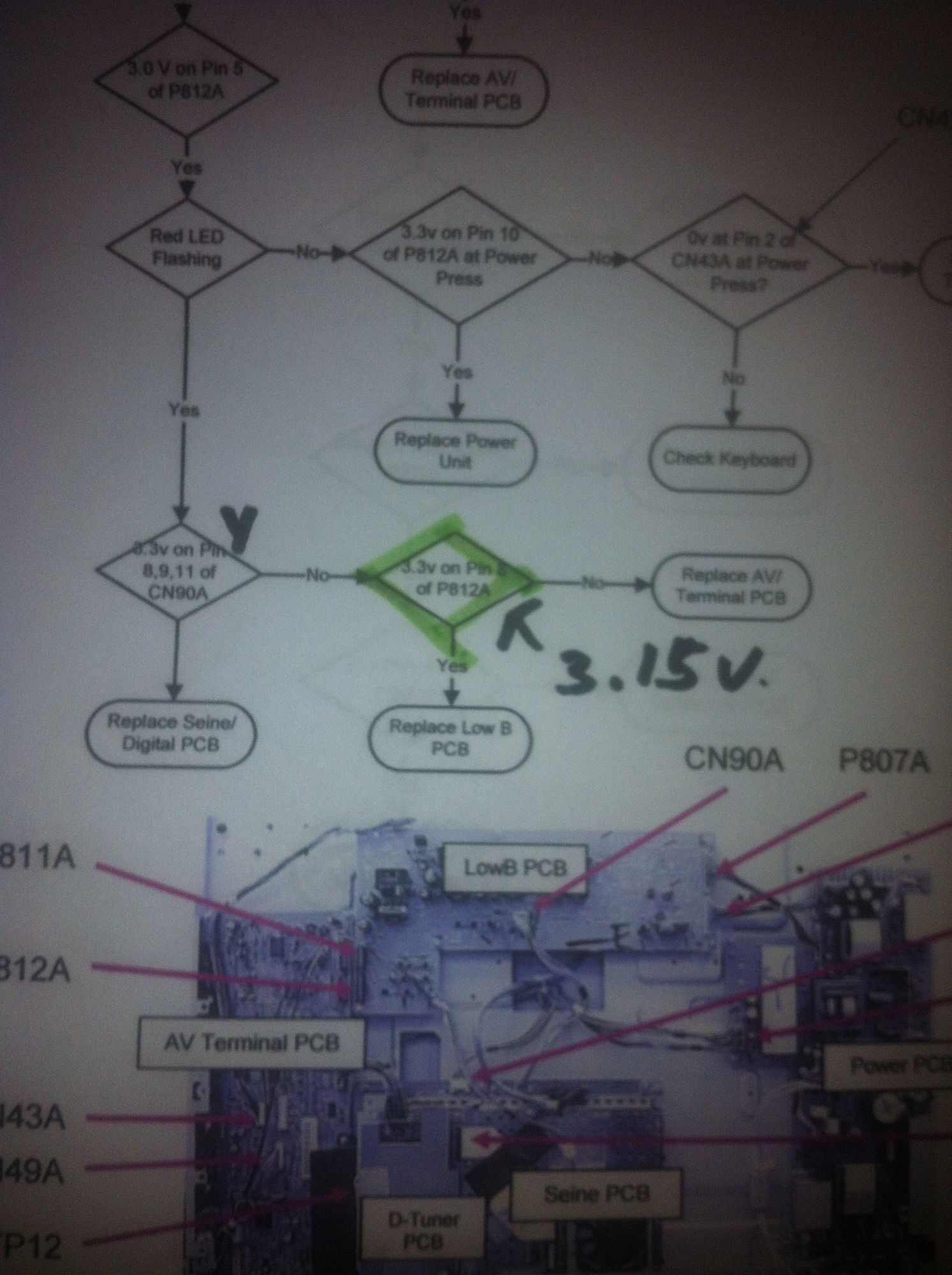

    OK, I've found a pretty good manual from scribd with a nice flow chart and found that on pin 8 from the AV/terminal board to the LOWB board on P812A is reading a bit low. It is supposed to be reading 3.3 and it's reading 3.15V. Not sure if this is low enough to be my problem or not but seems kinda low to me.
    • retiredcaps
      • Apr 2010
      • 9271
      Re: Toshiba 42HL196 No power 3 blinking lights, possible Seine board
      Most regulators have a +/-1% specification. Your reading is close to 5% out so i would say it is bad unless your multimeter is really out of whack.
        I was thinking 1% but wasn't sure. MM is good
          tried tracing the pin down but lost it and can't figure out where it goes, kind of looks like it goes to a small 40 pin IC. This board has a 5 pin transistor on it. How do I test it?
          • retiredcaps
            • Apr 2010
            • 9271
            For transistors, I do a simple in circuit test for shorts. Any reading under 30 ohms warrants desoldering and verifying out of circuit.
            Without knowning the part number, the easiest way would be to number the pins 1,2,3,4, and 5. Test 1-2, 1-3, 1-4, 1-5, 2-3, 2-4, 2-5, 3-4, 3-5, and 4-5.
            It would be wise to look for its datasheet because some pins may be shorted on purpose.
              1-2 is showing shorted but like you said it may be intentionial. I'm horrible at finding datasheets but I'll check it out again.

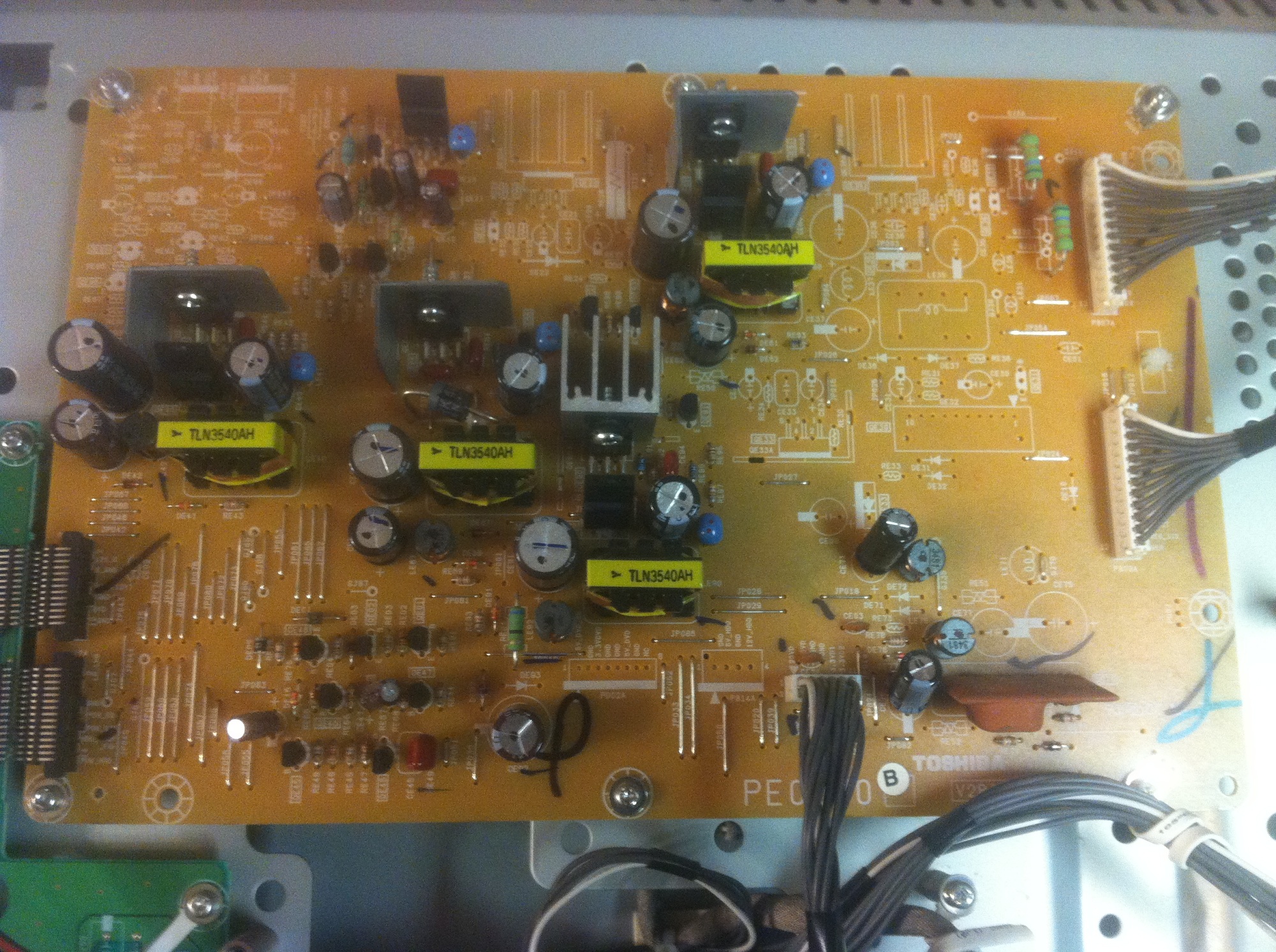

              Heres the numbers on it.
              00jc5w
              636 h59
              • Th3_uN1Qu3
                Believe in
                • Jul 2010
                • 6031
                • Romania
                It's a 1.5A low dropout regulator. http://www.alldatasheet.com/datashee...BA00JC5WT.html
                What voltage do you get on its output? That 3.15v doesn't sound like a bad reg, more of a bad capacitor after the reg, or one of the parts it is feeding drawing excess power.
                    I'm getting .382v on pin 1 and 2, 3 is my ground and 4 and 5 have 0 voltage.
                    • Th3_uN1Qu3
                      Believe in
                      • Jul 2010
                      • 6031
                      • Romania
                      You don't have the right input voltage, where is the input of this reg coming from? Input should be 5v or 3.3v. As for the output, the control pin is also low, so the regulator is in shutdown mode, hence the output is zero.
                      A working TV? How boring!
                          Pin 1 and 2 are reading short so I'm thinking this regulator is trash
                            Time to unsolder it and see if the short is in the part itself or on the board.

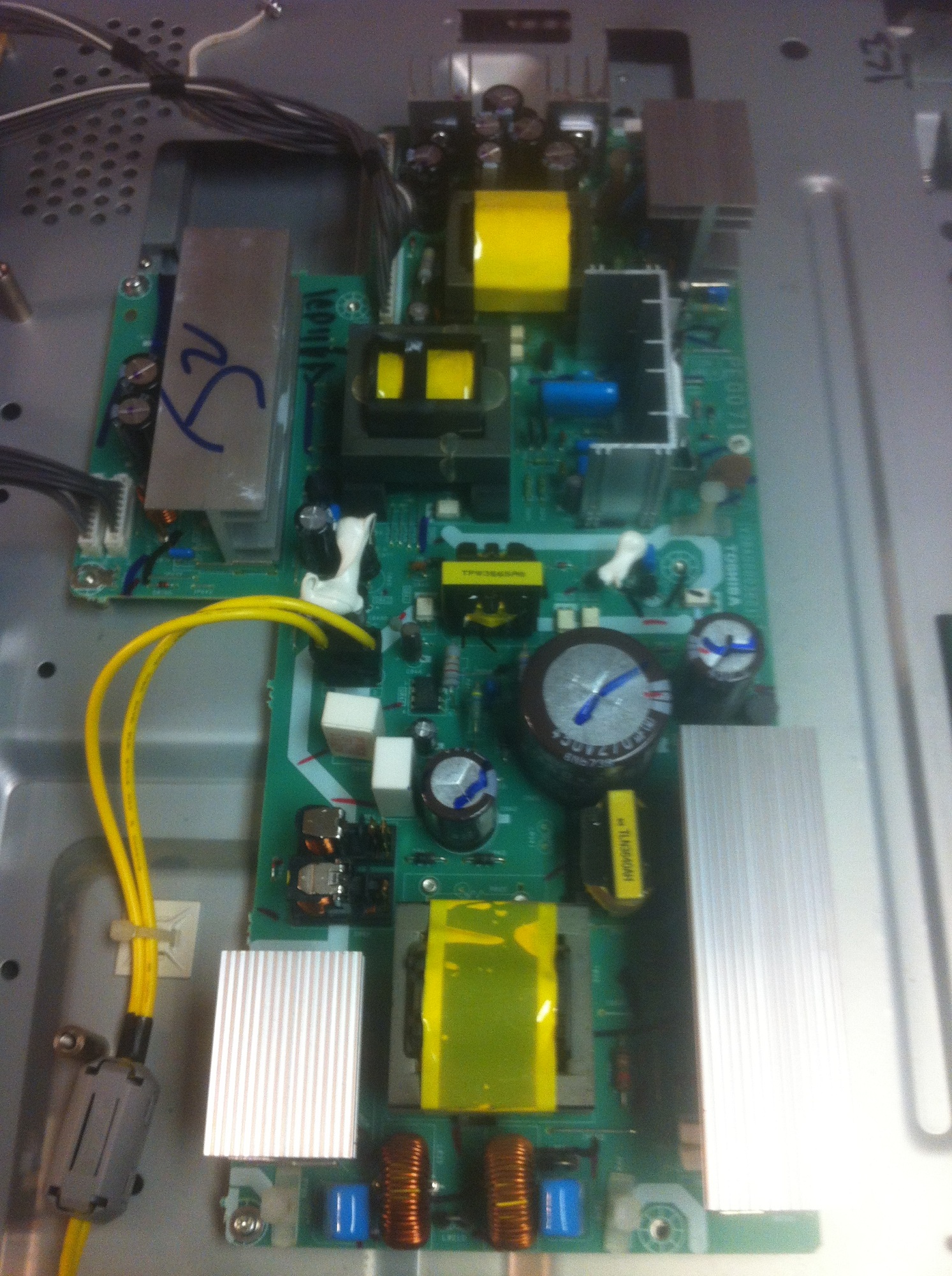

                              Q880 is strw6765 goes bad on those power supplies --turns on 12v to 12volt relay sr81 on power board pe0071g-1 if same -power SUPPLY board -this real common COST 5-12 DOLLARS + SHIP
                              COMMON FIX FOR DEAD/ AND BLINK LIGHT- will see if fixes mine -part will be here tomorrow.
                              also -strz-4479-Q860 ,
                              and srx-2039 Q820
                              • jackslater
                                • Jan 2012
                                • 20
                                Just put strw6765 - set works fired right up - old was was cook to heat sink
                                rip some pads off PB bottom.
                                Recommend anyone - new like me unsolder pads before trying to free regulator-
                                Also note
                                No more click click click - just two solid click-=when plug in - also had 3.3 on protect line
                                You also want to replace srx-2039 that factory Toshiba recommend - according to another forum -
                                    pulled from board and tested good. Time to move onto something else.

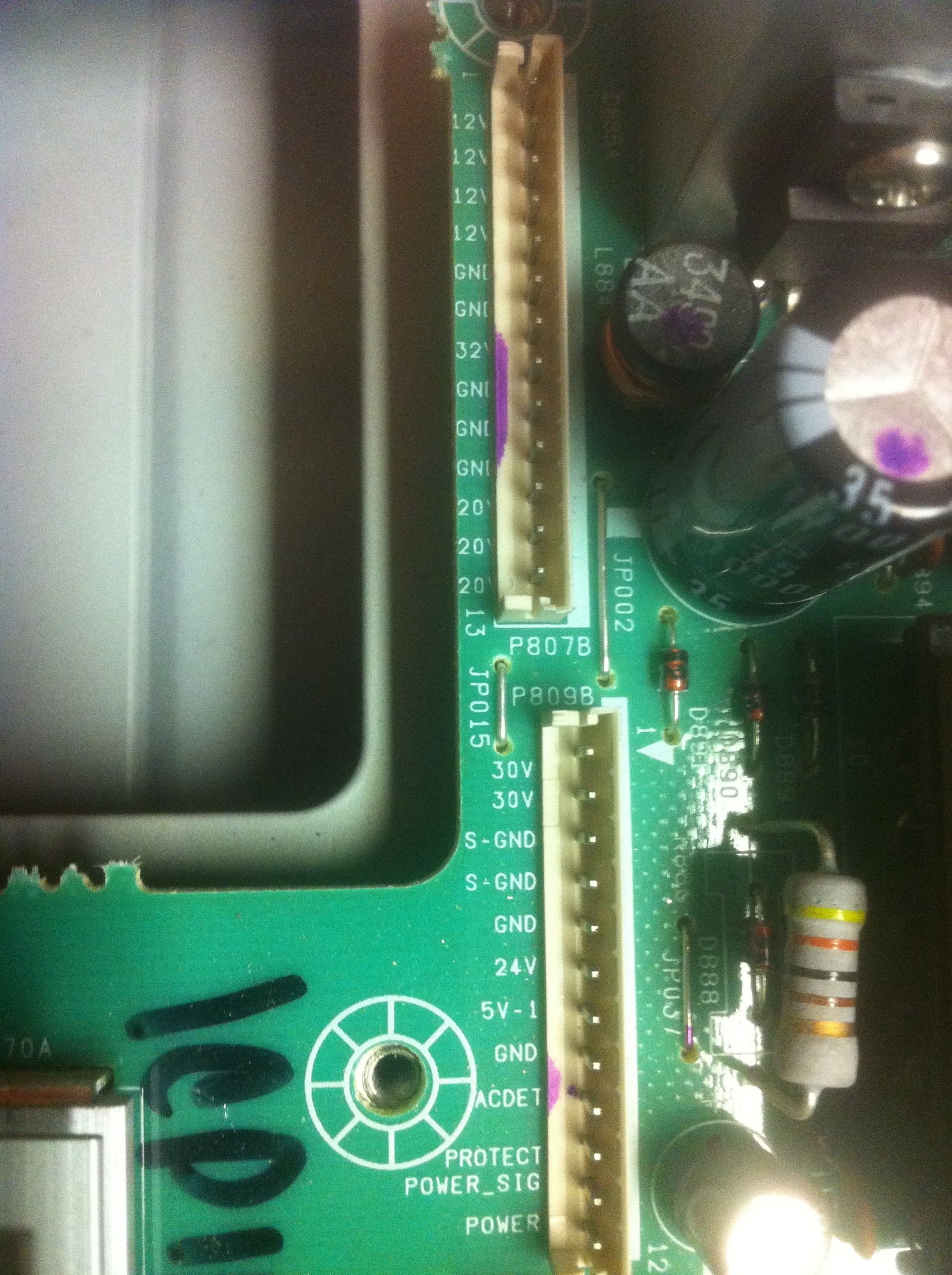

                                      I really don't think my problem is in the power supply. I'm only getting my 5vstby on the PS. Don't ever get any voltage on the power_sig or Power pin which should be a 3.3v signal to turn the power supply on. Maybe my problem is in the Seine board.
