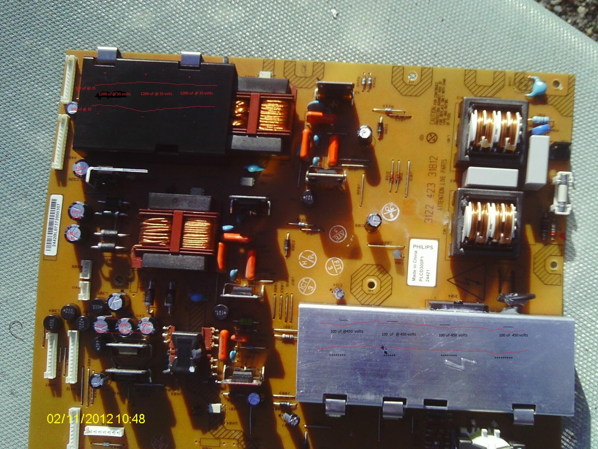

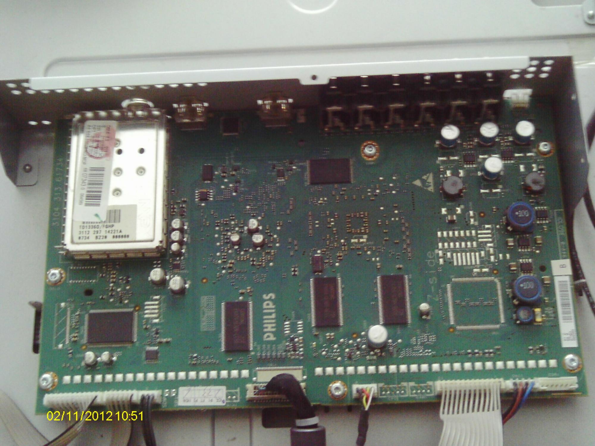

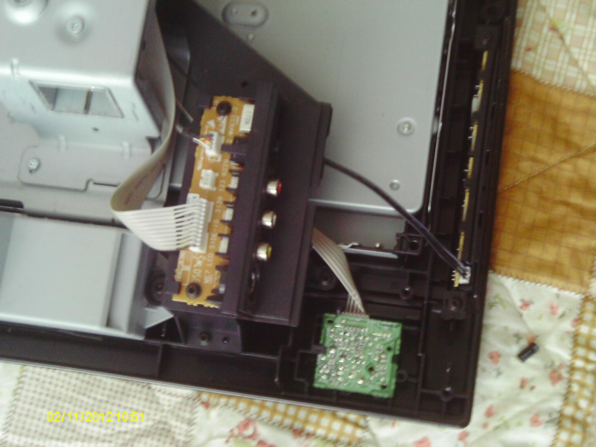

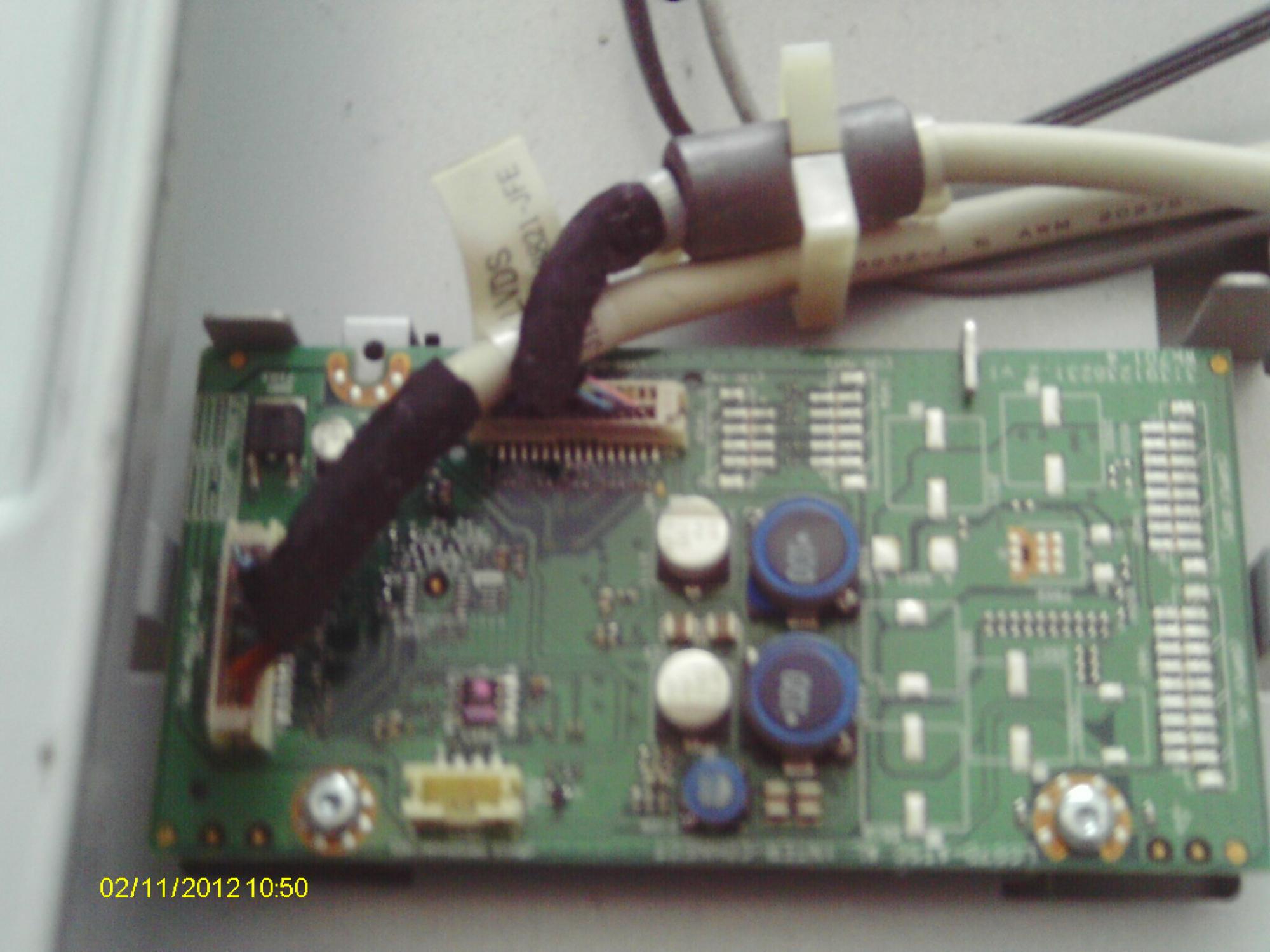

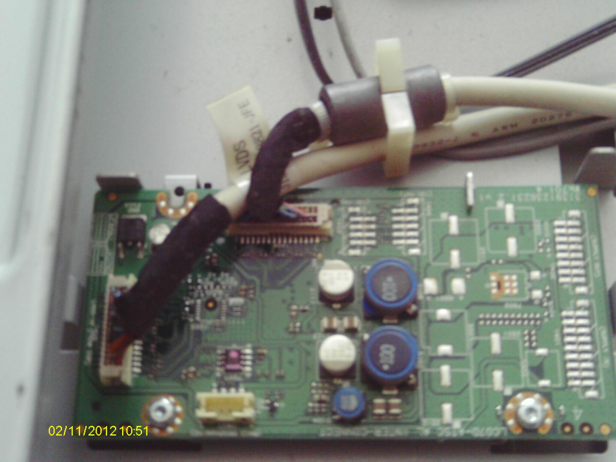

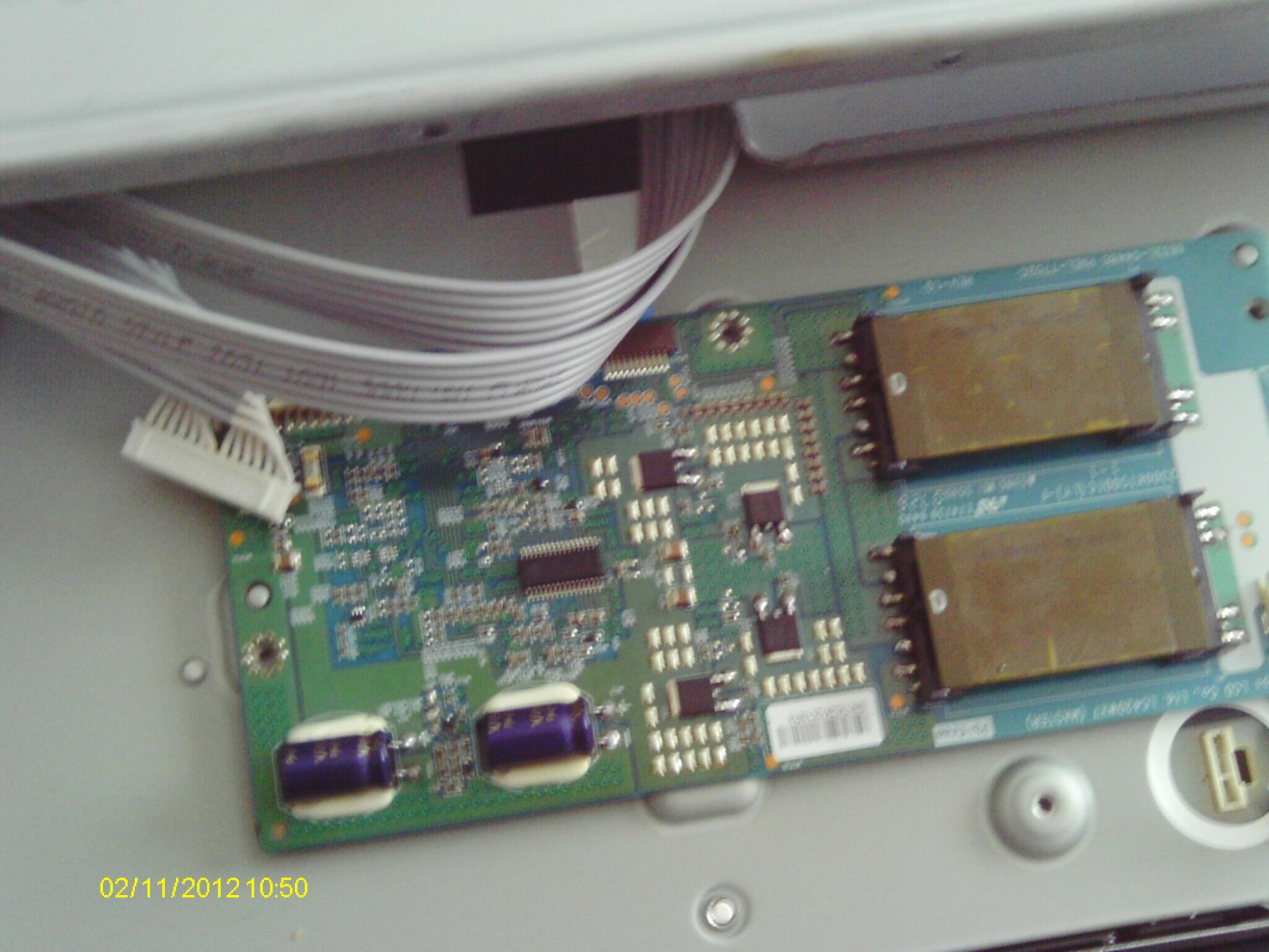

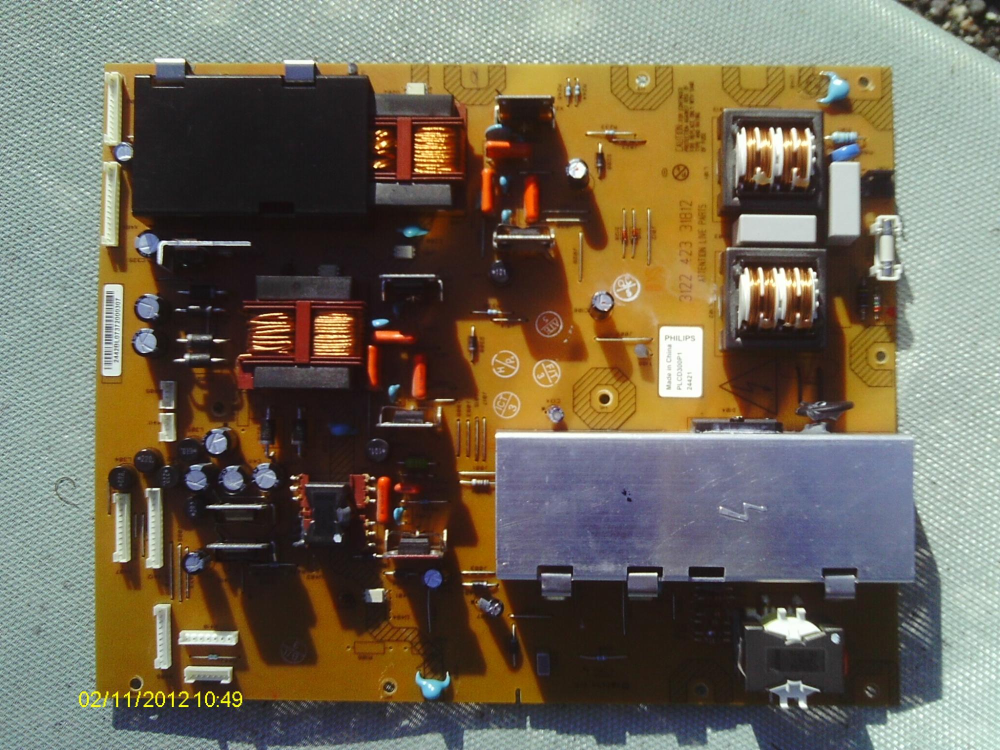

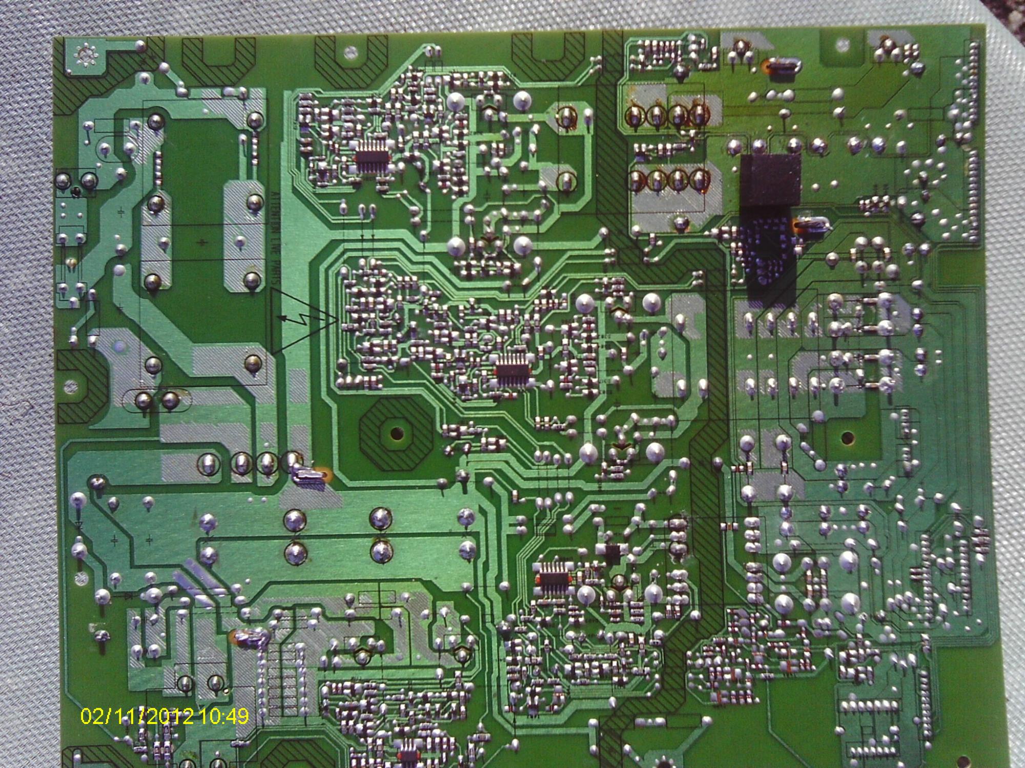

                  Here are some photo of this TV set
                  Top left photo shows the caps under the heat sinks and how they hook together and some of the caps values
                  All caps under 35 volts are Rubycon except the ones on the inverter boards
                  YXG replaced FC
                  470 uf @ 25 volts ESR reading .03 cap reading 478 uf
                  470 uf @ 25 volts ESR reading .04 cap reading 477 uf
                  470 uf @ 25 volts ESR reading .03 cap reading 477 uf
                  470 uf @ 25 volts ESR reading .05 cap reading 477 uf
                  YXG replaced FC
                  1200 uf @ 35 volts ESR reading .03 cap reading 1056 uf
                  1200 uf @ 35 volts ESR reading .03 cap reading 1059 uf
                  1200 uf @ 35 volts ESR reading .03 cap reading 1040 uf
                  YXG replaced FC
                  1000 uf @ 10 volts ESR reading .04 cap reading 1123 uf
                  1000 uf @ 10 volts ESR reading .04 cap reading 1113 uf
                  1000 uf @ 10 volts ESR reading .04 cap reading 1111 uf
                  YXF replaced FC
                  100 uf @ 35 volts ESR reading .11 cap reading 87 uf
                  100 uf @ 35 volts ESR reading .13 cap reading 87 uf
                  100 uf @ 35 volts ESR reading .11 cap reading 86 uf
                  100 uf @ 35 volts ESR reading .12 cap reading 87 uf
                  YXF replaced FC
                  220 uf @ volts ESR reading .12 cap reading 214 uf
                  Rubycon 85 C FRS
                  100 uf @ 450 ESR reading .91 cap reading 88 uf
                  100 uf @ 450 ESR reading .85 cap reading 89 uf
                  100 uf @ 450 ESR reading .95 cap reading 88 uf

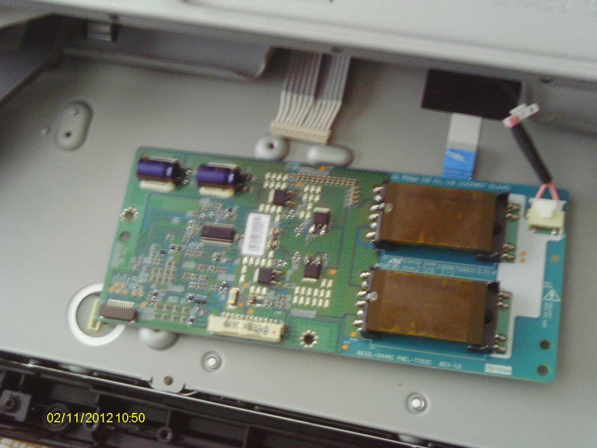

                  These cap where on the inverter board brand Samwub LT VOA Pet
                  replaced FR
                  470 uf @ 35 volts ESR reading .03 cap reading 440 uf
                  470 uf @ 35 volts ESR reading .03 cap reading 438 uf
                  470 uf @ 35 volts ESR reading .02 cap reading 436 uf

                  One thing I notice now that I recap this set when you turn ON the power to the set it take about 5 seconds for the sound to come on an .5 second more for the channel to show on screen then .5 second for the back light to come on to see the picture on the set
                  It use to this when it was new
                  What was happing was that would take 6 to 10 second for sound and picture to come on together
                  The set has been on from 12:00 pm to 7:00 pm and work very good now

                      I found on both the inverter board where the transformer pins go to the board the solider joints look very ? able there was a lot of flux came out from the pins so I re-flow all pin's joints

                              check the voltage to the inverter board. when the backlight is off , is there voltage (most of time 24 volt)? check if there is a 'inverter on signal' (inv_on). maybe there is a bad ccfl lamp.
                                Re: Philps LCD TV Some time no back light
                                I see the list of caps, so the caps on the Master and Slave boards are replaced? DO AS anno suggested to see if you have those two signals when you do not have backlights.
                                Post closed up pictures of the inverter boards if you are not sure which pins to use for tesing.
