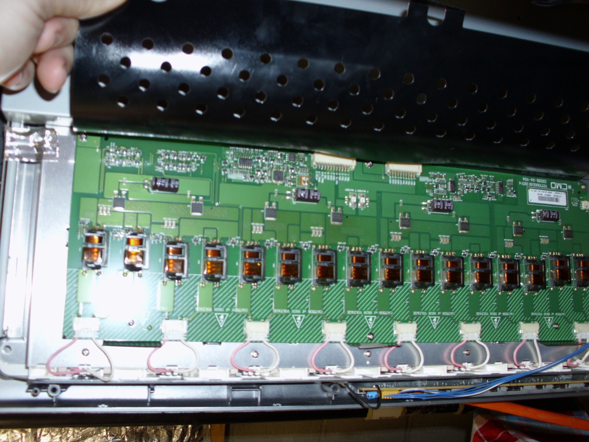

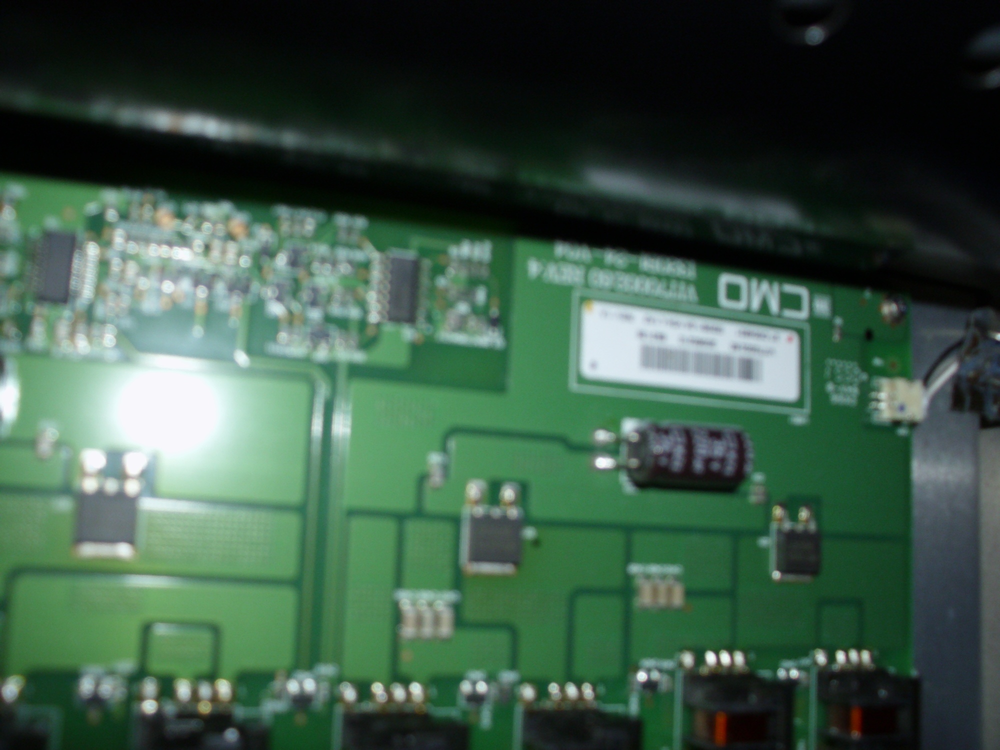

    Comes on , lite back lights, icon goes blue then shutdown in 30 seconds , looses 3.3v on main board, no picture , no video .
    With the invert unplugged and t-con unplugged Comes on , lite back lights, icon goes blue then shutdown in 30 seconds , looses 3.3v on main board, no picture , no video .
    It points to main board.
    It loosing 3.3v start volts and come when set is restarted.
    power supply has all volts okay have 12volts 5 volts and 24-
    any have any details about main board problems

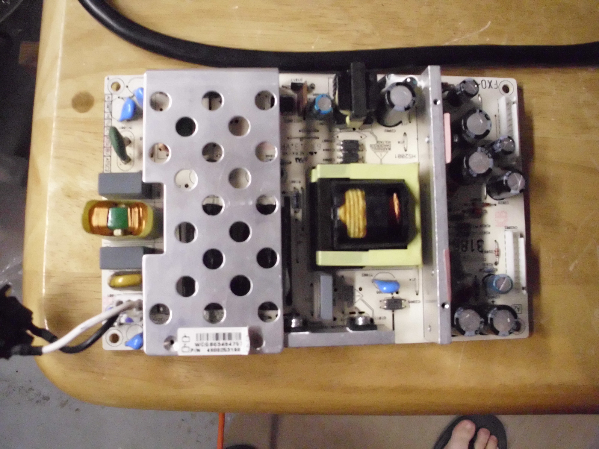

      Re: Ltv- 32w6 hd - shutdown 30 after back lights come on - and no video no sound
      well , while testing the power supply died yesterday. no low voltages any where lamo
      mfg part # 4900253180
      i only have high voltage power to rectifier then first of to ( two) - p20nm50fp Mosfet
      i looked spec/ data sheet} up .They *seem to test okay * - but seem like second of p20nm50fpis in series is not getting power - both test same out of circuit. This feed to the primary transformer.
      all diodes and resistor test - good
      Have zero on secondary diodes the 12volt diode transistor part # E83-004 and 24 v power transistor part # stps40h100cw
        Got supply working maybe
        i have 5 volts and 3 volts on power supply
        the front led lights blue
        main board has 5 volt - near power white connector- but dose not go any where to a cap and is no traceable after that.
        In 3 volt at bottom - near the power button connect
        i can not get the power supply to switch on for 12v on 24 volts
        any help would be great
        thanks

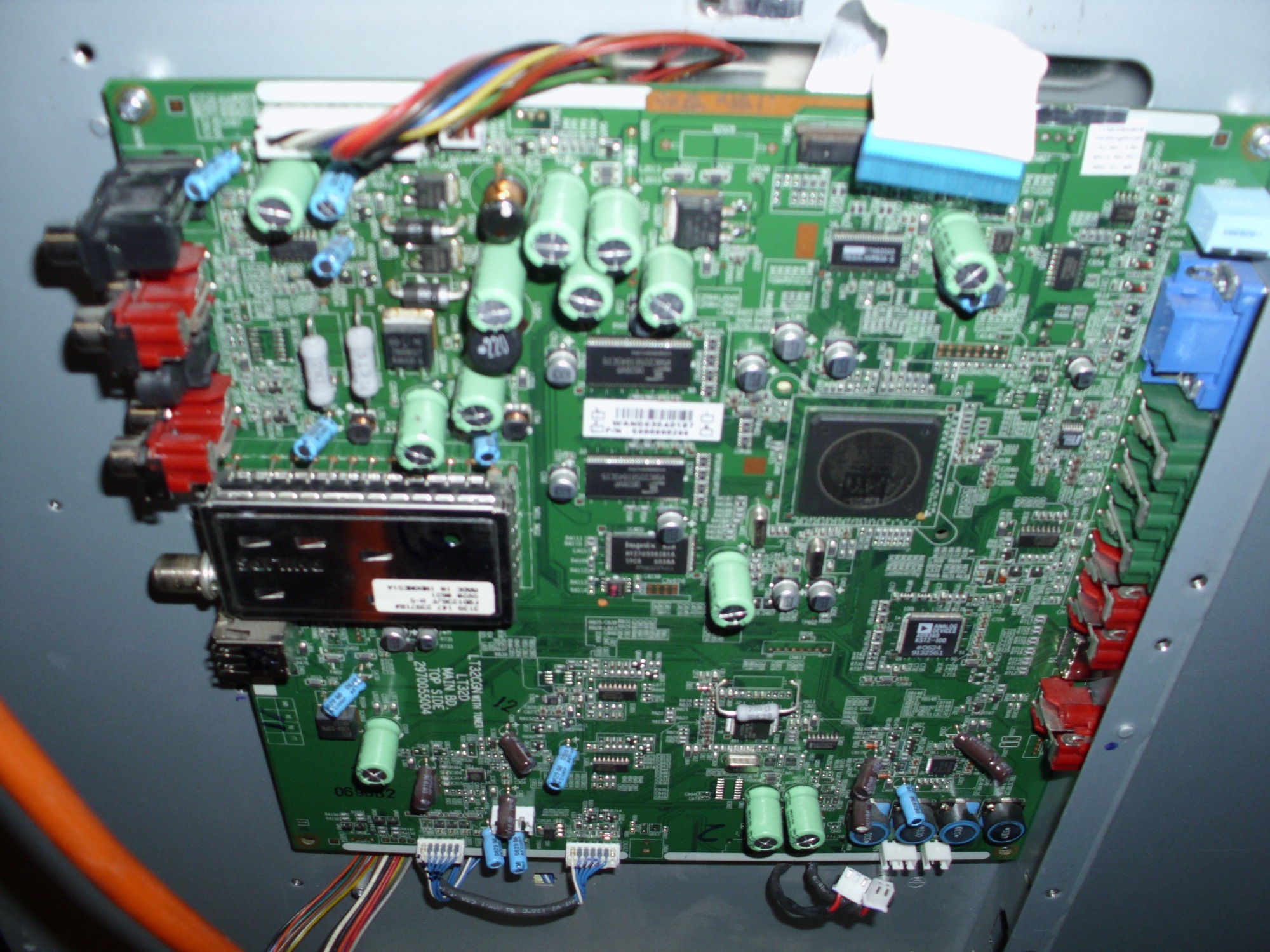

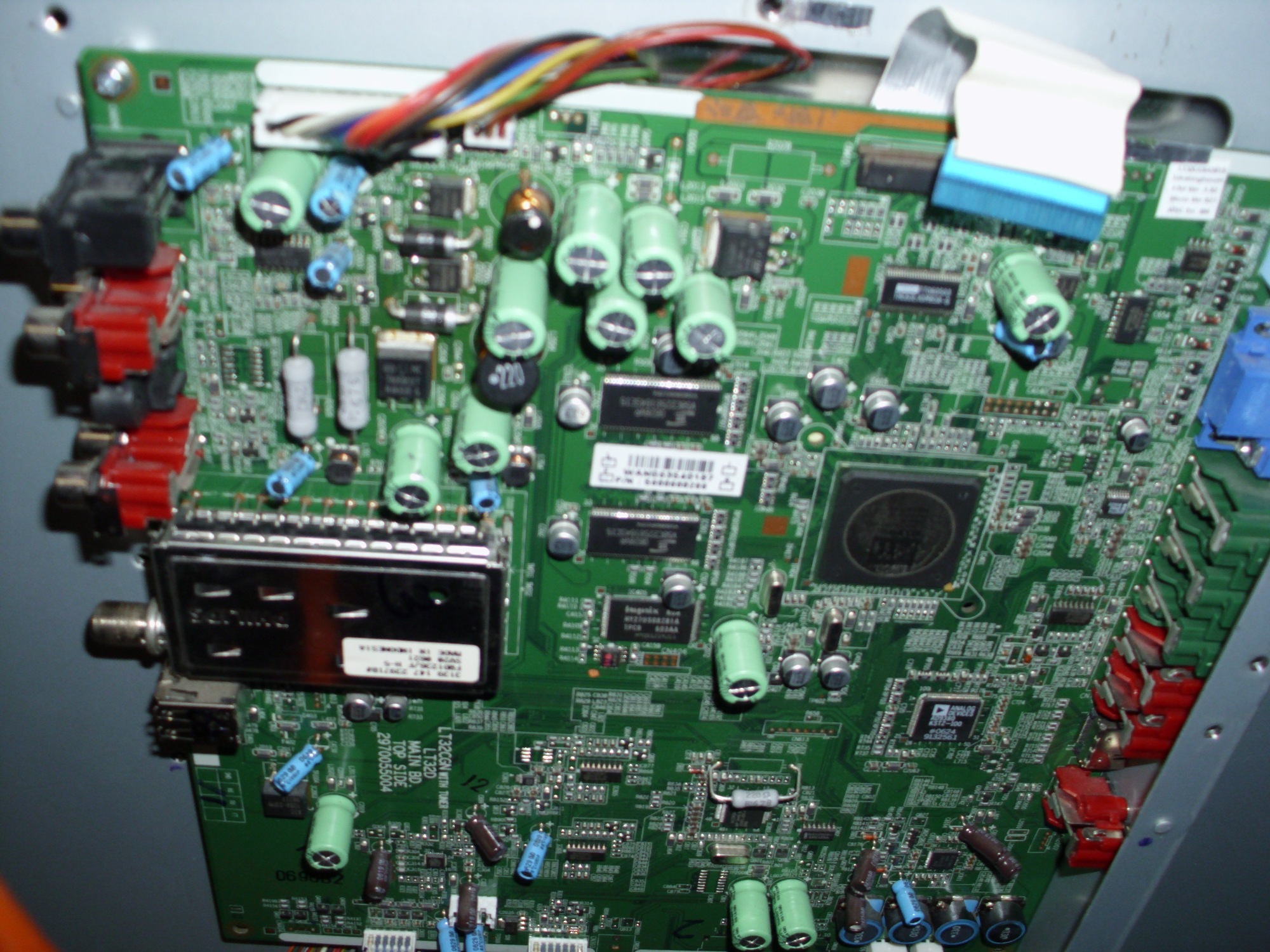

          Well bought a new main board - LOL-
          Now i have sound , back light . No picture or menu- problem now
          Going try to hook up to different video source-
          Just got my Toshiba going - so happy for that- offer to buy a dead Sony
          Any thoughts - current problem where to start
