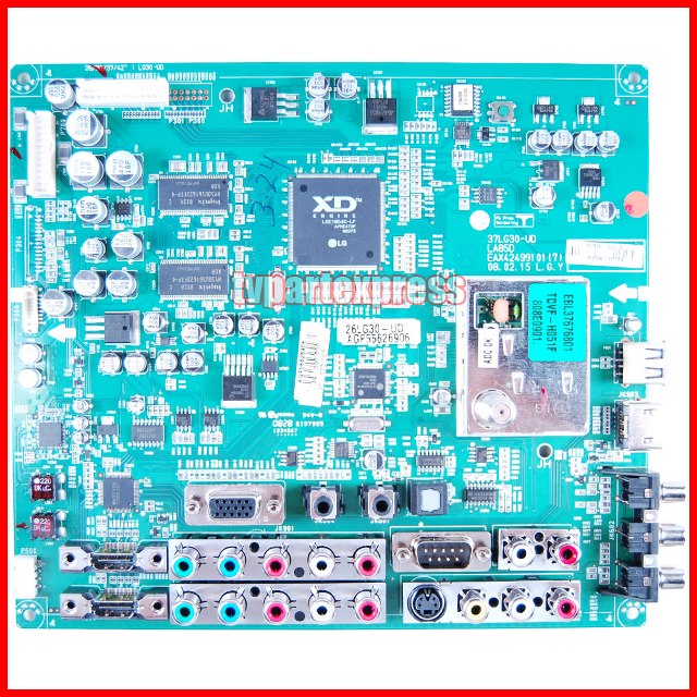

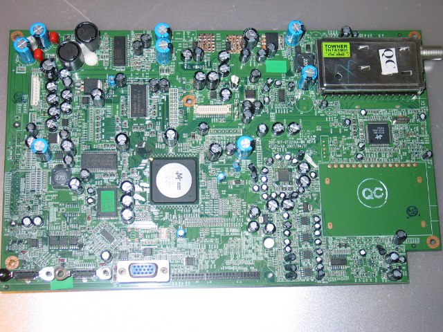

            Compare these two motherboards - one is Proview, one is LG. The way the cheap electros are just put in at any which angle looks ugly. Also, the board has been made as small as possible, to reduce costs. The LG is neatly laid out, with SMD electrolytics and excellent machine assembly. Shame the caps are bad on the PSUs, though, otherwise I wouldn't hasten to recommend LG or Samsung.
