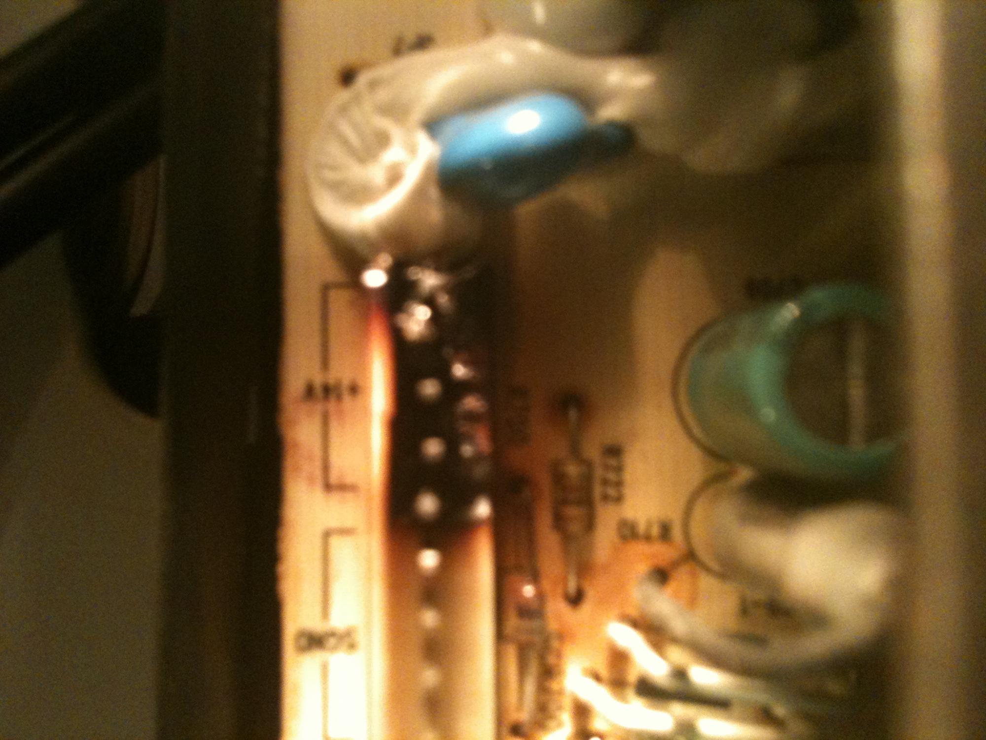

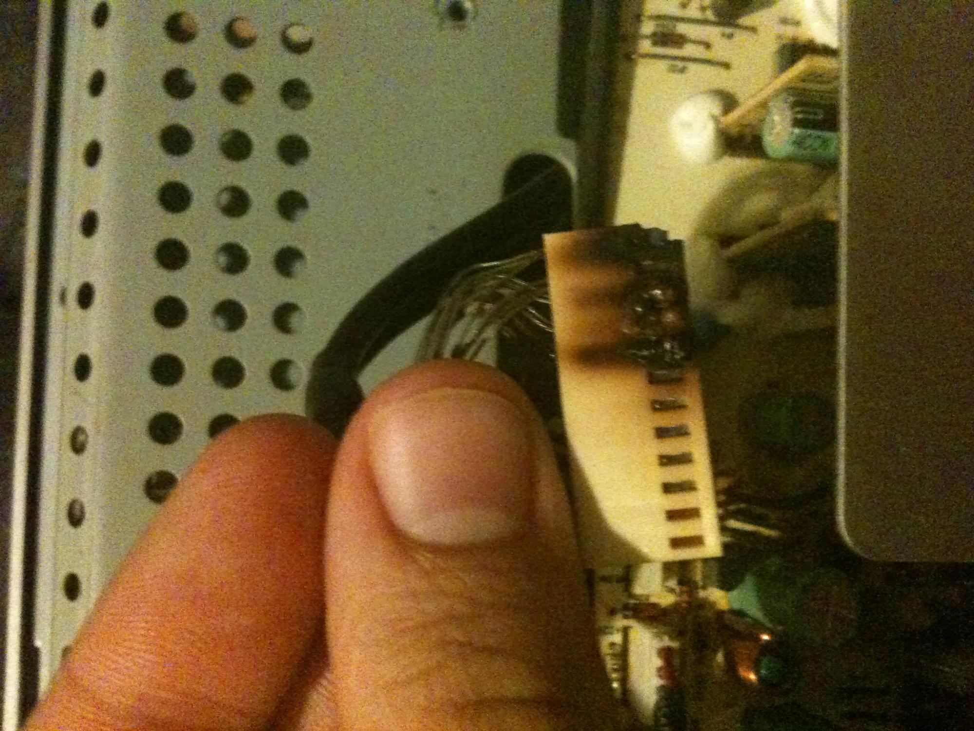

    Dell W2600 LCD TV/Monitor - sorry if this is the wrong place, but supposedly this item is a TV first, monitor second. Before we start, I know this model has had a recall and that it's plagued with numerous amounts of problems, from the power supply to the everything else. I know some about electronics, but not much, I'm more computer software and hardware.

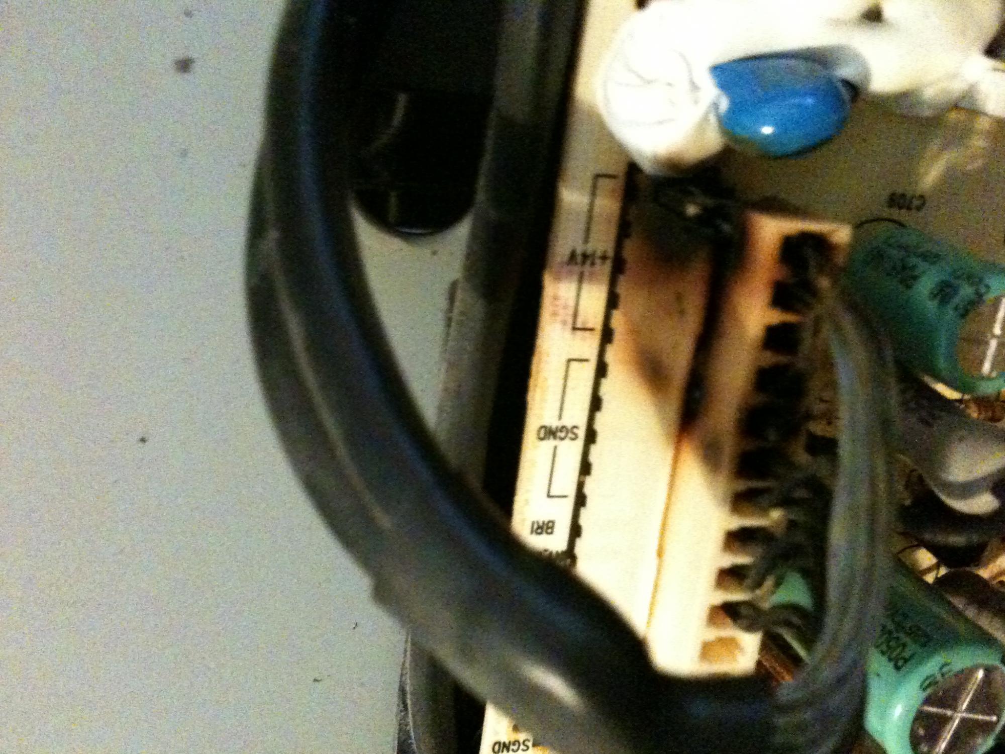

    The initial symptom was no picture. Powered on, audio worked, blue power light came on, no video. Upon inspection I found the power connector (sorry if that's the wrong terminology) that goes from the LCD to the I think power board, to have black and brown residue from overheating. When I wiggle it slightly, the picture is restored, and after only minutes of being on, I think I smell the connector shorting/burning again (could be my imagination tho) but the connector is very warm to the touch after just minutes of being on.
    In conclusion, my first question is, what is that connector actually called so I can be more knowledgeable. Second, where would I find this part number and or could it be a generic part. Third, any diagnostic tips for me to preform would be appreciated. I have access to certain tools, and I would try anything if able to. I have not done any diagnostics, just what I've seen smelt and felt. Ok I guess we can start from there, sorry for the picture, I can't find the cord to my digital camera, I will shortly and post better pics, this picture is from my phone with no flash, those are not shadows on the connector, the borwn/black is the burn/short from overheating (I think). Thanks everyone.

    That picture is adequate (and eloquent!!!)
    Either there is a bad solder joint(s) on the bottom of the board, or one or more contacts in the female portion of the connector are bad. I'm of the opinion the only way to repair this is by removing both parts of the connector and replacing with new. IF the cable has connectors at both ends and can readily be removed from the TV, it would be possible to remove both parts of the defective connector and solder the wires directly to the board, but I don't recommend that practice.
      Connector is correct.
      I don't know. If you can find a schematic for the Dell, there may be a bill of materials with a part number.
      Try
      http://elektrotanya.com/
      If there is no spare part, perhaps you can recrimpt it somehow by stripping away all the burnt wiring?

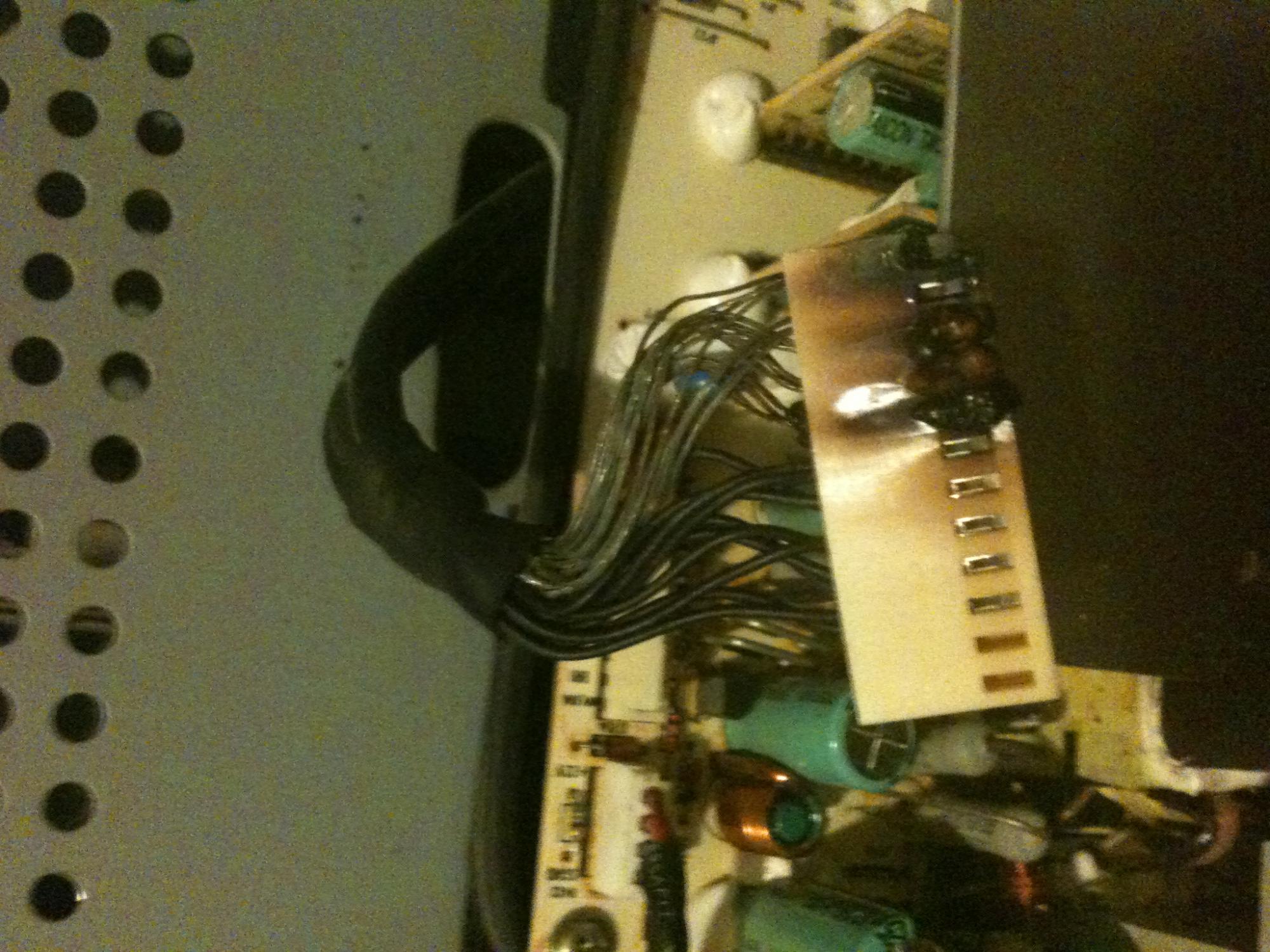

      Post pictures with the connector off so we can see if there is any damage. Post a picture of the "inside" of the connector (looking into it).
      edit: PlainBill beat me again.

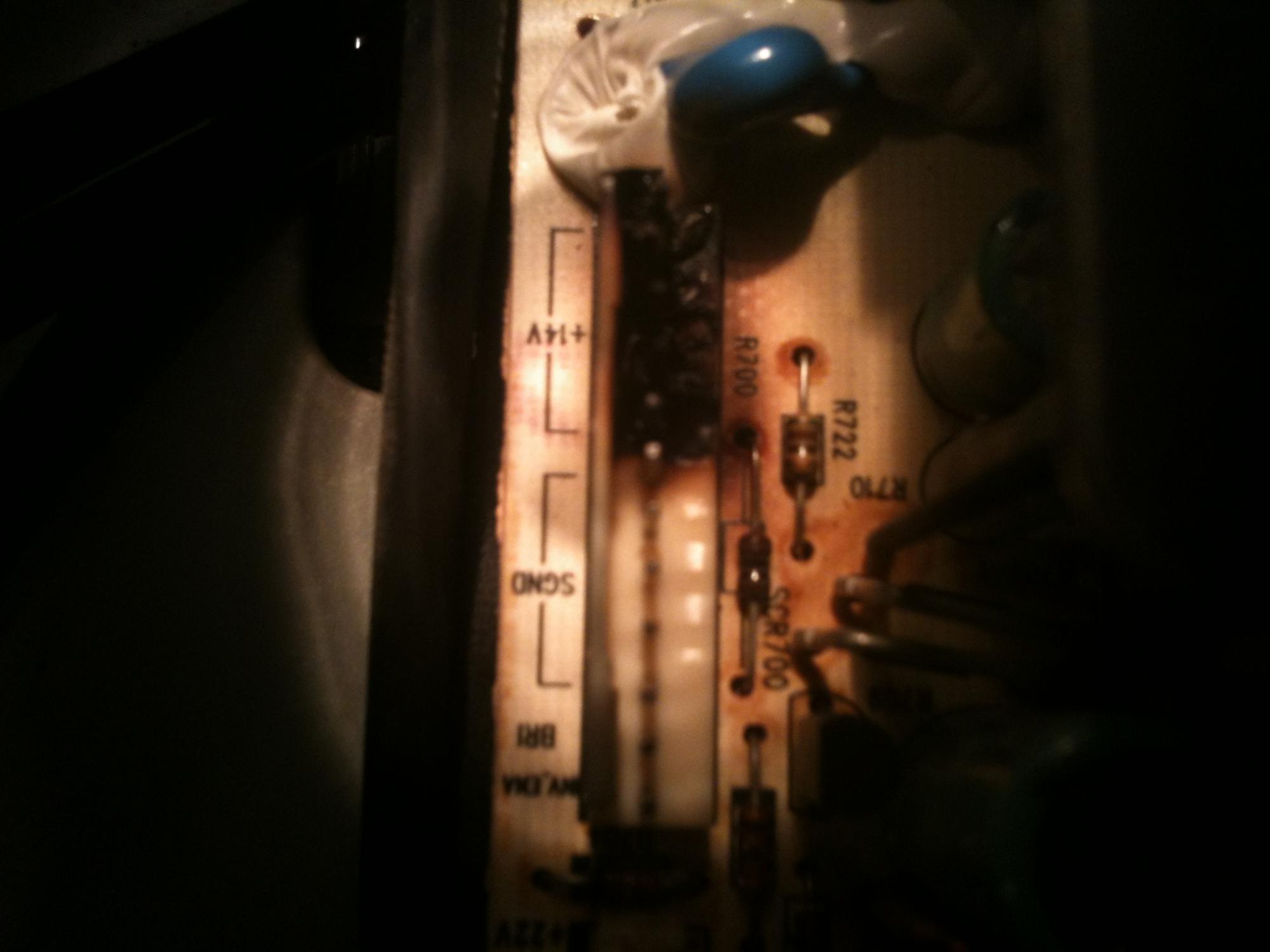

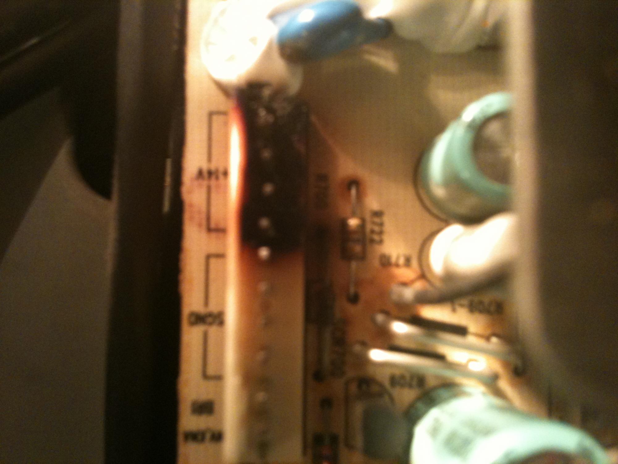

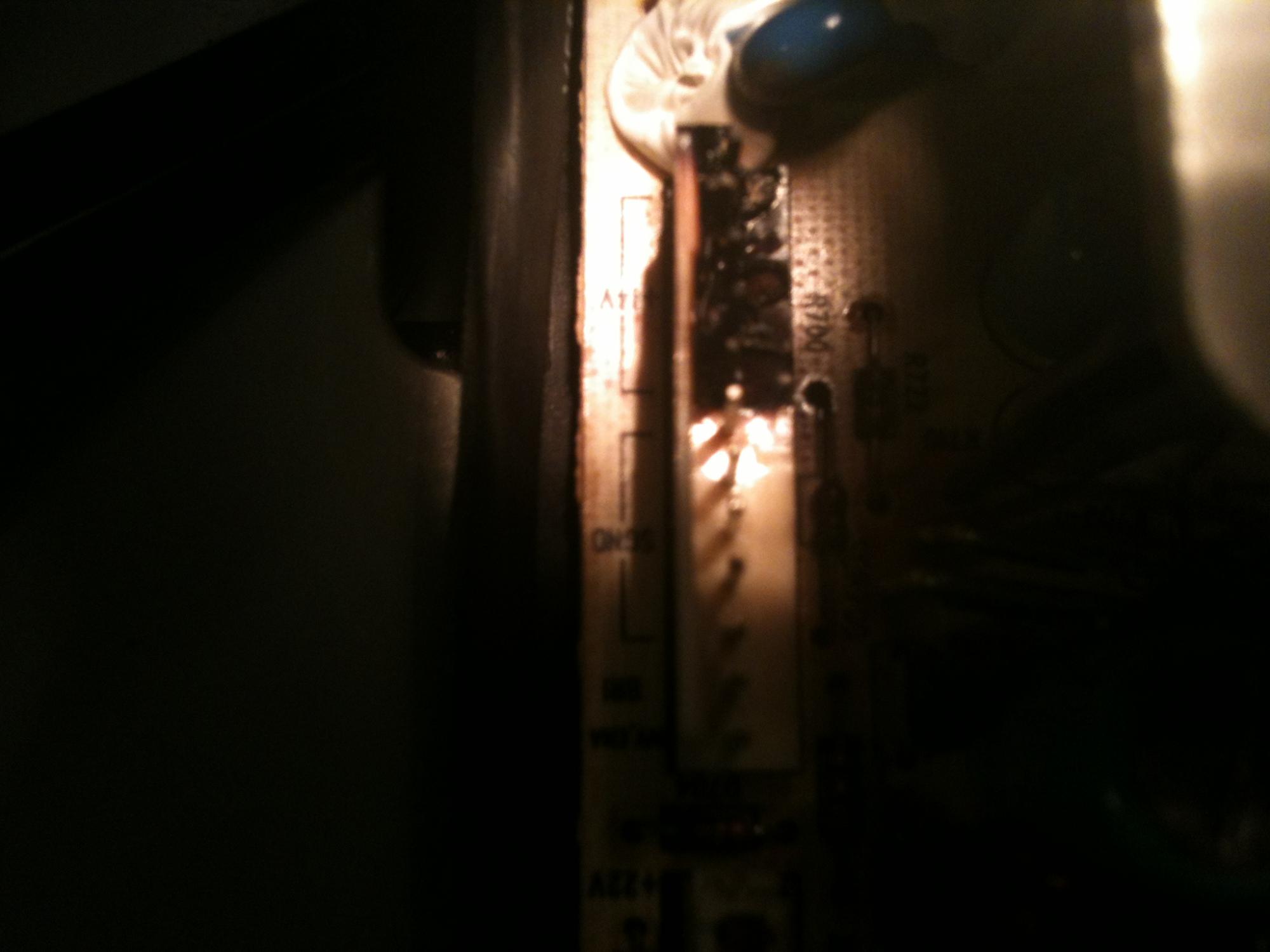

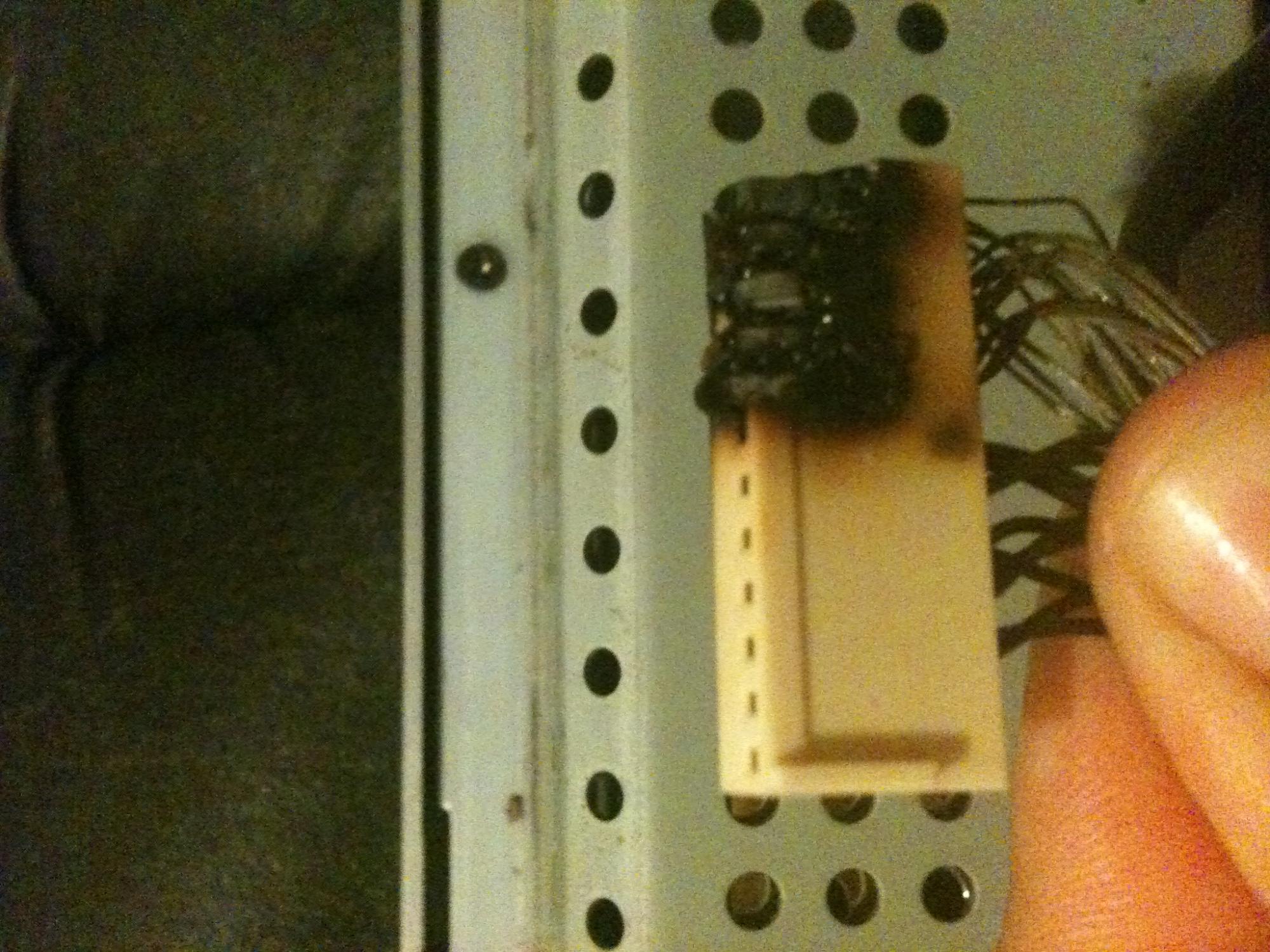

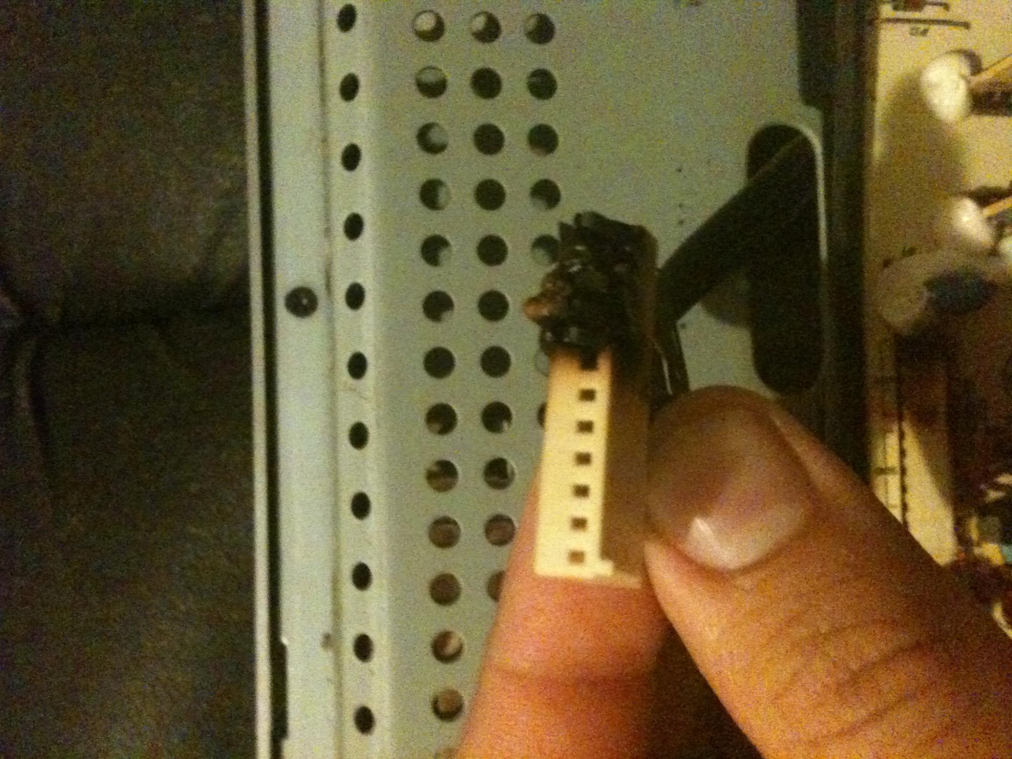

        Unfortunately I still cannot find my usb hookup to my digital camera, so more smart phone minus flash pictures. As you can see, the plastic on the connectors, both male and female parts are crispy and crunchy, yet that does not stop the t.v. from getting a connection to it and producing a picture. The wires are now exposed, and it seems that all the prongs (?) are still there, just with black and brown residue. Any ideas as to what caused this or procedures I can do to figure out what caused this? If I do replace the power connector, is there a chance this will just happen again? Thanks again everyone.
          Re: Dell W2600 - no picture unless I wiggle
          It's possible there is an internal short circuit in the connector or on the other end of the wire affecting only those four pins. Check using a multimeter for shorts or low resistance.
          Could be tin whiskers in the connector.

            Hello everyone, thanks again for the quick replies, it took me a while to borrow a voltmeter, but I was finally able to get my hands on one. There are twelve pins, working from left to right on the power board, the far left has 60, then pins two thru eight have 56.5 and the last four pins have 70. The last four pins being where the black/brown residue and melting connector issue. The other end of the connector that plugs into the power board reads 56.5 on all points, even the exposed wires. Any input would greatly appreciated. Enjoy the super bowl

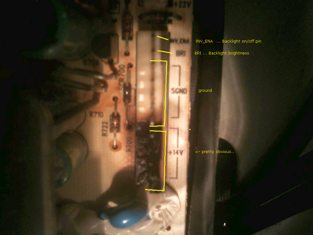

                    Is it just me or are the positive wires (going to the fried part of the connector) without any insulation (bare wires) !? :O
                    Looks like that connector is going to the backlight inverter. Played with the image a bit (see attachment)
                        I stand by my suggestions in post #2.
                        The cause of failure was either a bad solder joint on the circuit board, or one or more weak contacts on the connector, I'm leaning toward a defective connector. It was NOT caused by something drawing too much power.
                        There are three possible solutions.
                        1. Replace the cable and the board - this is the way a factory authorized shop would do it, but they don't care about cost.
                        2. Replace the male connector on the circuit board and replace the cable. You can sometimes see 'complete cable sets' for a specific model TV on eBay.
                        3. Unsolder the male connector from the circuit board and cut the wires as close to the female connector as possible. Solder each wire into the proper hole. Do this ONLY if the other end of the cable can be disconnected from it's source.
