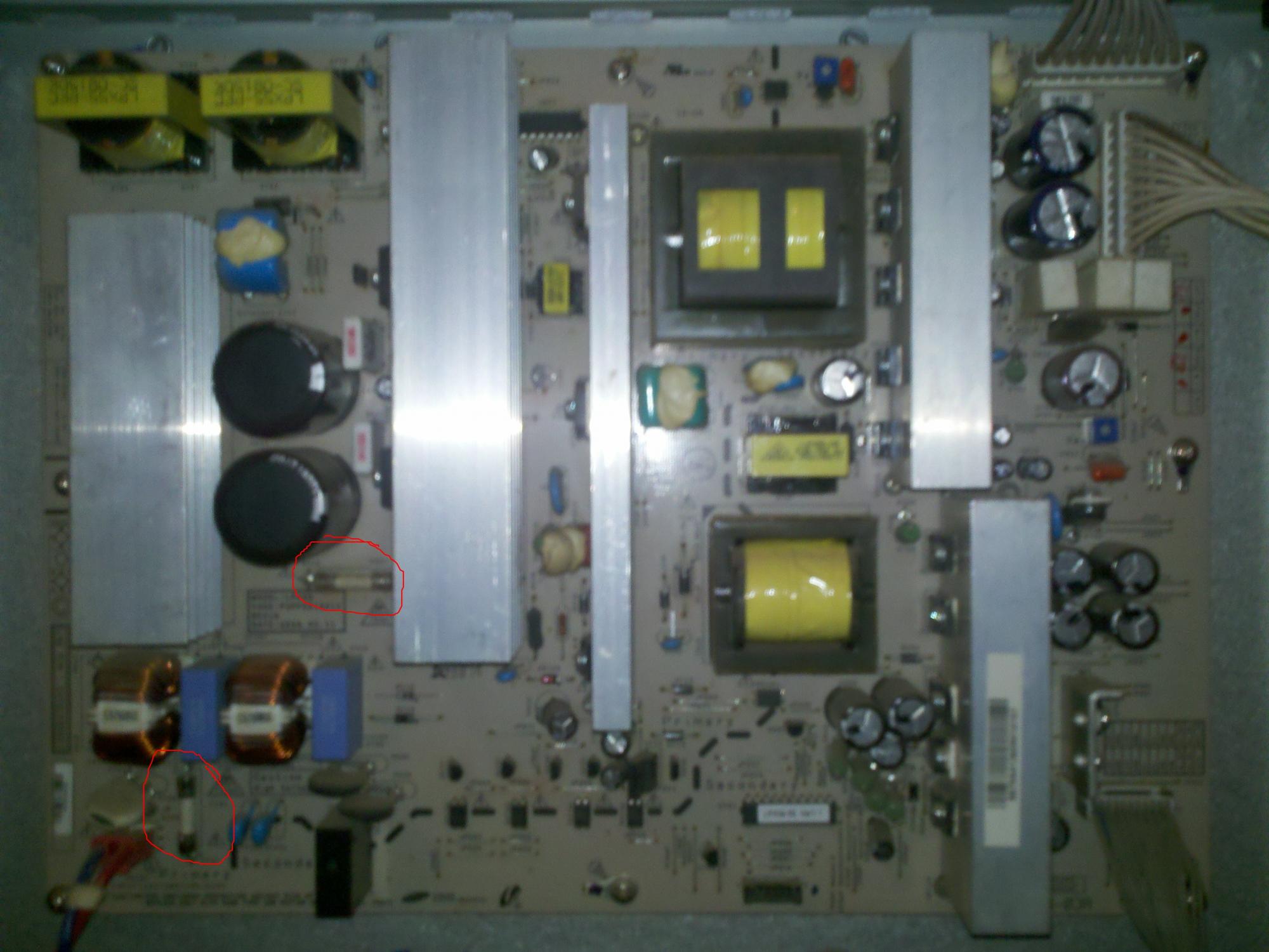

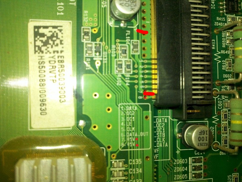

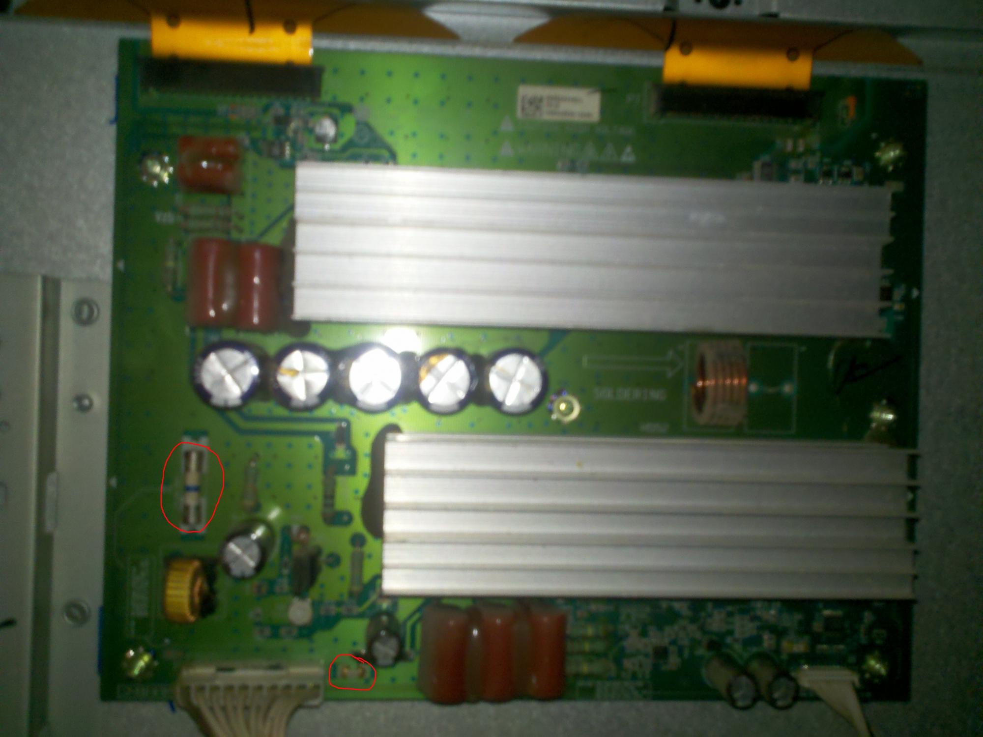

            Also, here are some admittedly bad pictures of the Z-sustain and main boards.
            If clearer images are needed, I can try tomorrow in the sunlight.
            I circled the two fuses I found on each board. All tested good.
            On the main board, the wires that lead to the Y-sustain and Z-sustain tested as follows while unplugged:
            Vs:193.6V
            N. C: Goes from 0-197V increasing at a rate about 20-30V per second
            Va: 59.6V
            M5v: 5.06V
            On the main board, the wires that lead to the input board tested as follows:
            16v: 16.41V
            12v: 12.07V
            5v: 5.09V
            AC_DET: 5.07V
            5V_DET: 5.07V
            VS_ON: 3.27V
            RL_ON: 4.57V
            AUTO: 0
            M5V_ON 3.27V
            On the Z-sustain board, I don't see much to measure.
            I did see a little green resistor marked VZb+.
            That measured 98.3V.
            • gopro25
              • Jan 2012
              • 23
              Re: Zenith Z50PG10 - Voltage Discrepancy 60V vs 5V ?!
              Also before you mention it, I found the 3rd fuse on the Z-sustain board. It's good too.
