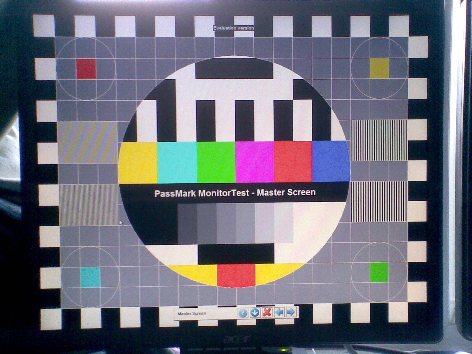

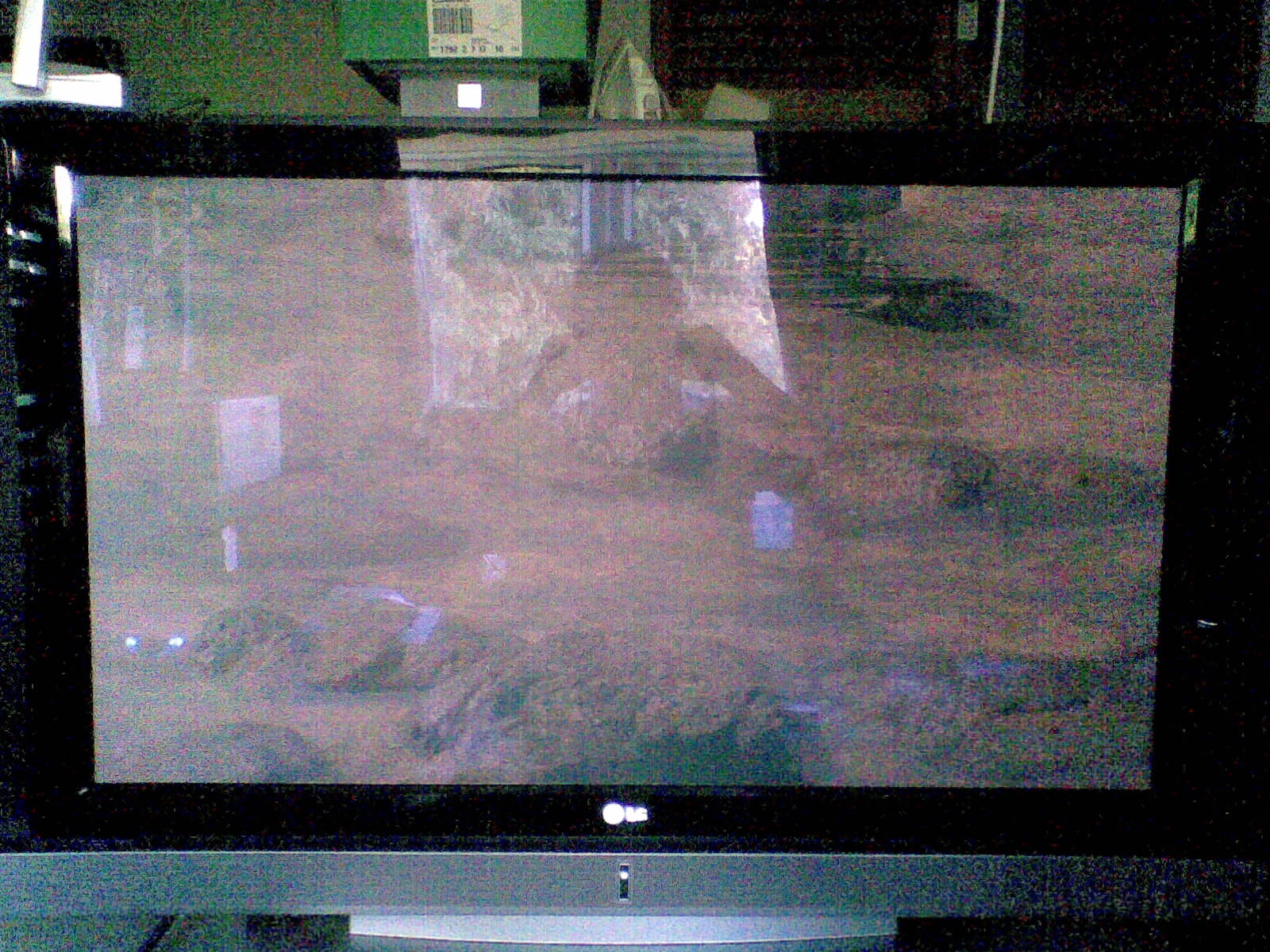

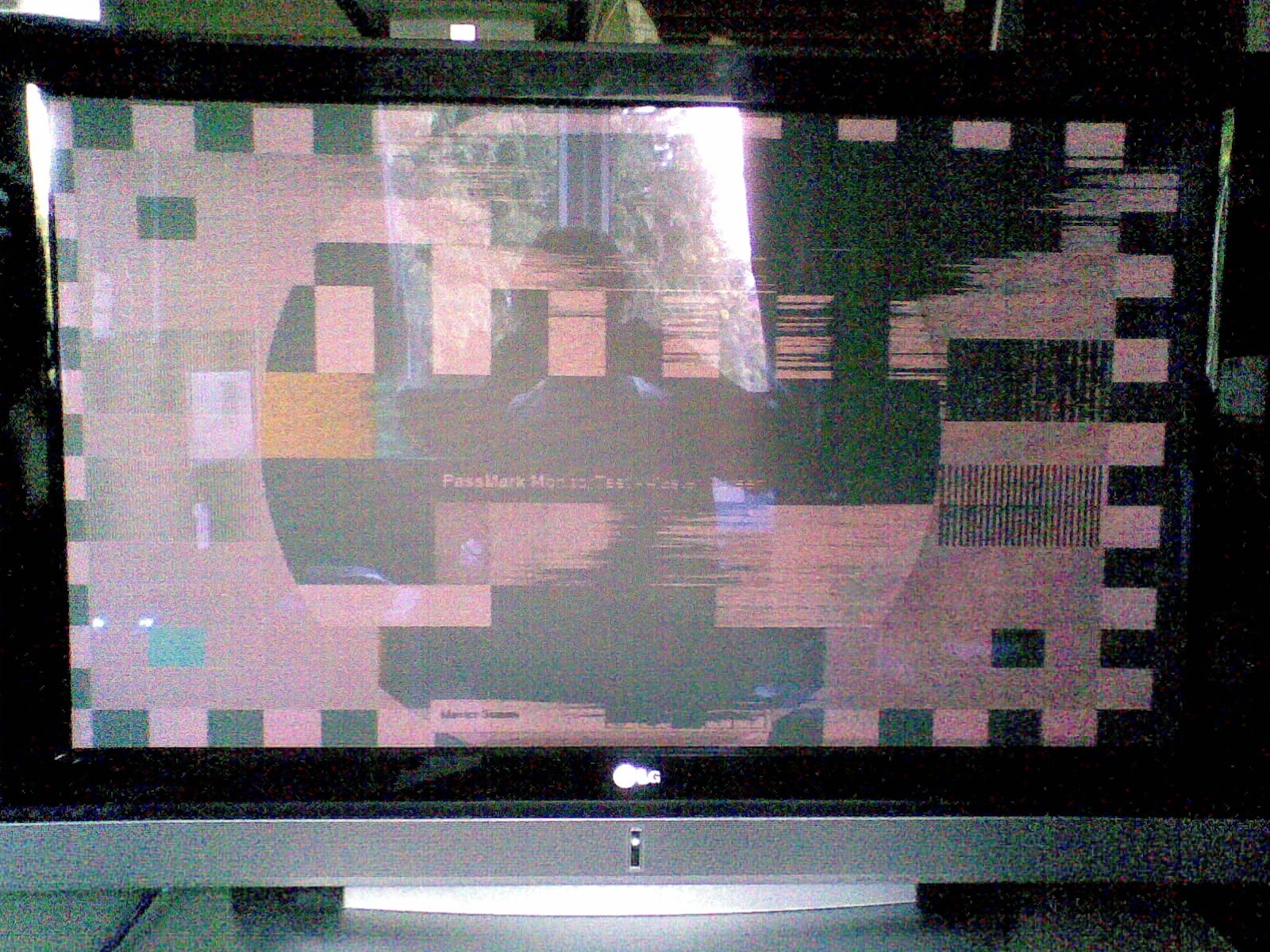

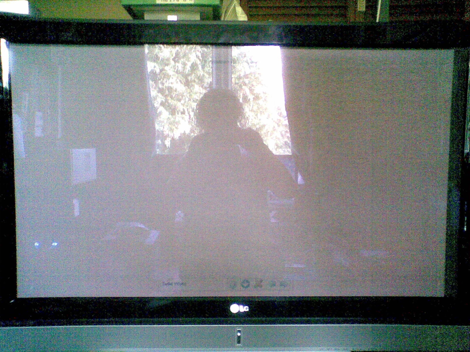

                                      Some screen shots.
                                      1st one is an Full White test,
                                      2nd standard test card
                                      3rd standard test card on a working monitor for ref
                                      4th an image off the tv of i think a beach.
                                      it does look very purple on the full white now i look at it
                                      tom66 - scope & probe not a problem. if it starts to get serious, i have 2 scopes, 2 sig-gens 5 channels of bench supplies, 2 variacs and a 200w dummy load in my lab
