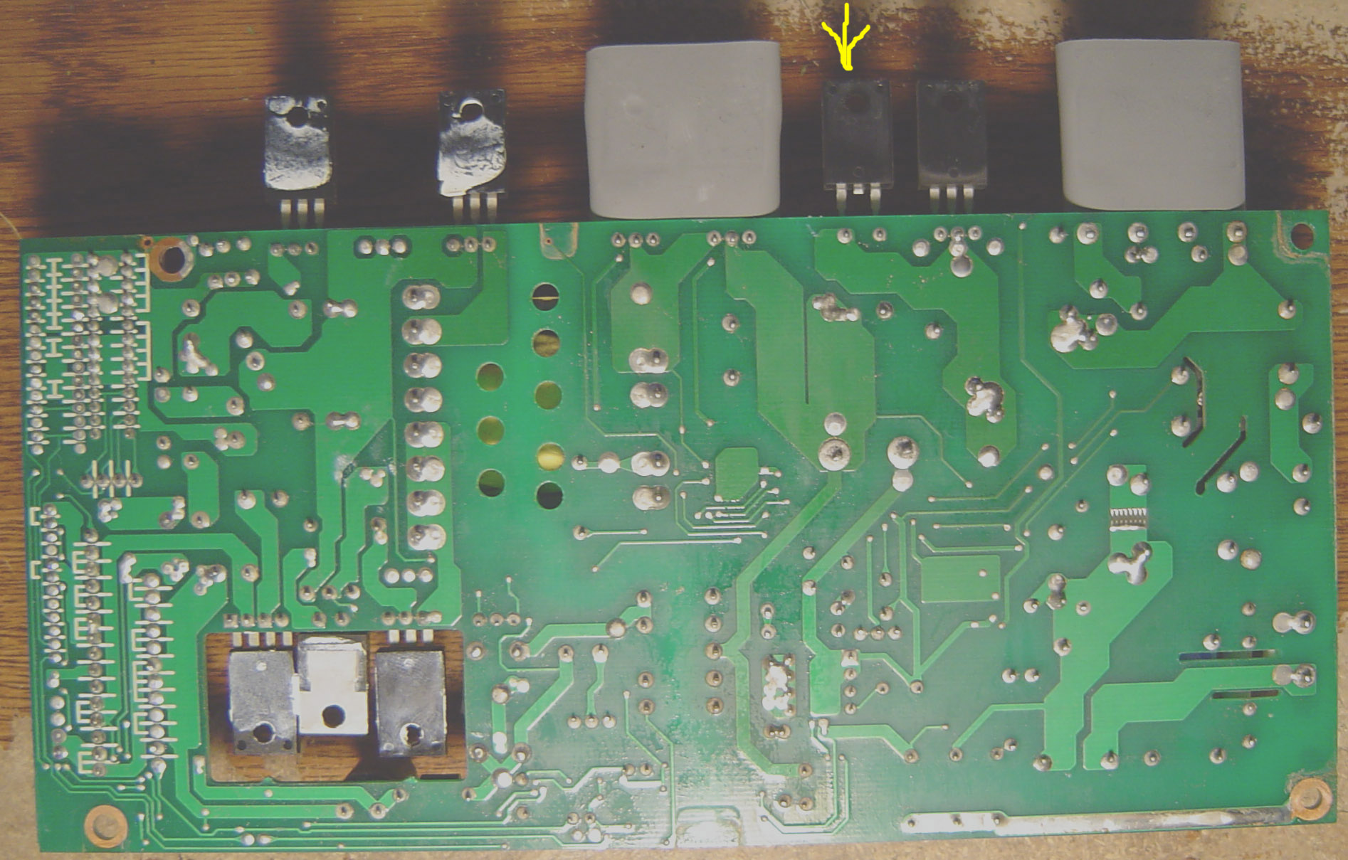

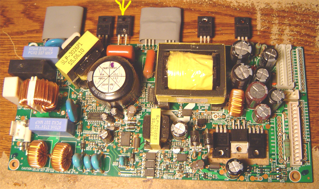

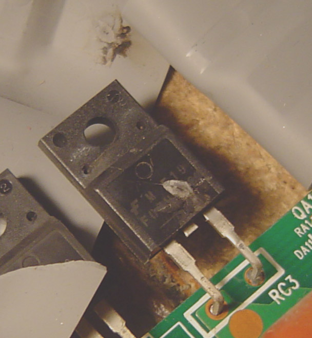

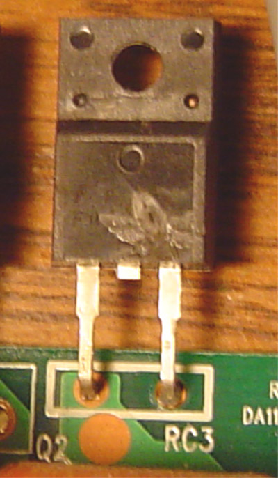

    I hope I'm posting this in the right forum. I garbage picked a Digital Lifestyles 32" lcd tv the other day. Symptom is no power at all. No standby light. I'm sorta weak with this stuff. I have replaced blown caps on monitors, motherboards and other tv's with pretty good success, but that's about the extent of it. I found a burnt component on the PS. I guess you call it a mosfet. My question is can anyone identify by what markings are left on it?
    So far I think it may be a Fairchild mosfet. I can see the F and what looks like M 519 and another F 0 3 and maybe a U. That's all I can get.

    Re: Digital Lifestyles 32" LCD TV blown component on PS board identification.

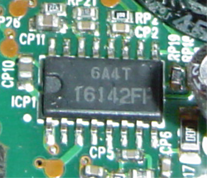

    That appears to be part of the PFC circuit. Could I have a picture of that area from the reverse side? I've got an idea that is a diode, not a FET.
    Also, there is a 16 or 18 pin IC below and to the left of the largest cap. That is probably the PFC controller, what is the part number?

      Here's a couple more photos. A closeup of the 16 pin IC with 6A4T and
      16142FF on the chip. Thank you for taking a look at it. Appreciate it.

        That is 16142fp. Datasheet at
        http://pdf1.alldatasheet.com/datashe...HA16142FP.html

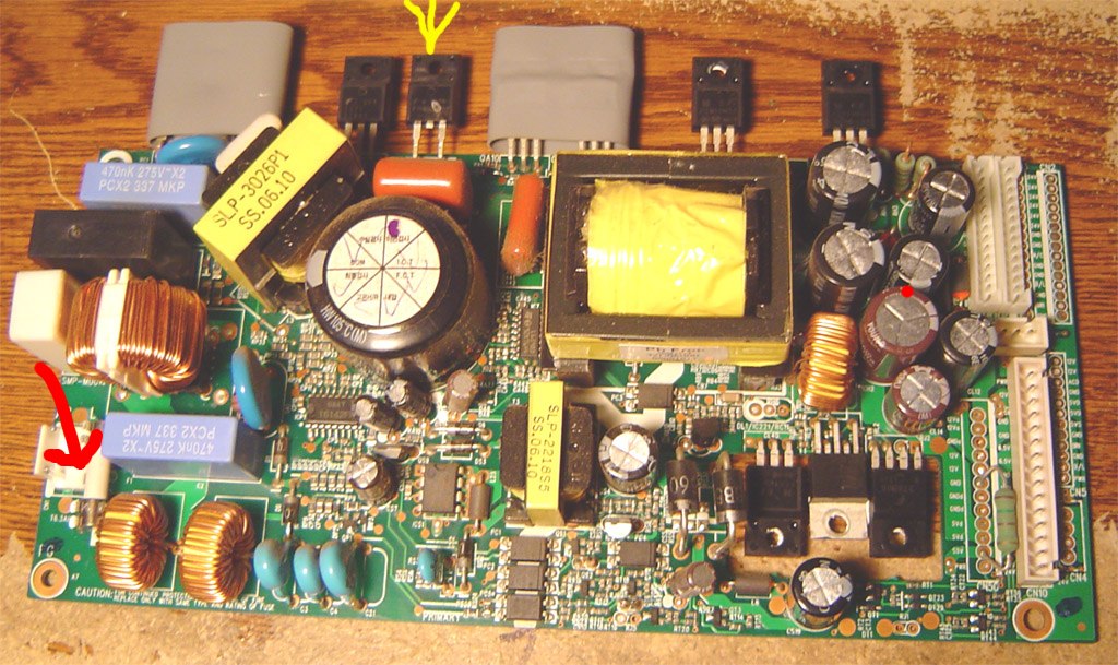

          Just to confirm it is truly blown (and it most likely is), use the diode test mode on your multimeter. With power off, test it both ways. If it's working, you'll get about 500 one way and OL the other. If it's broken, it will be <100 both ways.
          Also, the fuse will have most likely blown if the diode goes, so check that.
          The PFC mosfet may be okay (the device to the left of it), but using the 200 ohm range of your meter, check all six combinations of pins (three combinations, both ways.)
          The terminal closest to the hole in the device is probably the anode of the diode.
              Can you post a picture of your multimeter?
              This is the fuse I am talking about, it's ceramic, what does it read? If this hasn't blown - and it doesn't always - the plug fuse may have.
              Here's a good replacement for the diode. http://parts.digikey.com/1/parts/211...xa10fp600.html It should be the right way around... but just to make sure, you can ohm out the diode and determine which side was intended to be anode and which is cathode... but you'll need to remove the diode first. Careful, the board has two layers which is easier to damage with too much heat...
              Once the diode is removed, it can be tested for shorts.

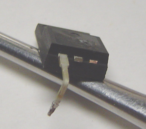

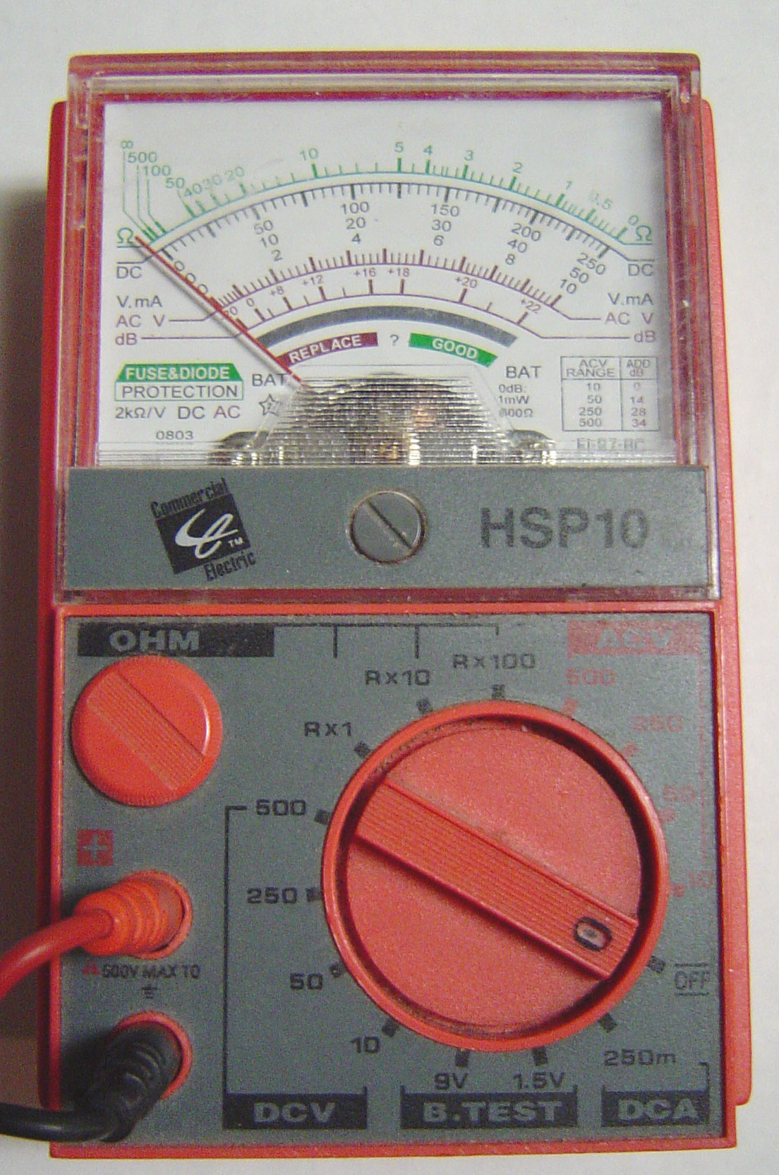

                Ok here's a photo of my crappy meter. I tested the fuse you pointed out and I have continuity on it. The diode broke as seen in the photo coming out, but there's still enough there to get a probe on it. Will this meter be able to test which is anode and which is cathode? Thank you again.
                  Mike
                  It will be, but it's not necessary. Note the two holes on the board where it was mounted. One of those holes will be connected to the positive lead of the large cap. That is the cathode side. The other will be connected to the winding on the SLP-3026P1 inductor. That is the anode side.

                    • Mike95inNJ
                      • Feb 2011
                      • 18
                      First off I want to thank everyone for trying to help me get this fixed. I appreciate it. I did replace the diode with no luck. Same symptom of no sign of any power. There will always be another one to save from the garbage truck. Thank you again.
                      Take care, Mike
                        Well, have you considered other options? The blown diode could have taken the PFC controller with it.
