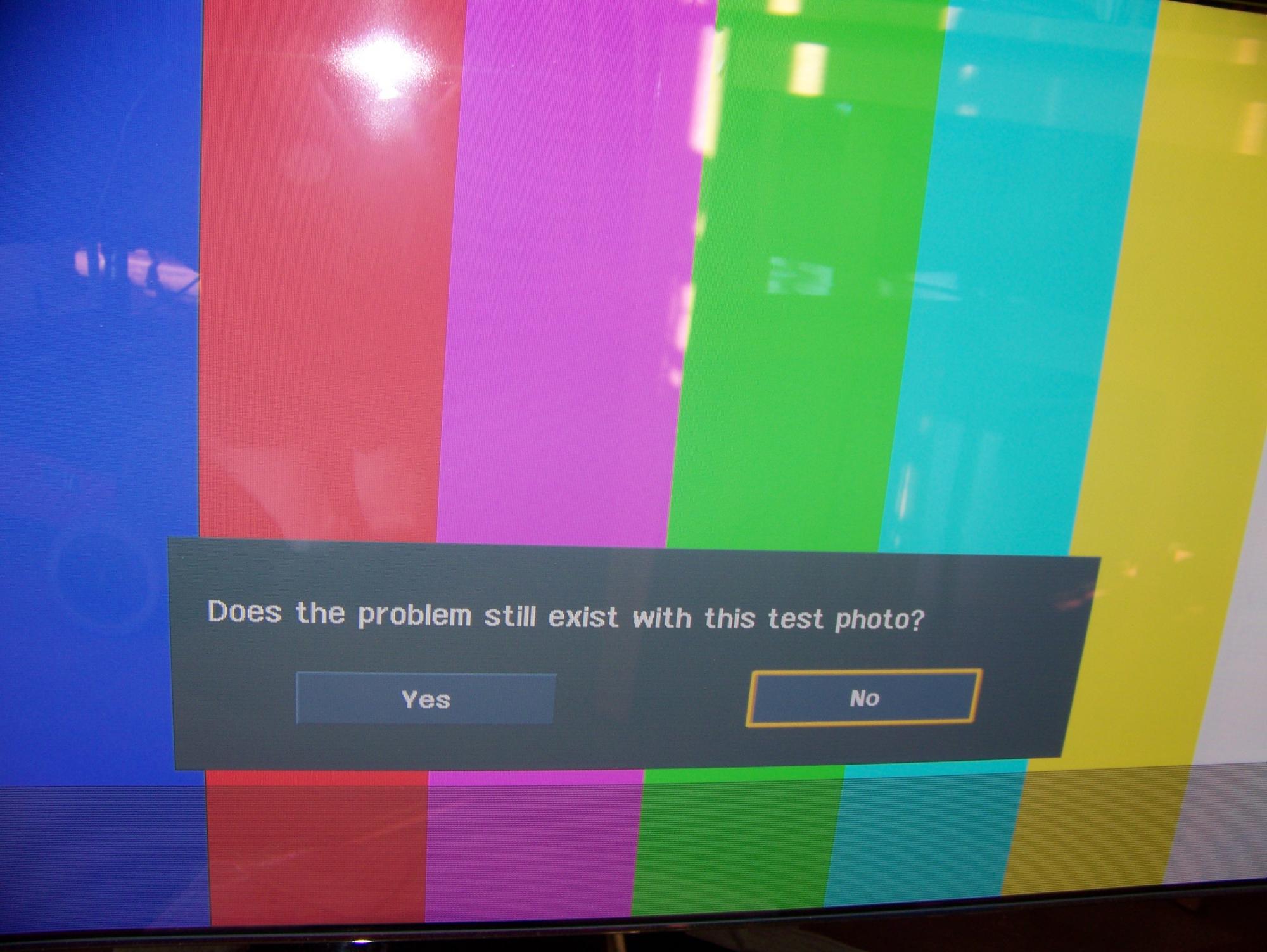

        Well I was so excited it worked that I didn't notice a shadow at the bottom of the screen. I hope this is a simple fix. I'm realy happy that it's
        working though.
        Please help.

          Loose Y driver FFC for the associated rows, disconnect and reconnect, if it still gives problem use a bit of contact cleaner in there (leave for 30 minutes for cleaner to evaporate, some are conductive.)
          I had the same problem with a Panasonic plasma and it was difficult to get the connectors just right. If you didn't get them just right you would get an interlaced pattern on some rows, like in your image. There's a trick to doing it, but it varies from manufacturer to manufacturer (or even model to model.) In case it's the same as the Panasonic, you have to push it in until you feel a slight click, and then you can engage the lever to lock it in place.
          Of course do this while it's switched off as those rows are energised with 400V.

            You were right on Tom66. I cleaned the contacts and the Picture looks great.
            Now I can say "It's fixed!",
            Thanks again
