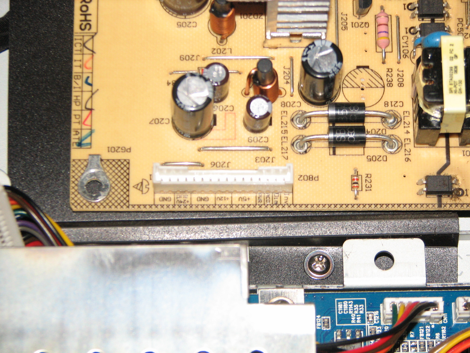

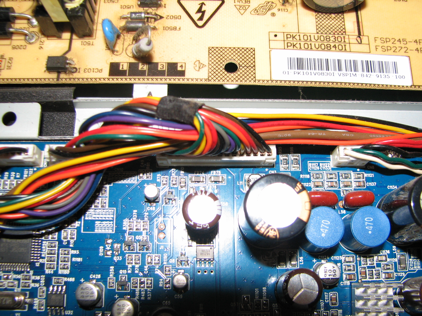

                                    #57
                                    Re: Toshibia 40rv525u Green Blinking light and questions about Caps!!
                                    What Should I do now?
                                      #58
                                      The readings you show are most likely good for the PSU.
                                      Post a close up of the connector going from the main board to PSU, on both ends. If there is a label next to the connector, make it easy to see in the picture. We have not established if PSON is good.
                                      • ComputerGeek
                                        • Oct 2011
                                        • 262
                                        #59
                                        Sorry for the delay in Responding, Here are the Pictures the only label is on the power board and the pin out is,
                                        1,2 Gnd
                                        3,4 24v+
                                        5,6,7 Gnd
                                        8,9 12v+
                                        10,11,12 5v+
                                        13 Pwr
                                        14 ACD
                                        15 D1m
                                        16 Inv
