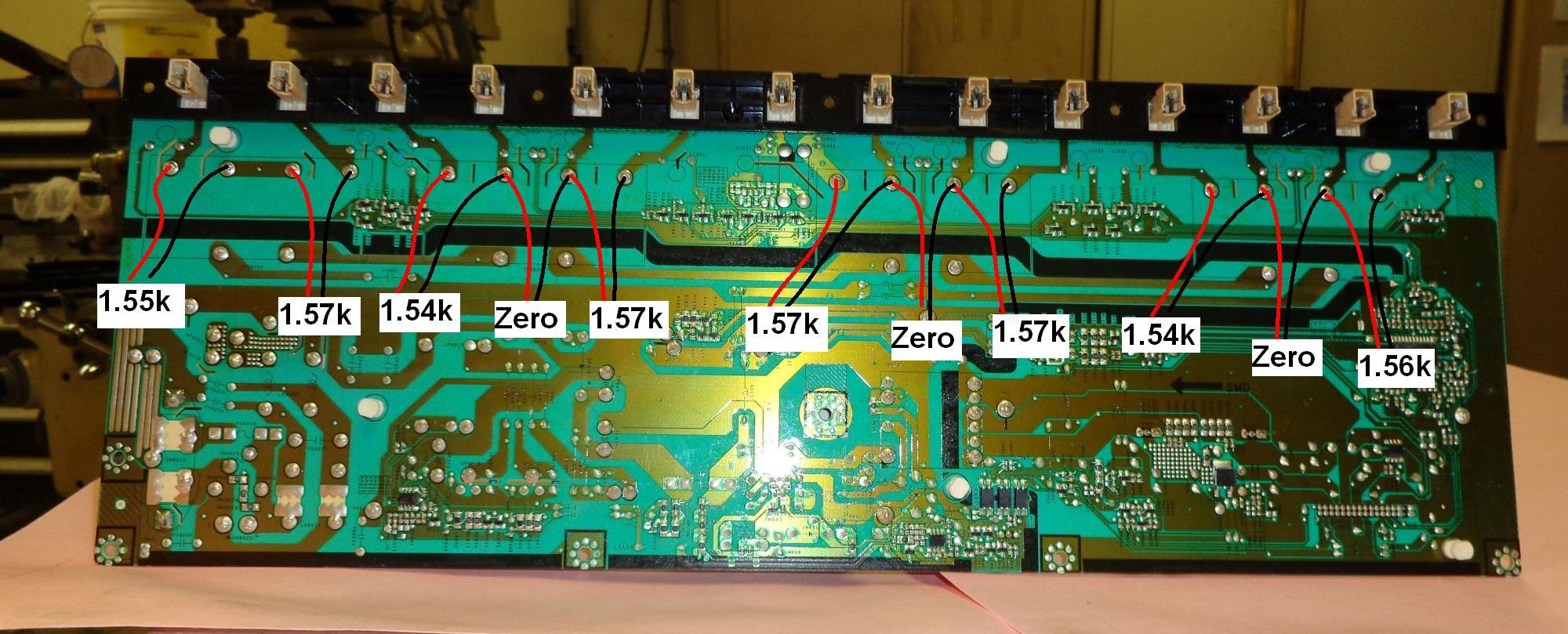

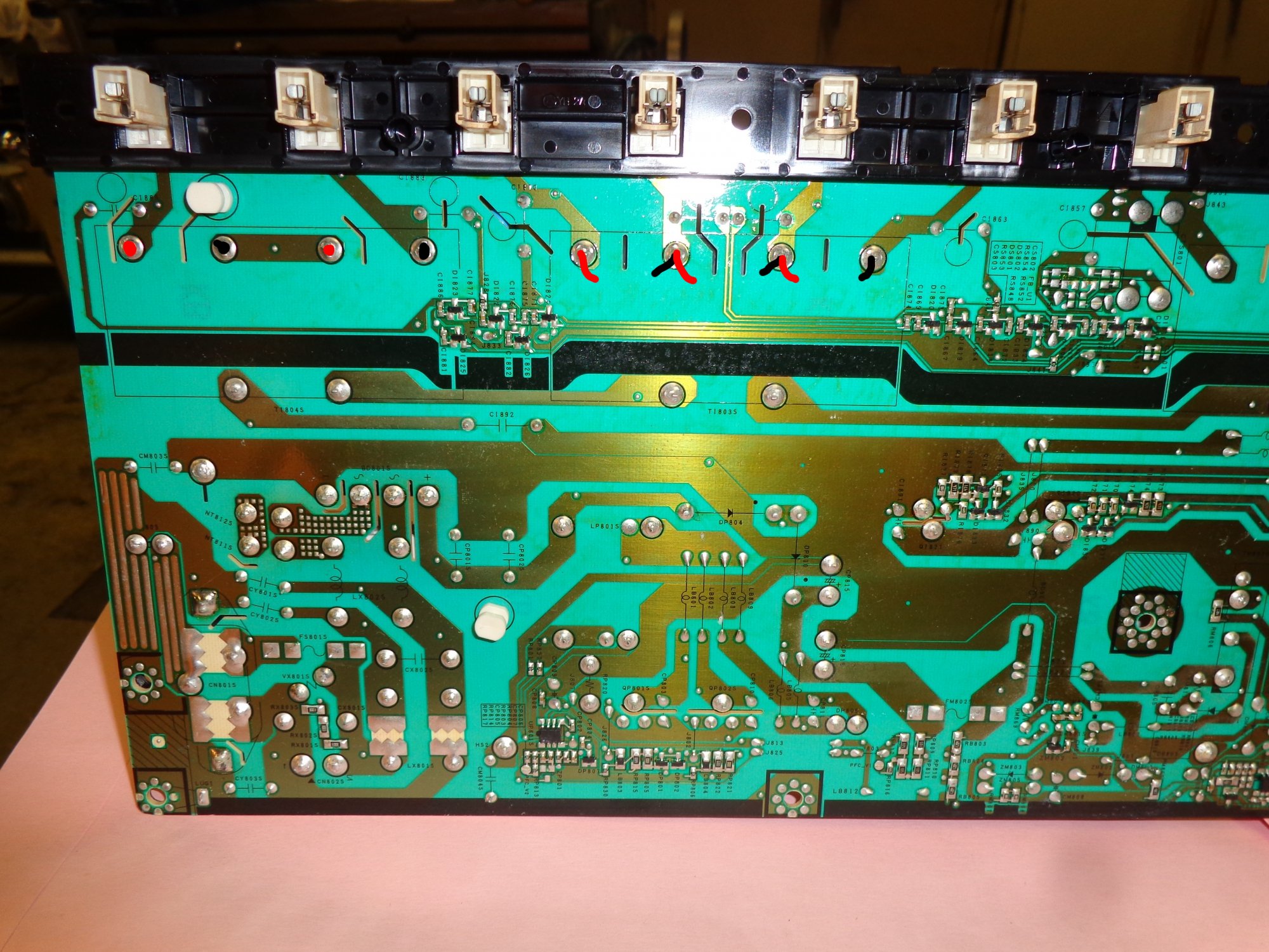

      Transformer test: first transformer, 20000 ohm range (or autoranging ohms, if you meter is autoranging) across each pair red and black, avoid the middle short link. For every other transformer test as indicated, curved pairs of red/black probes (though technically orientation does not matter it can help you be consistent in your tests so you don't double test or omit one...)
      Power to board must be disconnected or damage to meter could occur.

        Here are the results of the transformer test. I am guessing the test is to look for uniform readings between the secondaries. Is there a percentage value that you guys use in your decision making of OK or bad and if too far out one would then remove from circuit and retest? I'm just trying to understand what your thoughts are.

              The transformers are all OK, so I am guessing there is a bad bulb in the panel or some fault with the inverter circuit.

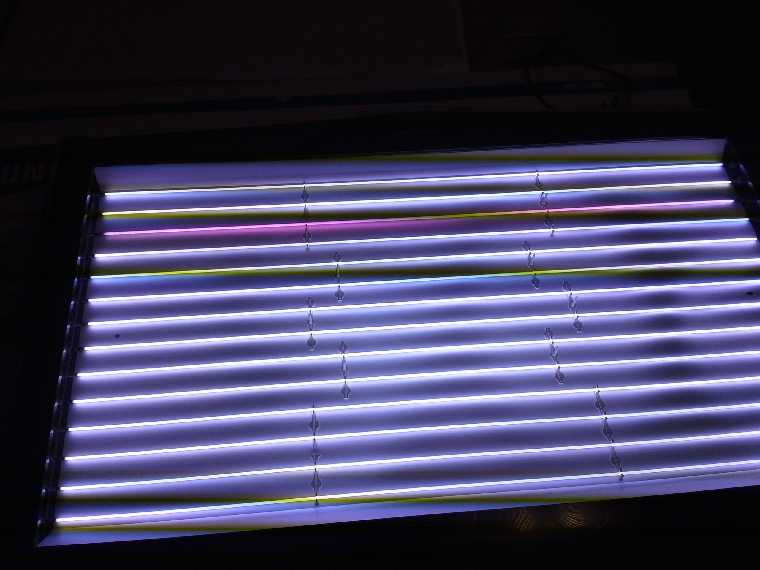

                  Its pretty simple to get to the backlights, the hardest part is getting the screen itself off without damaging it. Make sure you unhook any connections that block between the frame and the panel (usually the speakers, IR sensor, and buttons). Then just find any screws around the edge of the panel. The panel should easily lift up away from the frame if all the screws are off.
                  You'll then need to unscrew the metal frame of the panel that cover the tab bonds to release the lcd screen. The hardest part is gently and carefully getting the lcd screen out. It usually comes off easily (however in few cases it is slightly glued down... or itll be stuck in a tight fit between the black bezel)
                  After taking out the lcd screen, there will be a black bezel that needs to be removed. They are usually held on by latches on the sides. After that there are two white plastic pieces that cover the ends of the lamps. (They usually pull off easy on most panel or latched if not)

                    I'm back! Went to my friend's last night and worked on the screen. All was just like you guys said it would be. No lamps were damaged due to the mistake made with the sockets, and after getting the lamps exposed and firing the thing up, it looked just like Glitchers previous photo. I attached ours below. Thanks so much for the help getting this far. This site, thanks to the head stooge and its members has really put a spark back in my life, and I am truly grateful. No-one treats me like an idiot and I am learning so much. THANK YOU!
                    Now I need to find a 36" lamp. I will be in the hunt and would appreciate any guidance. Thanks again.

                                  Yipee!!
                                  Replaced that lamp and all lamps lit up bright and no flickering. What an adventure. Thanks to all for helping. I learned much and had a great time.

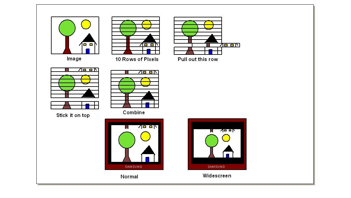

                                  But ... If you revert back to post 20, I attempted to describe a horizontal line problem. I read about tab bonds and told myself if the lamp solved the main problem (which it did) I would check into that. My plans were to flex the tab bonds with my finger and watch the line to see if anything changed. So after the lamp was placed, I re-assembled enough to fire it up and still get to the tab bonds. I presses on each one repeatedly (boy, they get warm) I saw no effect on the line. So we reassembled the set. We were watching the fine picture for a couple hours and I will try to explain what I saw relating to this line. I don't know the terms but here goes.
                                  This line is horizontal and the width of the screen. It is located at the very top of the image. If you are looking at an image which I will call widescreen, with large black borders, the line is the first scan line or row of pixels of the actual image. If you look at something like full screen, the line is still the first scan line or row of pixels in the actual image. So in layman's terms the line is not related to an actual row of pixels on the LCD but moves around with the actual displayed image. Don't know how else to try to explain it.
                                  After staring at the thing for a long time, I discovered something else. This "line" is an actual duplicate "scan line" (sorry) which appears to be duplicated from another area of the screen. If you look at the total image, and watch the movement of objects on the screen, and imagine taking one horizontal row of pixels from 3-4 inches from the bottom of the screen and stick it on top of all the image, that is exactly what that line is composed of.
                                  I read this over and even I can't understand what I am trying to say... be right back with a sketch...
                                  See attachment.
                                  The sketch shows my exagerated LCD composed of 10 horizontal rows of pixels. This is what I am seeing. I can't tell if the duplicated line is actually removed, but there is no visible gap in the area where it should be.
                                  I don't know how but this is what I see. Hopefully you won't think I am nuts, but is this even possible?

                                      Re: Samsung LN40B650T1F won't power on
                                      Hmm, I have had the issue you describe before. In my case it was caused by the overscanning settings of the source being set wrong for the TV - a bug with the source's software not the TV. A quick fix in some cases is to turn off the "Just Scan" mode on the TV - in the picture size settings. This will hide the faulty row of pixels.
