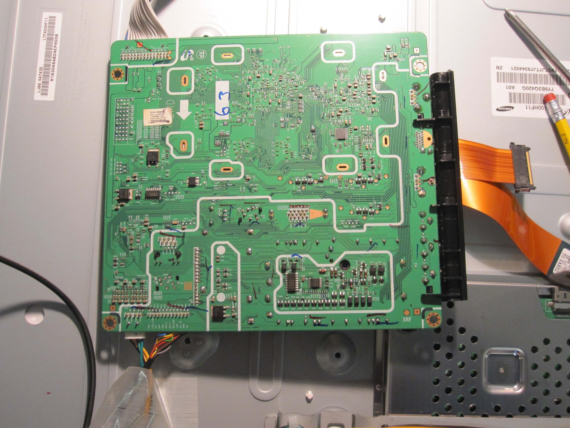

                Re: Samsung LN40B650T1F won't power on
                I checked the regulators on the back the voltages seemed ok but all were bouncing up and down from high to 0.something is turning them on and off. I have 5V at the connector but without a schematic, I don't know where to look.
