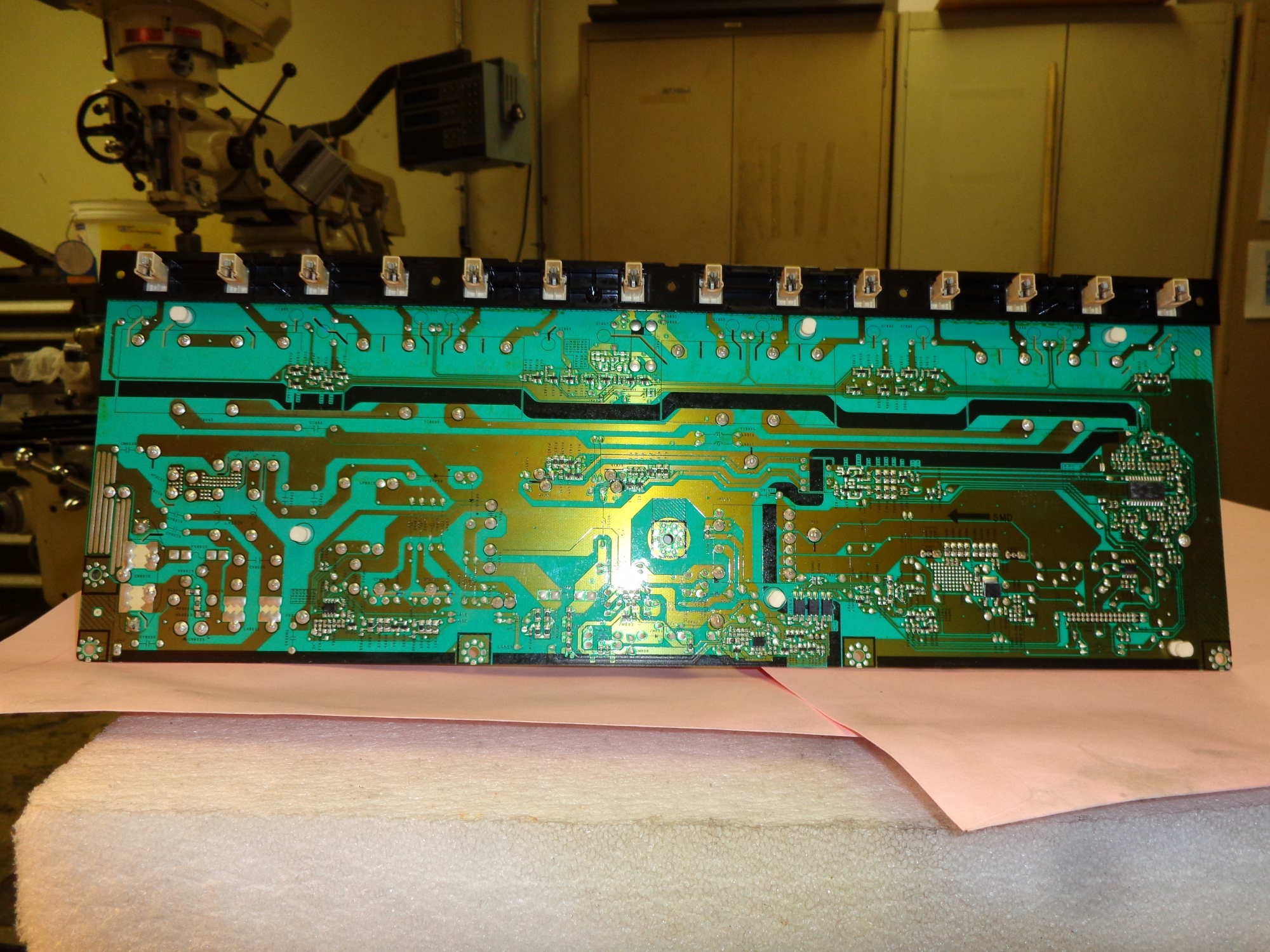

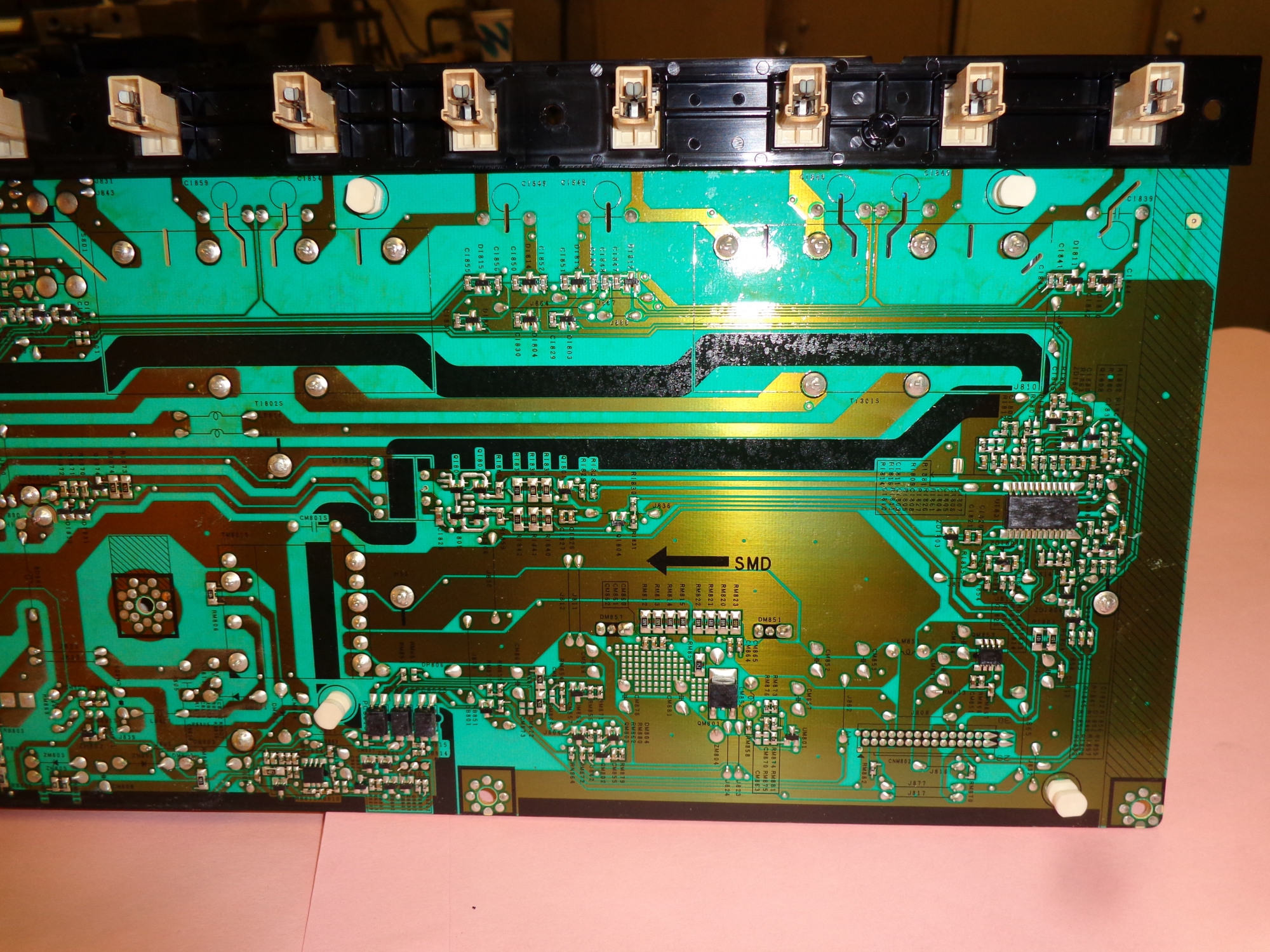

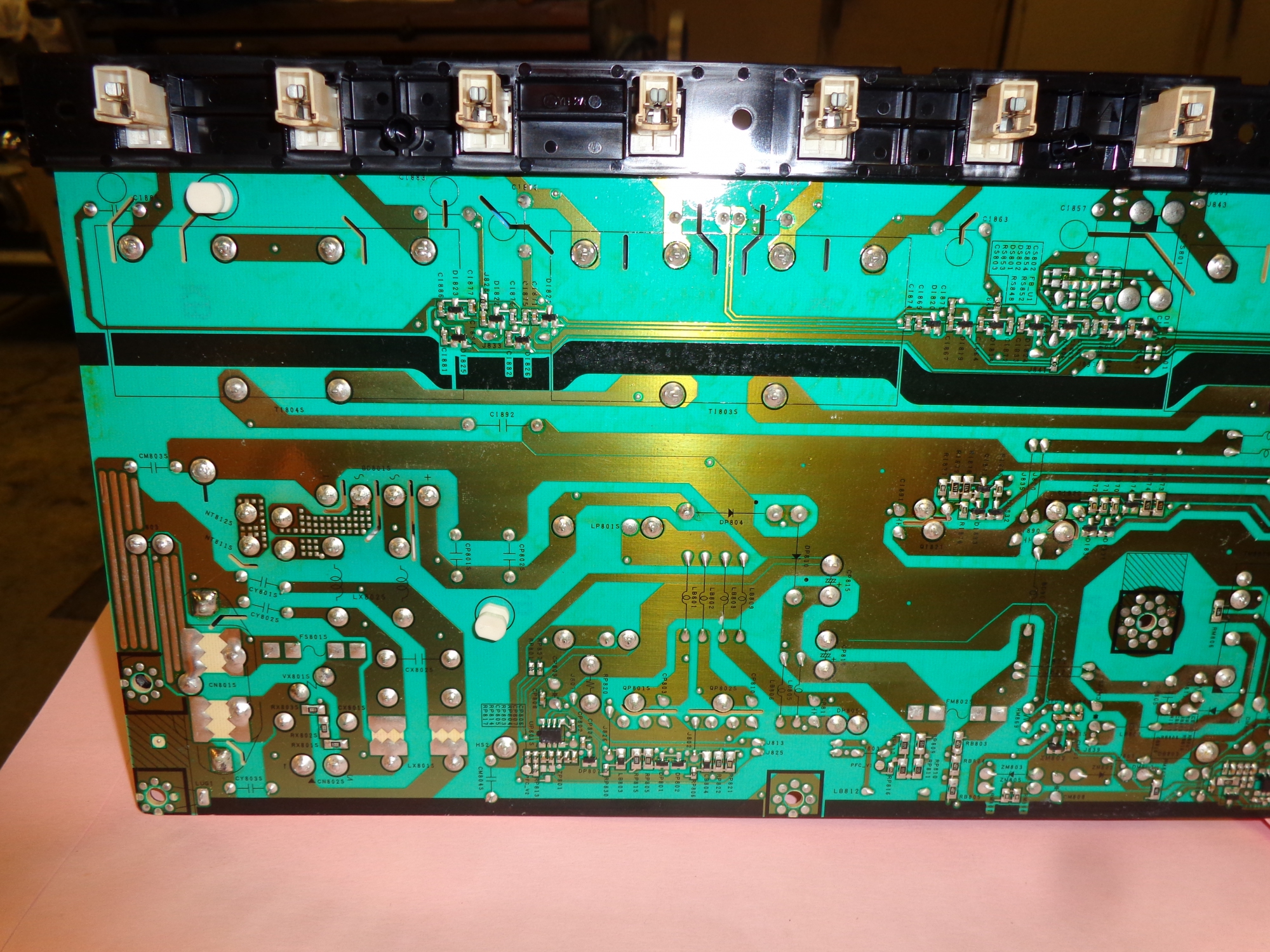

                                    #57
                                    Re: Samsung LN40B650T1F won't power on
                                    OK,
                                    Here are some photos of the back of the IP board. The ones of half the board may be a little clearer. Am anxious for instructions. Thanks.
                                      #58
                                      Oh no, you are not supposed to remove that black plastic that has the lamp sockets attached to it, the board is supposed to slide out from the black plastic. I hope the lamps are not broken.
                                      • MEB
                                        • Sep 2013
                                        • 371
                                        #59
                                        Oh No......
                                        I had my buddy remove the board as it is his TV. But in his defense, I would have probably done the same thing as this is the first TV I've been involved with. Thanks for the response and the information. I will determine the damage and reply with the assesment.
                                        • MEB
                                          • Sep 2013
                                          • 371
                                          #60
                                          Thanks budm for the pictures. It is very clear now what should have been done. I now have the board and easily slipped the black plastic piece containing the lamp sockets from the board as it should have been done initially. This is what I feel must happen now.
                                          Continue testing the transformers as tom66 stated. Could someone mark up the board so there is no question as to what to do? I think by reading posts I could do it, but I'd rather be sure.
                                          And I don't see any way to reliably reassemble the sockets to the lamps without disassembling the lcd screen. So I would appreciate any hints, advice, or documentation which might aid in this. I would also like to test all the lamps before reassembly as they were tugged on pretty hard due to the improper removal. Visually the tubes do not appear cracked, but having gone this far, I would want to be absolutely sure. Would it be possible to use a smaller lcd monitor with working backlights to test these much larger tubes? I have plenty of those around.
                                          Any advice would be appreciated. It is almost an obsession now to fix this TV. But at least learning alot in the process. I tried to buy the set from my friend, but he still isn't ready to give up, so I guess I'm in it for the duration if you guys will stick with me. Thanks.
