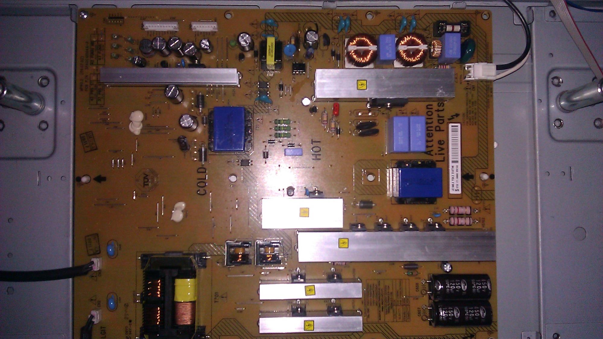

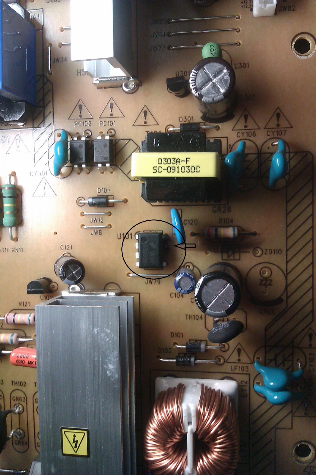

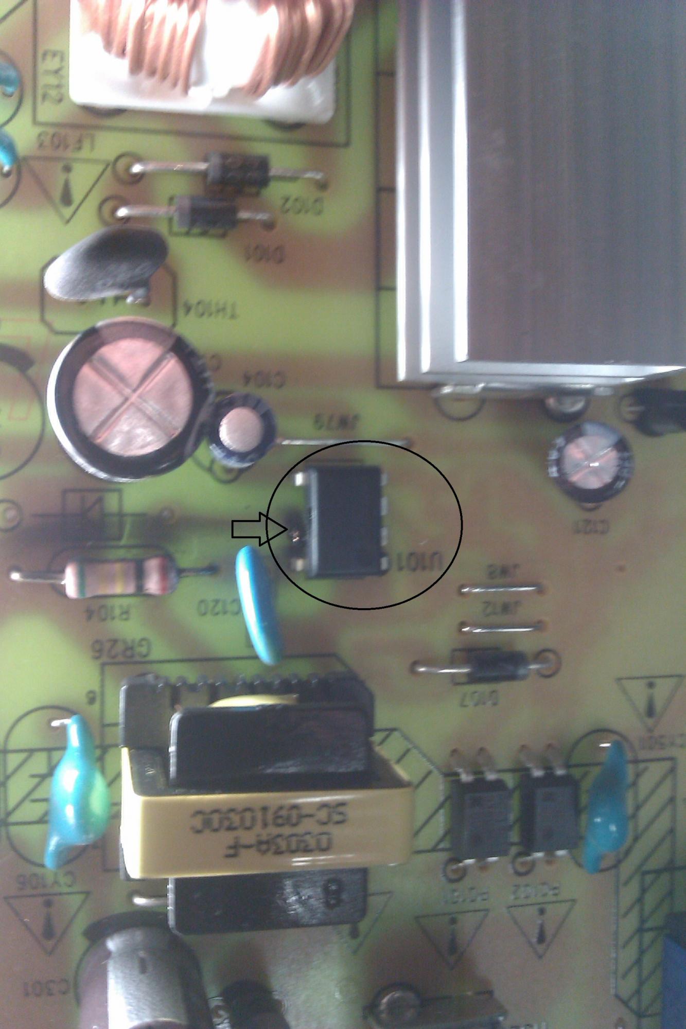

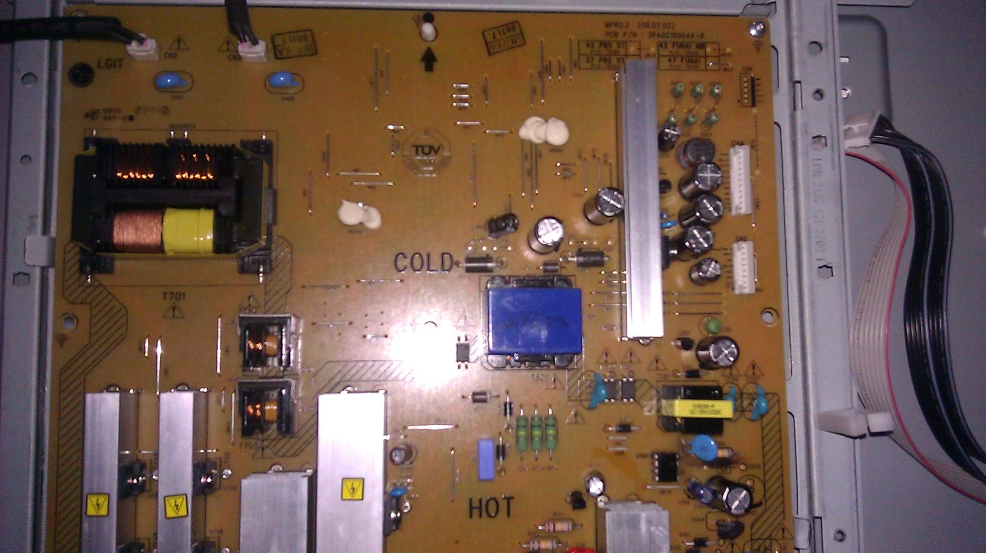

    I have been on this site for a few days now researching my problem and kind of have an idea of what my problem is. Long story short I have a Philips 47PFL5704D F7 and when it's plugged up I get no power at all. I opened the back and looked for the usual suspects being the caps and all seem to be good. But I did come across a IC chip (U101) labeled FVK31 "bottom line" FSQ510. This chip has 7 legs and the side with 3 legs is blown the leg is blown off the chip, so I think maybe replacing this chip may solve my problem. Then I begin to think what would have caused this problem and if I replace the chip will it blow again. So any help would be gladly appreciated.

                  If it's the drain it's tied directly to the internal fet, so it's likely the fet died in a spectacular fashion. Causes include a power surge, high temperature, peaking drain voltage (exceeding 700V is okay once or twice... but not too many times) or a chip that was just on it's last legs (e.g. from being operated near it's limits continuously, like in a current limit mode.)
                  I would expect the mains fuse to blow; check that (including the plug fuse.)

                        Ok I tested for shorts and here are the results so far.
                        D101--.554
                        D102---.558
                        D107--.458
                        D111---.460
                        D301--.193
                        D510--.458
                        D501--.457
                        D203--.164
                        If I test the in opposite direction I get 0 for all D***
                        R104 -- 196k ohms
                        tested the Bridge and no shorts it tested good
                        Please let me know if I'm missing something.

                                Ok I installed the FSQ510 chip and still no power to the TV........
                                  Re: Philips 47PFL5704D F7 No Power
                                  With the FSQ510 chip installed in the circuit, measure the voltage on pin 3 (Vfb), pin 5 (Vcc), and pin 8 (Vstr). Post what voltages you get. Use pin 1 and 2 (GND) as ground or use hot ground (the "-" of the bridge rectifier on the primary).
                                  Try to perform the test fairly quickly (i.e. don't apply power to the TV for too long). This is to prevent anything else from going bad.
                                    Here are the readouts.....I used pin 1 as ground
                                    pin 8 -------147 volts
                                    pin 5 ------- 0 volts
                                    pin 3 ------- 0 volts
                                    Thanks again!
                                    I was trying to find a schematic of this board but can not.
                                      Interesting...
                                      Pin 5 (Vcc) needs to be at least 8.7V in order for the FSQ510 to start and continue to be no less than 6.7V for the FSQ510 to keep operating. Should there be a fault, data sheet says the voltage will fluctuate between 6.7V and 8.7V. The fact that it's not suggests that perhaps Vcc is being pulled low by a shorted component.
                                      The voltage on Pin 3 (Vfb) should also be close to 2.8V when the PSU is operating normally and 4.7V when in overload protection. Getting zero for this one likely means the PSU is not even trying to start.

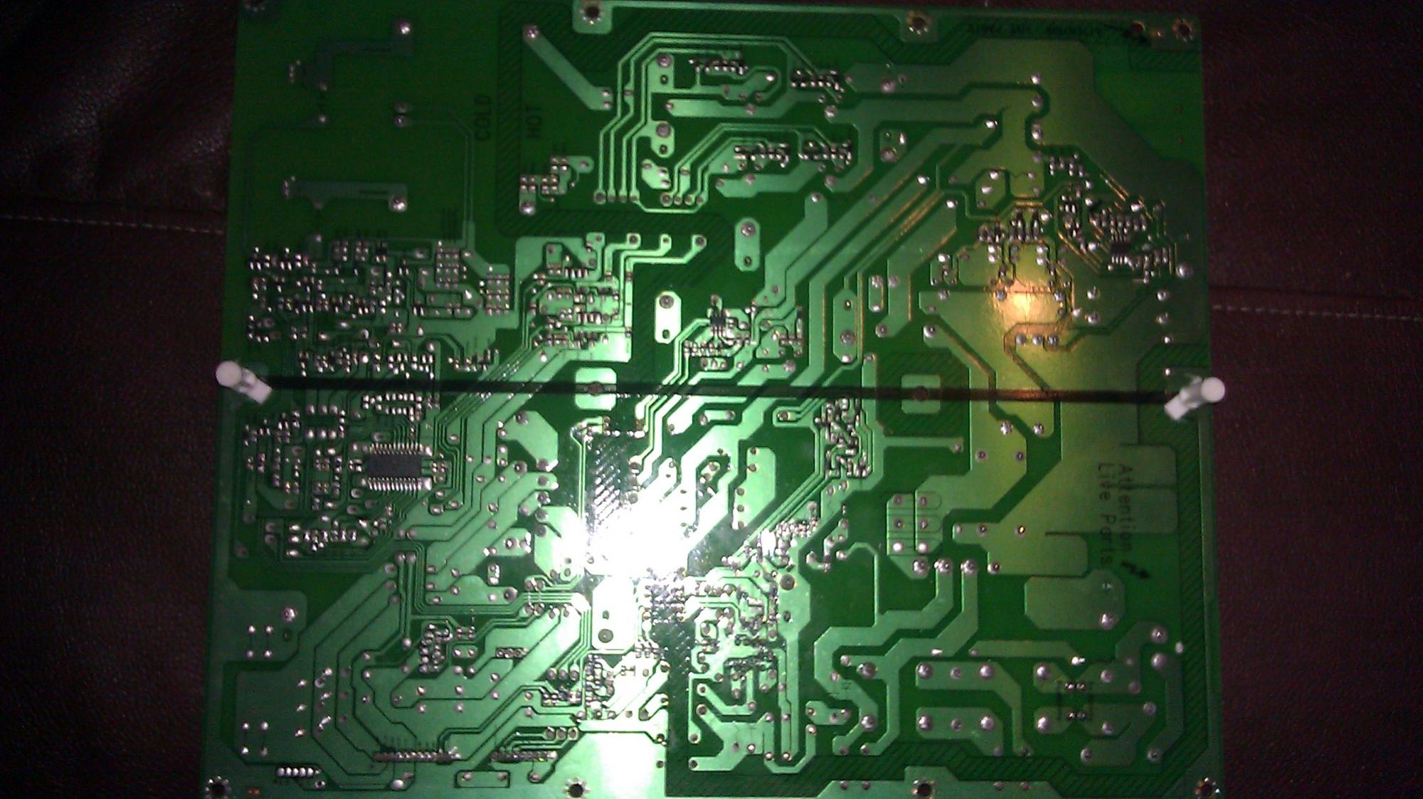

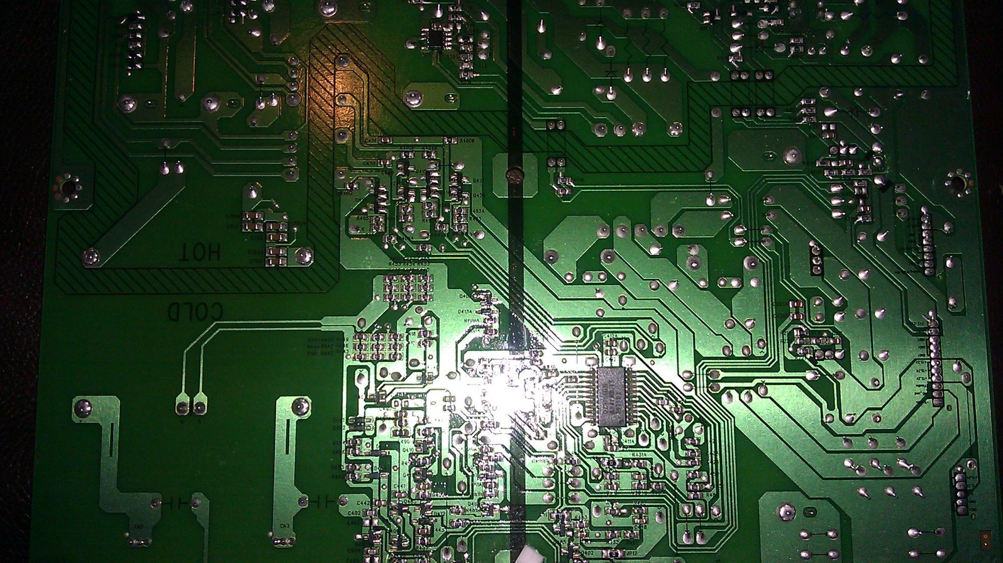

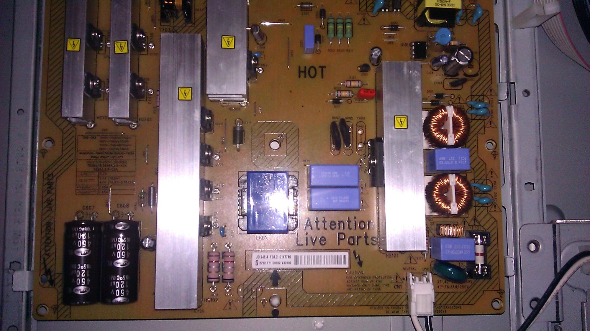

                                      If possible, post a few more pictures of the PSU - one capturing the underside of the whole board and 1 of the topside again capturing the whole board. The FSQ510 data sheet has a sample circuit on page 2. It looks pretty simple. I think we should be able to figure out the circuit in your PSU without a schematic pretty easily. Just need good pictures.
                                        Thanks again I just posted multiple pics to make sure that you can see them good.
