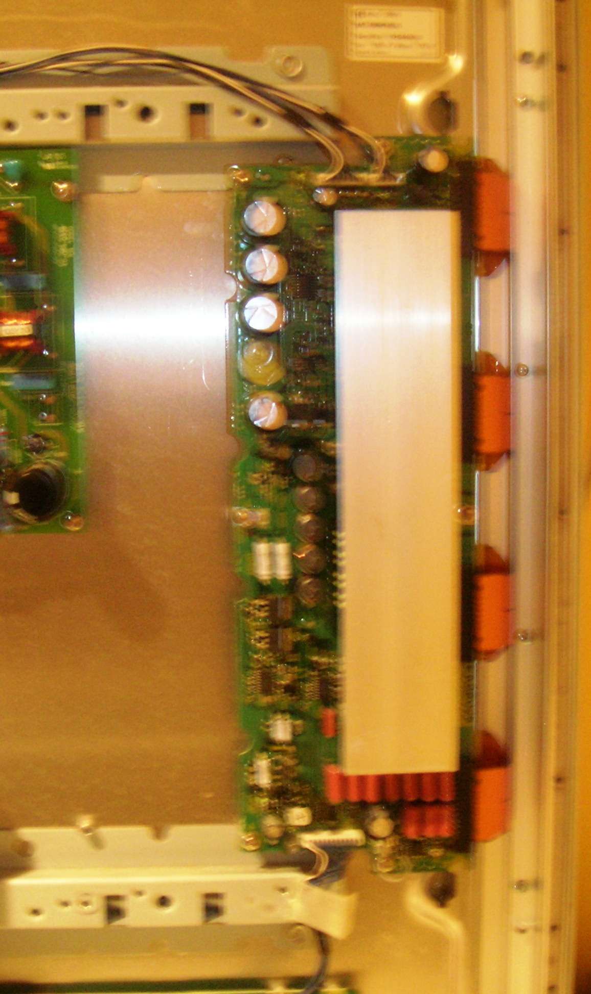

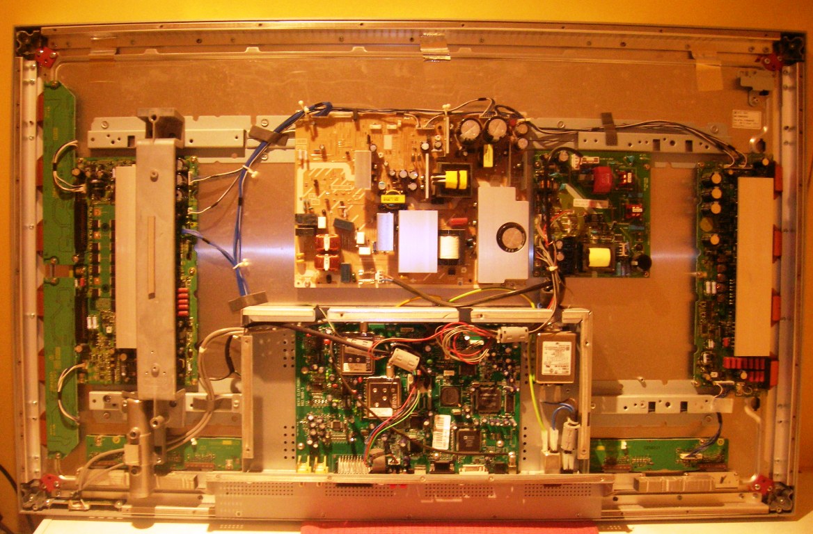

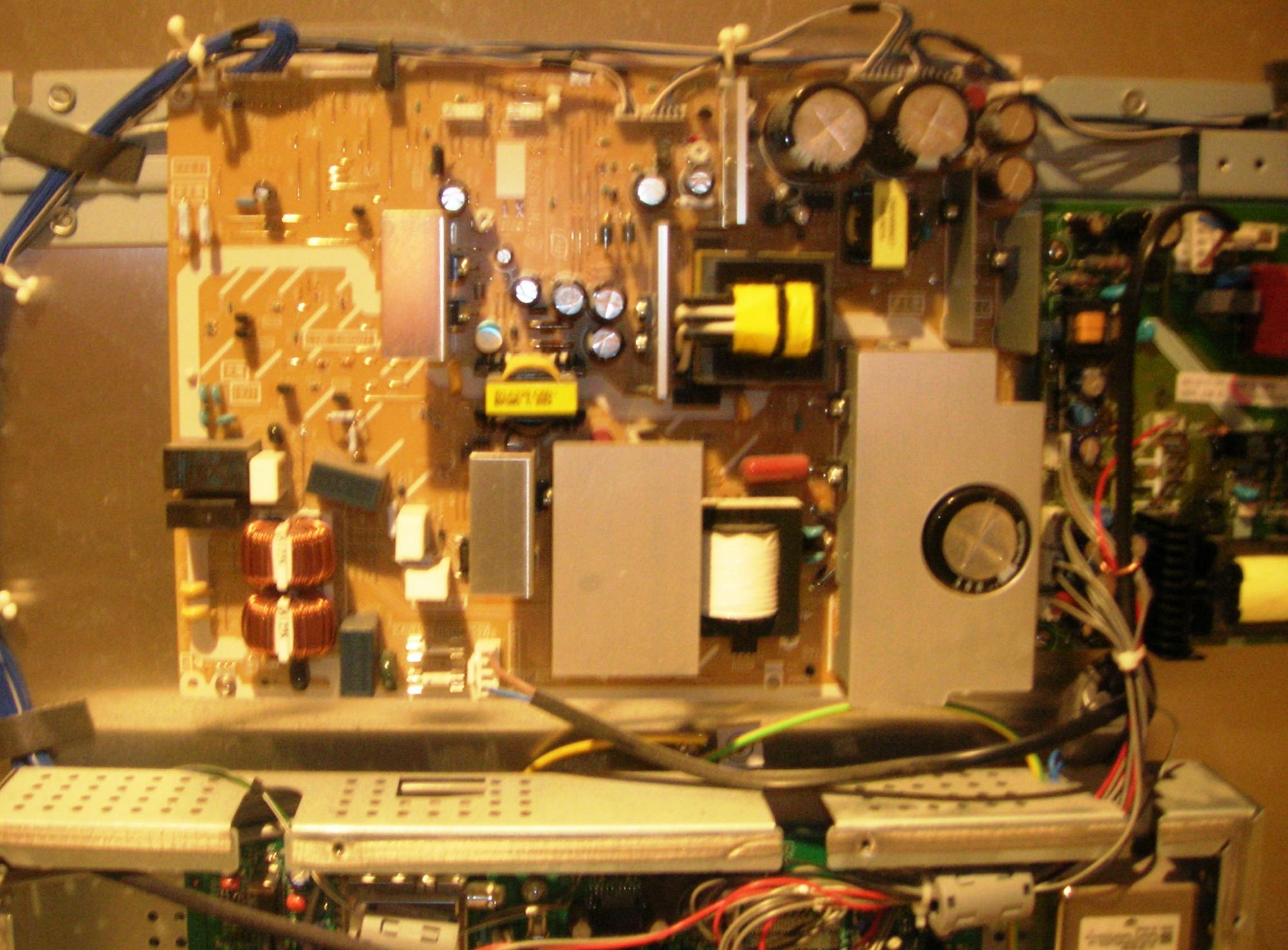

    Hi I have a Goodman GTV42P6 plasma that I picked up to play around with (never touched one before) with the aim of repairing it so the kids can use it with the games consoles .

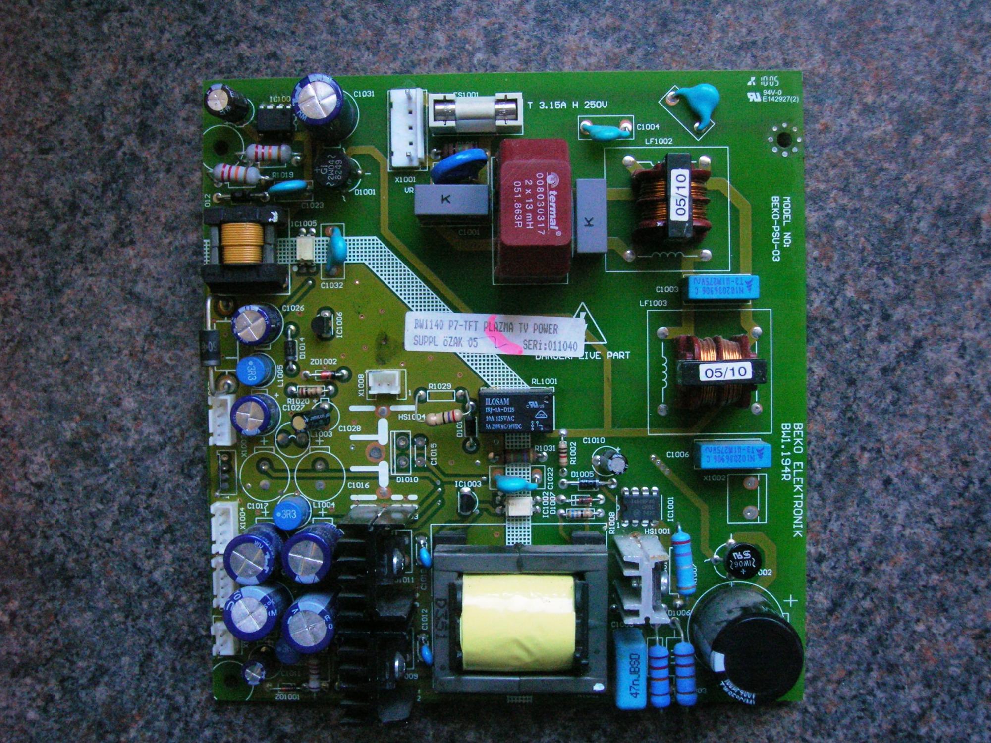

    Bought as dead no power or standby lights opened it up and checked the psu after reading about repair kit and tested what I could before replacing the blown fuse .
    Screen now lights up but is grey and there is still no standby light .
    The boards either side have green led's on them that are lit .
    Basically is it worth buying a psu repair kit and seeing how it goes from there any input welcome can do pictures if needed

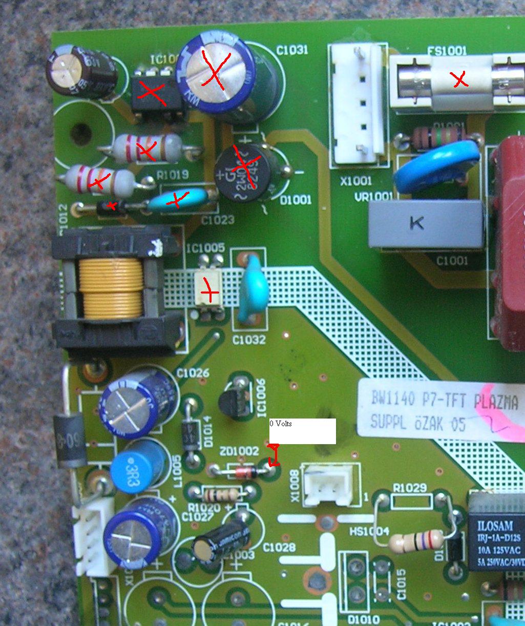

    Ok bought a kit
    IC1004 FSD200
    IC1005 PC817 op coup
    D1001 B250/1500 Bridge rec
    R1018 R1019 22K 3Watt res
    D1012 FUF4007 Diode
    FS1001 3.15 amp fuse
    ZD1002 Zner 12v
    Also changed C1031 as it was swollen and C1023 bit charred .

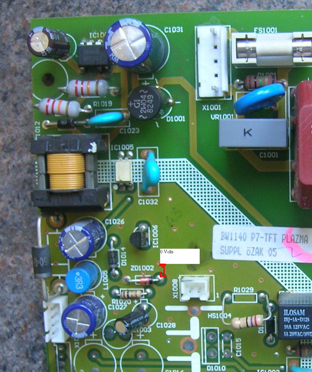

    As yet not changed the zener as i wanted to check voltage before fitiing
    one side showed no volts other showed 0.7v and still have grey screen no standby light

      Right problem solved thanks to FIXITNOW i went back and rechecked everything tracing as to why i had no voltage at the zener diode .
      All components checked ok until out of frustration i checked the fuse and it was dead popped in a new one and all fired up .
      So moral of this misadventure even if its new check it
        Re: Deadish Goodman GTV42P6

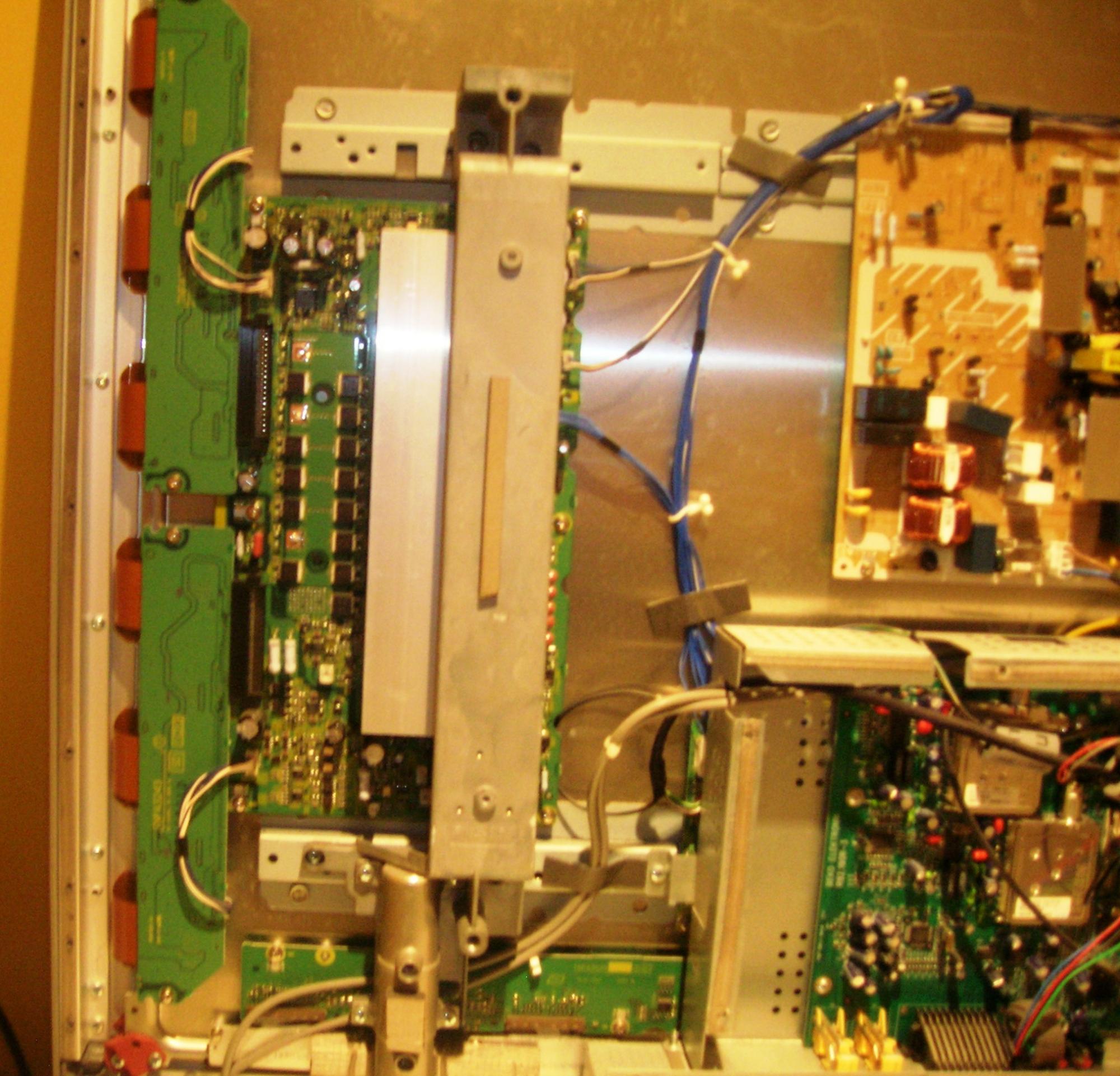

        Interesting. Looks a lot like a Panasonic plasma TV, but with the Goodmans name on it. I didn't know Panasonic sold panels to other manufacturers...

          Well as i said this was my first delve into Plasma but the kit i bought also
          fits some Bush and Grundig models that use this PSU
