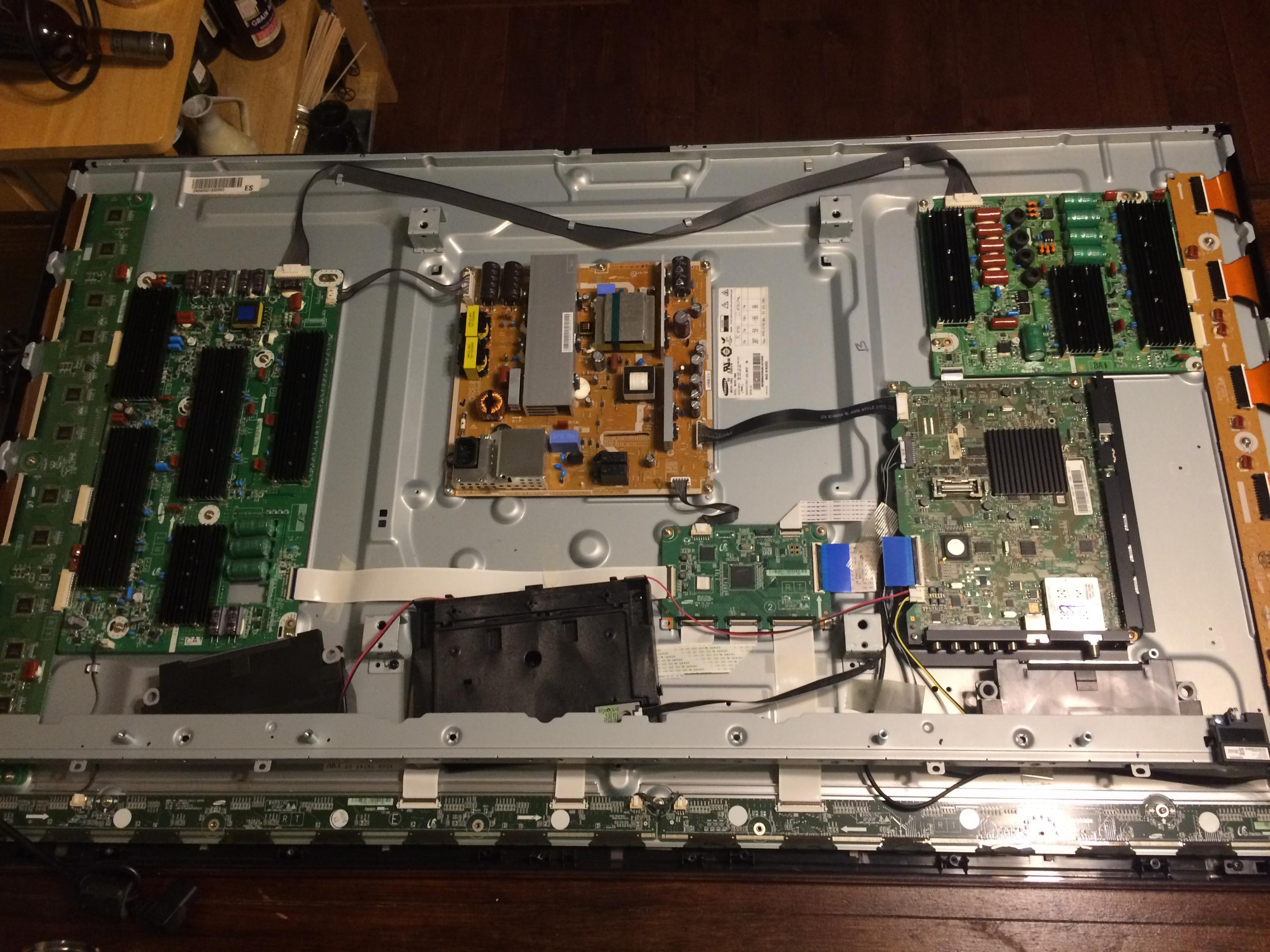

                    I have the exact same issue on a Samsung P59D6500. It's on the far-left from top to bottom. It's approximately 4" wide. The TV got this issue around the 2-year mark and Samsung wouldn't do anything for me.
                    I've taken the back panel off and ensured the ribbon cables along the side of the TV are connected before but don't know if there is much else I can do.

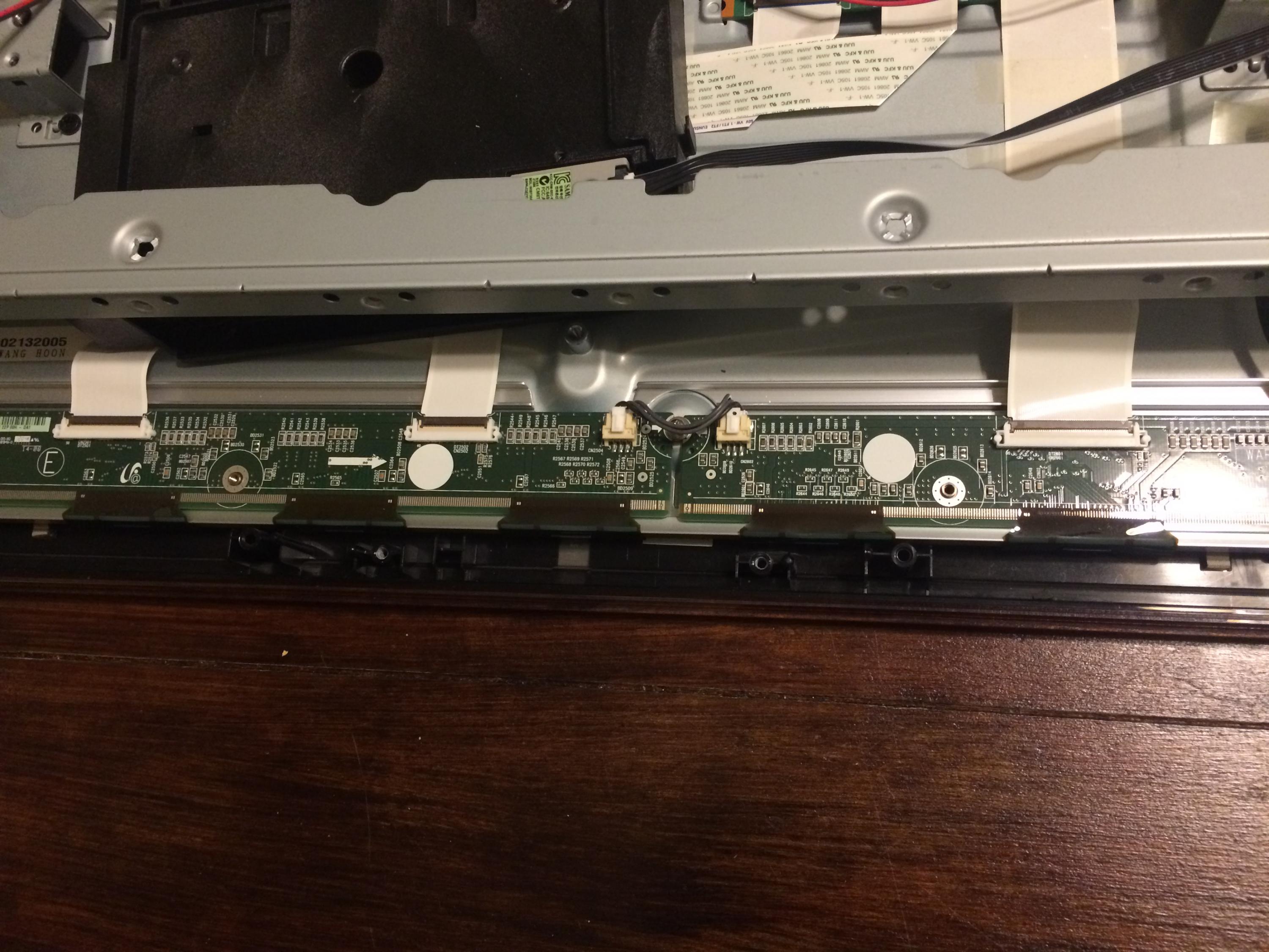

                        Sorry old thread, but what difference would this make? I have a Samsung PN51E7000 which started out with a few thin vertical lines. It eventually turned into an entire vertical black bar about 3" wide with the thin vertical lines visible within.
                        I tried removing all ribbon cables going to the bottom (x-buffer?) boards and turning on the TV. The image was just dark noise, but the vertical black bar was still visible. This leads me to believe the problem is the chip on the ribbon cable going to the panel :/
                        In hopes for a cold solder issue, I tried flexing/tapping on the bottom boards, but the black bar remained. Even if it was that bottom board, the ribbon cable from the panel appears soldered or glued and I wouldn't know how to reconnect it.
                        It's pretty frustrating knowing that a little chip going bad can ruin an entire TV.

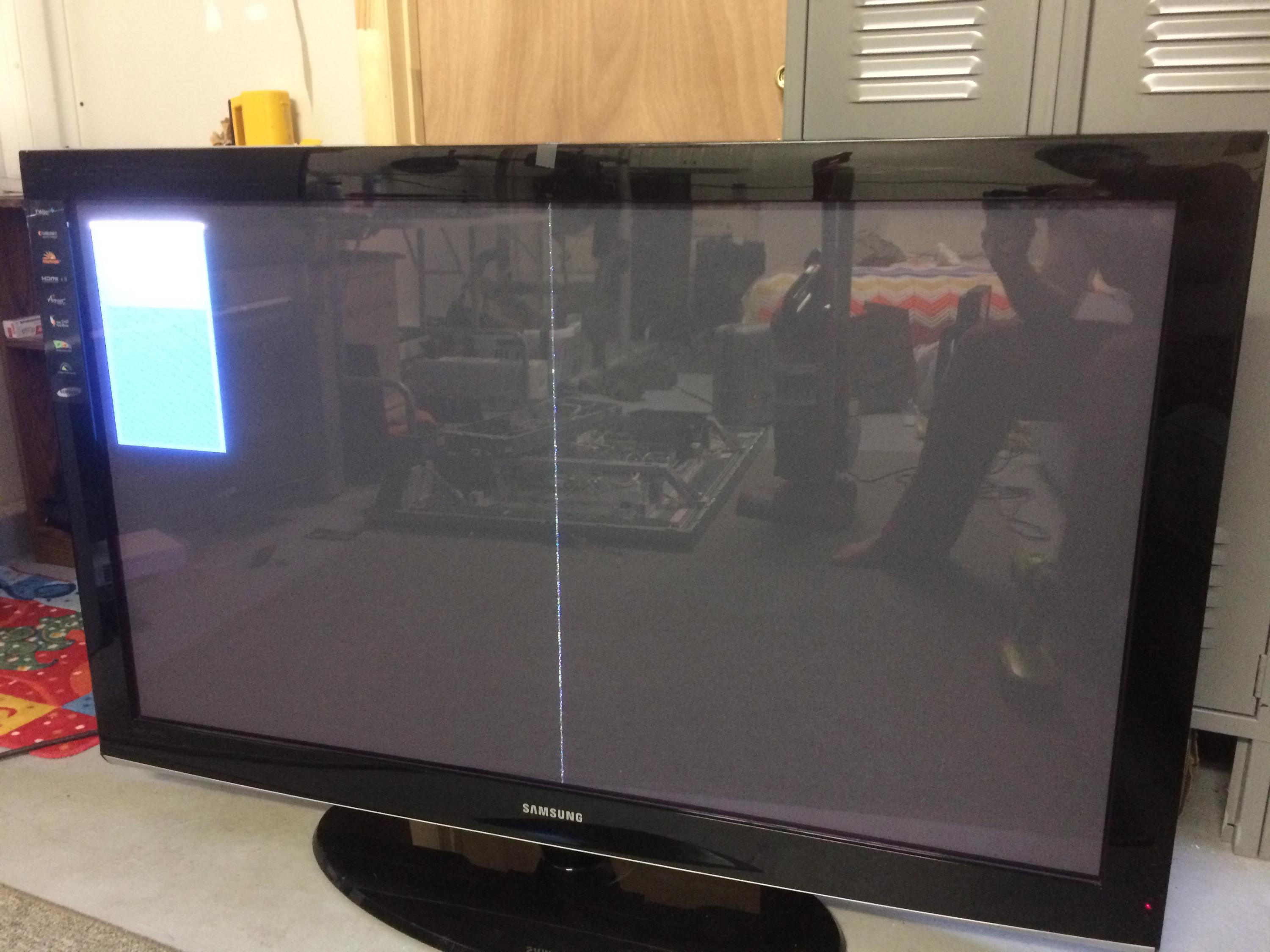

                          what does it mean if the black abr shows pixels inside? I have a samsung plasma with that issue. the bar is in the middle, where the two thin boards that control the vertical pixels are hooked together with jumper-wire type of connector. I can add a picture if that helps.

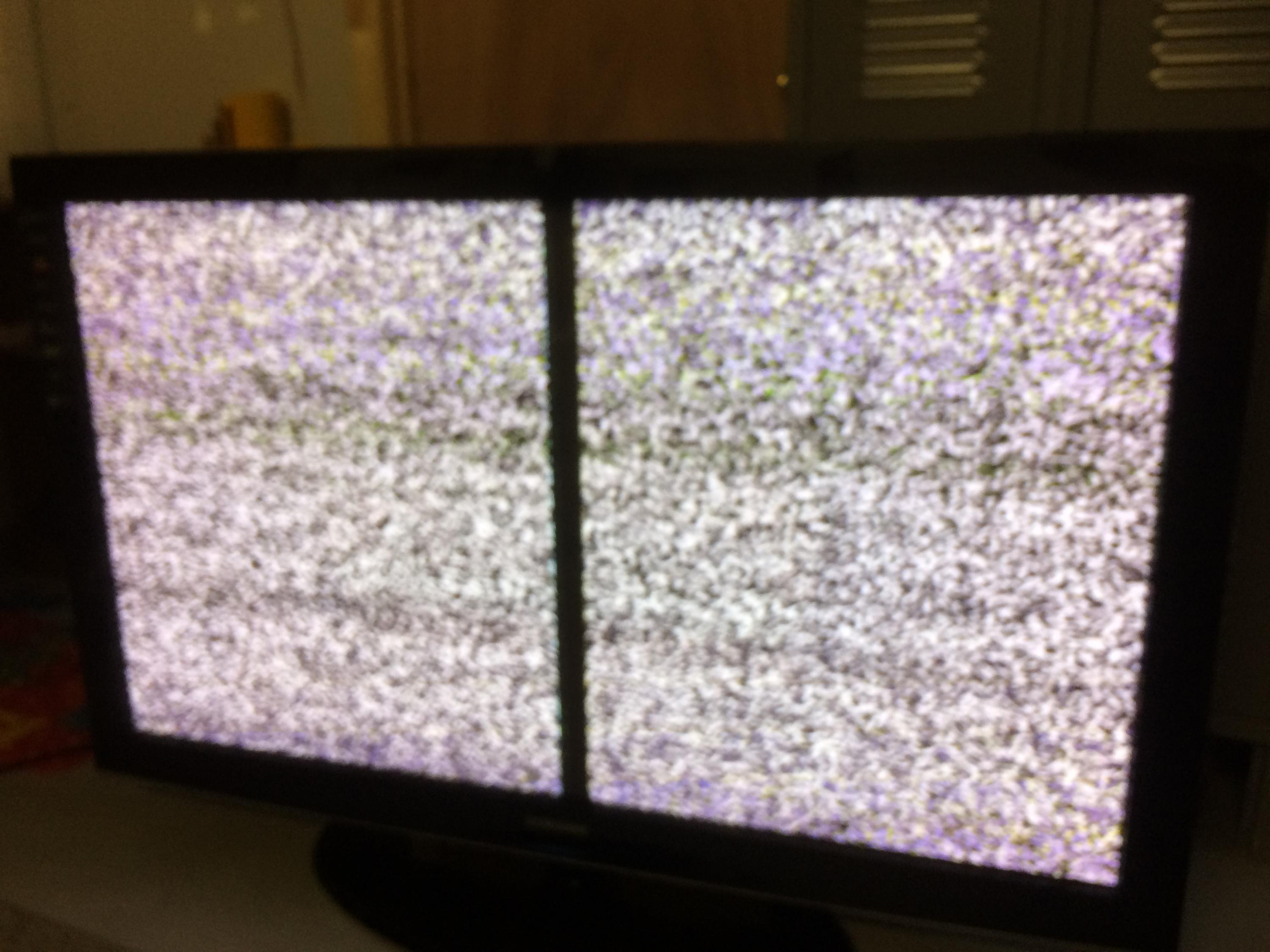

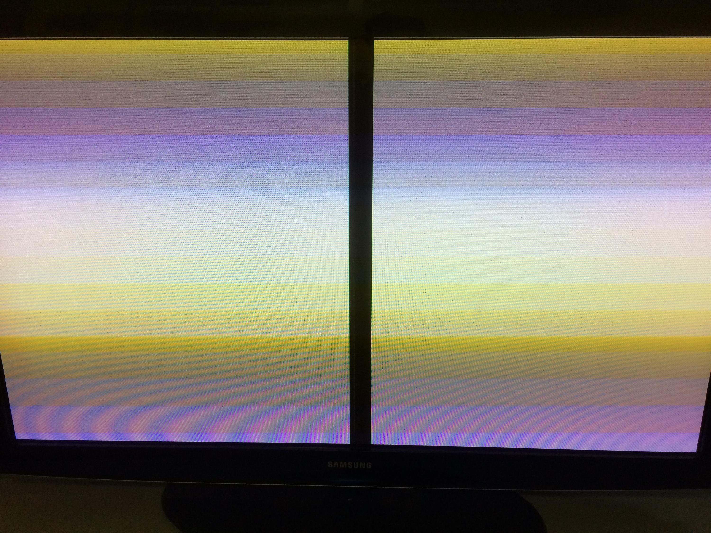

                                im having a similar issue. I have a black bar straight down the center of the tv, and if you were to divide the tv into two equal squares, there is a thin strip right in the middle of the screen within the black bar. I opened the TV up, and the bar is located where there aren't any ribbon cables or anything going right to where the bar is generated on the screen. should I check one of the boards? I will open it up again if yall think its fixable. otherwise ill sell the boards and scrap the screen.
                                I upgraded to the newest firmware and it didnt change anything.
                                also the first time i turned the tv on after closing the back, I saw many green and red vertical lines for a split second during boot, right as it was pulling up the video input. I can't get the tv to show them again, so I dont have a picture.
                                model is pn50a450p1d.
                                thanks for any assistance. I bought this TV for cheap as-is, so i wont be distraught if its not fixable.

                                  also that colored vertical line in the very center of the screen is there from the moment I hit the power button. so...dead panel, right?

                                    Have you tried reseating all ribbons and cables? With power off and disconnected with 30 second drain time when you do the reseating.

                                      I will try tonight. I didnt do every cable, just the ones closest to the bar's area of the screen.
