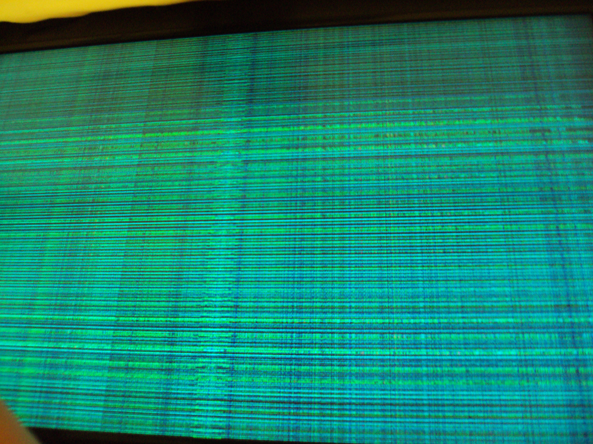

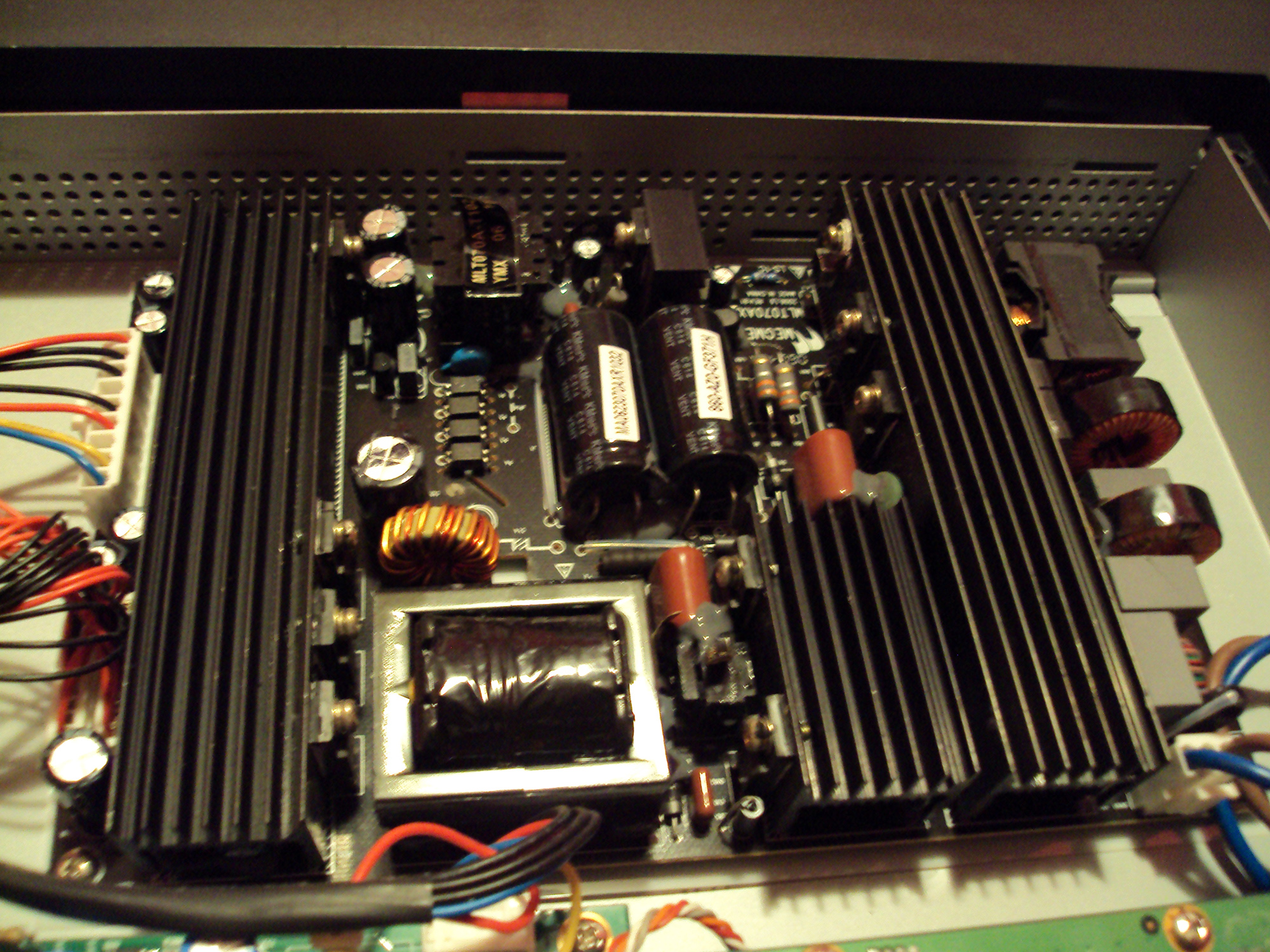

    ok so ive gotten my hands on this 37 in polaroid and the problem im having is it will sometimes power up to a blank screen, but you can see the backlights come on and sometimes it shows up like the pic below. All scrambled. i took a look at the power supply board and no caps seem to be bulged in any way. im thinking the mainboard but was wondering if anybody else had this problem and what they did to fix it. thanks

    what brand capacitors?
    polaroids are known to have bad cap issues, which is not always visible (the caps sometimes "dry up").

      sorry for the long wait i was out of town. the caps are mosetly capxon but cap c113 and c112 are nichicon so maybe those have been replaced before?

        do you think a simple cap kit will fix this issue? i know the capxons arent that good when in comparison to nics, panasonics, and so on.

          You are being too generous. CapXons are junk compared to most other brands.
          Since no caps are bulging, I won't state that recapping will fix the problem, but it is the most logical thing to try.
          PlainBill
            Re: another polaroid 37 flm373b problem
            I've seen this problem occur when the power supply goes bad. It's due to the 5V going to the T-con dropping out (in my case the motherboard supplied the 5V, from a buck converter - the converter had failed and I rigged a 5V supply up to it but it started overheating and the picture froze with lines all over the image and eventually became the image you show.)
            There are two caps on the power supply, 1000u 10V I think, that filter the 5V rail. If those go bad then the T-con will go funky.

              thank you for your insight. i will try a cap kit first and foremost.

                ok so i recapped this power supply and i did get better results. i can now get a picture but it still seems distorted. i cant read the menu when i press the menu button but in the big letters if i was on a channel i can read that although not to well. Also on a fuzzy channel the pic is green?
                  Remove the LVDS cable and plug it in again. Very common for it to come loose during service of these Proview TVs causing odd symptoms.
                    yup that fixed it.. thanks again for the help.

                          the only caps i dint replace on the power supply though are the 2 really big ones side by side and one small one close to t104 underneath the small heatsink.
