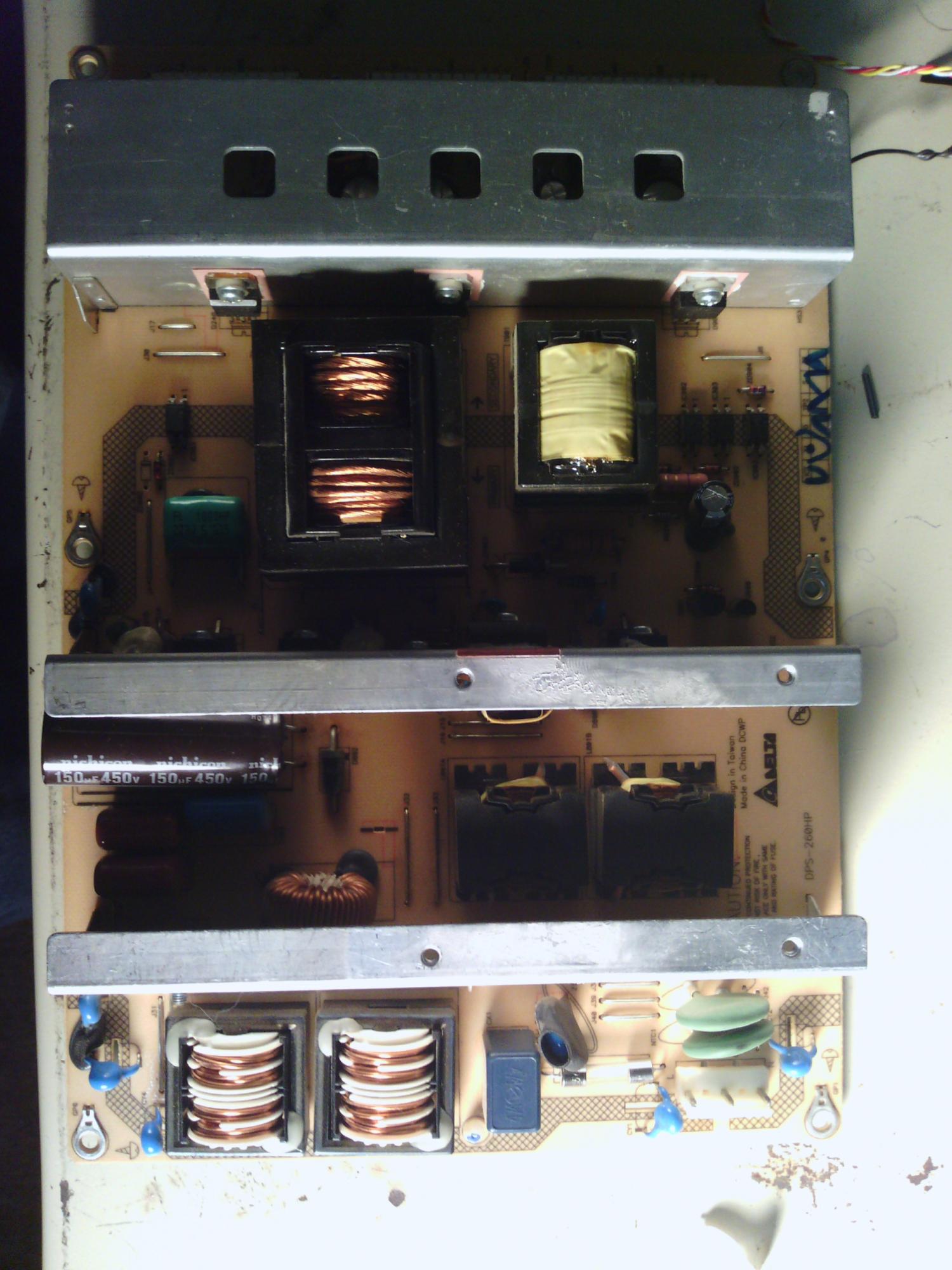

          Re: Vizio VW42L HDTV10A [Only Standby 5v, No Light]
          Whenever possible, post clear pictures of your power board. Use "Manage attachments" when posting these pics.

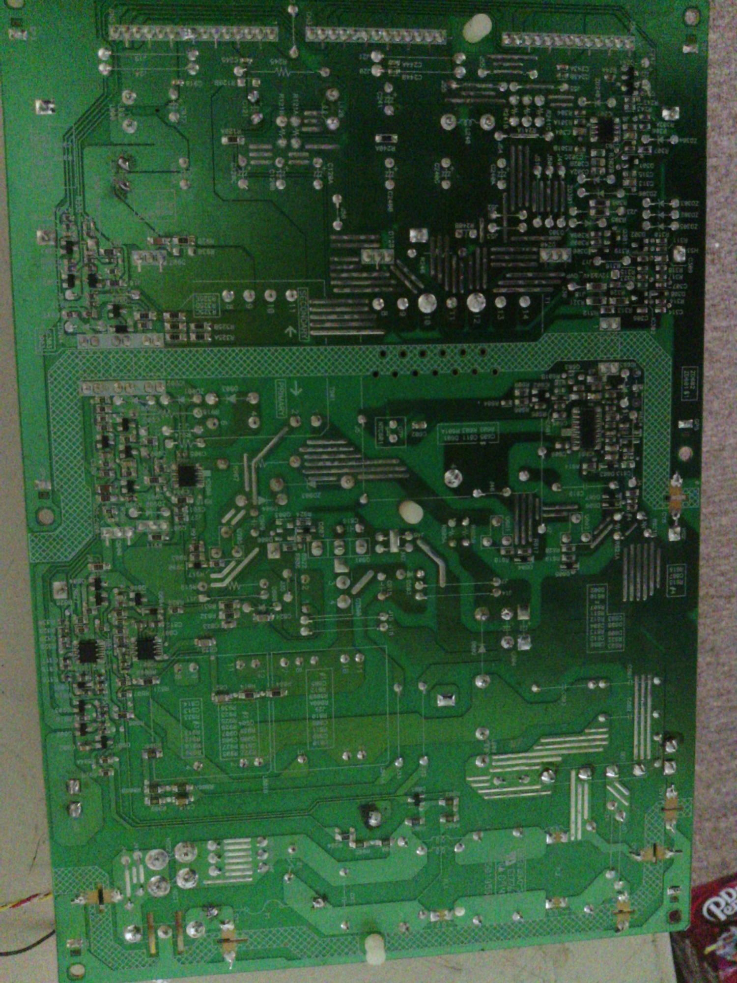

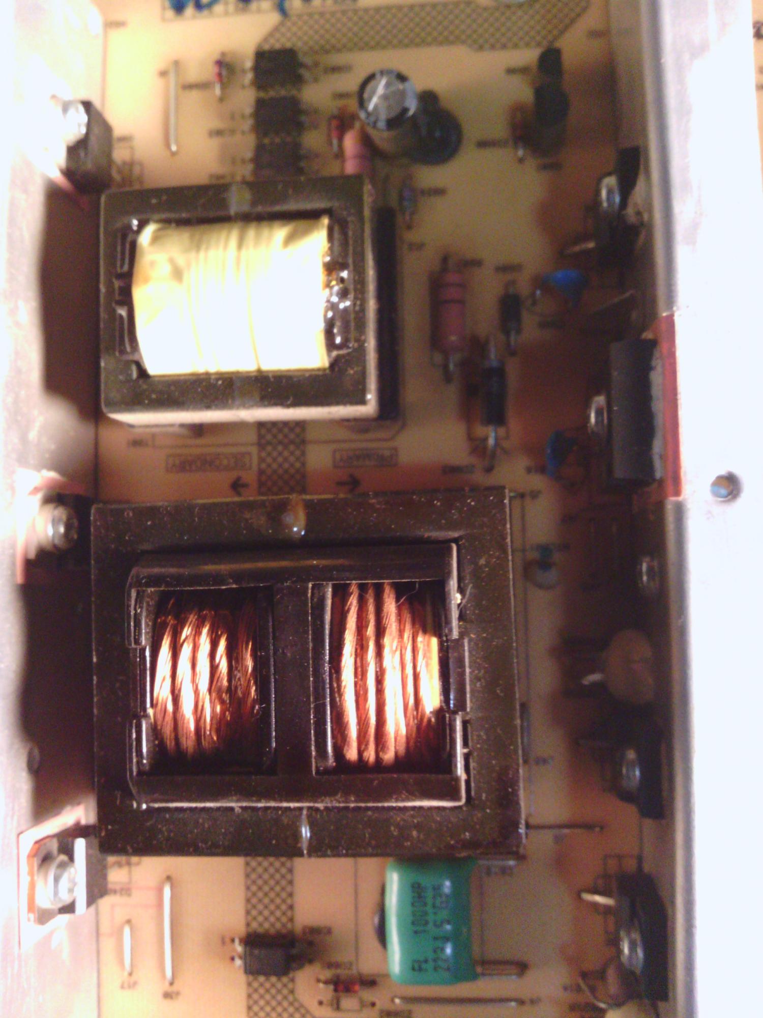

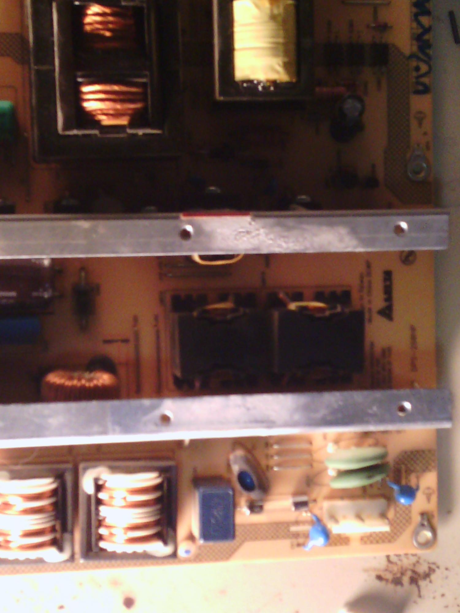

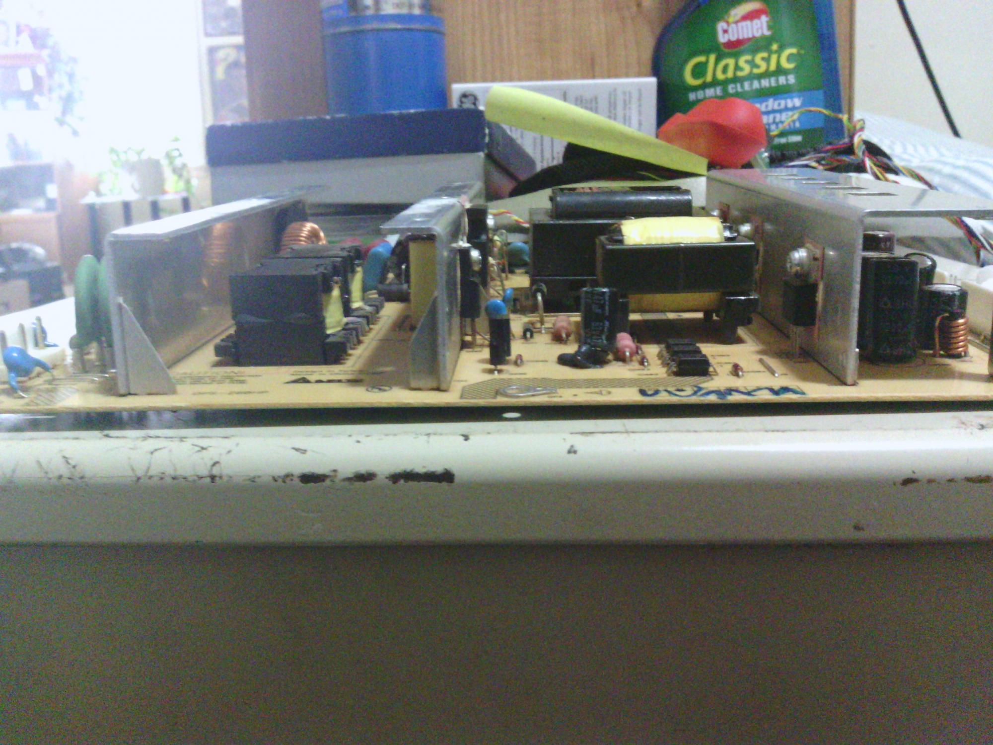

              Pics, had to use my tablet couldn't find my camera power cord.

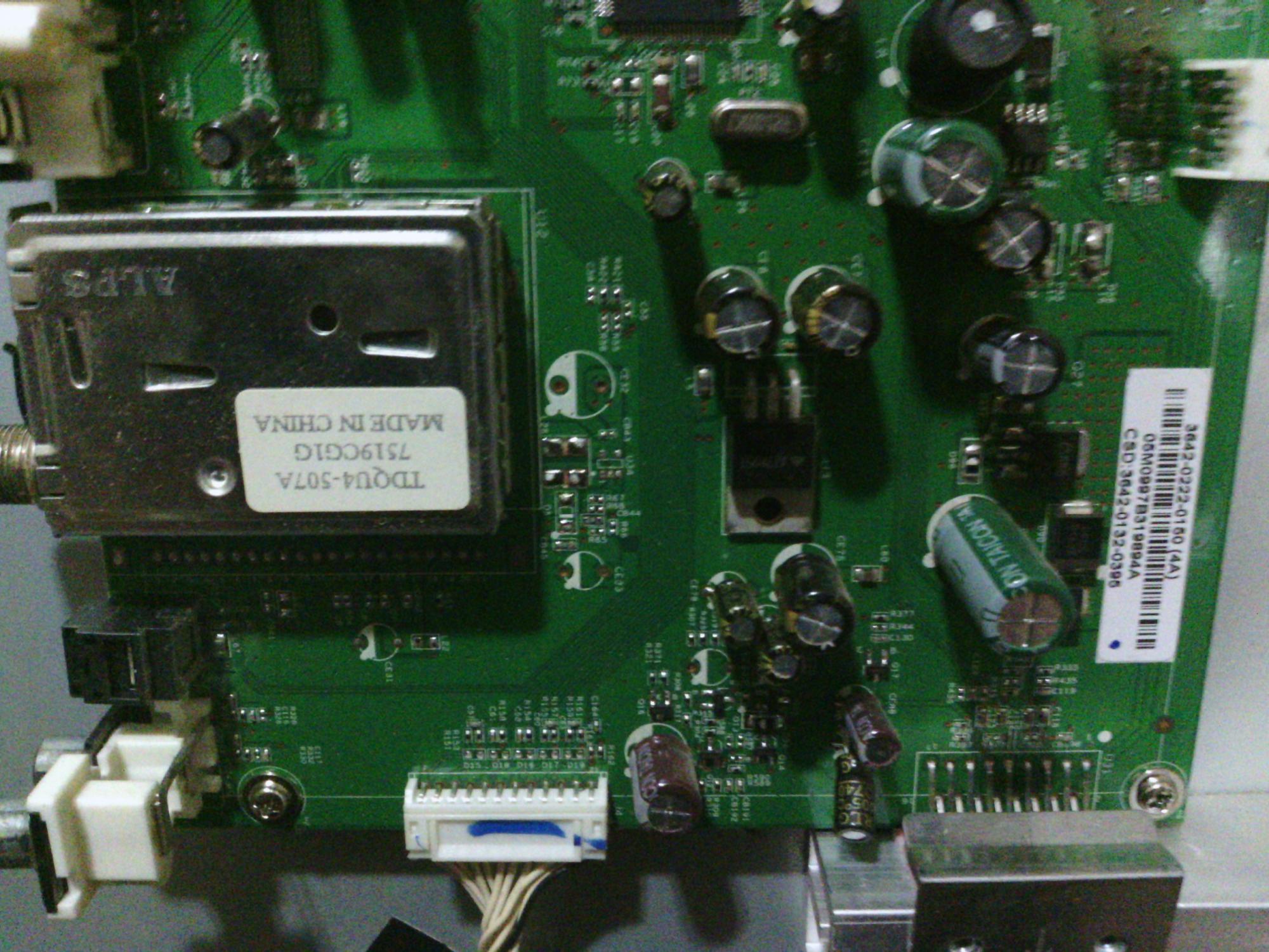

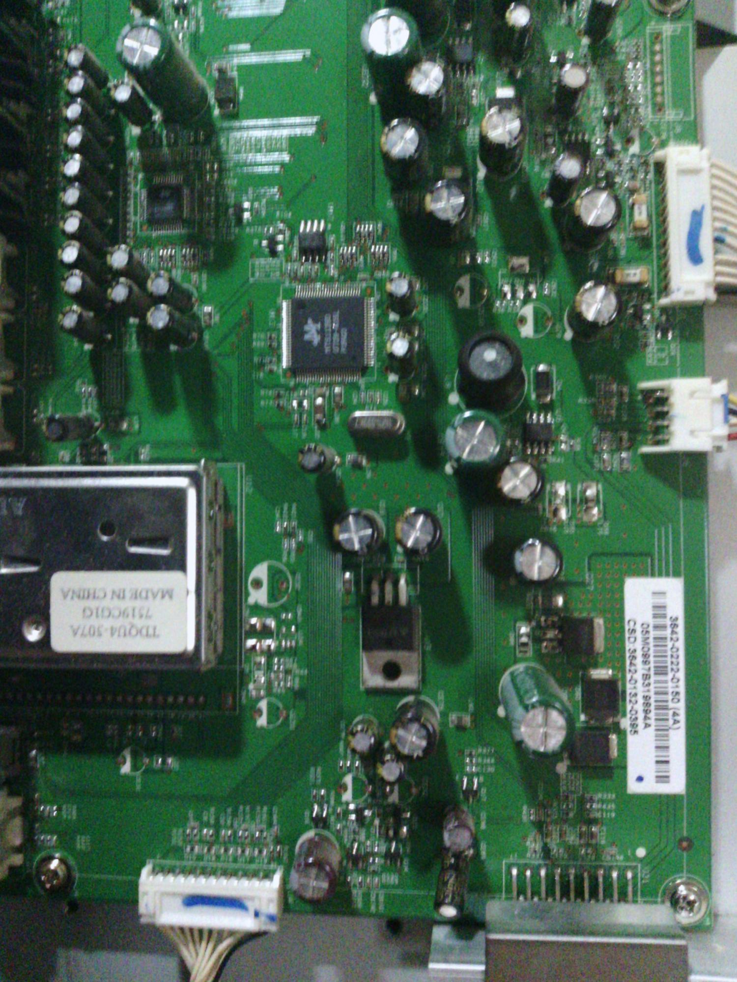

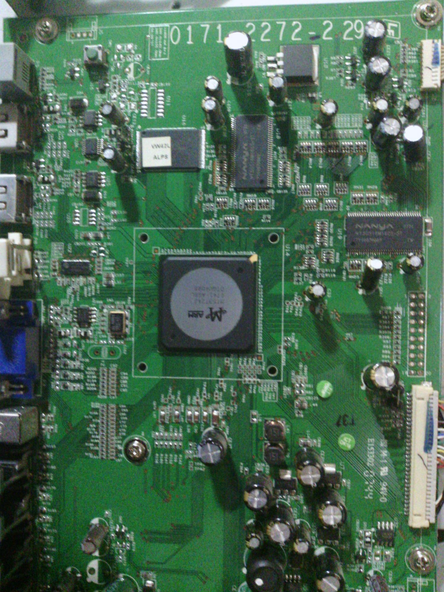

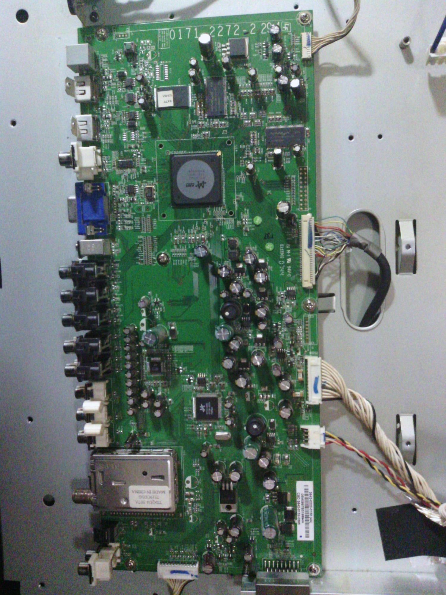

              • Vizor
                • Nov 2011
                • 215

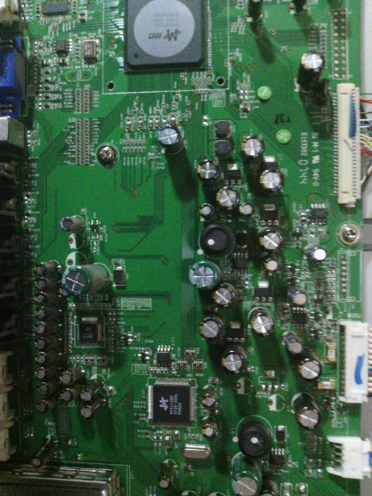

                Main Board Pics.

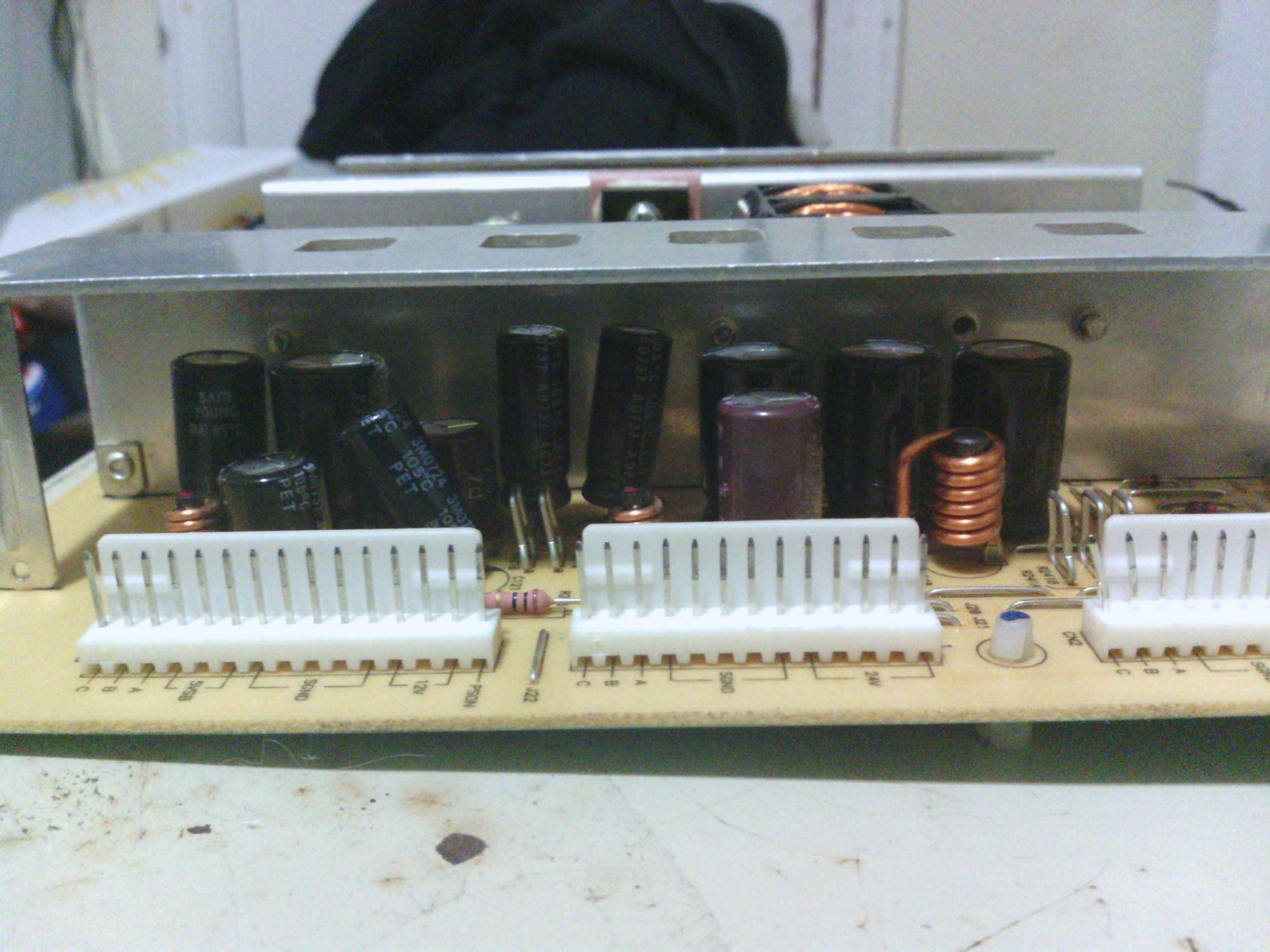

                • Vizor
                  • Nov 2011
                  • 215

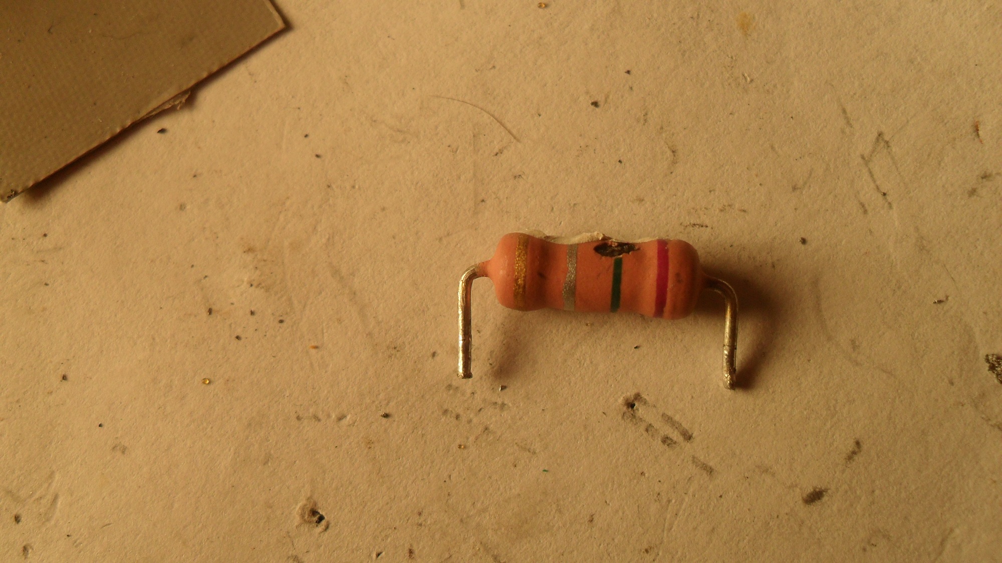

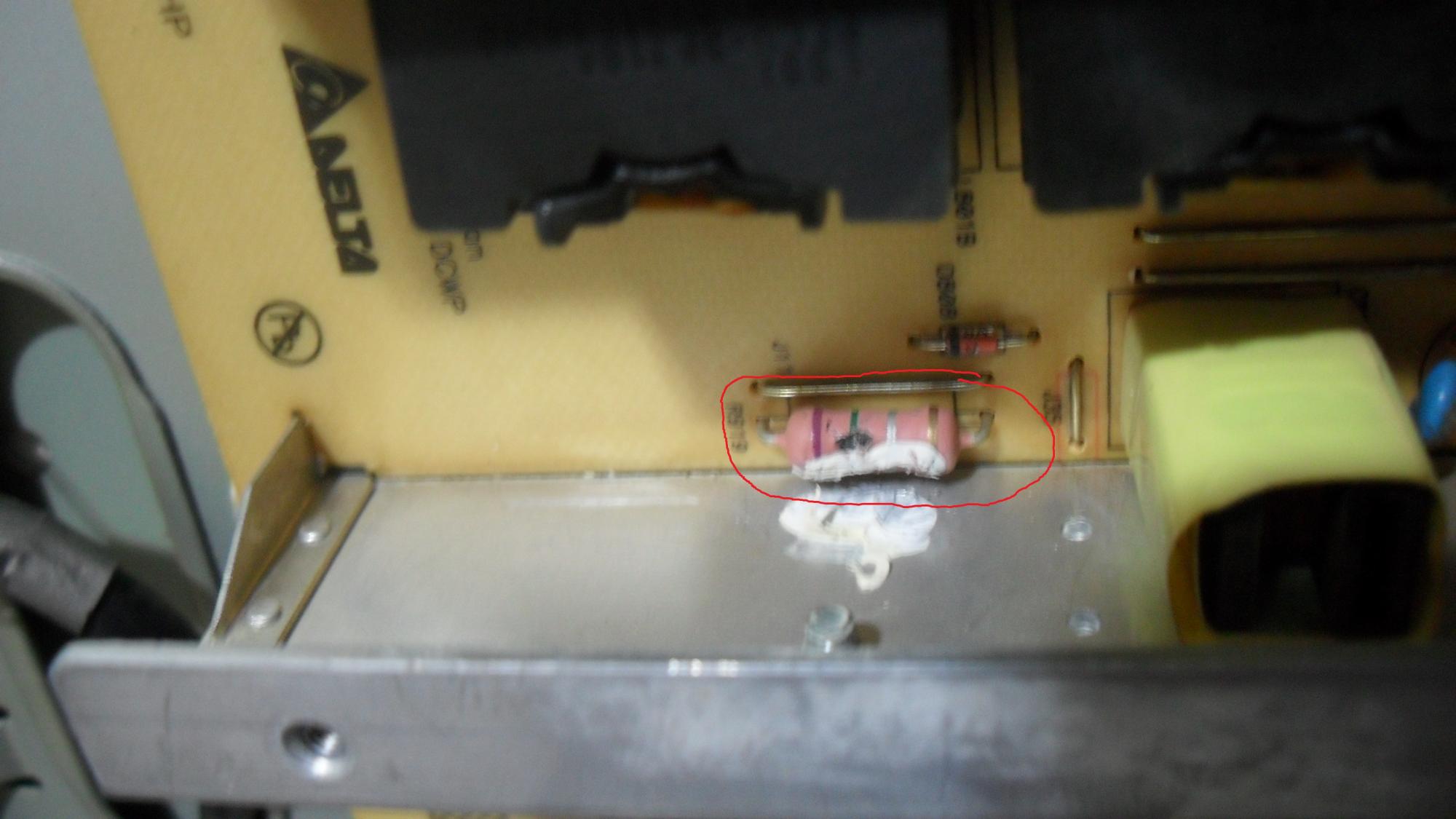

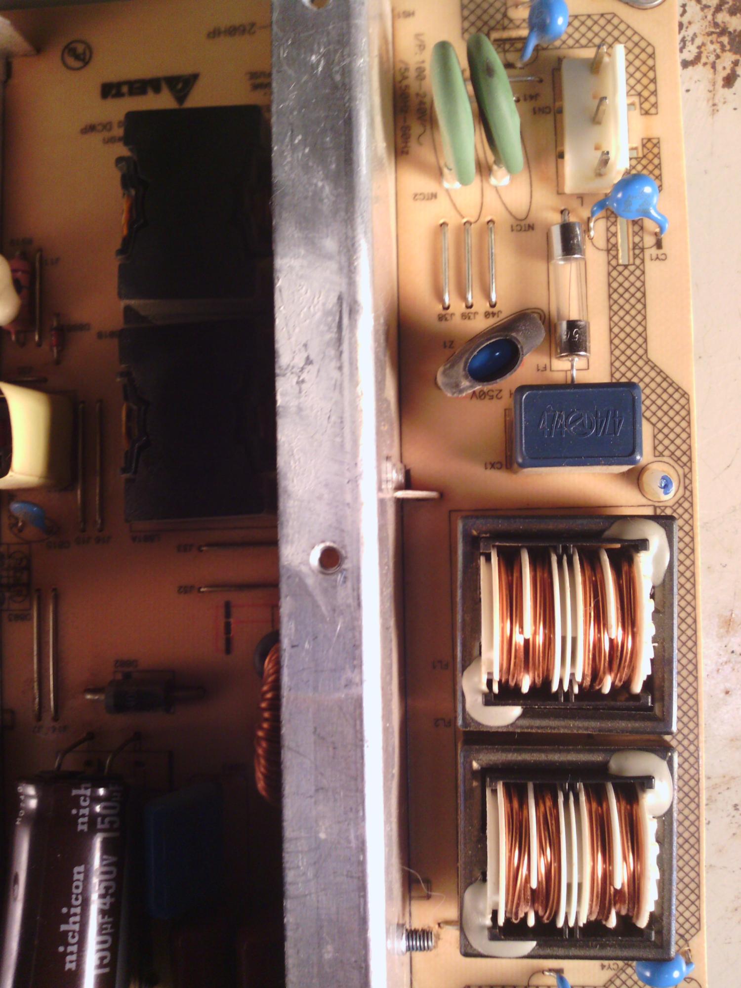

                  Noticed this a little bit ago what can i replace that with?
                  • PlainBill
                    • Feb 2009
                    • 7034
                    A .75 ohm metal film? 1 watt? resistor. It's a little hard to determine the size from the picture; the actual length of the body can be used to determine the wattage.

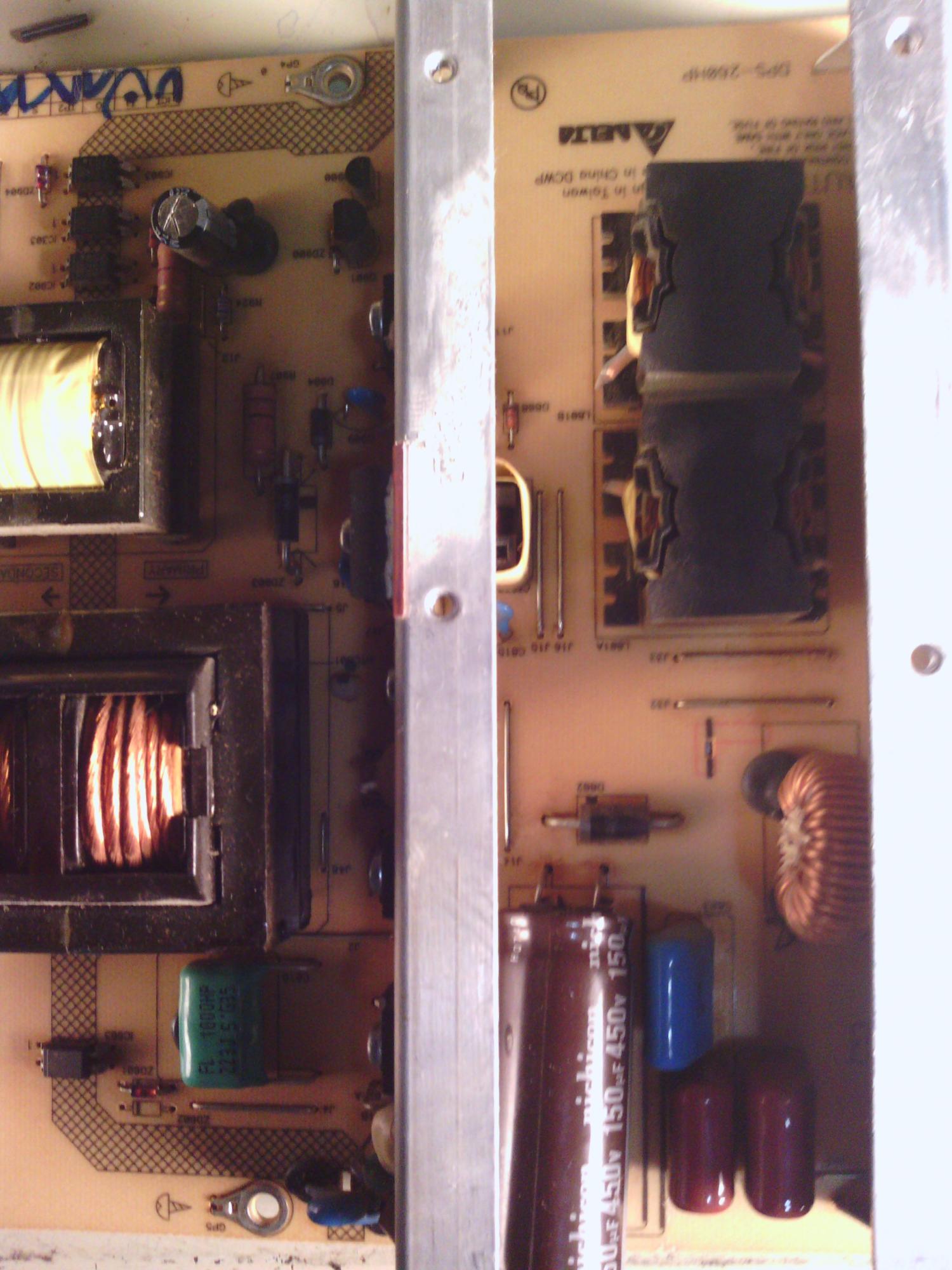

                    • Vizor
                      • Nov 2011
                      • 215

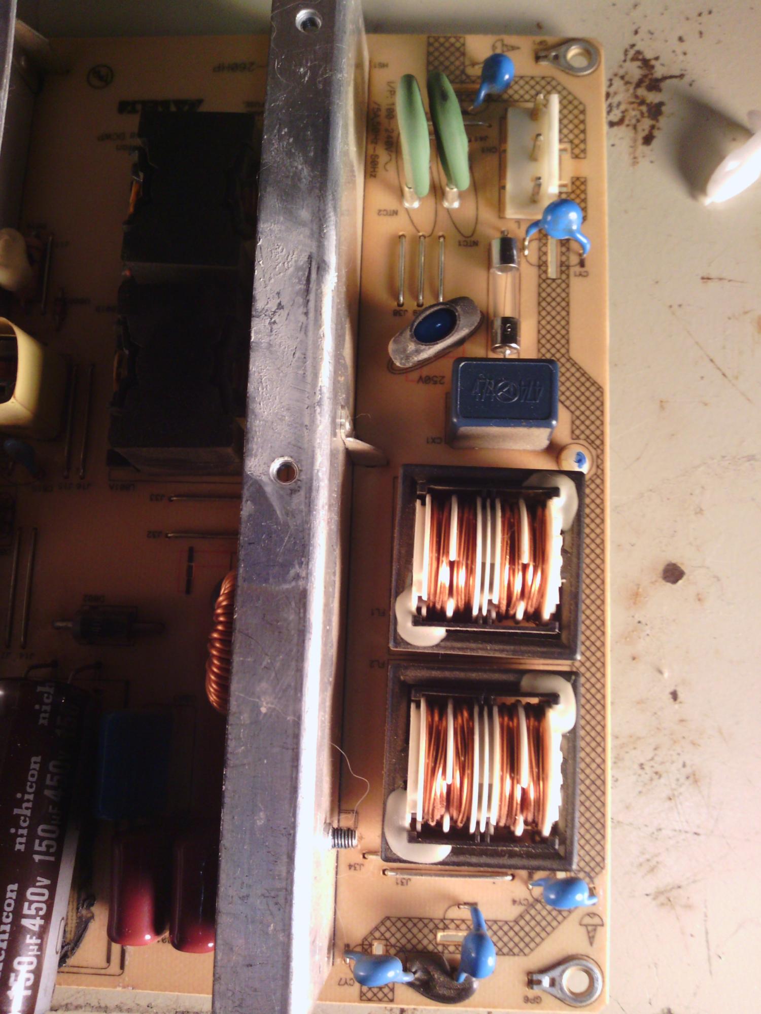

                      More pics.
                        Looks like a 1W or 2W resistor. But even a 5W resistor would fit there. Just get the wattage higher than the original. (Make sure the replacement is bigger.)
                        But... what makes you think it has failed?
                          More pics.
                          Vizor, How about a picture with a ruler next to the resistor?
                          Also, a resistor of this value is often used to sense current. This may have failed because something else was shorted.
                          tom66: The hole in the resistor kind of indicates it might be bad.
                          PlainBill
                          • Vizor
                            • Nov 2011
                            • 215
                            its 1/8" don't have a real ruler around here lol :P used my tablet
                              PlainBill
                              I've seen resistors with black marks that are fine; but a hole would usually be pretty bad. I did overload a 3W resistor once. The only sign of failure was that it had darkened and the colours on the bands were darkened; however from a casual inspection you wouldn't know the difference (it went from 680 ohms to open in about a minute when 20W dissipation was used.)
                              • Vizor
                                • Nov 2011
                                • 215
                                also checked the main board, checked F1 and F2 on a 200 range ohms, F2 has 0.5 and F1 has 0
                                was looking at this thread. same issue.
