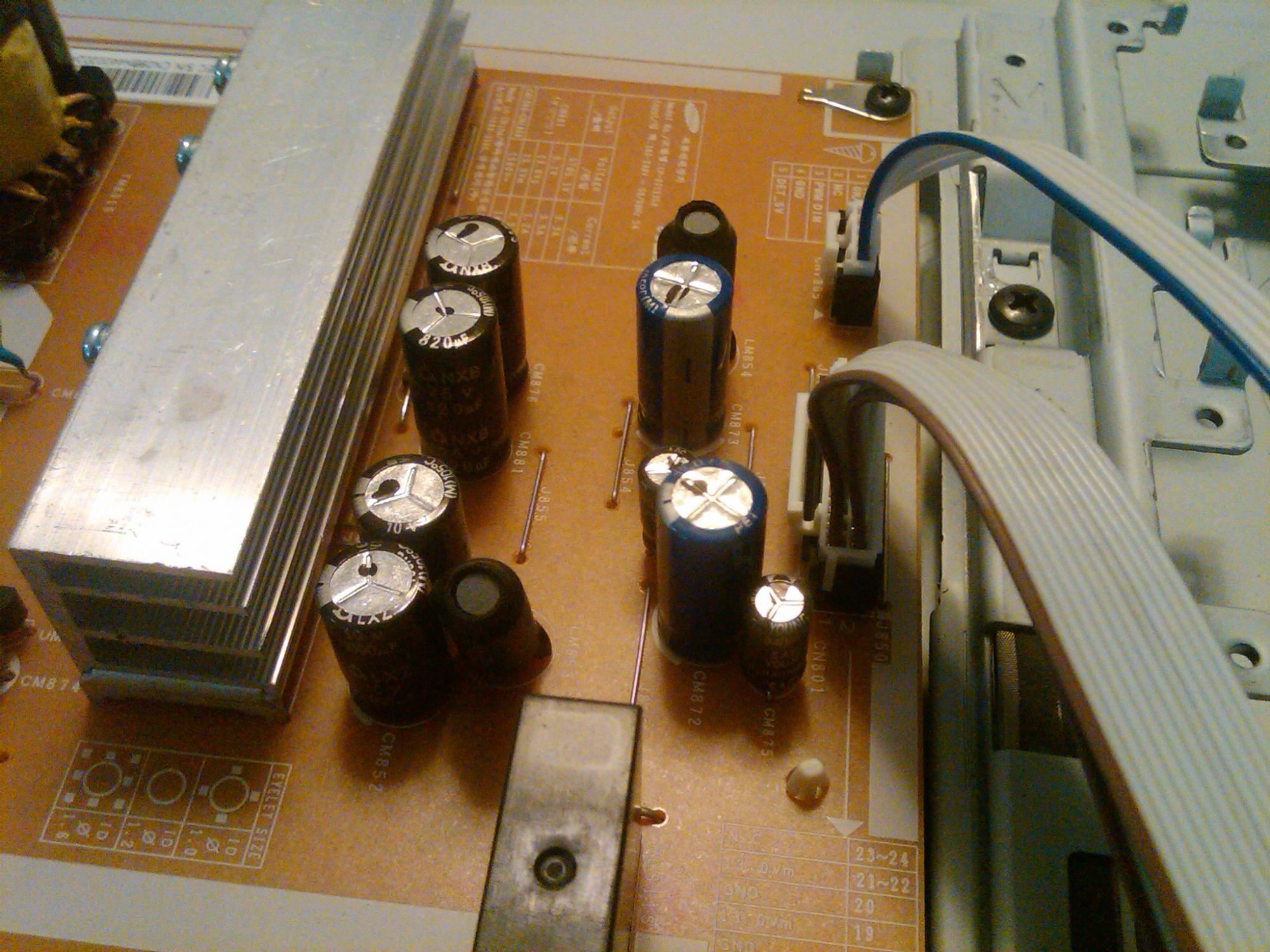

    Rookie here, I tried using the search function to locate similar problems to my tv and couldn't find any, so I apologize in advance if this topic has been discussed already.
    My Samsung LCD TV (model# LN46A540P2F, bought 11/2008) is having problems when turned on after being off for 1hr or longer (problem doesn't happen when the tv is warm or has been on for a while). The TV constantly reboots and the picture has green vertical lines and loud screeching static noise, after 5-6 automatic reboots the picture/audio quality is fine. I have visually checked the capacitors on the psu and they are not bulging or leaking (see photo), I just replaced the t-con module last night with a new one and that didn't solve the problem. I also just replaced the cable box and that didn't fix the problem (samsung cs recommendation). After some basic trouble shooting I have found a pattern:
    1) If I turn the tv on and cable box on (same time) after both being off for 1 hr or more, I get the problems.
    2) If I turn the tv on (turns on right away, even after being off for awhile) and leave the cable box off for 2-3 minutes (TV says searching for signal), then turn the cable box on I don't get any problems. So it appears that once the TV is warmed up, I don't get any problems. Could it be bad capacitors? Even though they are not leaking or bulging? Maybe they work better once warmed up????? What about the power inverter, could that be the problem?
    3) I also tried using the HDMI port on the side of the tv this morning and my TV couldn't find the HDMI signal, weird I thought so I just plugged it back in the rear HDMI port (where is always has been). Maybe the side port is bad and back feeding the problems?
    Any help would be appreciated.

      Thanks for the suggestion dgtech. The static sound is intermittent, the picture quality is always strange with greenish verticals lines that sometimes are flashing. also the TV is not responsive while this is occurring. I did video tape this with my phone but I don't think I can attach a video file. And this always occurs when the TV hasn't been on for awhile. so my new work around is to turn the tv on (leave the cable box off for another 2-3 minutes) then turn the cable box on and no problem exists.
      I do have new capacitors on order, my existing ones are from the bad manufacturers, so I figured why not replace them anyway.

            Did you open it up yet and inspect the power supply board? If the power supply is not stable, it can create a lot of strange symptoms.
            You can a bunch of SAMSUNG with bad caps.
            http://s807.photobucket.com/albums/yy352/budm/SAMSUNG/
