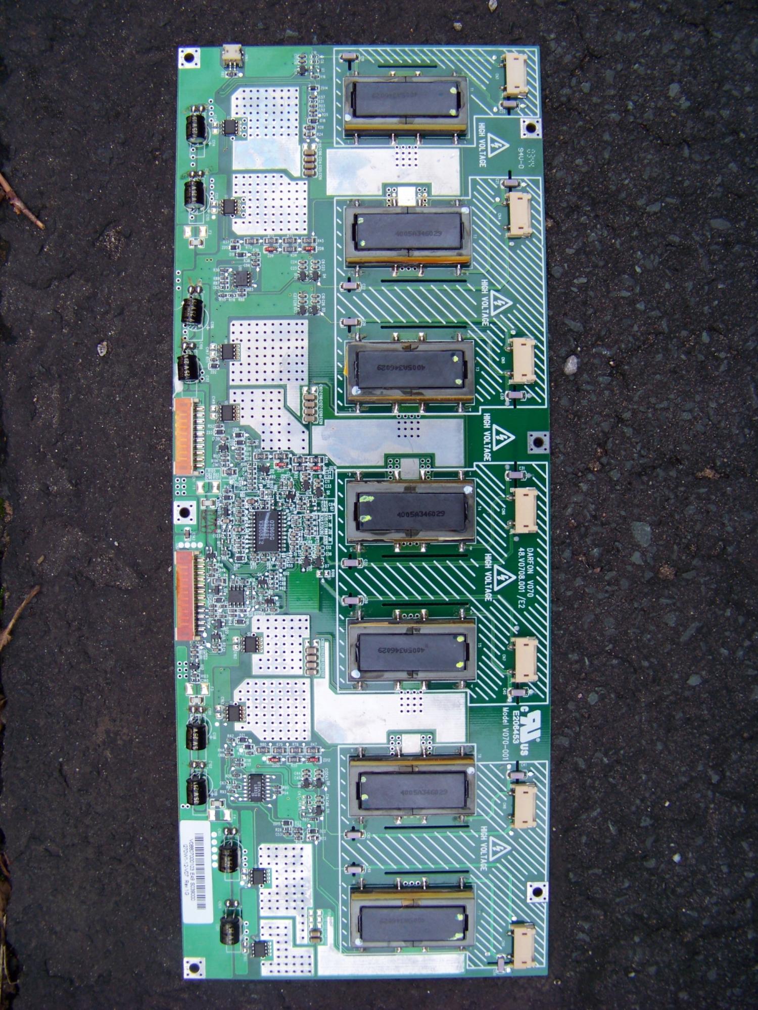

    ok for a while but now has 2sec to black. I have read a few items on here and I am pretty sure I need a new Darfon inverter transformer. I am about to order one having carried out
    A simple resistance check across pins 1 -8 and 4-5 –all show similar (950) except one (T2)Which gives no reading at all on pins 4-5.. At that point I was quite happy with my
    diagnosis ( despite the poor voltmeter I am using – one not recommended on this site)
    but I then thought I’ll check across some other pins 1-4 and 5-8.
    1 -4 5-8
    T1 nr nr = No reading
    T2 0 nr
    T3 nr nr
    T4 0 1908
    T5 nr nr
    T6 0 1908
    T7 nr nr
    I am guessing that if T2 had a reading on pins 1-8 then it would have
    a reading on pins 5-8.
    My question is would it be correct for T 2 ,4 and 6 to have the 1908 readings
    and T1 ,3,5 and 7 to have no reading. I am asking because (a) I should have thought they would all be the same and (b)if I need to buy more than 3 transformers I may as well buy a working board . Im sure that this is a simple query for some of you having read so many of the other difficult ones you have answered.

      If you are measuring in circuit, concentrate on the 1-8 and 4-5 measurements. There are additional components connected to the other pins that will distort your readings. The failure mode on these transformers are an open secondary. The secondaries are wound with very thin wire which is prone to breakage; the primaries are wound with a heavier wire.

        Hi - Thanks PlainBill - I hoped someone would say that. I was measuring in circuit. Have now managed to remove the suspect transformer. Took some effort mind, naturally couldnt find my de solder braid but improvised with thin tv aerial coax (braided part)loaded with flux. Got most of the solder off then revisited each contact passing 3 amp fuse wire between the pins and pads whilst meltiing the remaining solder and a little upward pressure with a small lever. Good job its only one to remove!!.
        Tested the pads/traces back to next visible point and they seem ok.
        Transformer doesnt look burnt or damaged but still no reading on pins 4-5 so I have ordered a new one. Will update when I get it all back together.
          Re: Testing darfon transformers
          Transformer came today (Wow- cant believe the quick service) I have put it in and
          TV works great. - hopefully for a few months at least.
