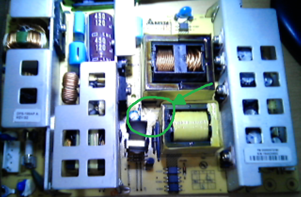

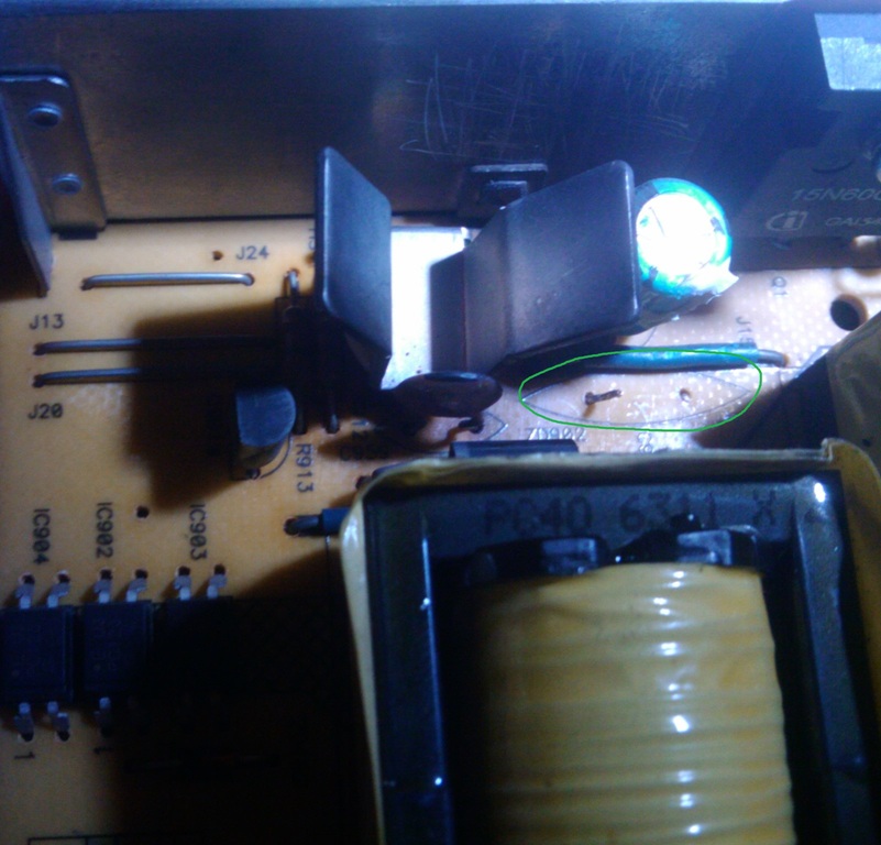

    Ok, I got this Vizio L32 HDTV10A for dirt cheap($10) and the problem is a blown cap on the Power Supply (Delta DPS-199ap a Revison:S2). If I knew the exact ratings for the blown cap, I would repair it instantly. Please someone direct me to a schematic drawing of the Power Supply and/or if you know the value of hand. Thanks in advance.....

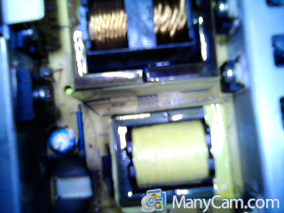

    Re: Delta DPS-199ap a Rev:2 cap value for C913 location(For a Vizio L32 HDTV10A)
    If you can read this, post larger pictures.

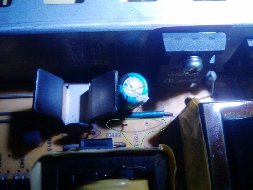

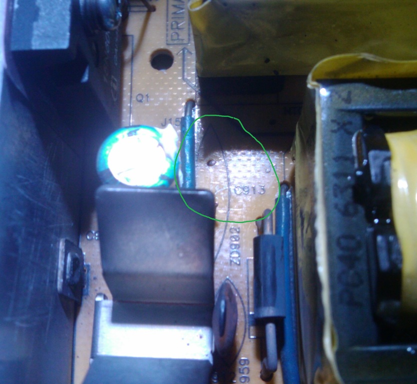

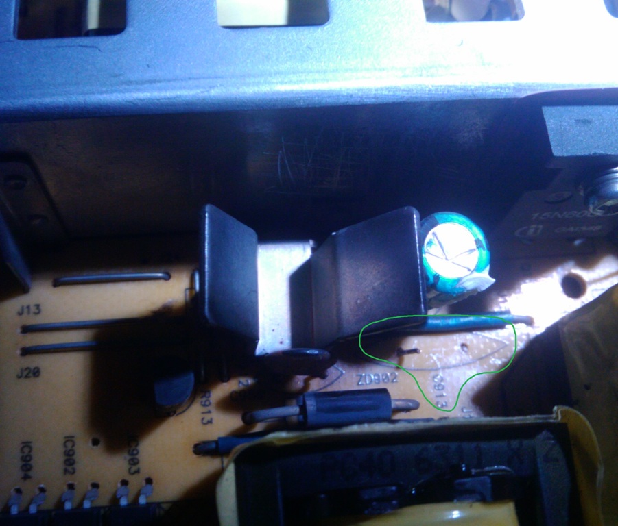

      Hopefully these are better images of the location on the power supply....I circled the area of the location of the cap....The cap was so blown that I couldn't get no specs from it, it's a disc type....

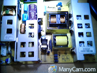

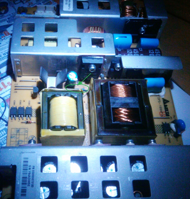

        PlainBill
        Hope these are better pictures.....I inspected the whole power supply board and the other components of the TV and they seem fine....Wish there was a more complete service manual of the Vizio L32 HDTV10A.....
          That looks more like someone cut it off... because ceramic caps do not just disappear like that with two little stubs of wire left.
          If it really did explode, there should at least be fragments of it lying around.
            I agree with b700029, unless you trimmed off the lead and there were more parts of it lying around, it looks like this was cut out deliberately.
            It looks like this is part of the gate drive circuitry for the main SMPS. With the part numbers of the SMPS controller and the power FET we may be able to make an educated guess for the proper value.
            Schematics for Vizios are hard to find. Many TV manufacturers turn to a subcontractor to design and provide the power supplies, schematics for those supplies are very hard to find.
                I trimmed it off to clean up the area. The cap was so blown, only a fourth of it was left.
                    PlainBill
                    Do you mean the Voltage Regulators(ie. Mosfet) on the heatsinks and the IC chips on the board? The ones in close proximity to the blown Ceramic cap.

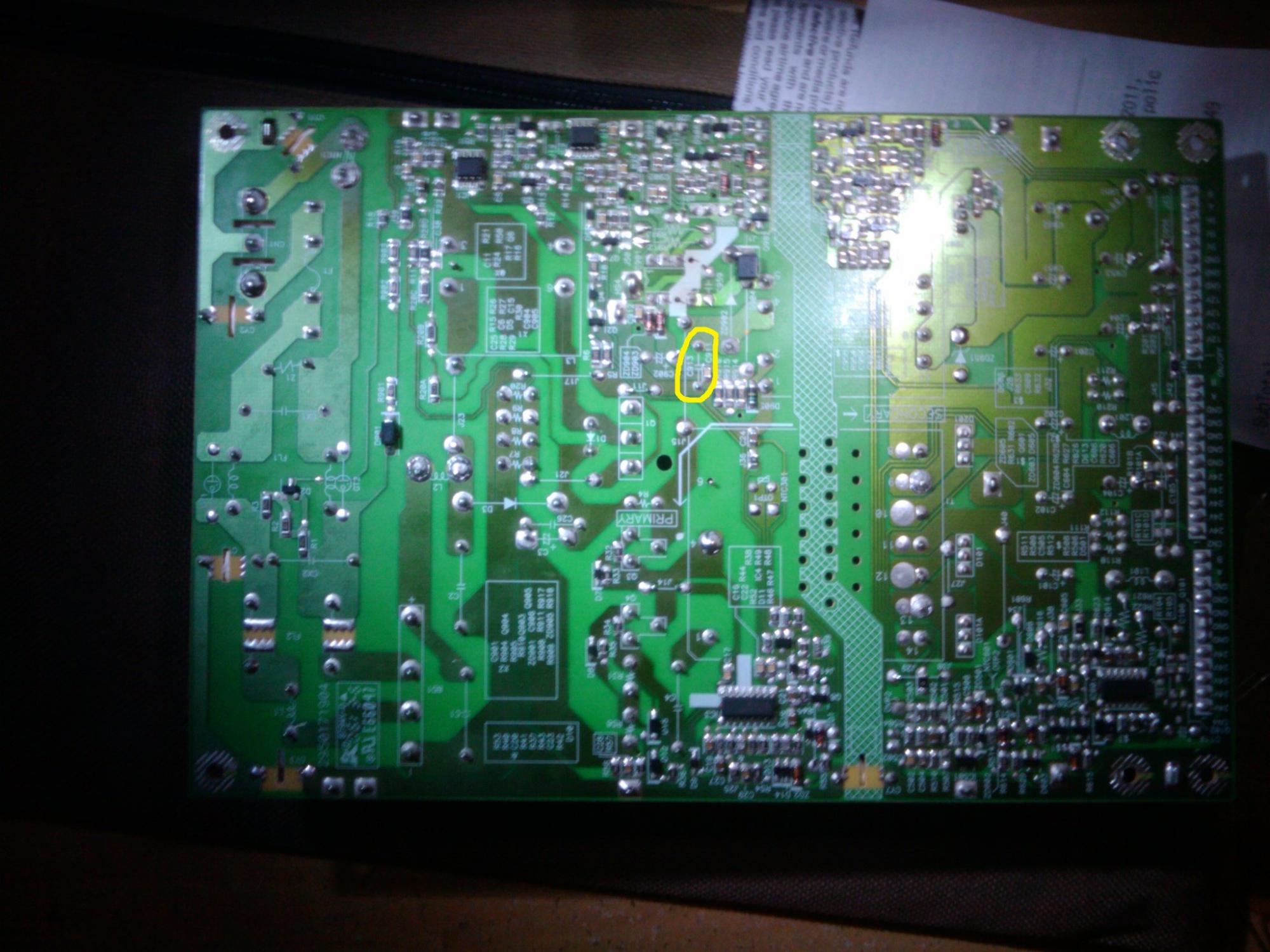

                        Don't know if this will help out, but here's the back side of the PCB....
