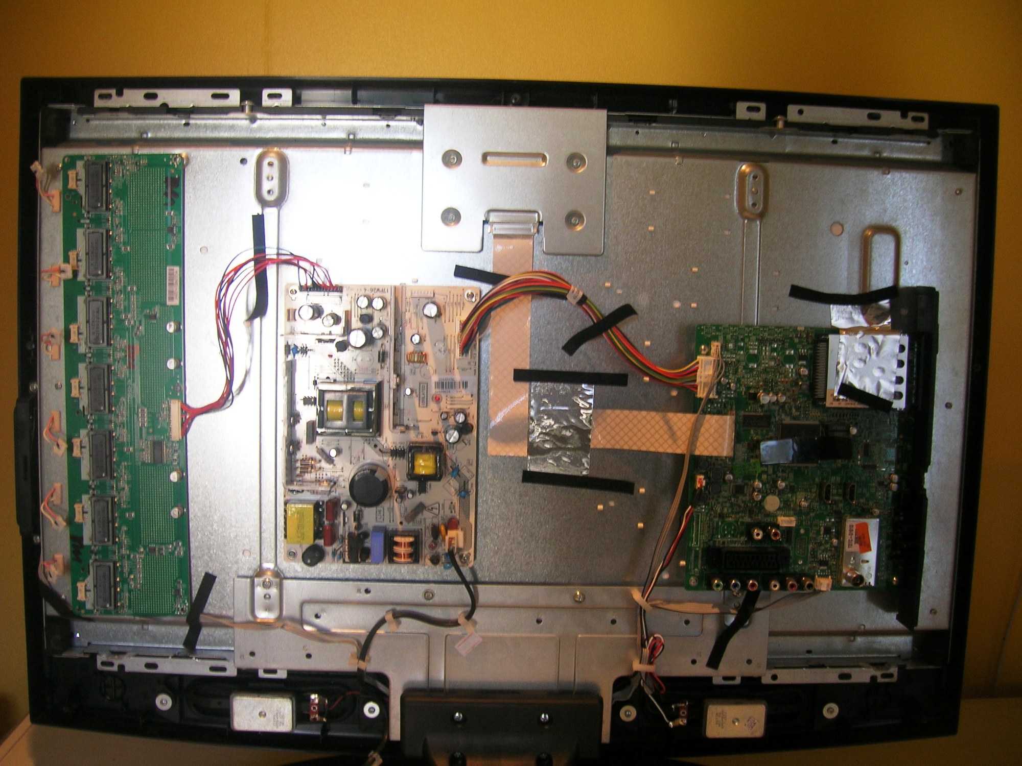

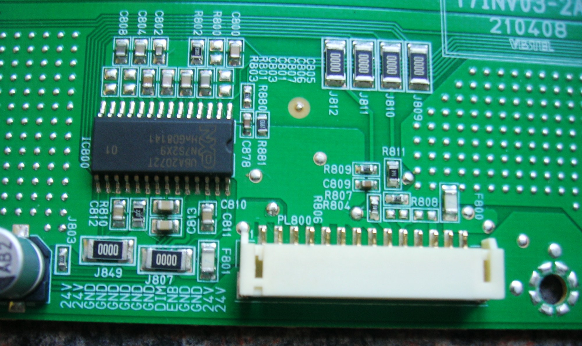

    Hi all have a problem with a 32" Alba unit ,

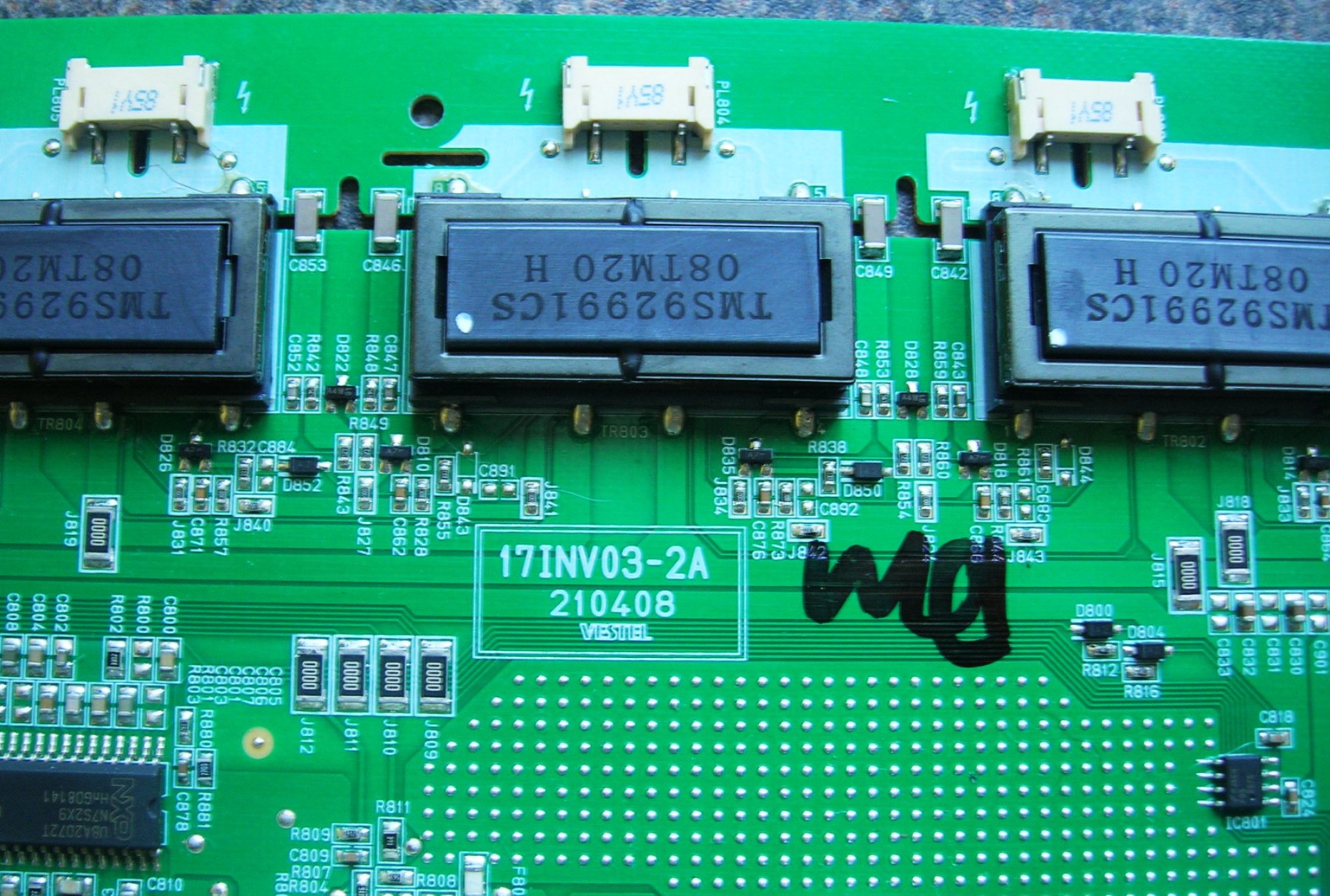

    i have sound but no picture so opened up the back and saw that the inverter board has had a repair attempted so using the board numbers i ordered a new board (17INV03-2A).

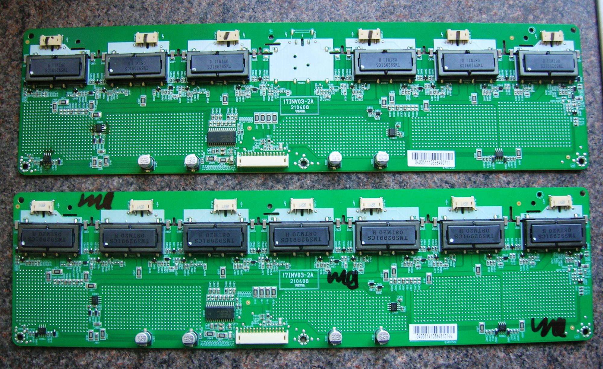

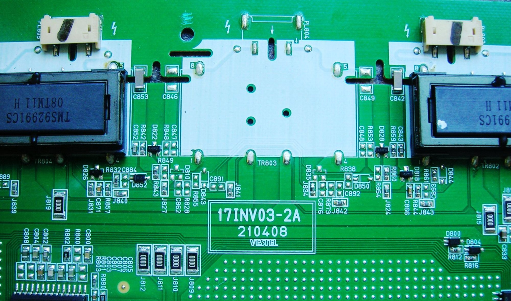

    New board arrived and it is different in the fact that it is a 7 lamp output and not 6 as mine.
    On close inspection it looks to me like a factory option for want of a better word for it ,the solder pads look clean and not as if someone has tried to rig it to work on this tv though saying that i am now not even sure this is the correct board for this tv .
    All outputs from the psu are working and correct ,i have even tried a new psu as i have one spare (17pw26-4 v.1)
    24v = 24.3v on all 4
    ENB = 3.3v constant
    DIM = 3.2v constant
    I am not sure where to go with this now as i dont want to start taking bits off a perfectly good new board unless someone has come across this before or know of another board that is supposed to go on here .
    Have looked up the board by Model number of the TV but this brings up an 8 lamp unit any help or input welcome plaese

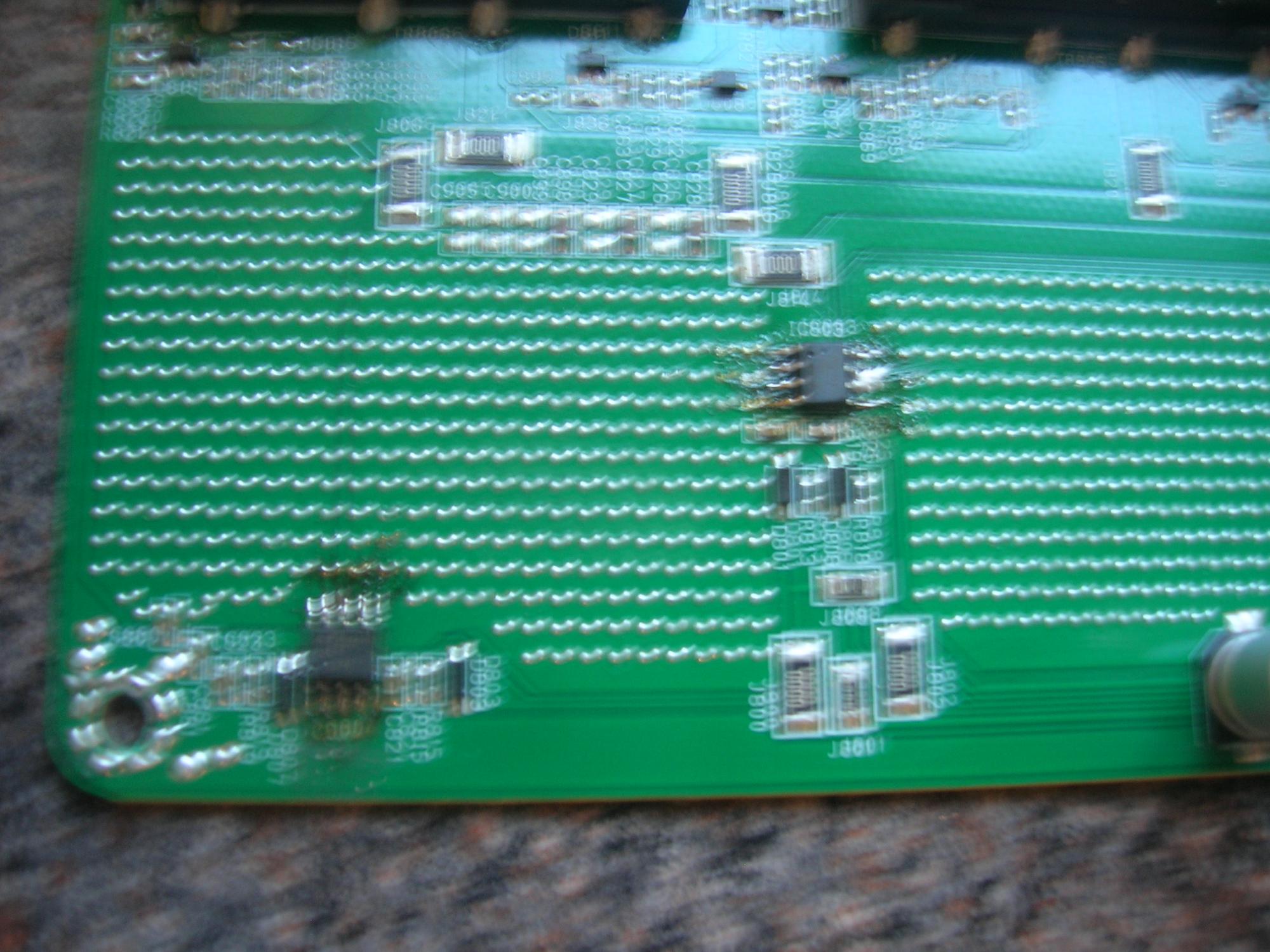

        Dose it look like the repair attempt was simply replacement of the fuse,are there other things look like they have been replaced?
        Whatever I do, I consider it a success, if in the end I am breathing, seeing, feeling and hearing!
          Re: Alba LCD32HDF

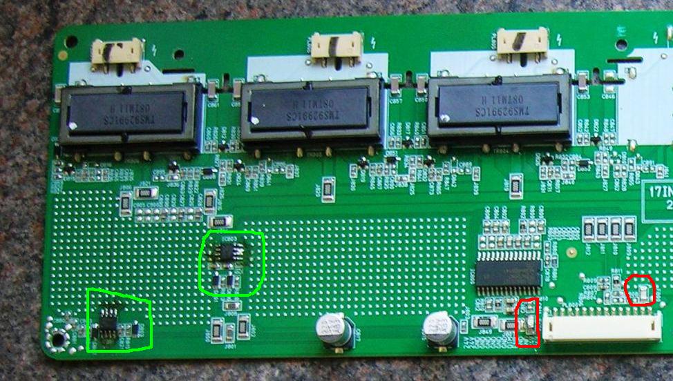

          Yes the 2 fuses marked in red both gone one has been replaced but blown again and one is original
          Both these 8 legged smd in green
          F p j5ch
          fds
          8978
          Obviously one badly bridge soldered so maybe worth me cleaning them up and start from scratch and see where i am then

              I don't know how much you've got invested, But sometimes ICs can be hard to come up with.
              If you're lucky you just may have a enough good parts to make one inverter working.

                    These ics are gone when comparing them to the ones on the new board .
                    But have also found that one of the fuses on the new board has blown
                    which is strange as i have not fitted it or powered it up

                      Have you tested the inverter transformers? They can be replaced individually.
                        Re: Alba LCD32HDF
                        Have checked the transformers on both boards and they are ok .
                        Replaced the fuse on the new board and still will not light up ?

                              The new board may not work. the system may sense that there is no current flowing through the extra output and shut it down.
                                Re: Alba LCD32HDF
                                I wired the board up to a tv with 8 lamps (which has a broken screen)
                                and i know these all work but the same result none of them lit up.
                                But looking at the wiring on the plug that goes from the PSU to the inverter
                                there are 2 spare grounds that are not wired and i was wondering if one of these may be a ground return and maybe thats why its not firing up ??
                                Any thoughts .
