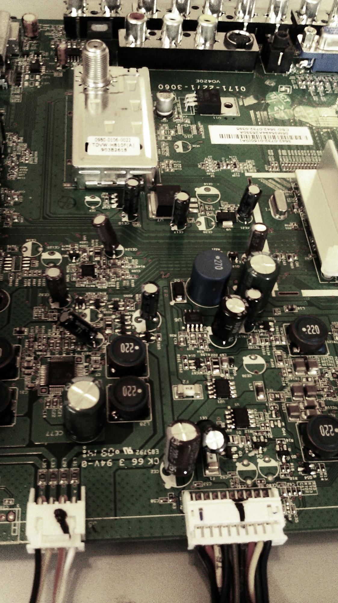

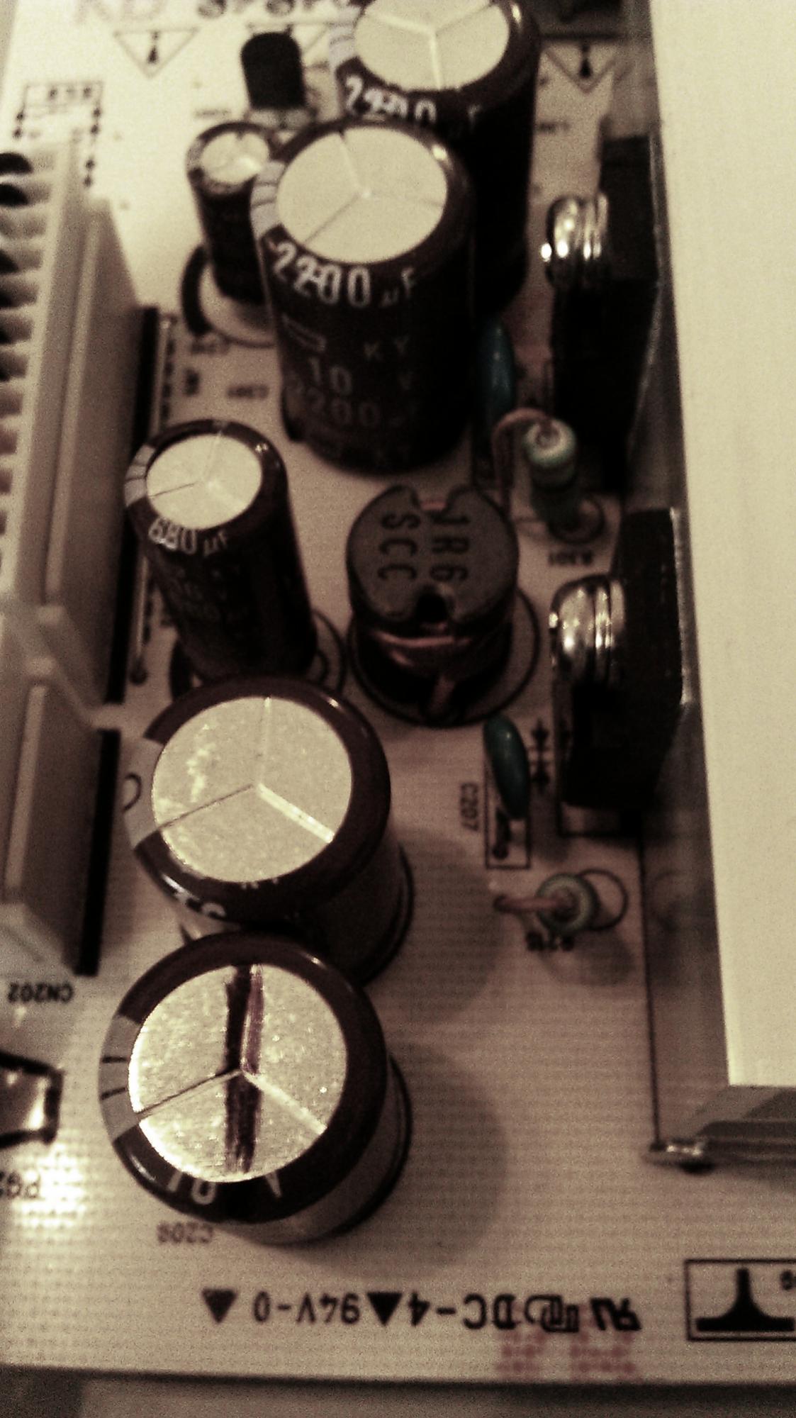

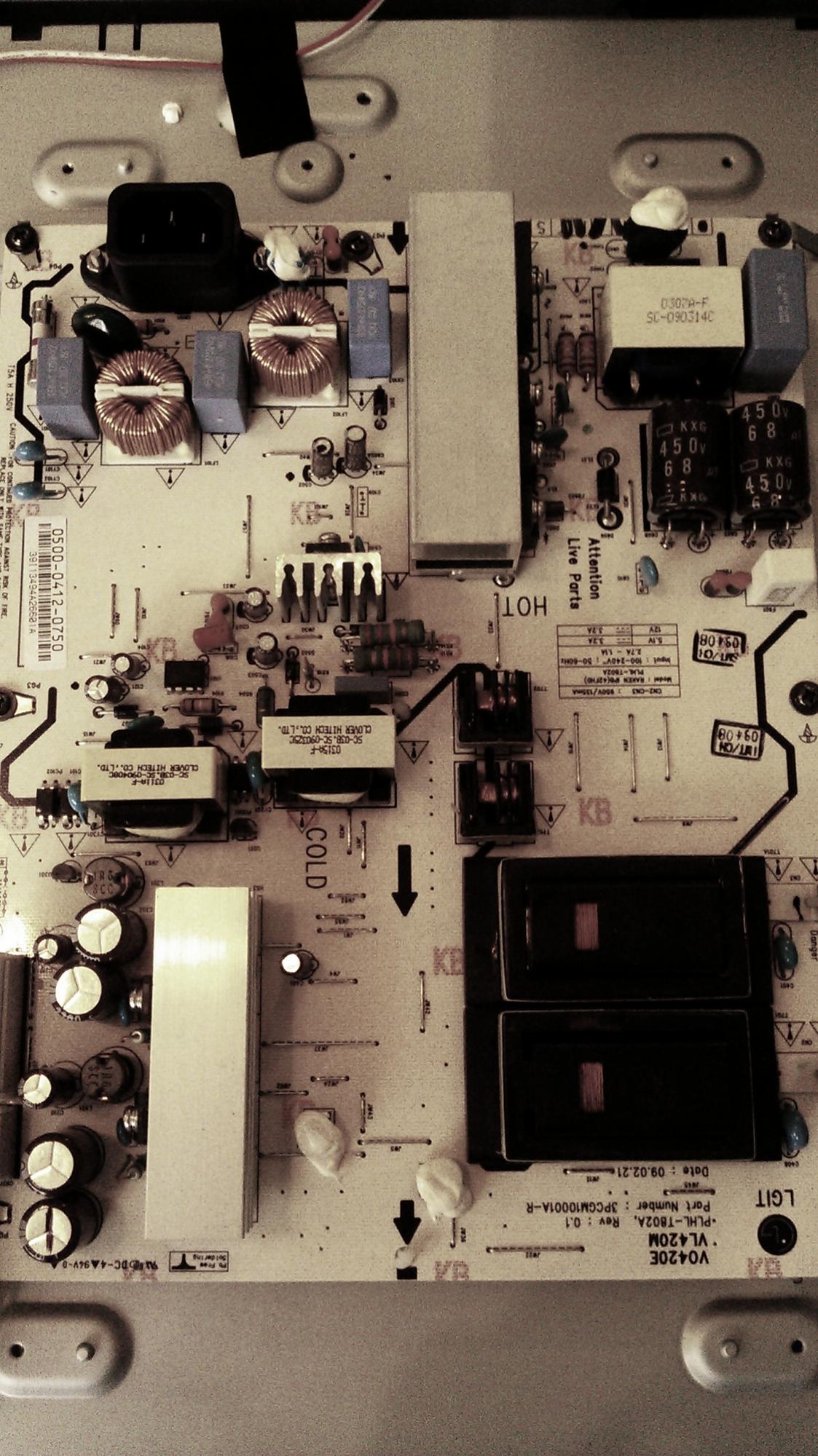

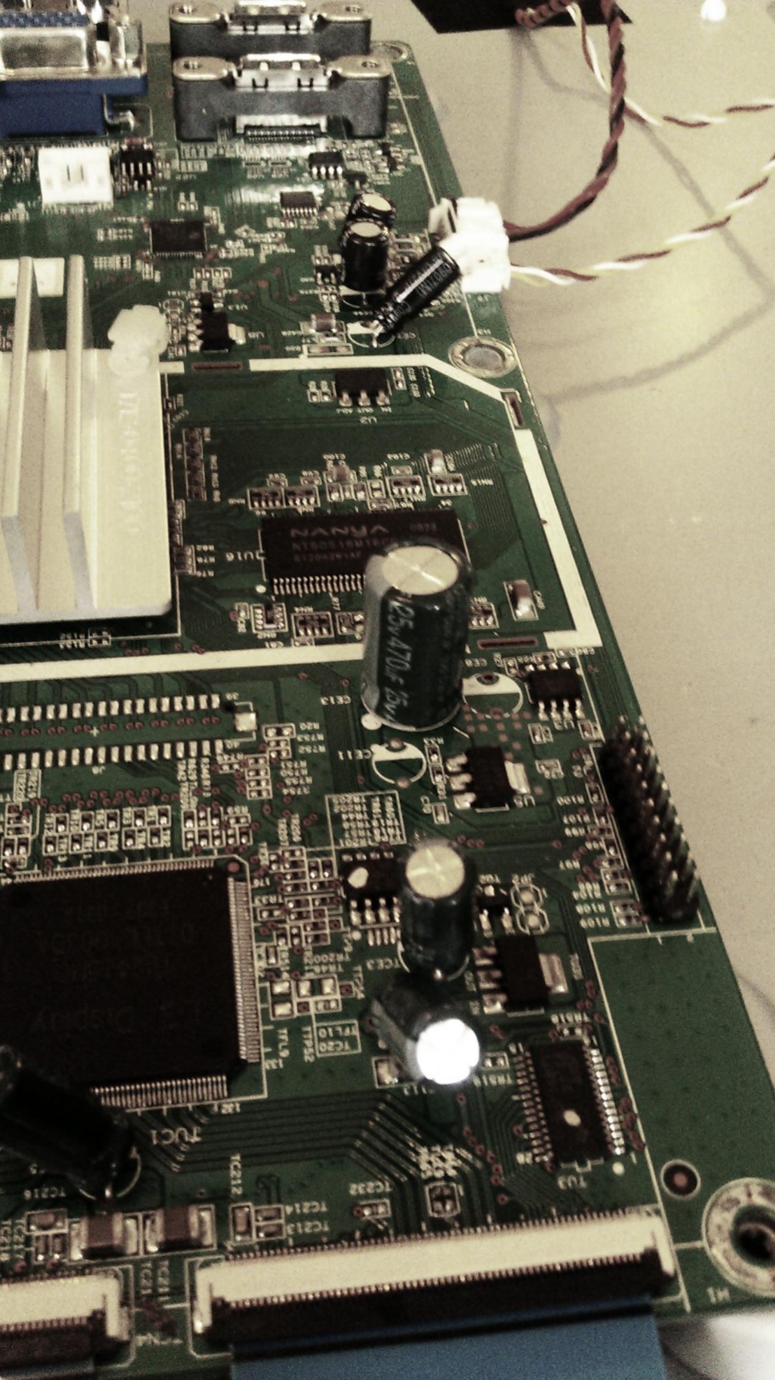

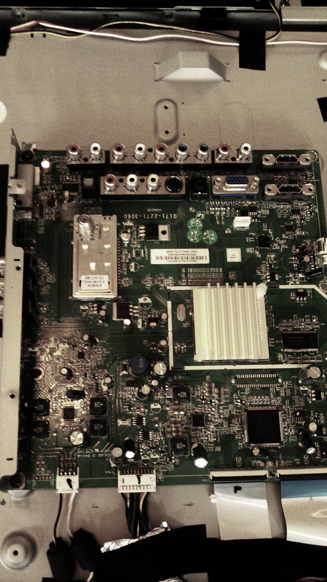

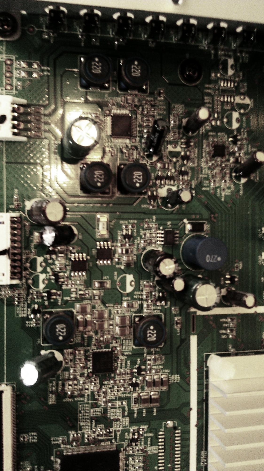

        These are the pics that i took, and the vizio logo does not change colors.

            Re: vizio vo42oe 42"lcd heat problem
            Originally posted by Grn94hatch
            I put the tv back together so i didnt have parts all over the dining room, i pluged it in and turned it on. Now its just the back light no picture or sound, could my first problem have cause the caps to go bad now?
            Not likely. Two likely causes - you forgot to hook up a cable somewhere - or there is a bad solder joint that was opening up when it got hot. Now it was jostled enough it is always open.

              I never took out the boards I just took the back cover off and the metal cover off of the video board. Does that change your answer at all Plain Bill

                    I agree with PlainBill, I'm thinking a bad solder joint or a loose connection. It probably can be found on the main board.

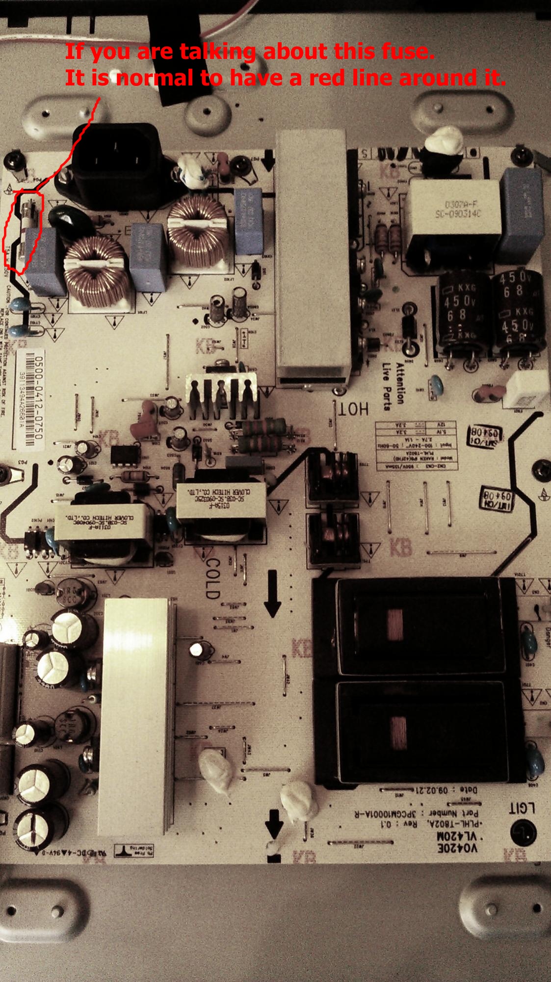

                        • Grn94hatch
                          • Sep 2011
                          • 15
                          There is a fuse right next the where the power cord plugs in, the fuse has a red line around it???

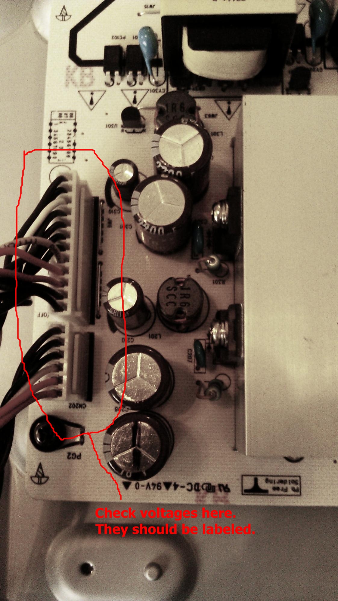

                          • 1beertap
                            • Mar 2009
                            • 219

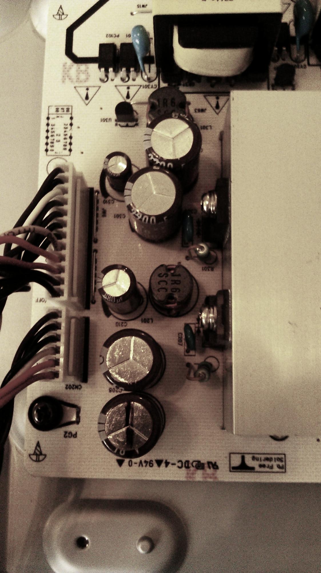

                            I think you are looking at the wrong board. I modified the power supply/inverter board photo you attached to show the fuse I think you are looking at. The main board is the one in which you removed the cover and what you called "video board". It is greenish in color. Take a look at this board for loose connections or bad solder joints.
                            Since you have a back light, this would imply that there is nothing wrong with the power supply providing power to the inverter section of that board. You can check the voltages going to the main board with a meter. On the power supply (yellowish board), the voltages are listed near the connector going to the main board. I hope this clears up some confusion.

                                I have looked at both bords and all the solder joints look fine to me, Im not sure what to do next. should i just look for new boards?

                                    • Grn94hatch
                                      • Sep 2011
                                      • 15
                                      I checked with my multi-meter and I got 10.6 volts on all 3 stand by voltaltage terminals. And 0 on all the others.
