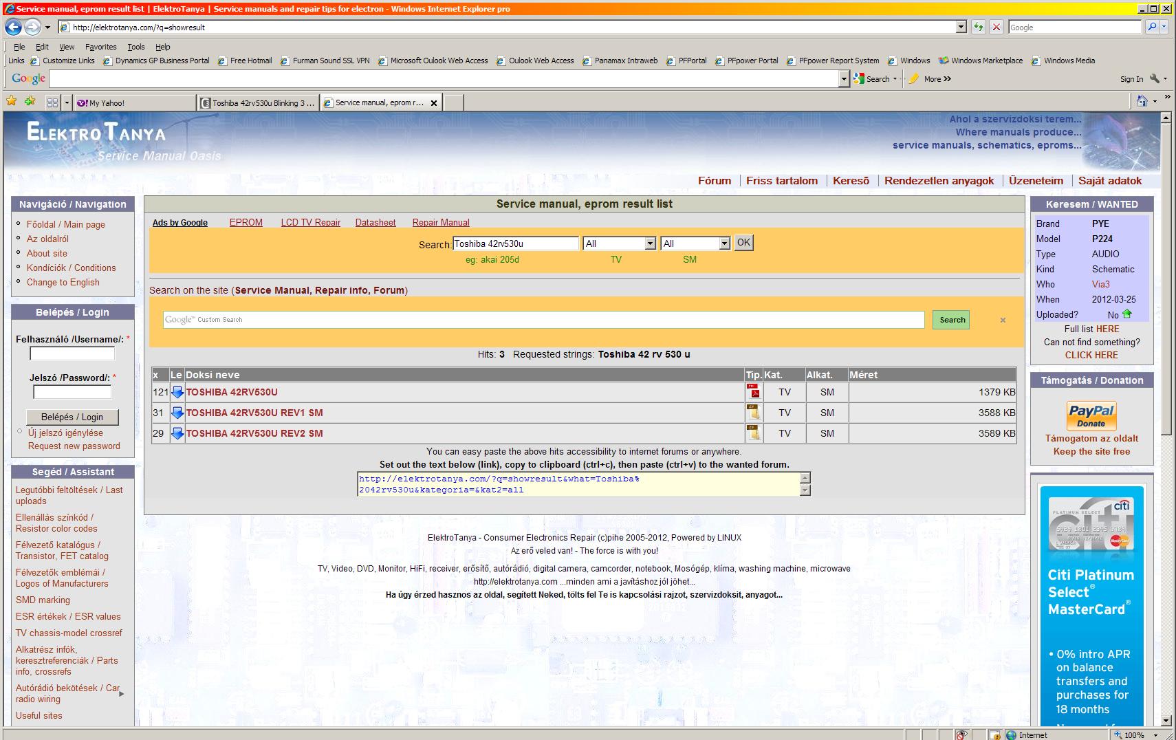

      Can someone please explain in detail how to open this service manual from elektrotanya? Thank you very very much!
        Re: Toshiba 42rv530u Blinking 3 times
        Go there with all your adblock stuff disabled and wait 60 seconds. Eventually the words Get Manual will show up on the screen.

                      I've also tried downloading both revisions of the service manual from elekrotanya with no luck. Always some stupid software you have to buy to open those files!
                        No software to buy, You can down load WINRAR, WINZIP, ETC for free from download.cnet.com
                        http://download.cnet.com/WinRAR-32-b...-10007677.html

                            They are "DWF" files. Only Autodesk can open them.
                              I just went to ELEKTROTANYA and type in the search box, I see 1 pdf file and 2 zipped files, where did you see the DWF?
                              http://elektrotanya.com/?q=showresul...oria=&kat2=all
                              By the way, you can get free DWF Viewer for free.
                              http://download.cnet.com/Autodesk-DW...-10276414.html

                                When I unzipped the file there were DWF files. I am trying to get a schematic for the power supply. I've exceded my 2 manuals per day-

                                  I downloaded the free software, The image appears for three seconds to tease me then goes away!
                                    After clicking on the link, you have to wait and at the bottom right corner will apear a Get Manual link.
